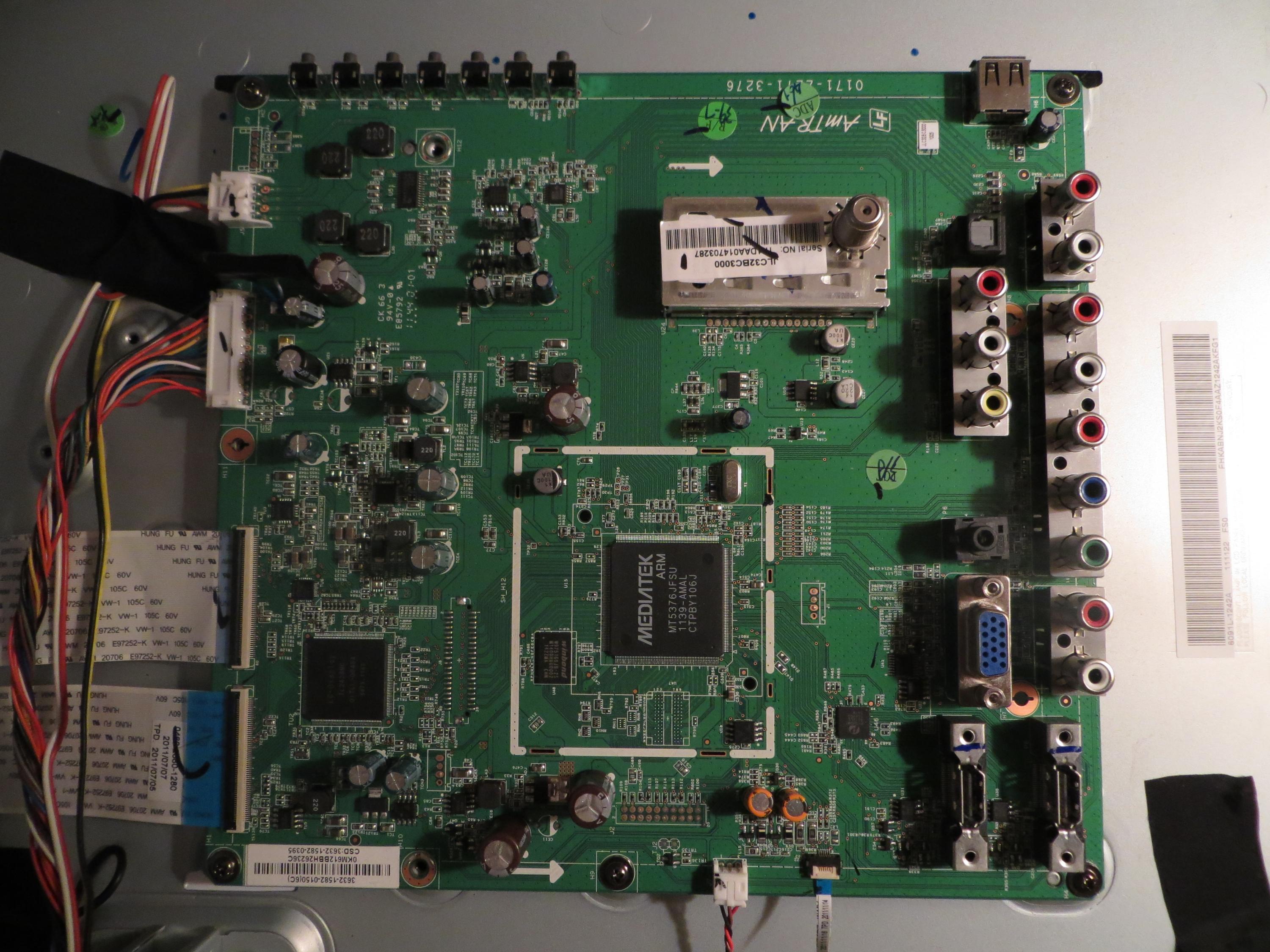

                          #72

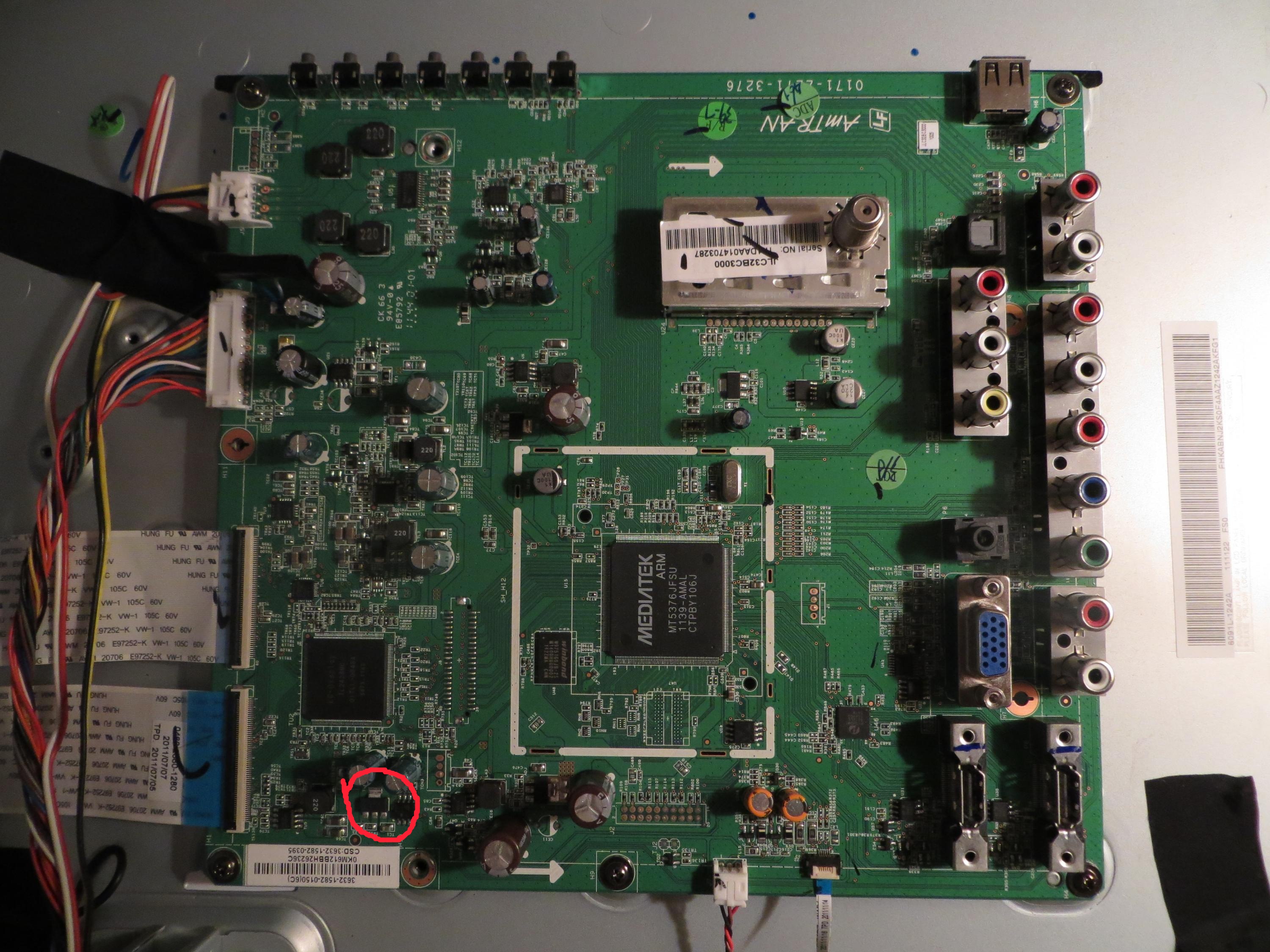

                          Re: Jvc jlc32bc3000
                          Can you post a picture of it?
                            #73
                            Re: Jvc jlc32bc3000
                            let me know what else you need
                              #74
                              Re: Jvc jlc32bc3000
                              Test all the voltage regulators as indicated in this thread:
                              https://www.badcaps.net/forum/showthread.php?t=22231
                                #75
                                Re: Jvc jlc32bc3000
                                this regulator has .1mV on all the pins
                                  #76
                                  Re: Jvc jlc32bc3000
                                  That is fine, no input == no output
