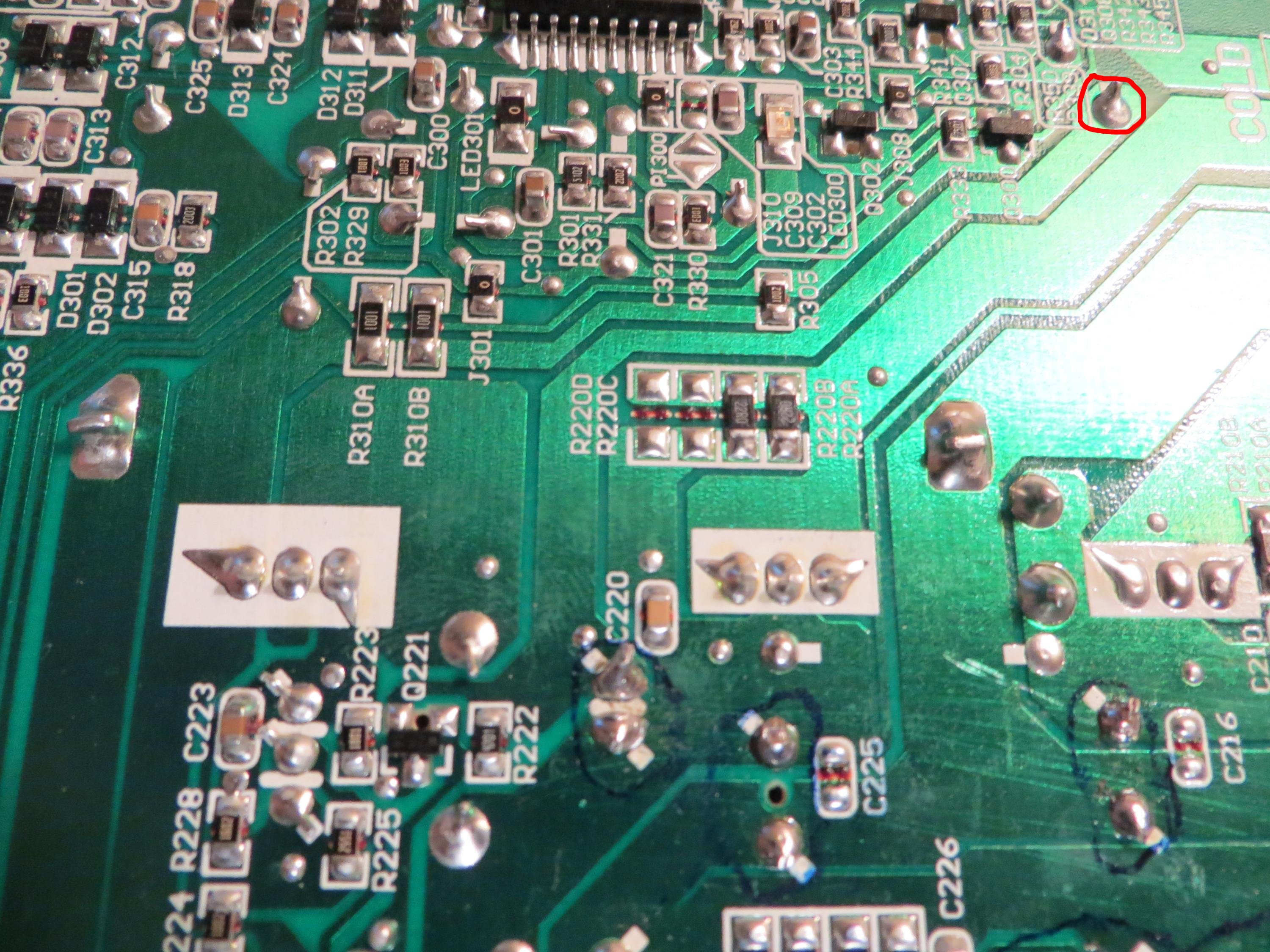

      Re: Jvc jlc32bc3000
      OK, so I suspect this device is faulty. (See attached.)
      Can you get the part # on it? It is probably a PNP transistor but it could be a P-channel MOSFET.
        #43
        Re: Jvc jlc32bc3000
        Kia
        431a
        117
          #44

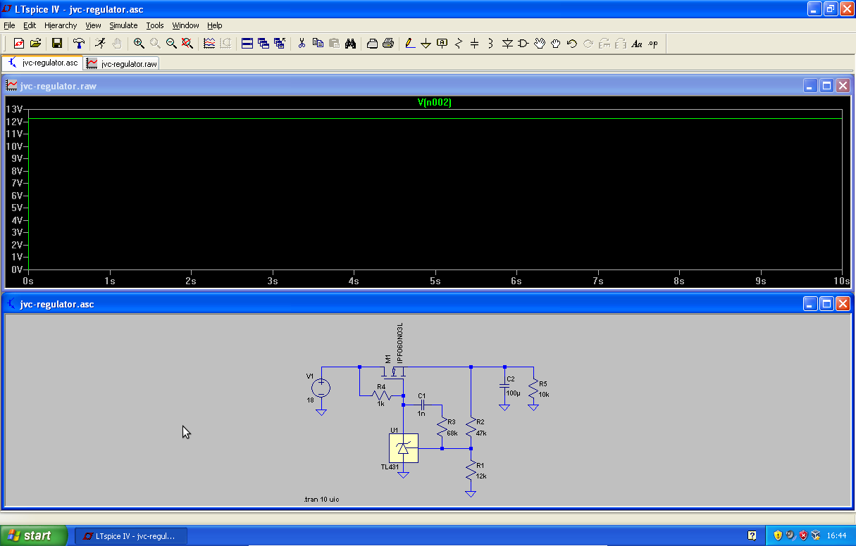

          Re: Jvc jlc32bc3000
          Oh, it's not either of those. I think I understand it. It's a voltage reference. It's regulating the 18V down to 12V, which is an odd way of doing things -- I'm not sure why they would do it that way. I need to trace out the circuit to understand why it's not working. I will be back.
            #45

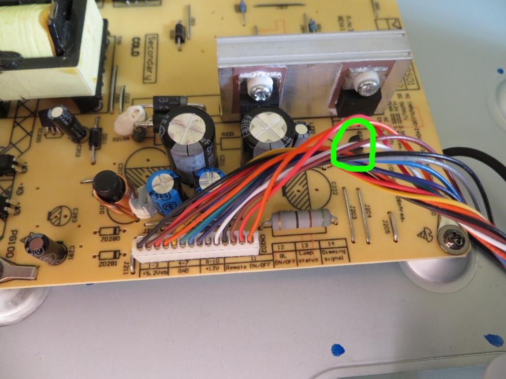

            Re: Jvc jlc32bc3000
            OK, here is the voltage regulator part (see attached.) But I can't trace it fully yet as I don't know where R222 connects.
            I remember seeing this circuit in a Samsung TV too. I think it is to reduce the standby power, by using a single transformer.
            I need you to check which component this lead is part of (see attached.) I have a strong suspicion it is ground.
              #46
              Re: Jvc jlc32bc3000
              it connects to r285 then to q283.

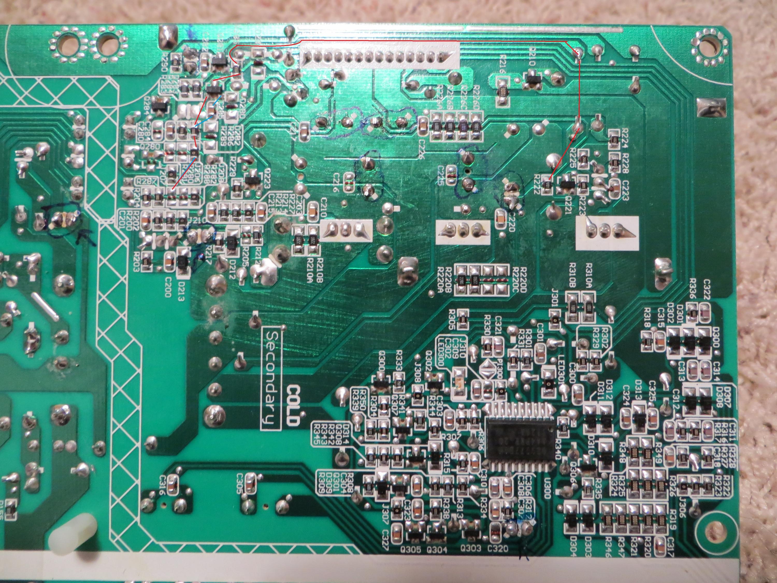

                #47
                Re: Jvc jlc32bc3000
                this what I found

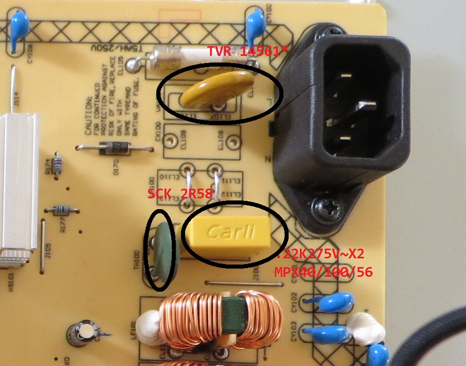

                        #51
                        Re: Jvc jlc32bc3000
                        I think this will help
                          #52
                          Re: Jvc jlc32bc3000
                          Sorry, what?
                            #53
                            Re: Jvc jlc32bc3000
                            Sorry, what?

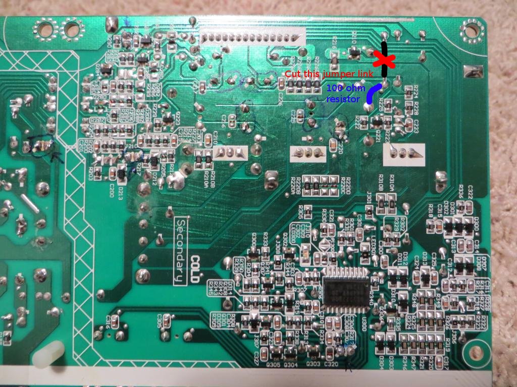

                                  #56
                                  Re: Jvc jlc32bc3000
                                  OK, see the attachment.
                                  You need to cut the jumper link on the top between the two pads.
                                  Then solder a 100 ohm resistor between the 18 ohm and the bottom most pad on the jumper link (nearest the KIA431.) 100 ohms is flexible. Anything up to a few 470 ohm down to 47 ohm should work. It's just to prevent damage in case of failure (the resistor should be the only casualty in the worst case.)
                                  Very important: BEFORE you connect the main board double check the 12V output is giving 12V and not 18V! It should now be 12V all the time.
