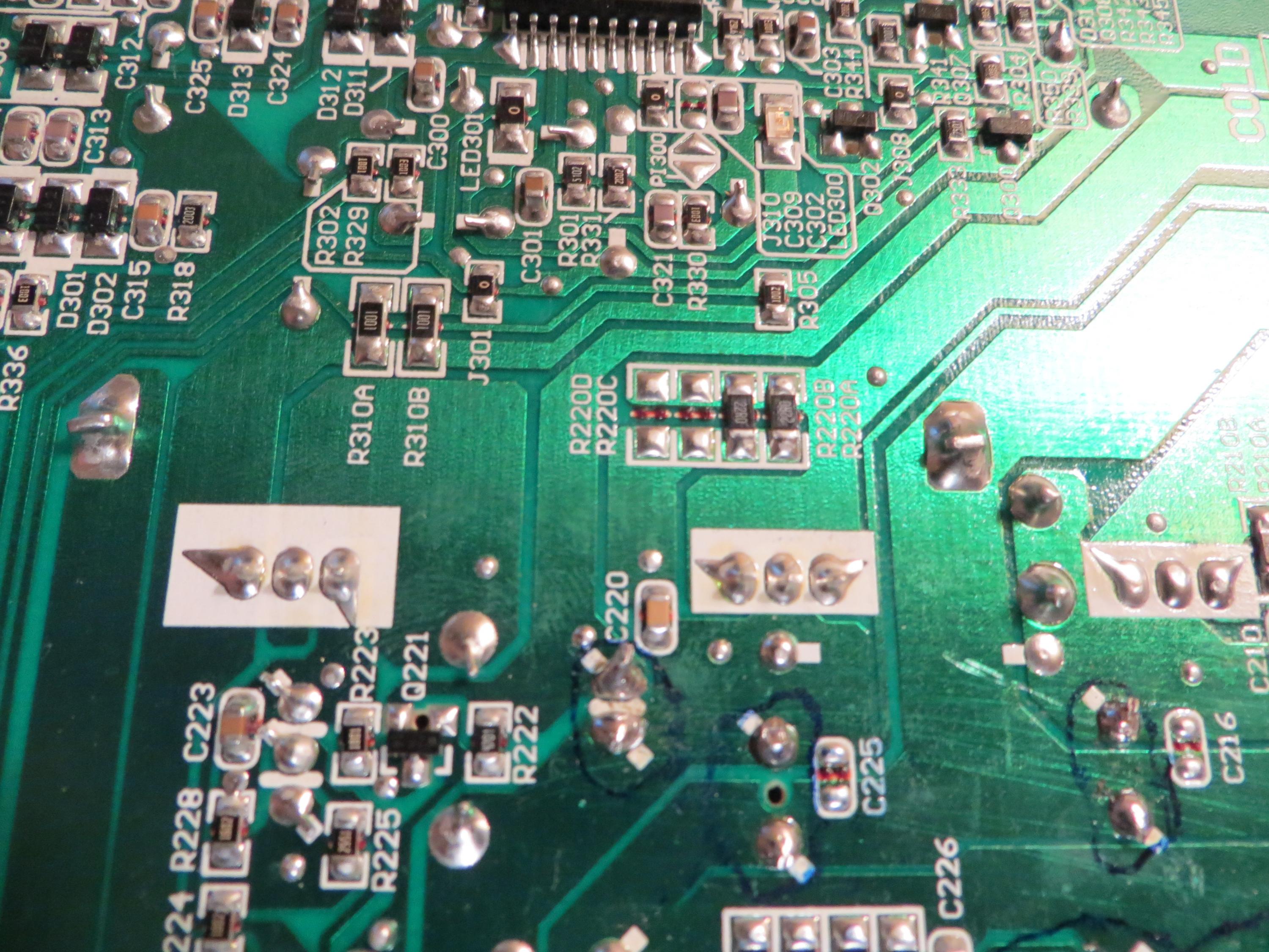

                                      #38
                                      Re: Jvc jlc32bc3000
                                      OK, there is 18.7V on the DRAIN, which is the input, but only .1V on the SOURCE (output.) In order to turn on it needs at least 4V more on the gate than the source. I am confused why the output is 18.7V but it could be because it is not connected to the capacitors or the main board is not loading it down.
                                      Can you get a closer shot of the traces around the 40N03? Try taking the picture from another angle... I need to see where the traces go.
                                        #39
                                        Re: Jvc jlc32bc3000
                                        Ok here you go
                                          #40
                                          Re: Jvc jlc32bc3000
                                          OK, I think I understand the design somewhat. Next question do the pins on the 40N03 change state when you press the power button?
