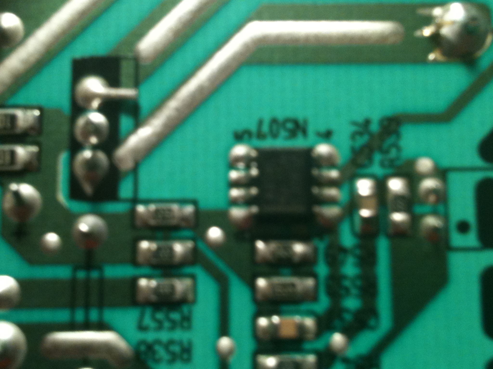

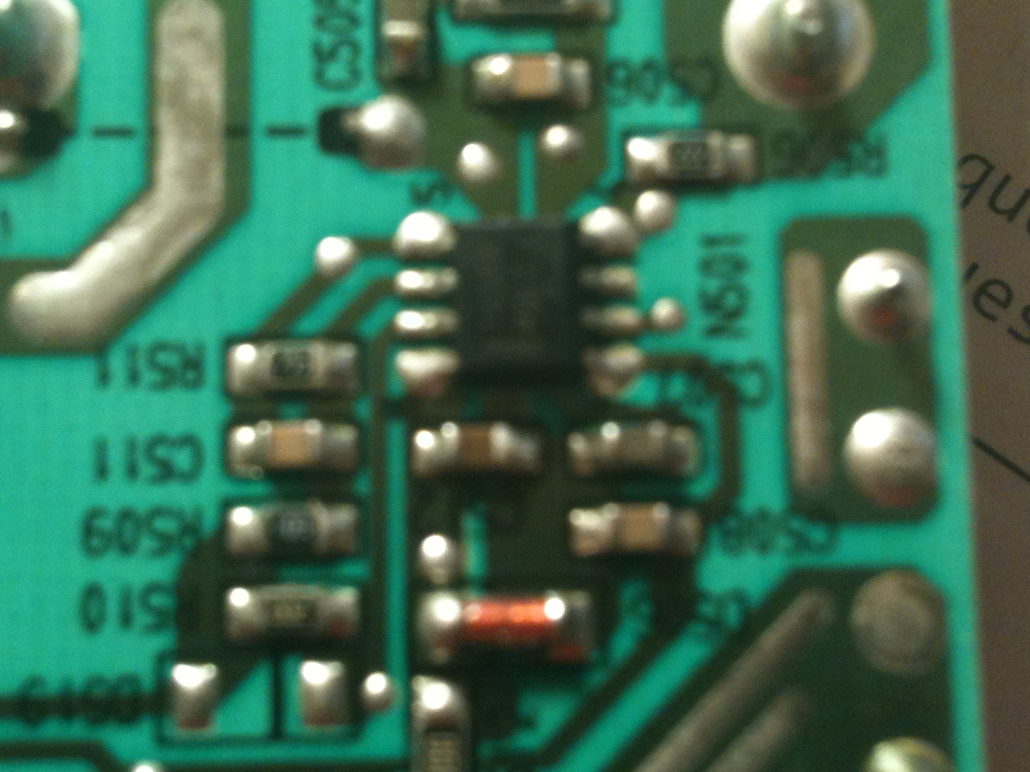

                                Re: No Picture or Audio on Insignia NS-LCD26
                                Here are some closeups
                                • adlegs
                                  • Sep 2012
                                  • 29
                                  pic 1170 - 165A
                                  PDLC
                                  pic 1169 - 431AC
                                  (TI emblem) 75M
                                  CJ06 G4

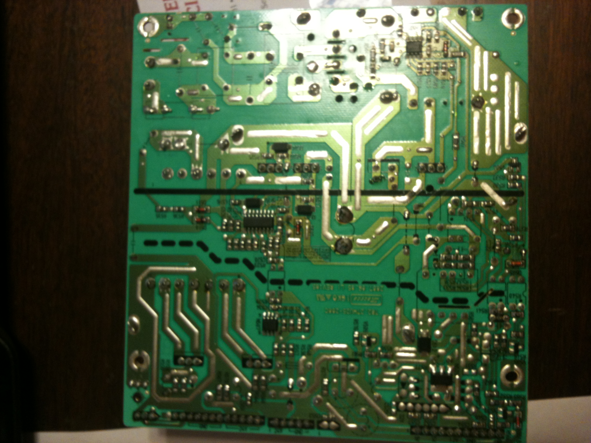

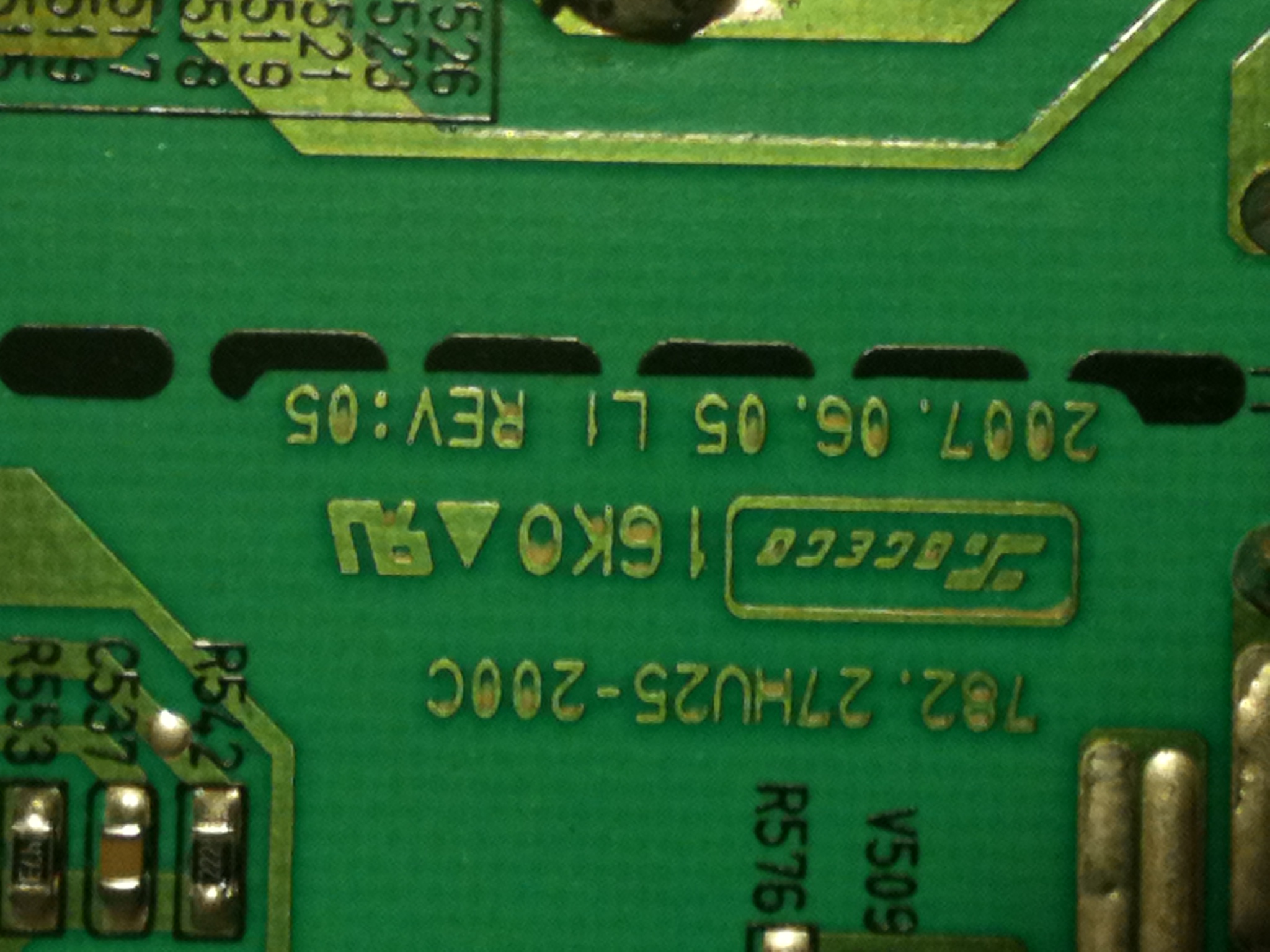

                                      Can we see good clear pictures of both sides of the power board? Also, what is the full model number of this TV, Insignia will have the main model number and follow by the - xx for the year.

                                        I am checking the voltages your suggested now. Did the pics I uploaded help you?
                                        If it was a fuse blown does the fuse reset? I have heated the video chip 3 times in an attempt to reseat the chip and each time the TV works but only for a few days then no video. The TV sounds like it powers on and I get a green power on light but I have to hold the power button for 5 seconds to turn it off. If a fuse was blown wouldn't it stop working for good until the fuse was replaced?
