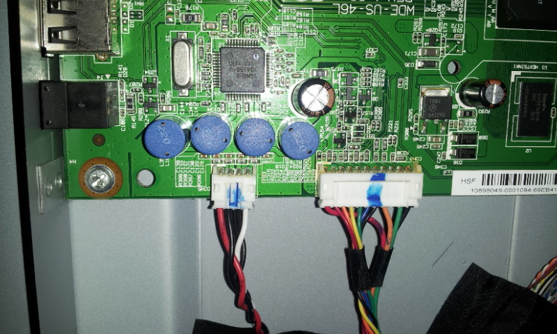

                #127
                Re: Westinghouse LD-4655VX - My First LED
                Please, please, please, help! I found the same problem as described on this post and I did replace both ribbon cables on my tv. The problem is that the tv still doesn't display anything! I even ordered a new board and power supply and still nothing. I do get the red light indicating there's power when I try powering it on with the remote but still nothing displays on the darn thing. I try disconnecting one side and power on, nothing. Next side, power on, nothing. Seems everyone's have fixed theirs with just the cables. Mine's being stubborn. Anyone else with ideas? Thx in advance.
                  #128
                  Do you see burn marks on the main board, where the panel LED connections go out?
                  • cejaslocas
                    • Jul 2013
                    • 3
                    • Puerto Rico
                    #129
                    Not quite. Neither on mine nor the new board I ordered. Unless I'm missing something. Pls look at the pics, let me know. Thx for your reply.
                    • cejaslocas
                      • Jul 2013
                      • 3
                      • Puerto Rico
                      #130
                      Anyone??

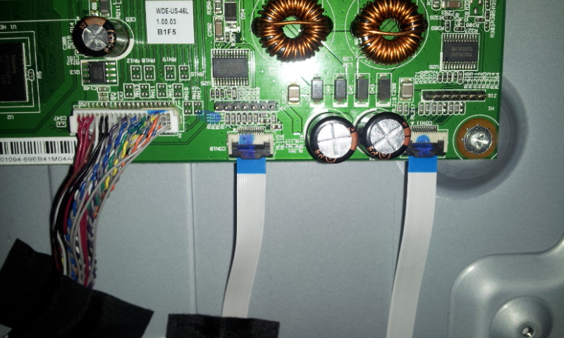

                      • paul85
                        • Apr 2012
                        • 13
                        #131
                        Fixed one of these last night. Had to relocate the left cable a couple times but it moves quite a bit under the panels so it wasn't that bad. I used diagonal pliers (dikes) to snip the cable clean and then attempted to use a dremel with the sanding bit on it, but kept cutting through the traces. I then put a wire brush end on the dremel and, at lowest speed, was able to carefully burnish off enough of the plastic to expose just the traces in the wire. I then reattached the blue header (that gives it the friction to hold into the fitting on the LED panel, and reinserted it. Voila, all lights work. I did manage to crack the led header wire holder, but I put a couple drops of superglue on it to hold it in place and after putting the whole thing back together, its still working great.

                                • tibimakai
                                  • Jan 2012
                                  • 3680
                                  #136
                                  I have just cut them and by hand I have sanded them down. Then, I relocate the ribbon cables, to reach the connectors.
                                  • ecking767
                                    • Oct 2009
                                    • 492
                                    #137
                                    I will try that tonight, I was using a razor blade, trying not to cut the wire, but end up doing so. I have a dremel tool with the sanding wheel, I might go that route too.
                                    • tibimakai
                                      • Jan 2012
                                      • 3680
                                      #138
                                      You don't need a dremel. With a machine you don't "feel" what is going on.
                                      • ecking767
                                        • Oct 2009
                                        • 492
                                        #139
                                        you probably right, I will get some light sand paper today and give it a try.
                                        • tibimakai
                                          • Jan 2012
                                          • 3680
                                          #140
                                          ...sand it from the ribbon, toward the cut area only. One way only.
