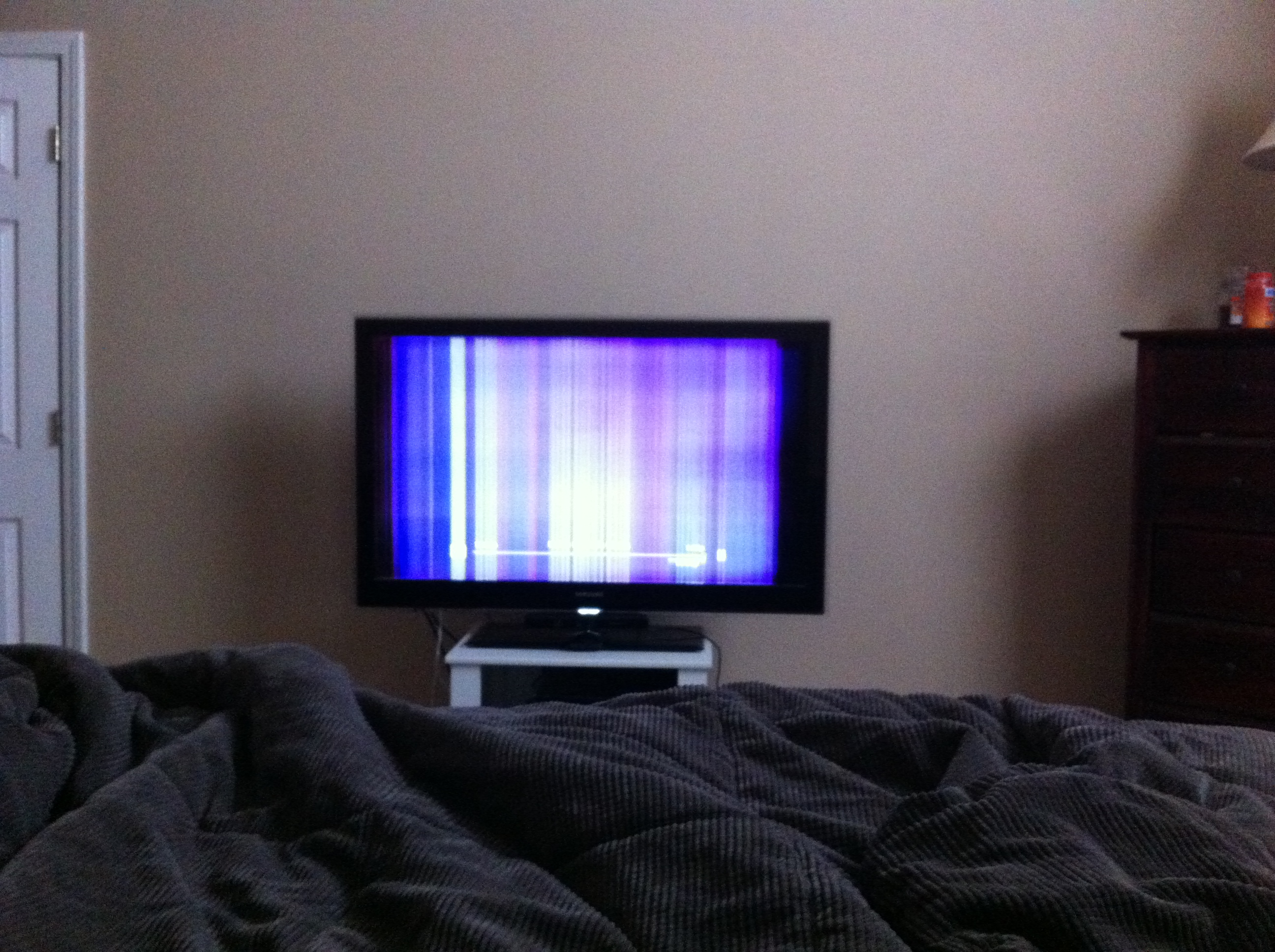

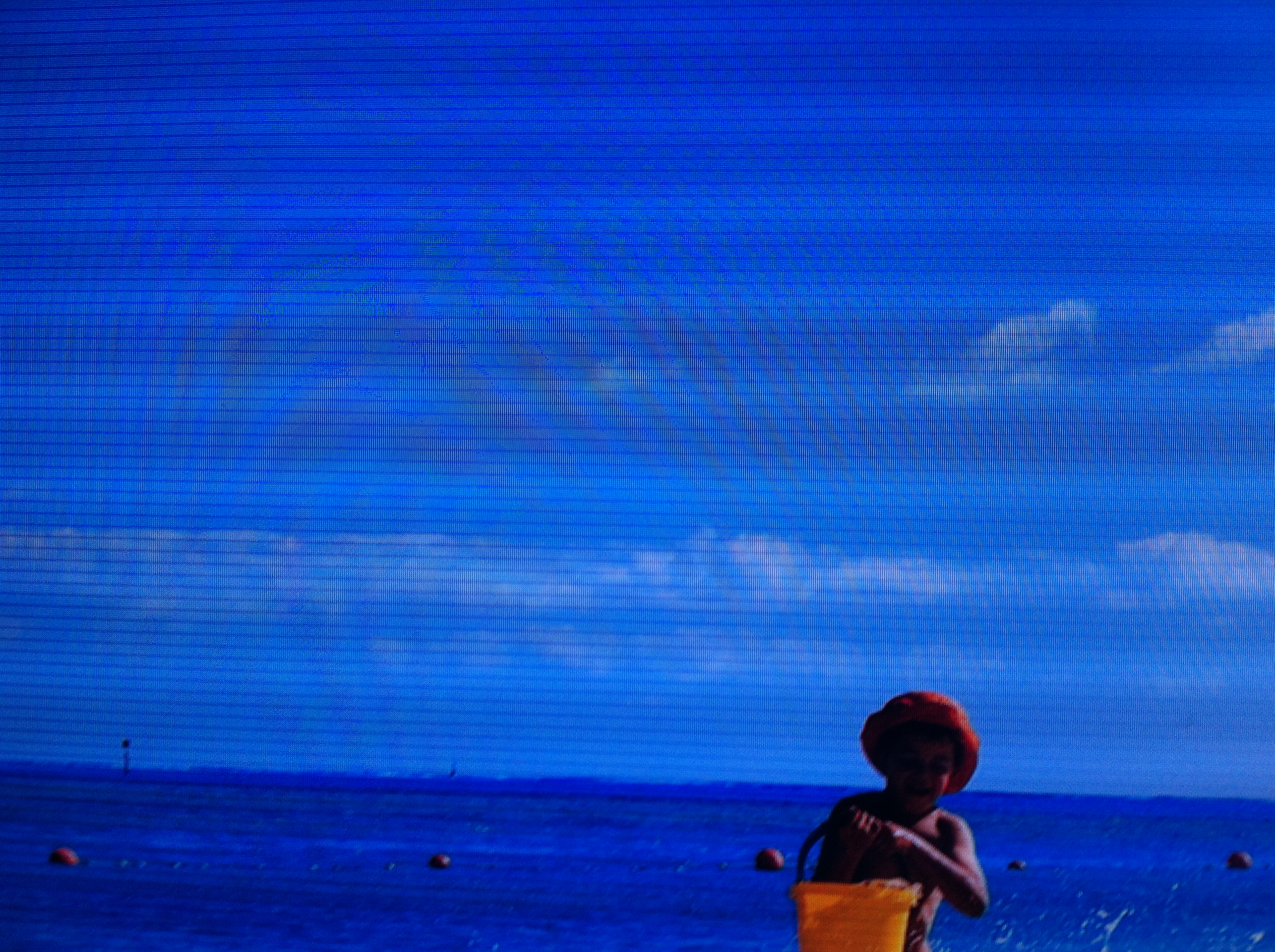

    I got a UN46B7100WFXZA, Samsung led, started with thin black horizontal lines, few days later went to white/red verticle lines. Can still see pic but looks bad, what can I check?? Please help only 3 yrs old(tv)

    here are some pics
      Re: Vertical white fading lines on Sams LED
      I would say T-con... common failure on Samsung TVs.
          Do the lines affect the menu, such as the setup menu or volume control?
          Do the lines fade in slowly, or suddenly appear? After appearing, do they stay as they are, or do they fade in?
            yes lines are shown on menu,settings, and all inputs.
            when first turn on tv it slowly fades in, then when watching the line fade on the left side and right side. but the white lines seem to stay. 2 days ago pic was great for only few hours but right back to line been like it since
              The only board capable of creating "fading" effects is the T-con, as far as I am aware.
              I found one seller for $56:
              http://www.ebay.co.uk/itm/Samsung-UN...#ht_1581wt_736
              That's a lot to pay - you may be able to get it cheaper elsewhere. Also, disassemble your TV and find the T-con to get the exact part code, it may be different.
                  I've had quite a few TV's where it seemed the T-Con was the culprit and that did not turn out to be the case. Without a scope could never determine whether it was the panel or main board but I suspect the main board in at least a couple times.
                  One case was a 26" LG, picture would freeze horizontally, sometimes a white screen. After heating up would work normally. Replaced t-con, same result. Sold lcd panel and power supply which worked for buyers. Last part left is main board.
                    Sometimes if there are bad caps in the psu, it can cause issues with the video processing. Too much ripple can cause errors and such in the processing.
                        i was just about to order the tcon from cali they told me it could be they panel is bad and to call back tomorrow to talk w/ a tech, does that sound right the tcon was 99$ which is a lot better than a 400$ panel
                            After talkin 2 another tech he was thinking it was the panel & not the tcon, does that sound right? Is the panel a common problem on a Sam. LED. Do u think it's worth trying a tcon 1st if not I don't believe it worth replacing panel due 2 cost... Any input would be greatly appreciative
                              It COULD be the panel, but that basically writes off the TV. Panel failures usually affect only one half of the picture, not the whole picture. A t-con would be a good gamble if you saved the TV and if you can get it cheap. (Usually, t-cons are around $20 each, so you might consider making the seller an offer on it - it's worked before for me.)
                                its definitely a bad panel. it looks like it anyway. panel failures affect any portion of the screen whether partial or all of it.
                                Especially if the picture ghosts its 99% bad panel. Its definitely a tossup, but im betting on the panel.
                                  This where I disagree. Most people would write this Samsung TV off with a bad panel:
                                  https://www.badcaps.net/forum/attach...4&d=1333908115
                                  Especially the repeating lines, affecting the whole screen? New T-con fixed it.

                                  This video is an example of a bad panel; the problem only affects half of the screen (AUO panel): http://www.youtube.com/watch?v=purk_SyiT44&feature=plcp
                                  Bottom line is, panel failures usually only affect parts of the screen or cause screen-wide ghosting. They rarely affect the whole screen with lines - that requires multiple gate-driver ICs on the tab bonds to have failed. Now, I have less experience with newer Samsung panels - so it could be different now.
