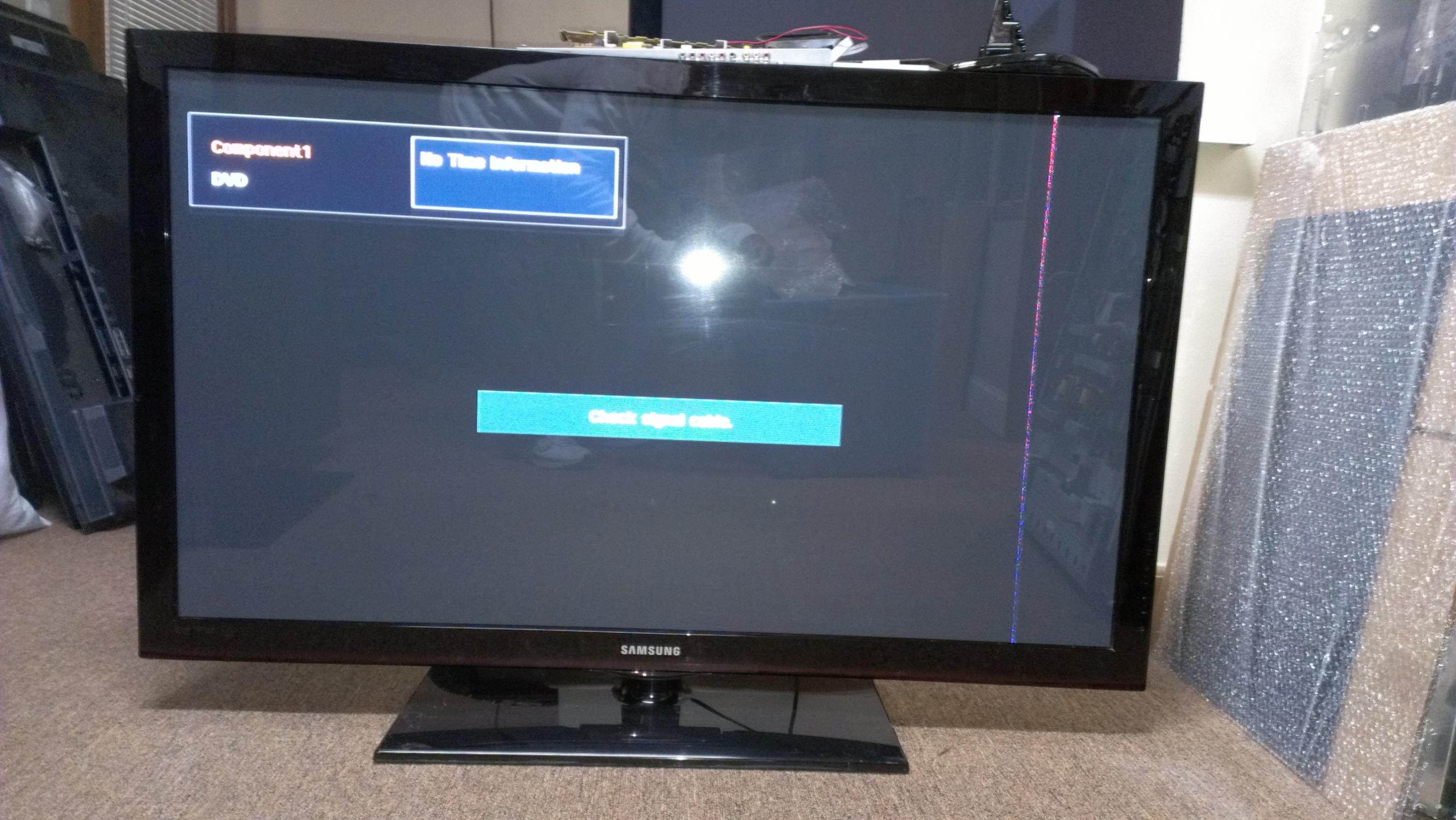

    Samsung PN50C450B1D Line in screen
    Need some help with this, other than the line the picture is perfect.

    Re: Samsung PN50C450B1D Line in screen
    My guess is a bad tab bond? Why? I just ran into this purple vertical line while installing "bump ons" into a Toshiba 46 inch TV. After fiddling with the "bump ons", the purple line went away.
      Might be a defect in the panel. I have an older philips with a samsung pdp panel that has a line on the right side in about the general area that your line is in.
        It's a panel failure.
          Yeah looks like it, I have 3 of these 2 with a broken panel and I've swapped out every part in this one with the line and it wont go away.
