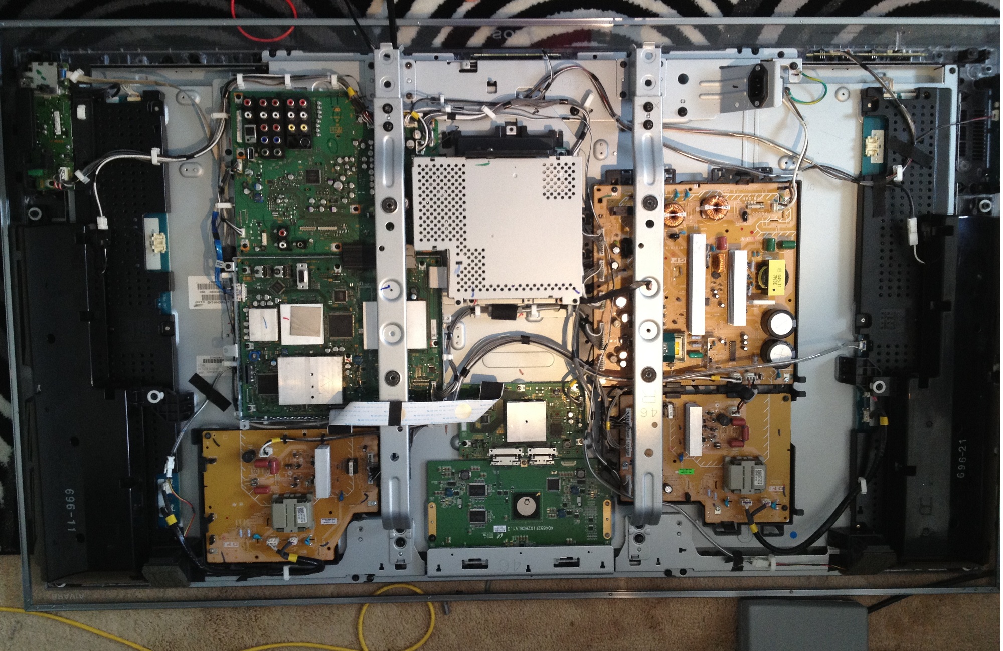

                            Re: Sony KDL-46XBR4 13 blinks
                            So just opened it up, and heres whats in it. I don't even know where to start! There are boards that I don't recognize. Which would be the balancer board? I'm about to disassemble everything down to the CCFL lamps and check those. I just learned that the "balancer" board is just the typical inverter board. Sony just calls it a balancer.
                            Been reading about the 13 light blink error online a bit and they all would say to replace the LCD panel itself if replacing the inverter (balancer) board does not work. However reading other articles, they say it is most likely a damaged CCFL lamp and the entire LCD panel should be replaced. No where mentions replacing the CCFL inside the LCD panel. Unless its not possible because there is actually no way to get into the CCFL lamps but I have not confirmed this. My guess is there is a damaged CCFL lamp.
                            My question is, Is it possible to replace a CCFL lamp within the LCD panel? If its possible I don't find much information about it online, is it very difficult to replace a CCFL lamp?
                              Left and right blue boards.

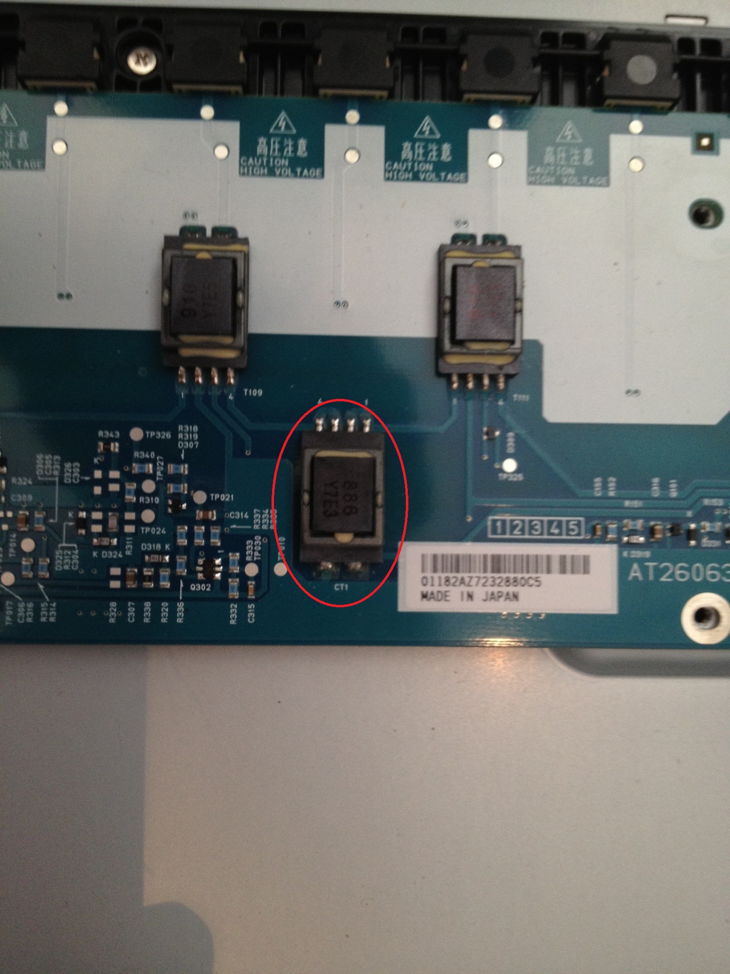

                                      I was measuring all the resistances of each transformer. All measured around 2400 ohms but the one i circled measured 0.04 ohms, however its a different transformer than all the others. The one I circled is labeled: 886-Y7E3, and all the other transformers are labeled 910-Y7E5. Would the circled transformer be short circuited? I measured out of circuit and got the same readings as well.
                                        That is a current transformer, different to the rest. It measures the power consumption of the backlight tubes as a whole. Not sure why, maybe some kind of lifetime balancing to increase the current as the bulbs get dimmer over time. Either way, it is unlikely to be the fault. I would expect 0 ohms.
