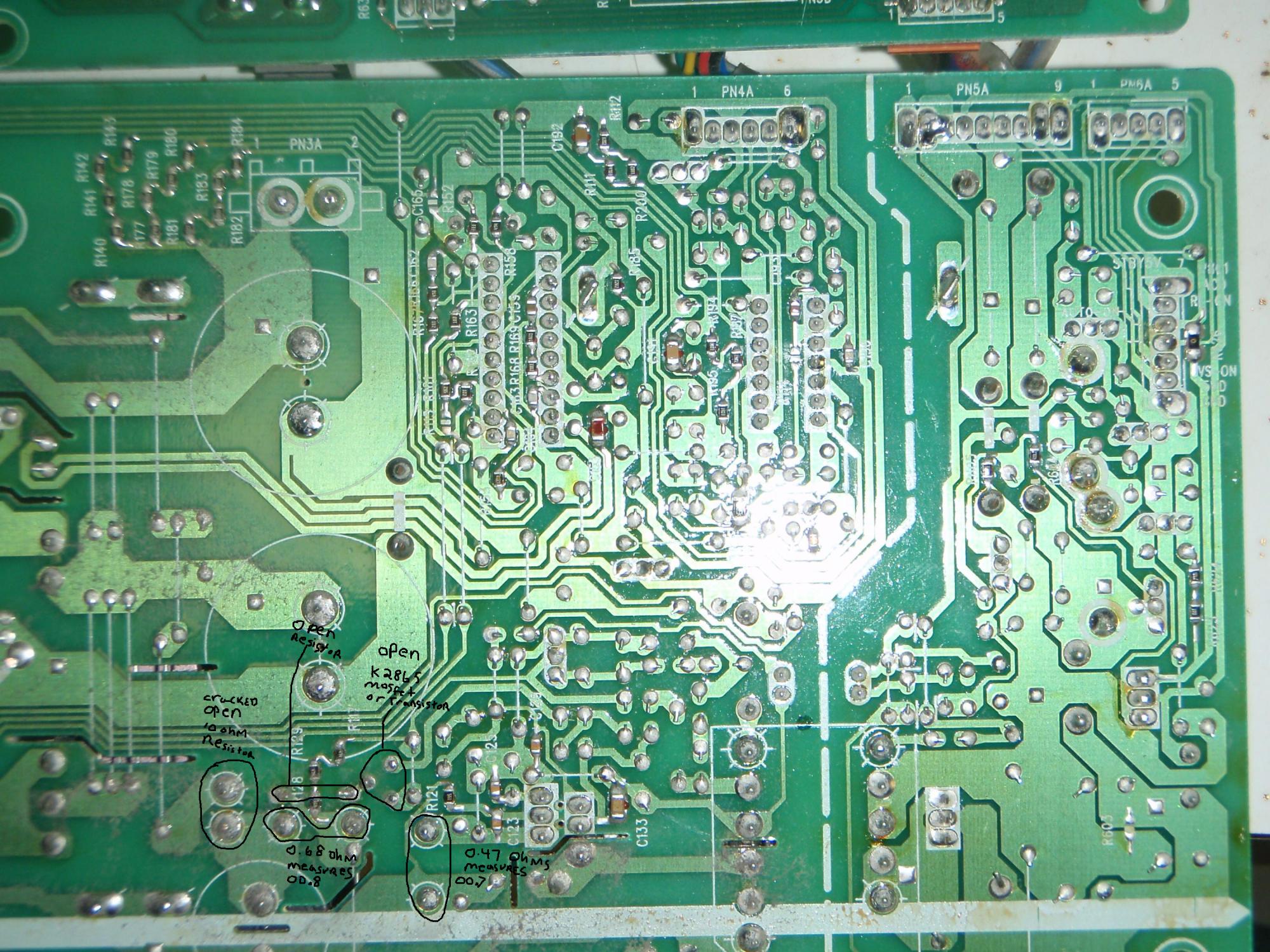

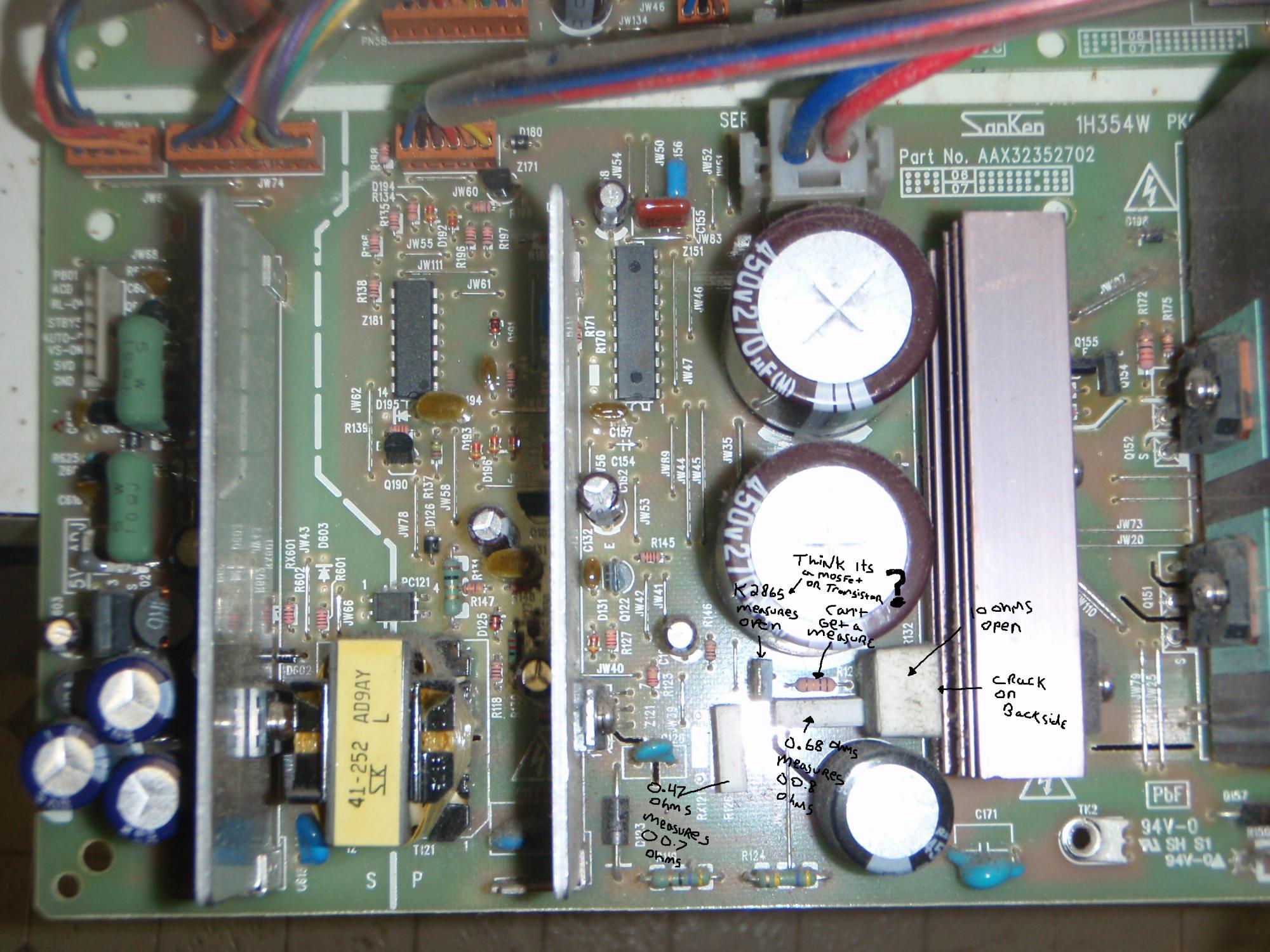

      Re: Vizio VM60P HDTV10A No signs of life except speaker pop when unplugged
      The ceramic power resistor is no doubt bad, it measures open and has a crack on the backside of it , i do question the nearby components , transistor shows shorted, the old school looking resistor shows open or can get a reading don't have a clue what its value supposed to be, its color bands supposed to tell ya. and the 2 little ceramic resistor seems to be out of tolerance. i added two pics maybe you can come up with a theory of what went wrong or its job in this part of power board. and i marked what is what. k2865 shows as a mosfet or transistor not 100% on what it is, however its shorted or just not getting a reading!! anyhow. thanks tom could use some help on what is what, or least a reconfirmation. again thanks i should have spotted this before i made a post but least it may help someone having same issue with same tv.
        The other resistors are likely reading what they do because your probes have some unwanted series resistance. Try with the probes touching, it will read something like 00.2 ohms, subtract this from your other readings to get actual resistance.
          did the probe together test it reads 00.3 ohms seem to be within reason?
            ahh makes sense thanks for the another tip, so those resistors are fine except the big 10 ohm and the best way to test the mosfet would be? just wanna make sure i am getting this correct on ohm 200 i read open on 2 legs and on one leg and back metal plate i get reading my dmm does have fet plug to test npn etc never totally figured the thing out. yeah i have lots to learn yet makes ya wonder how i manged to fix all those displays in the past but always learning..
                  thanks alot!!!!, ok the mosfet tests good so its just the one lonely cracked 10 ohm ceramic resistor gonna see if i have one if not will order provided i can find one.
                          well here is the update replaced the 10 ohm resistor made improvement, however we have a new prob area. i added a pic to show the area where it fried and i seen the flash i think we have a short in the upper power board er somthin how should i go about testing the area i marked in the pic and where the plug goes up to the upper power board kinda glad i left all the boards unplugged except the power boards cause it could have fried more.
                              in post 62 the k2865 looks to be a transistor not a mosfet as the testing guide i sent you try testing it again this guide seems good

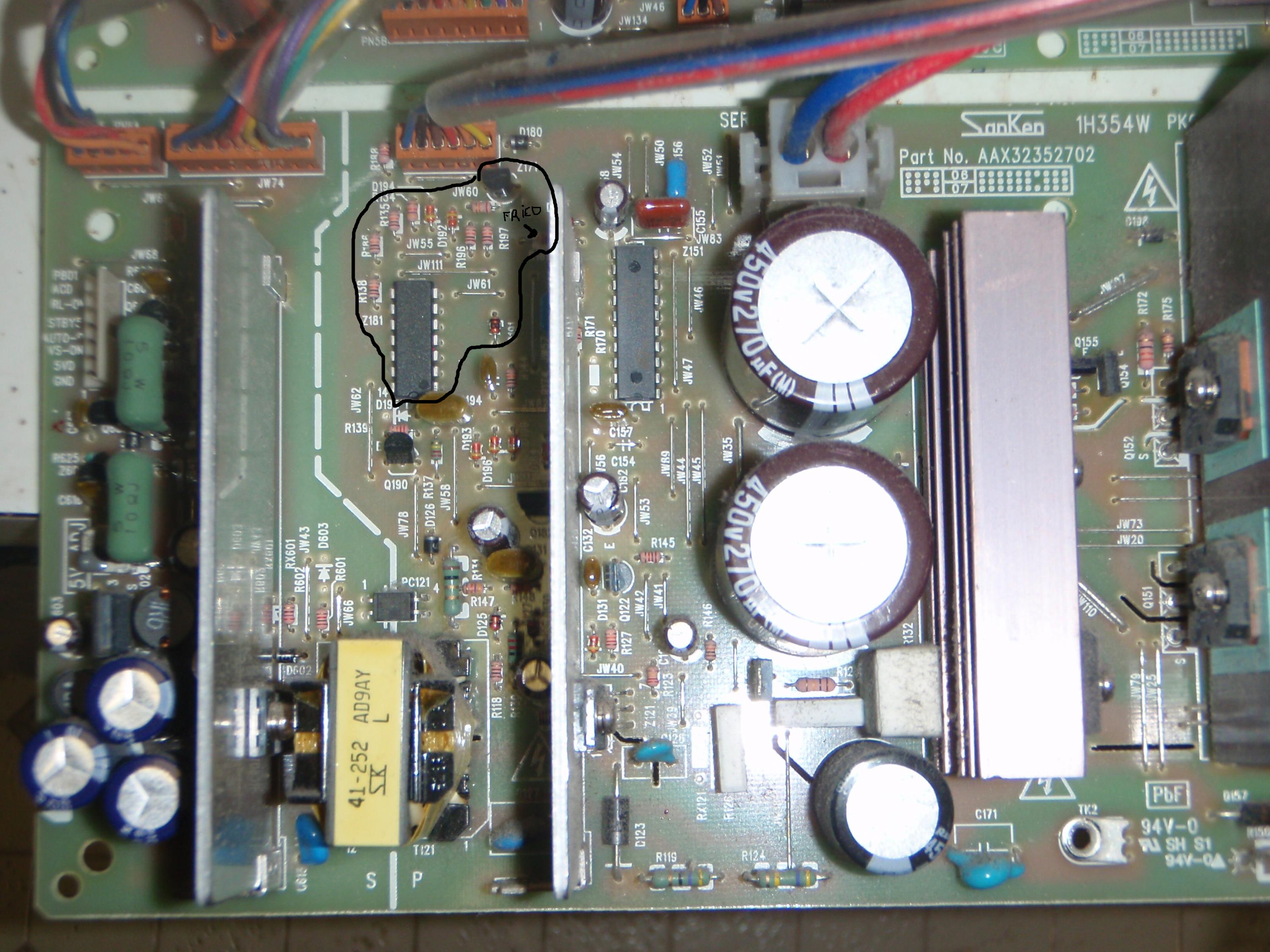

                                and i discovered that long ic within what i circled is fried too ugh...
                                  could be wrong just disappointed.... wg853p is the only thing on that heatsink on the opposite side looks like its a three phase control.
