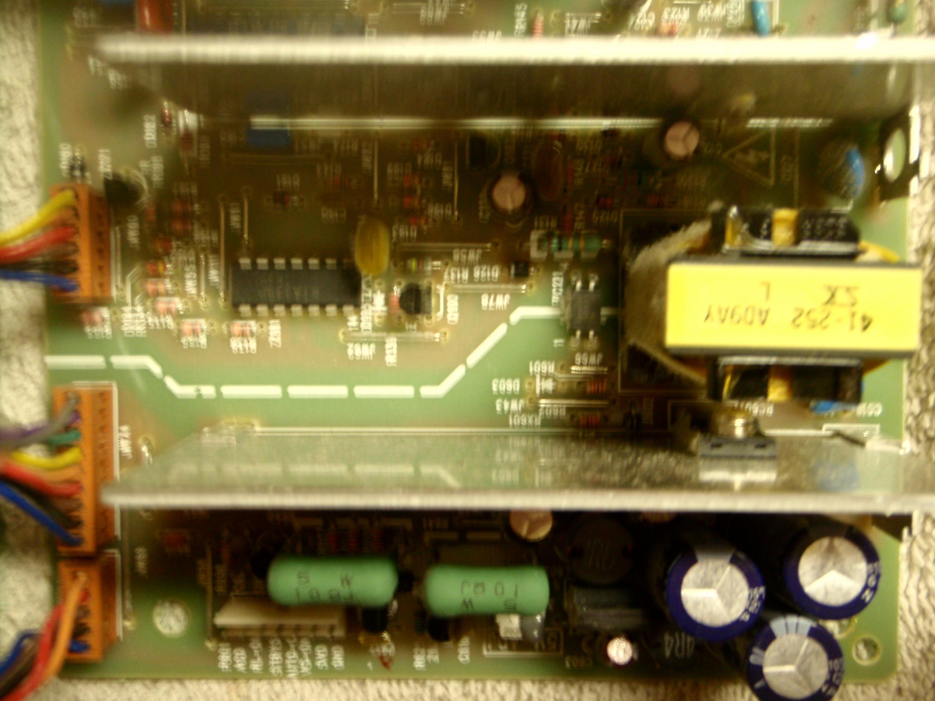

              OK the problem is the PSU is not turning on the relays so we have to look at the PSU.
              Need a closer pic or a listing of the labels on the connectors here.
              • heavymachines
                • Mar 2011
                • 1028
                #47
                Re: Vizio VM60P HDTV10A No signs of life except speaker pop when unplugged
                pin1 gnd
                pin2 5vd
                pin3 vs on
                pin4 auto on
                pin5 stby 5v
                pin6 rl-on
                pin7 acd (empty) not connected
                this connector goes to the mainboard
                  #48
                  OK check stby 5V. Try it with and without main board connector plugged in.

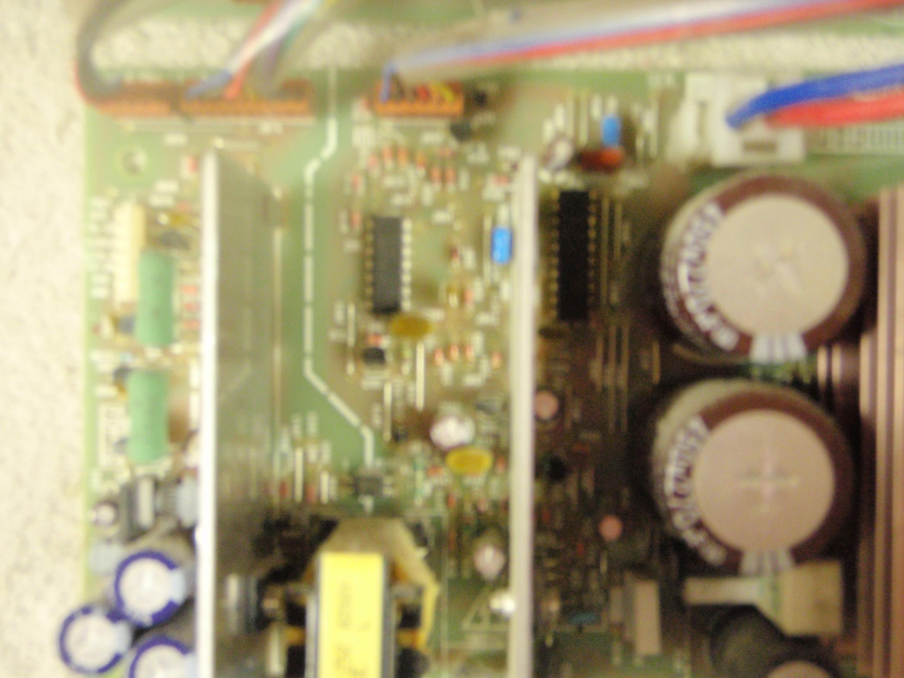

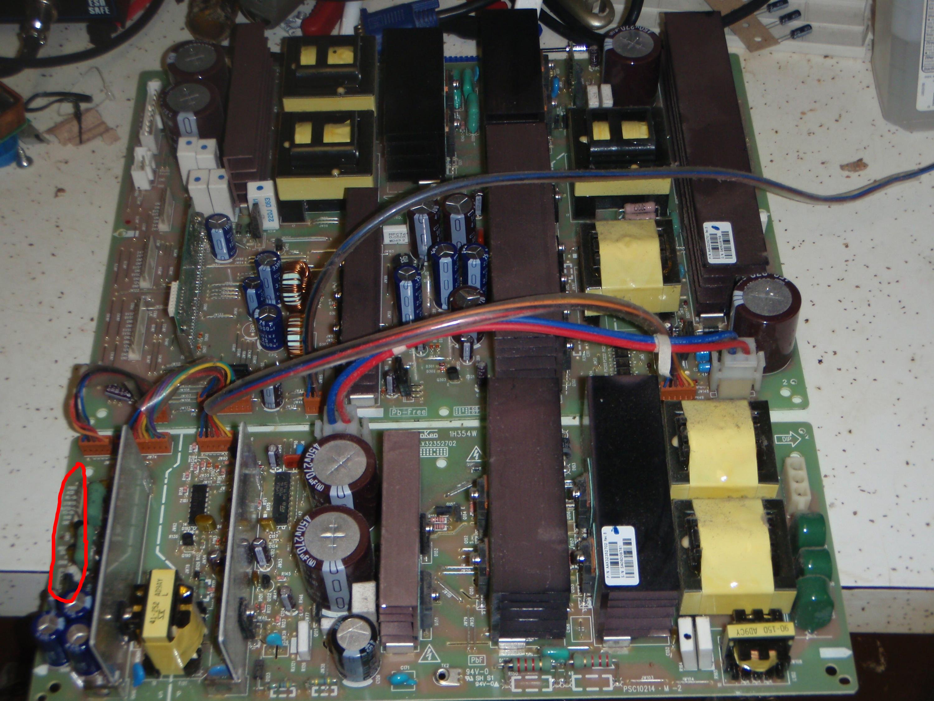

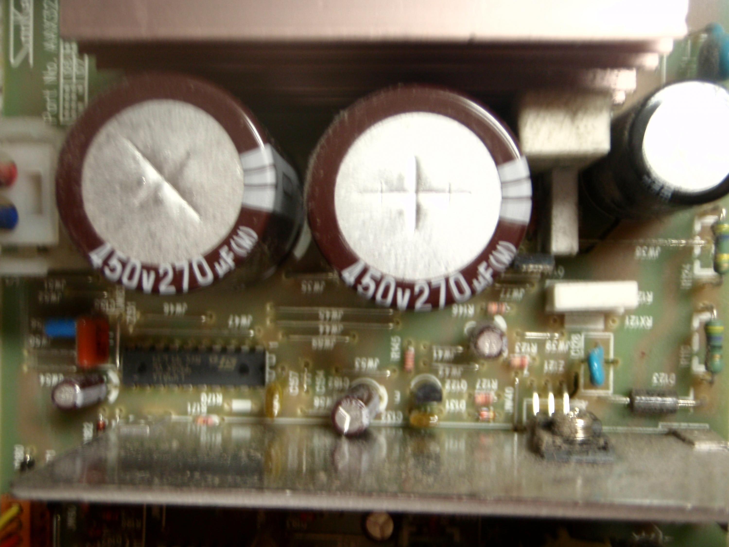

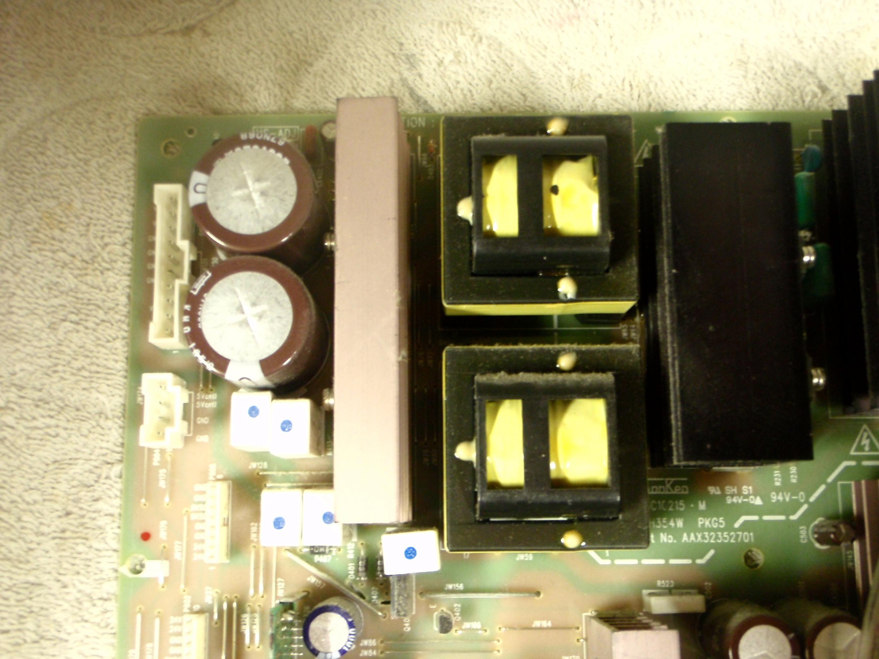

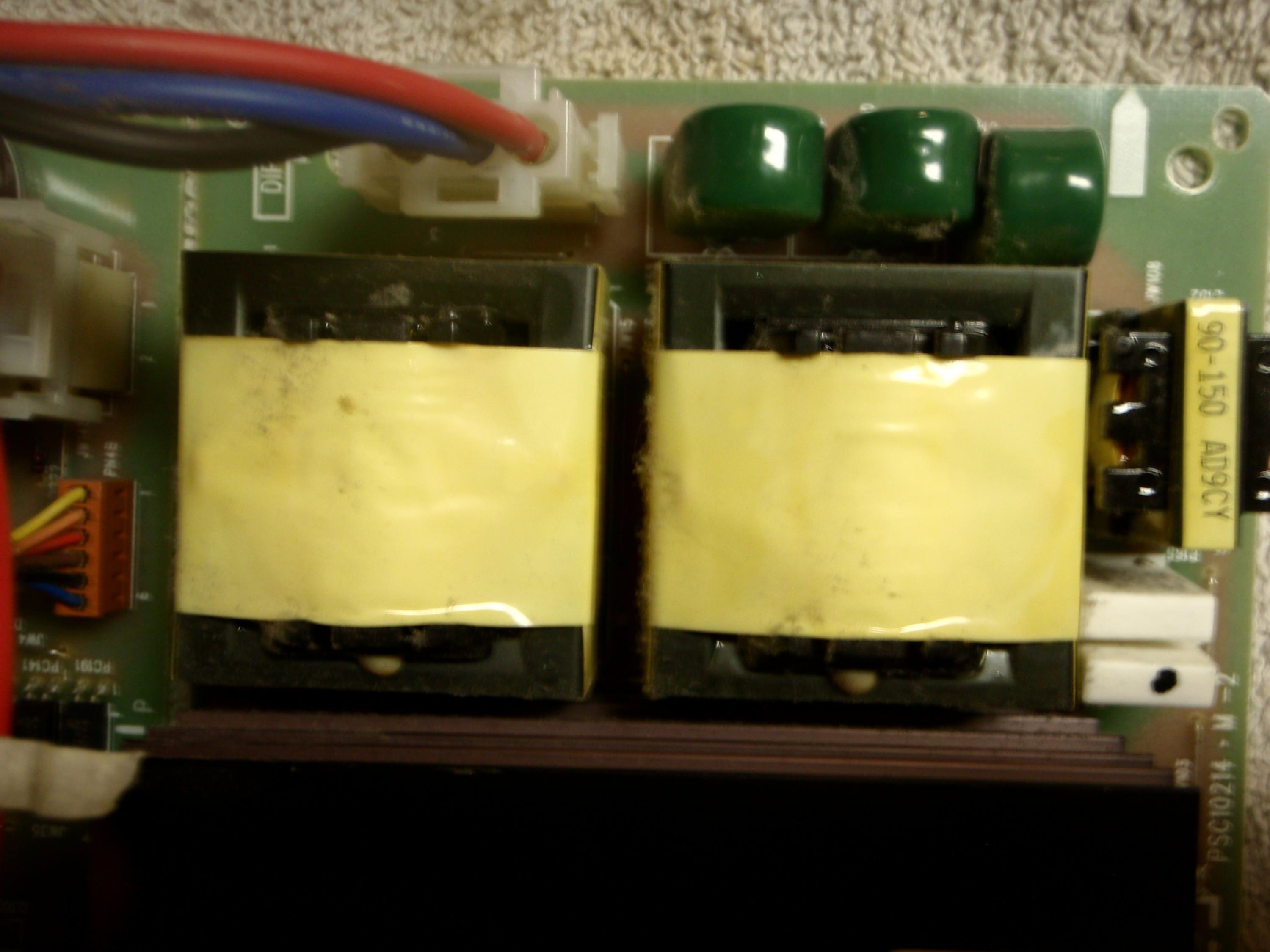

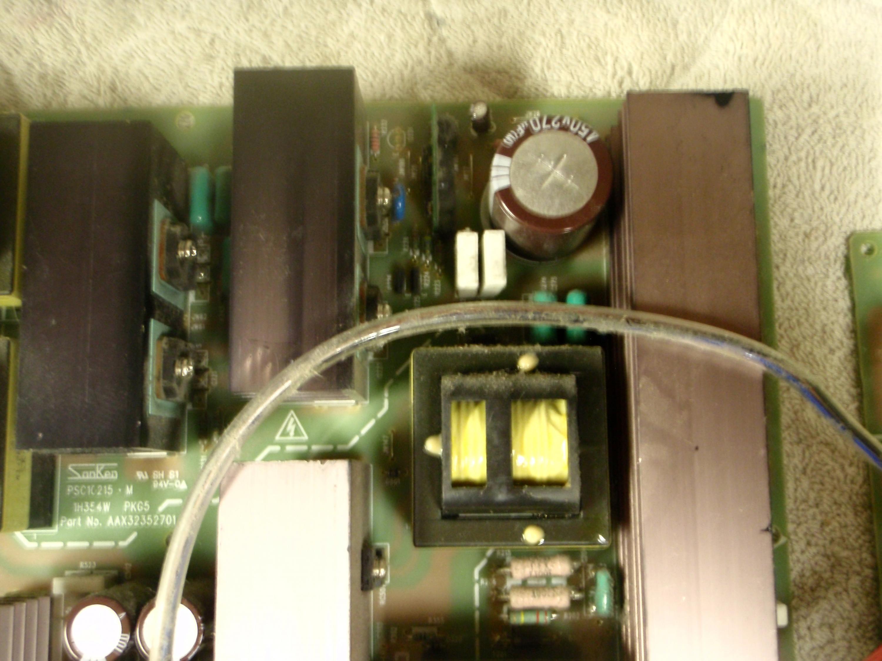

                    zilch nothing either way
                      #50

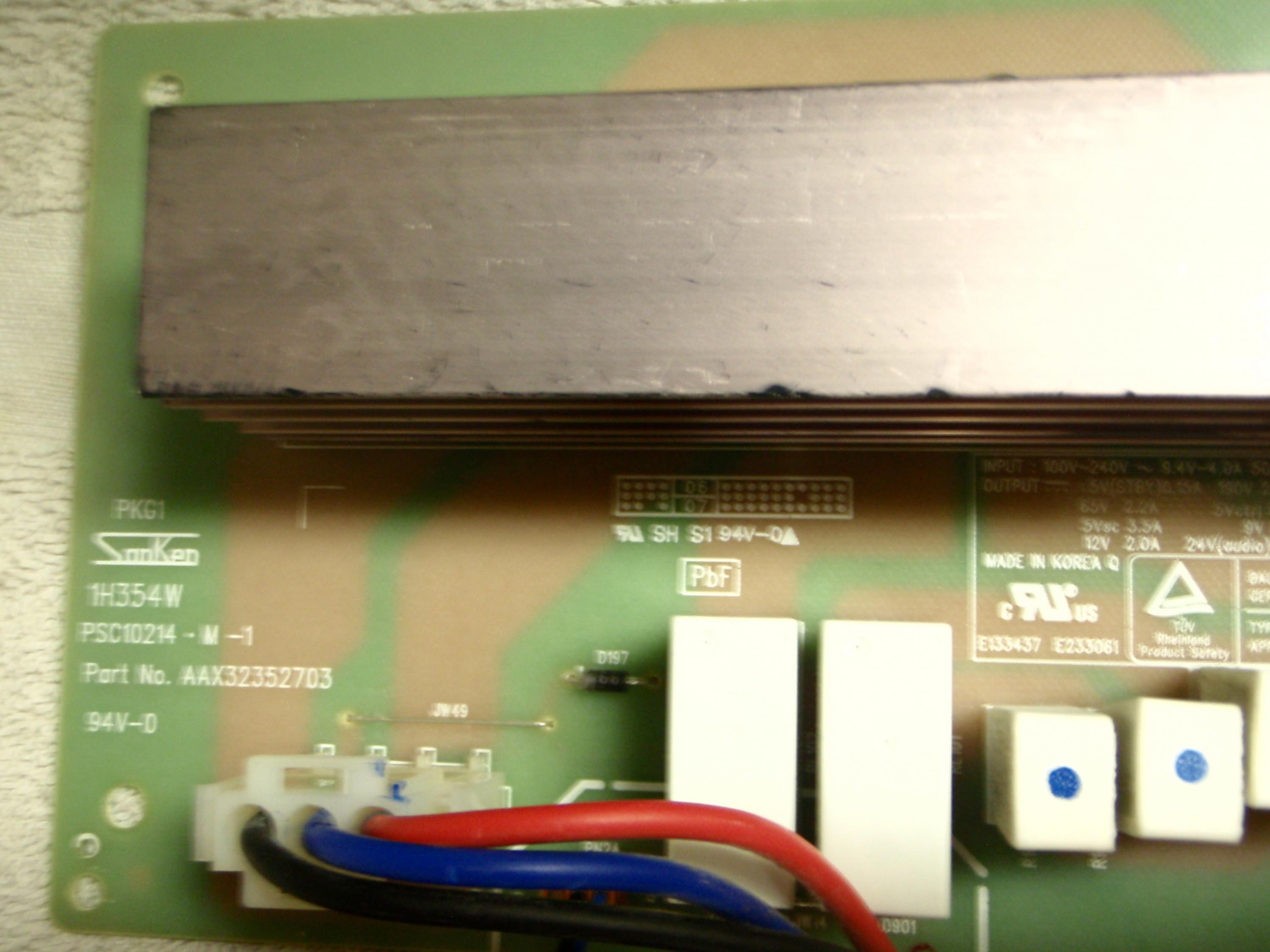

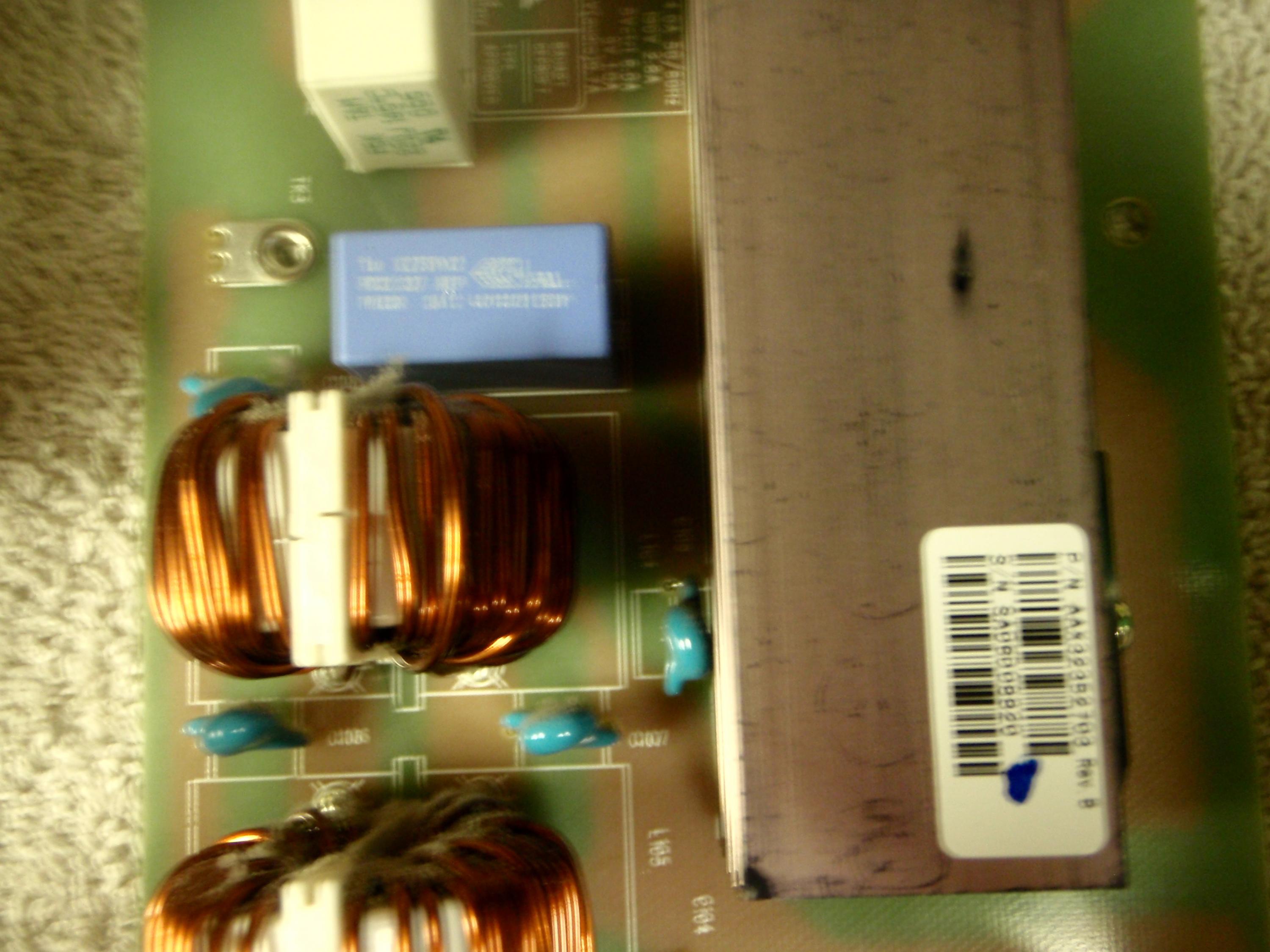

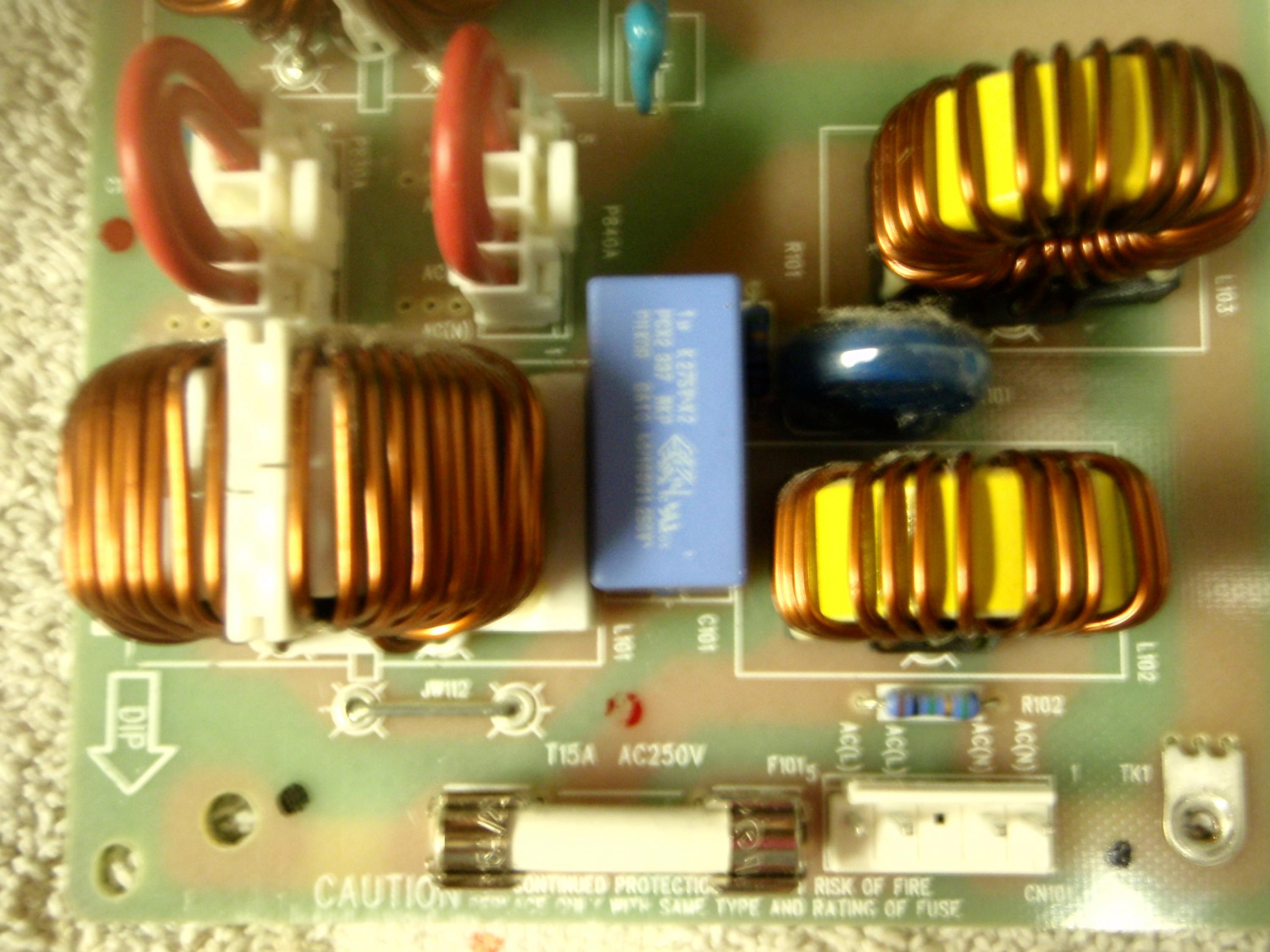

                      OK, that is sort of good, because it puts the problem pretty firmly on the PSU.
                      But I'm still not 100% on whether or not your mains input filter is working.
                      Probe the main filter connector coming from the line filter board to the sub PSU. Use black probe in the middle pin and red probe on both of the outer two, DC volts.
                      If you don't see anything, it might be a burnt fusible resistor - looks like there could be one on the line filter but it's hard to say.

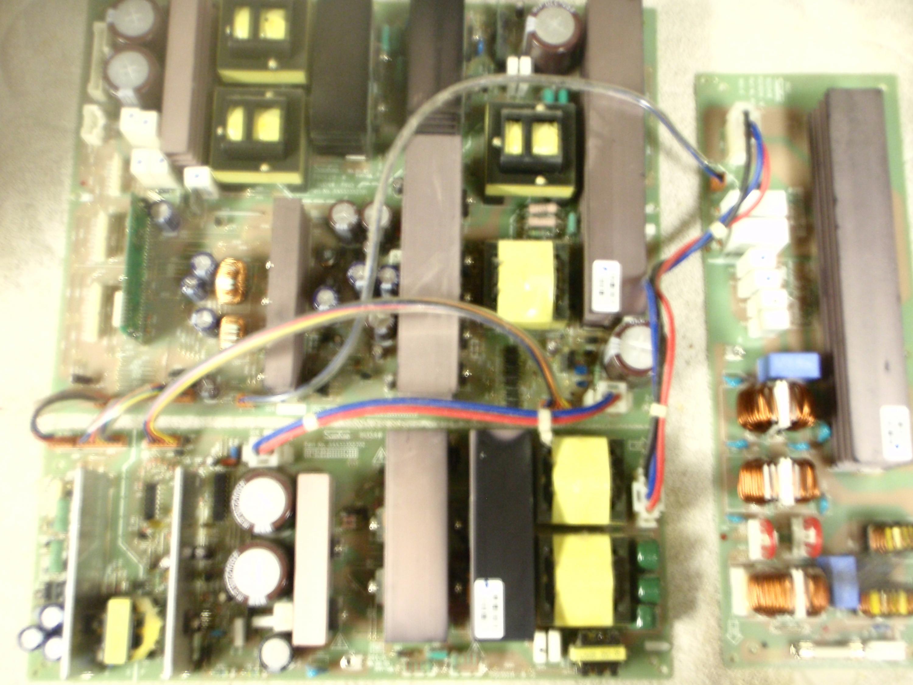

                      • heavymachines
                        • Mar 2011
                        • 1028
                        #51
                        okay i am home now and have the three supplies with me tv is too heavy to bring back n forth however is there any tests i can do without live tests for the night ? i can tell you the supplies put out nothing on none of their outputs on the left side notta.

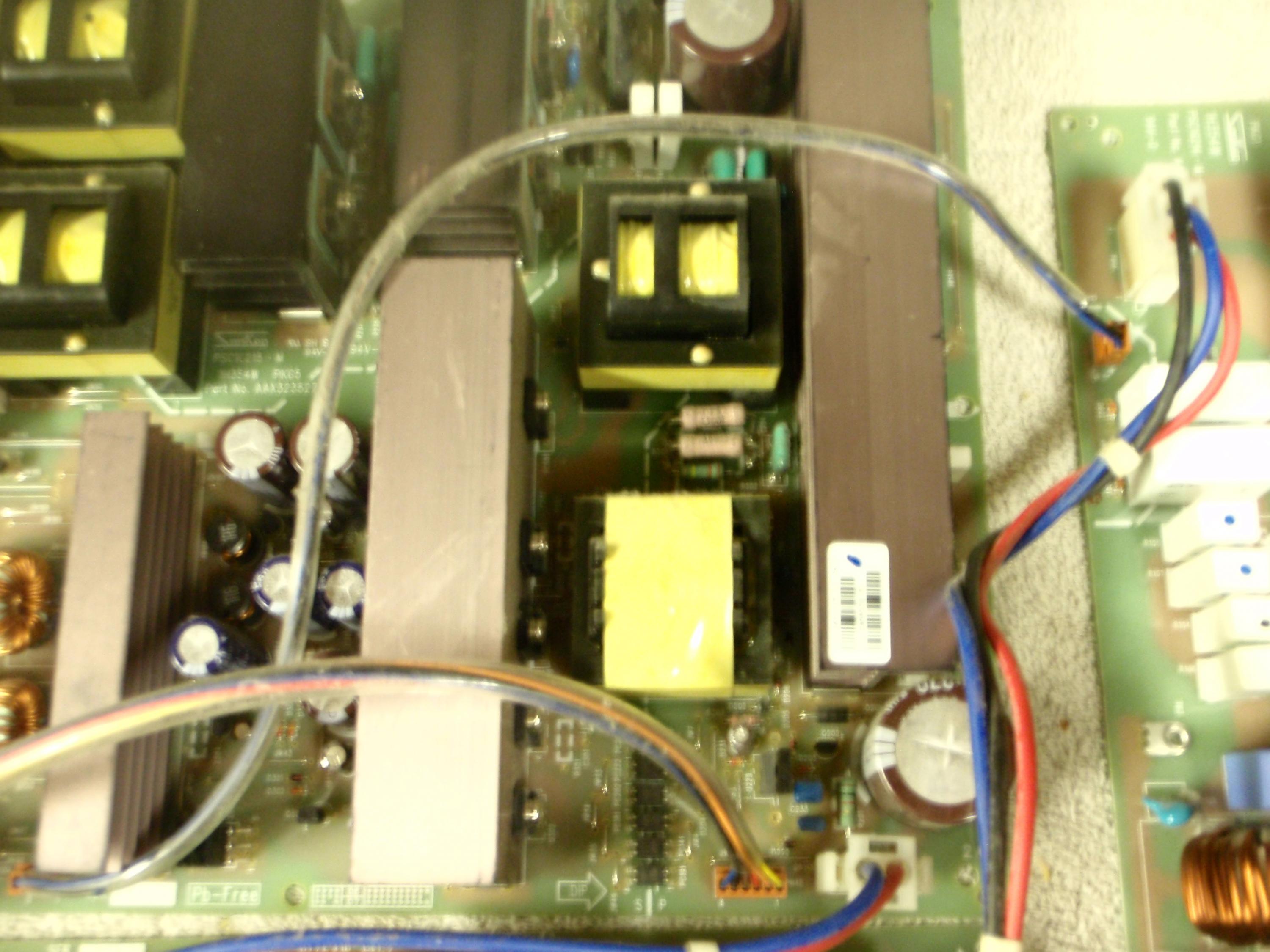

                              messed with camera hope these not the best pic's are better.
                              • heavymachines
                                • Mar 2011
                                • 1028
                                #55
                                also want to note there is nothing obviously burnt anywhere i can see...

                                  #56
                                  last one
                                      there are 2 resistors on the line filter board still havent done the last test yet will do that in the morning thanks tom for working with me btw my name is brian to properly introduce myself.

                                        #59

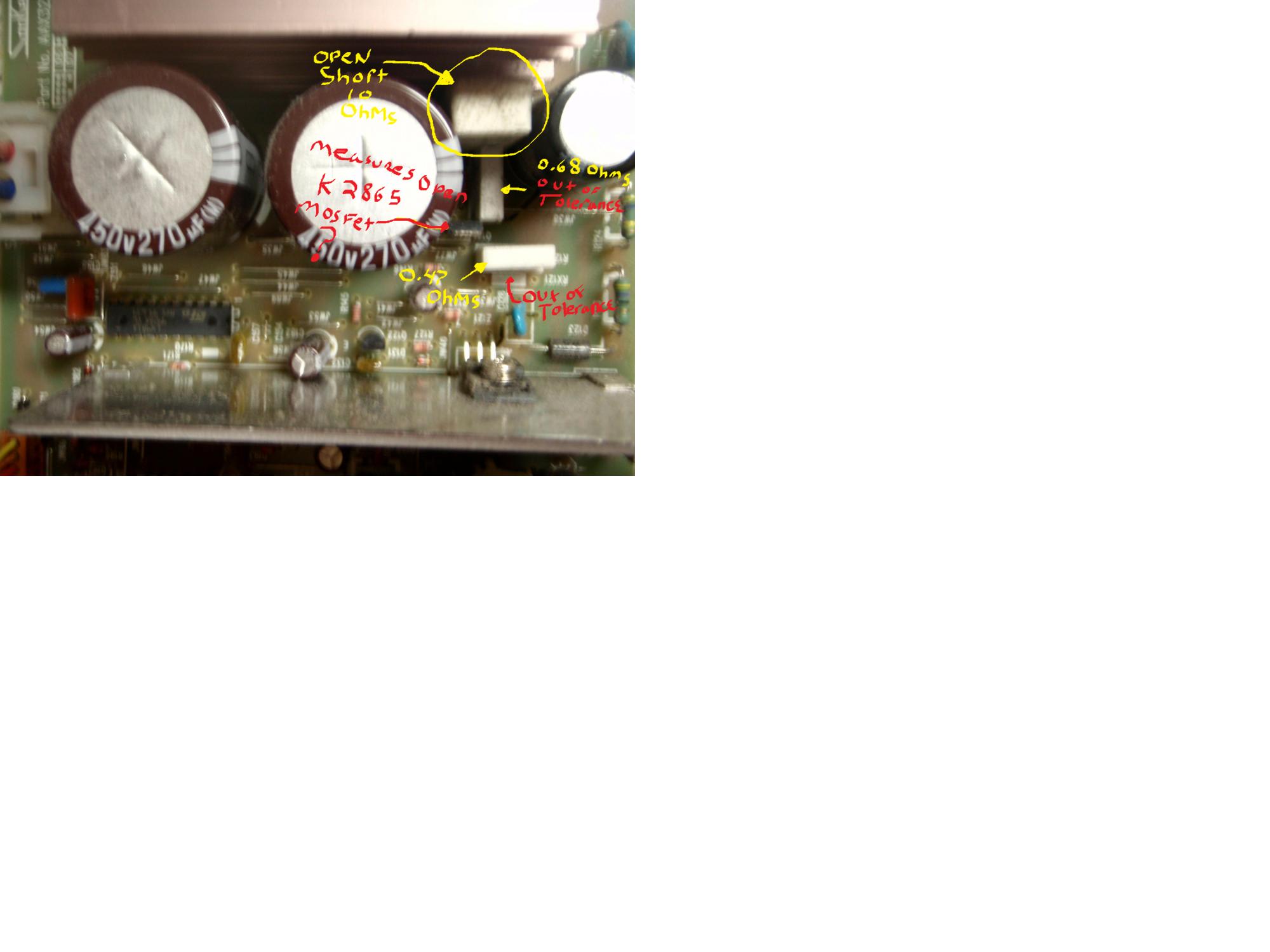

                                        Okay found part of the problem 10 ohm resister showing open circuit and pulled it and low behold it had cracks on backside that was butted up to the heatsink.
                                        and further inspection around same area has a k2865 n channel mosfet? not sure. Anyways it shows open as well. The 2 little resistors are out of tolerance shown in picture. gonna look around and try to get these parts. any advice on anything please do advise me thanks!!!!!. tom66 said something about a burnt out resister and i spent some time testing em all and Bingo!!!! not in the clear yet but will order what i know for sure and the mosfet i question about what it is, any suggestions or confirmation would be appreciated. Thanks again tom66 u made me think, and it seems to be paying off.
                                          http://www.ebay.com/itm/1pc-of-2SK28...item1c2a4ed530
                                          i am certain this is it correct me if you will thanks..
