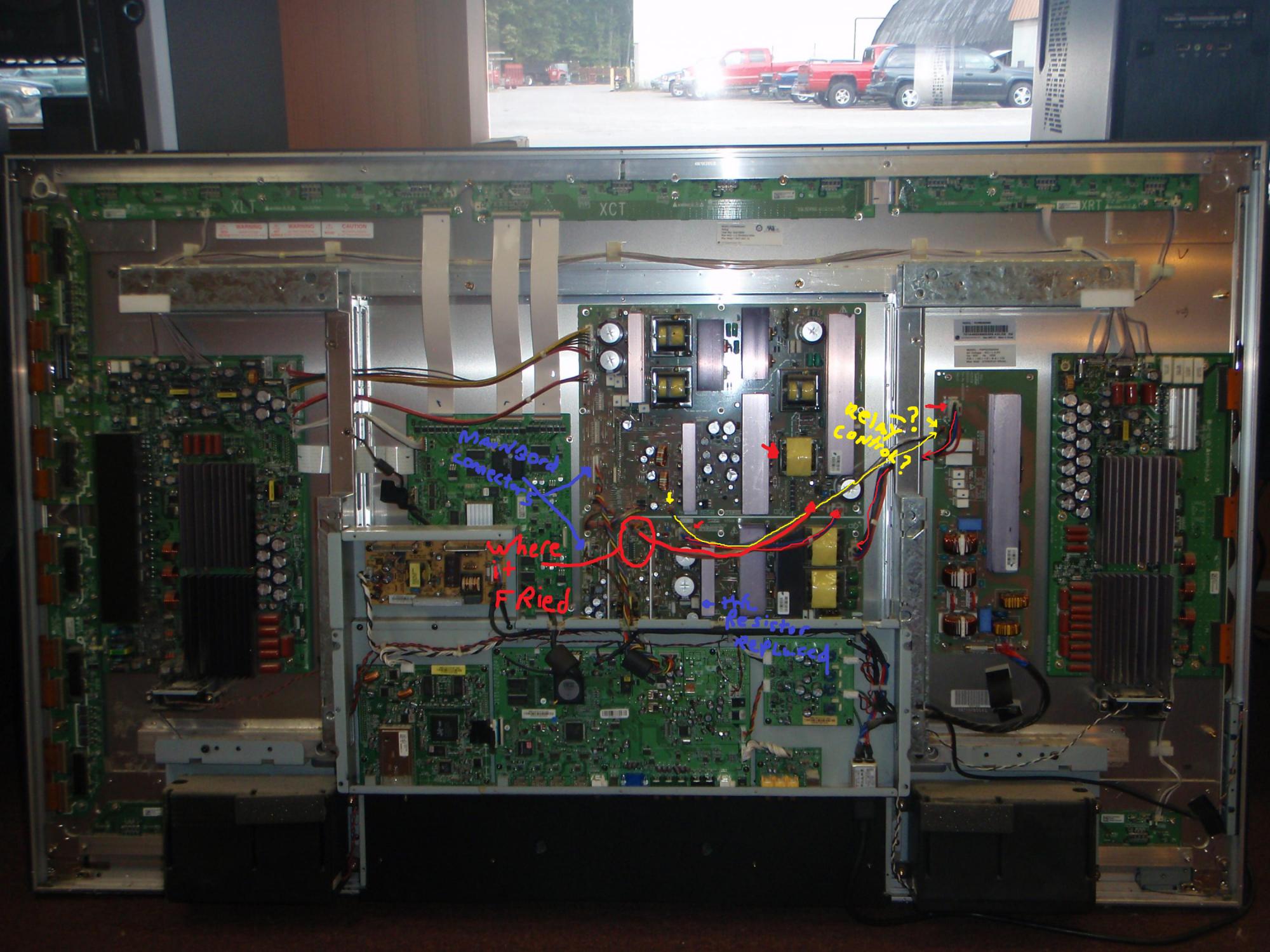

                                      #98
                                      Re: Vizio VM60P HDTV10A No signs of life except speaker pop when unplugged
                                      perhaps i drew this out to give u a good idea how i think it works please correct me, and yes i think that may be a good idea.
                                        #99
                                        I think you've got it nailed. The red/blue connector going from the small board to the larger one (not the line filter) should be OK to disconnect and try the TV without temporarily when the lower board is replaced/repaired.
                                        • heavymachines
                                          • Mar 2011
                                          • 1028
                                          #100
                                          so just leave the high voltage disconnected from lower to upper and the low voltage connected, that may work, just leave the one high voltage from the filter to the lower connected.
