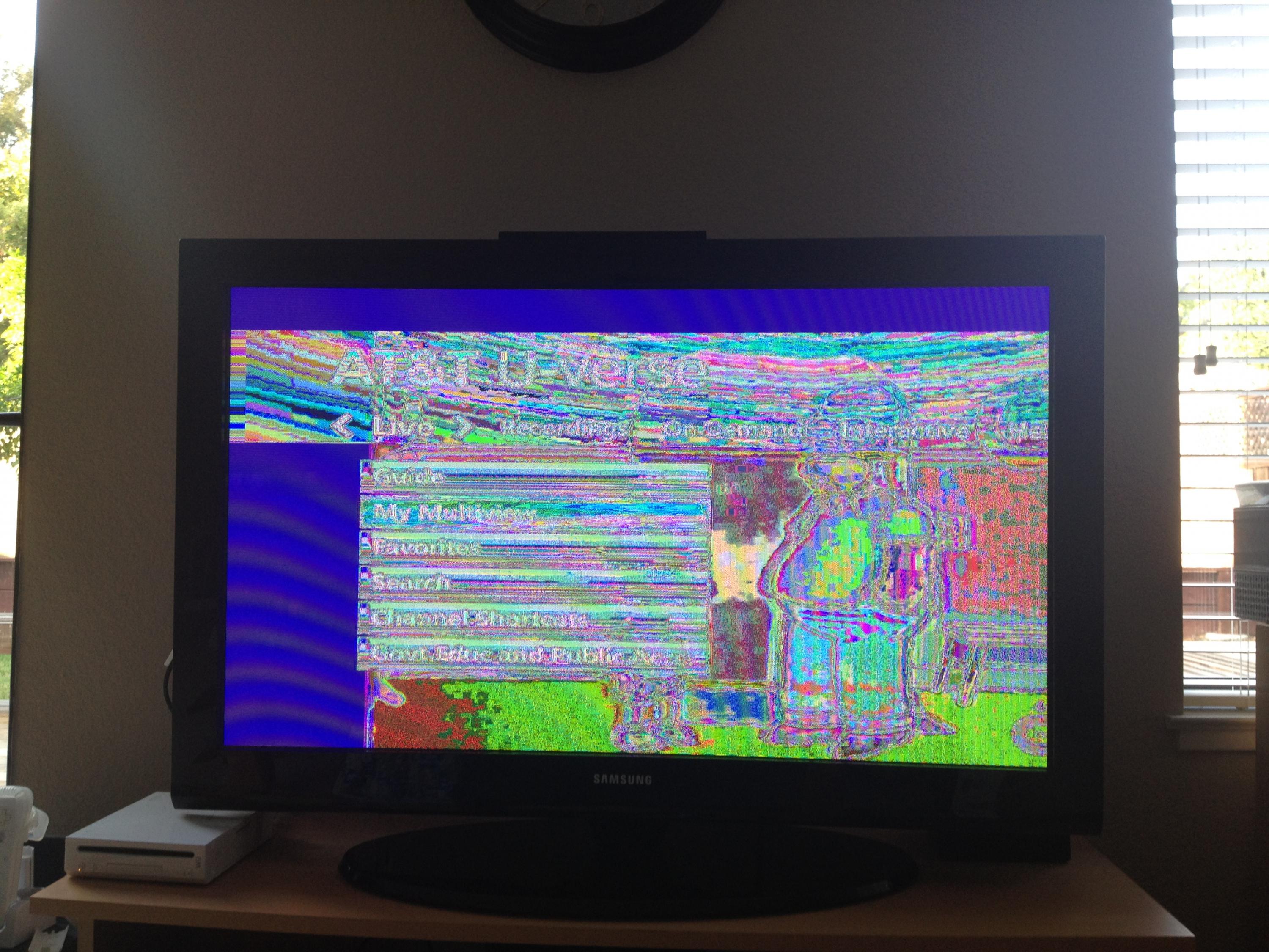

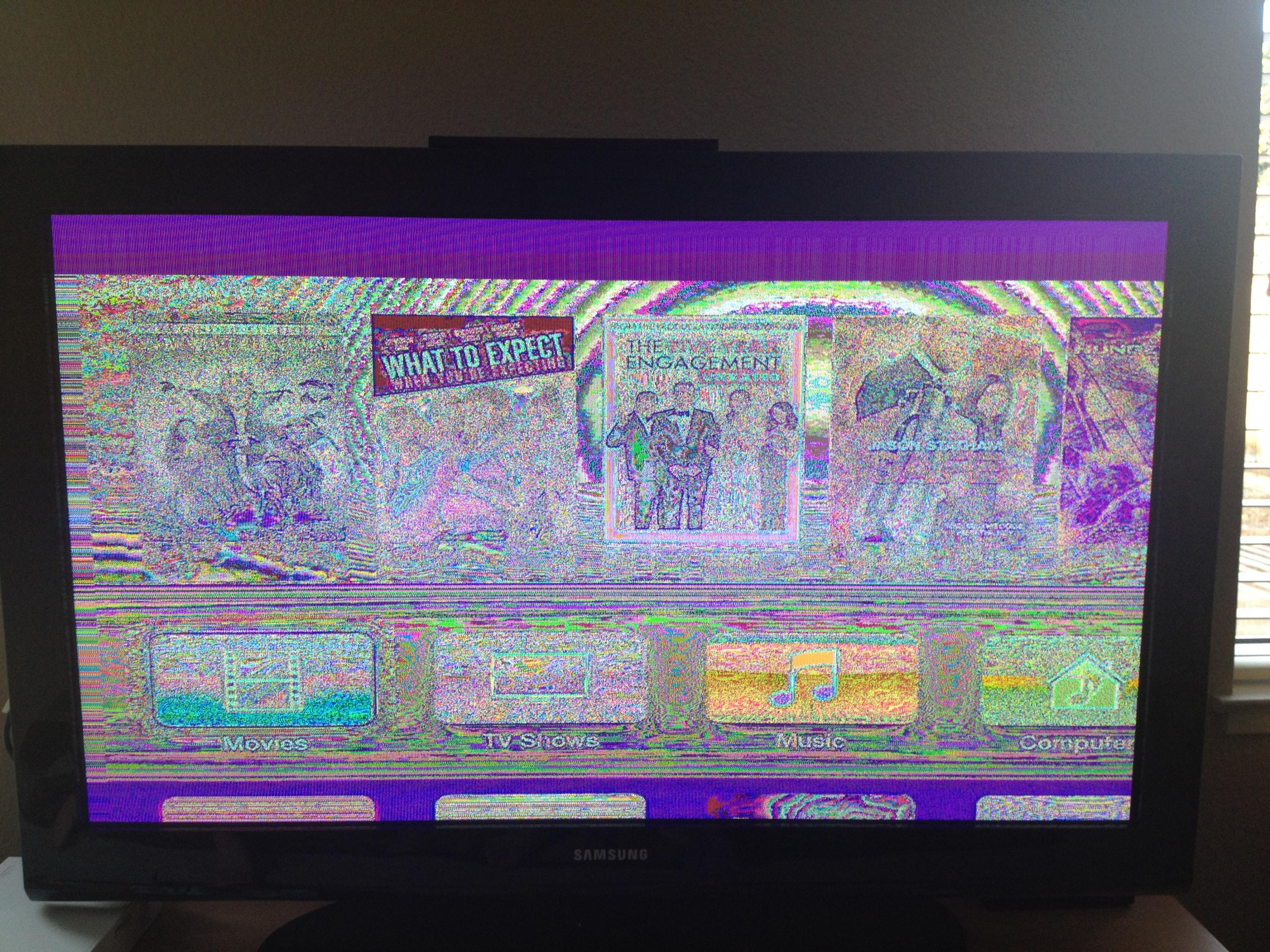

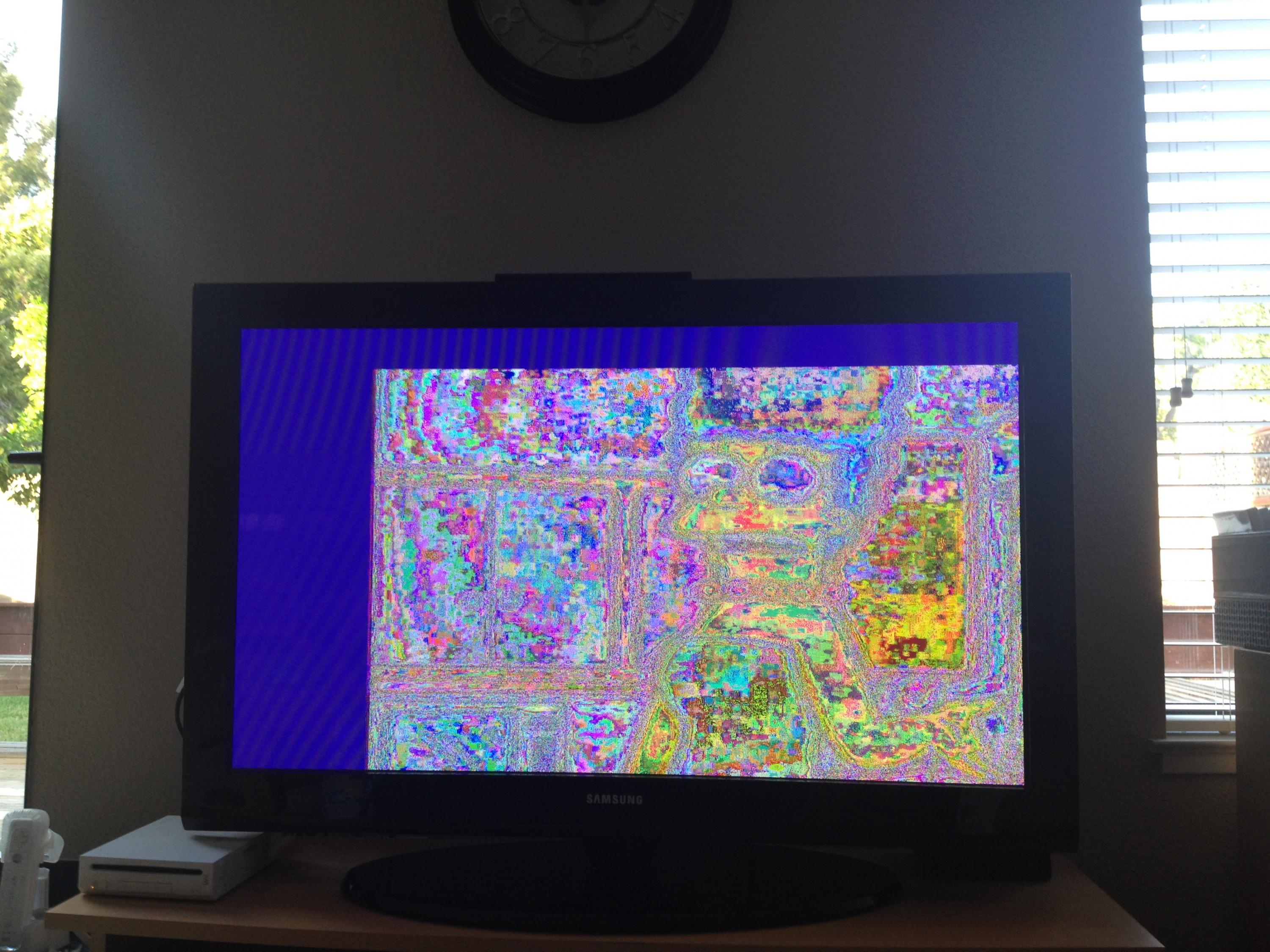

    My plasma TV picture started having problems all at once. Not sure how to describe it, so I attached some photos.
    Photo 1 = Apple TV home screen
    Photo 2 = The Simpsons. You can kind of make out Marge.
    Photo 3 = Homer Simpson with my cable provider's overlay (AT&T Uverse)

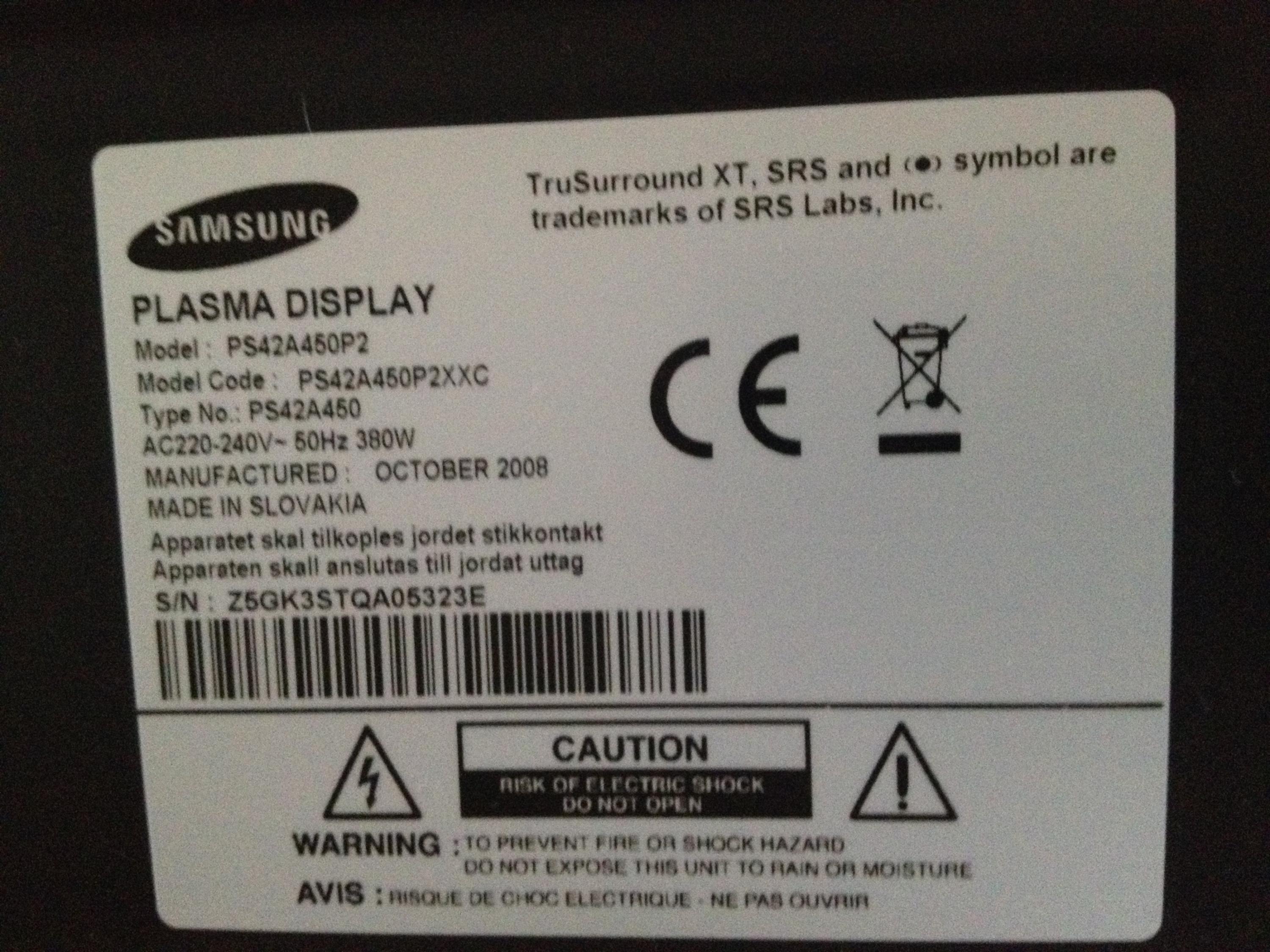

    Photo 4 = TV model sticker from the back.
    Any advice as to where the problem may be and if this is worth trying to repair? I'm comfortable with basic electronics and would be willing to open it up and see if I can figure it out. Am just wondering if anybody can say "Oh, the problem is probably with x, y or z."
    Thank you.

    Re: Samsung PS42A450P2 plasma screen problem
    I want to say main or controller since that processes video signal and the way it's displayed on the screen (firing order). Of course, you can try re-seating the LVDS cable.
      Is something like the volume control or main menu affected?
      It looks very similar to having the LVDS panel setting incorrect.
        Tom66: The volume seems fine.
        I tried the procedure that you suggested. The screen that appears when the TV turns on is unintelligible, so I don't know what to press to reset it. See the attached photo.
        Thanks.
          Going by the first pictures it looks like you have bad surface mount caps on the video processor board.or most likely one of the large processor chips.
          Sometimes pressing on these lightly corrects the picture. They may be hot also.
          I am not sure if that is part of the main or tuner board on this model.

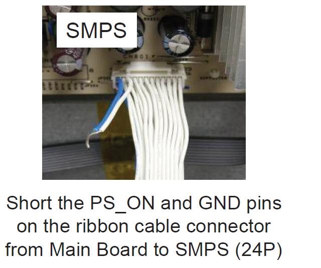

              Attached is a PDF of the hardware-based method that I was referring to in my previous post.
              Does anybody have any experience doing this?
                Crashp3 has some experience with this - I believe it's pins 3 & 4.

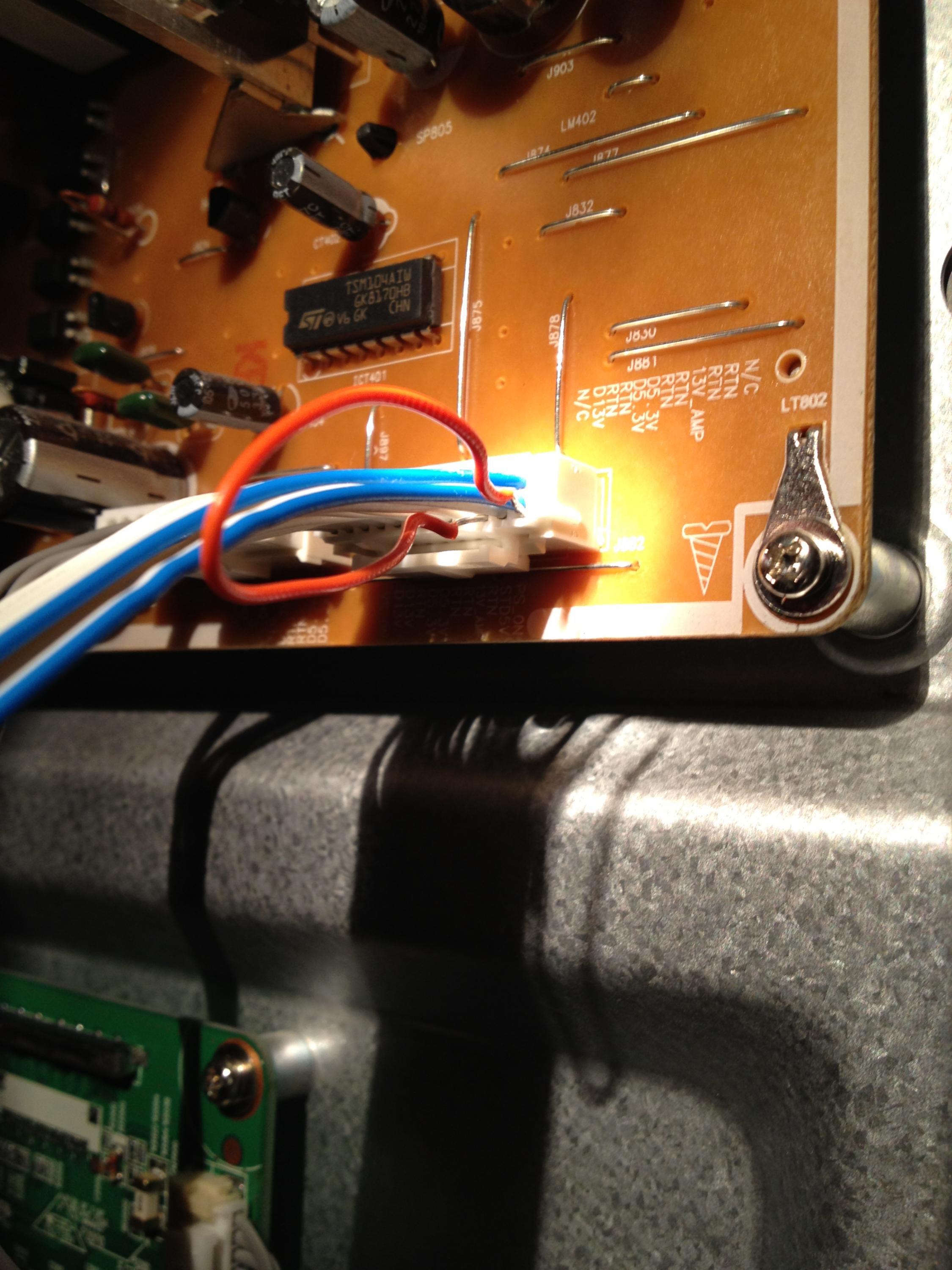

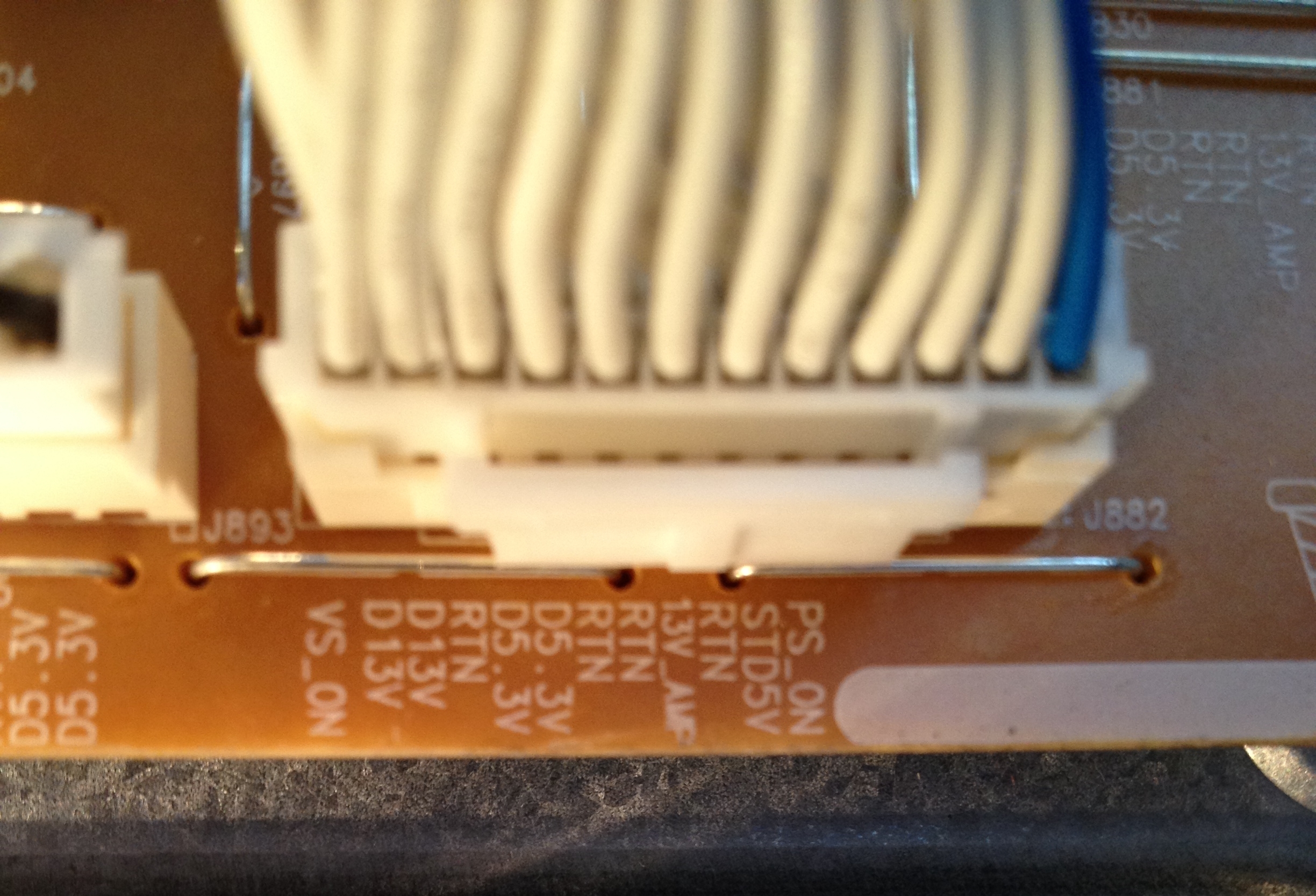

                  Part of the procedure to force the logic board to display the test pattern is to short the "PS_ON" and "GND" pins on the 24-pin connector that goes between the power supply and the Main Board.
                  My connector doesn't identify a "GND" pin. It has a "PS_ON" pin, but no "GND" pin is identified. Any suggestions as to which pin I should use? Is "RTN" the same as Ground?
                  Photos are attached.
                  • drpj23
                    • May 2012
                    • 528
                    Yes RTN would be your ground.

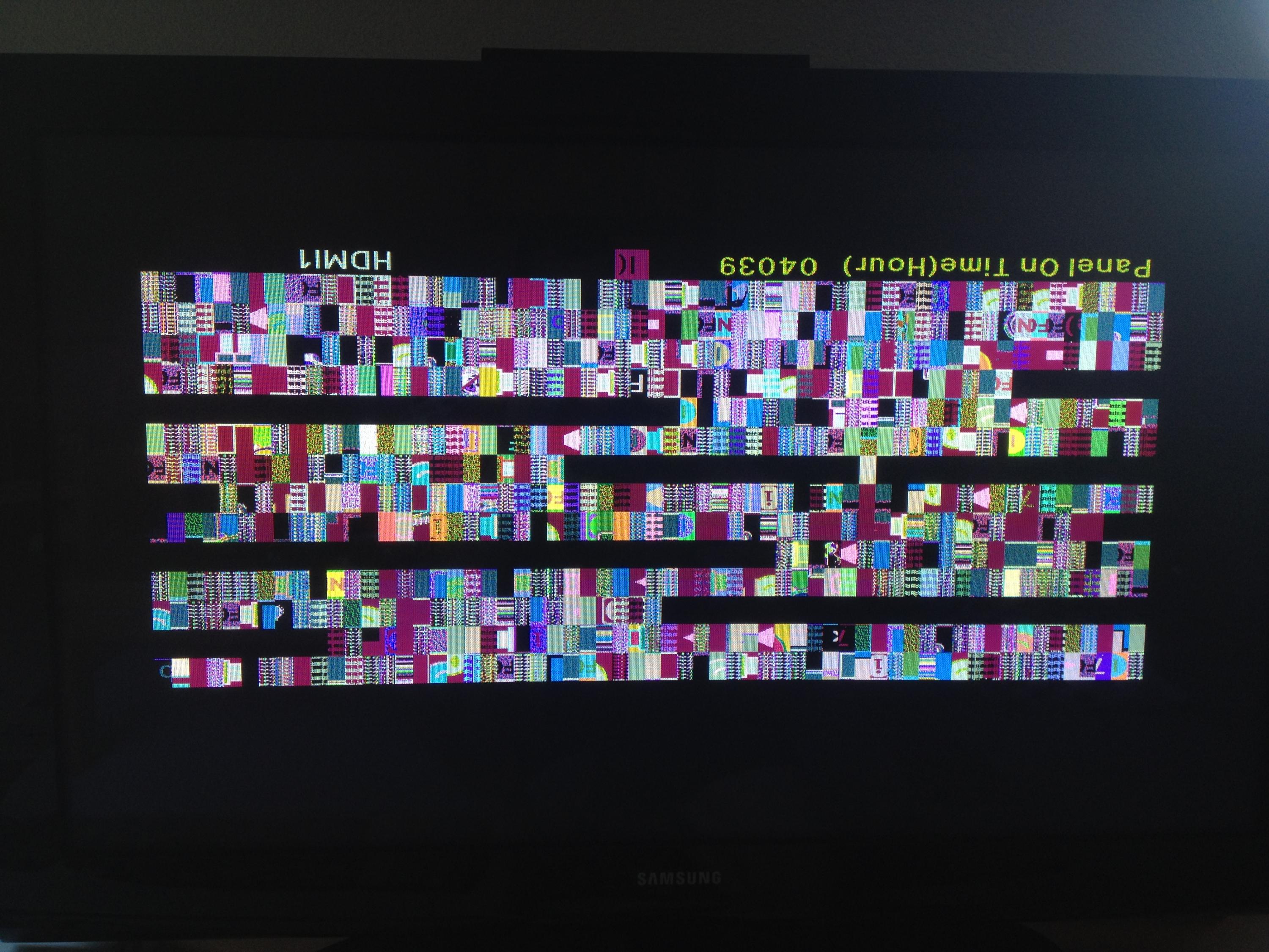

                      Thank Drpj23. It worked! The TV turns on and the display cycles through a number of test patterns and repeats the pattern in an infinite loop.
                      The patterns are not as complex as I expected them to be: All white, all red, all green, all blue, scroll up white, scroll up red, scroll up green, scroll up blue, scroll left yellow, diagonal white, repeat. All screens, colors and transitions were clean.
                      So that means that the Main Board is bad, since it is the only board that was removed from the system with this test.
                      Here is the procedure for anybody else who wants to try this (you assume all risk):
                      1) Unplug your TV.
                      2) Disconnect all cables that go to the Main Board.
                      3) Find 24-wire ribbon cable that goes between the Power Supply Board and the Main Board. Jump the PS_ON and RTN pins on the connector at the Power Supply Board. See photo. (Note that the other end of this cable should be disconnected from the Main Board per step #2.)
                      4) Short pins 3 and 4 on the quad connector of the Logic Board.* I used an alligator clip to do this. See photo.
                      5) Plug your TV back in. The TV should turn on automatically and start playing the test pattern.
                        Looks like a corrupted EEPROM. I noticed when you did it it displayed HDMI. If you have the set hooked up on a tv channel and watch it then try going into Factory menu what do you get?
                        your picture looks very similar to this Chinese special .

                              I guess what I mean is I see you get some kind of tv picture. Set the TV up as if you are watching then retry that remote sequence.
                              On the 2 samsungs I played with I'm pretty sure the service menu came up withthe picture running in the background.
                              On your picture it showed HDMI and I'm assuming that was the last input the TV was running on or selected.
                              Is that correct or not?

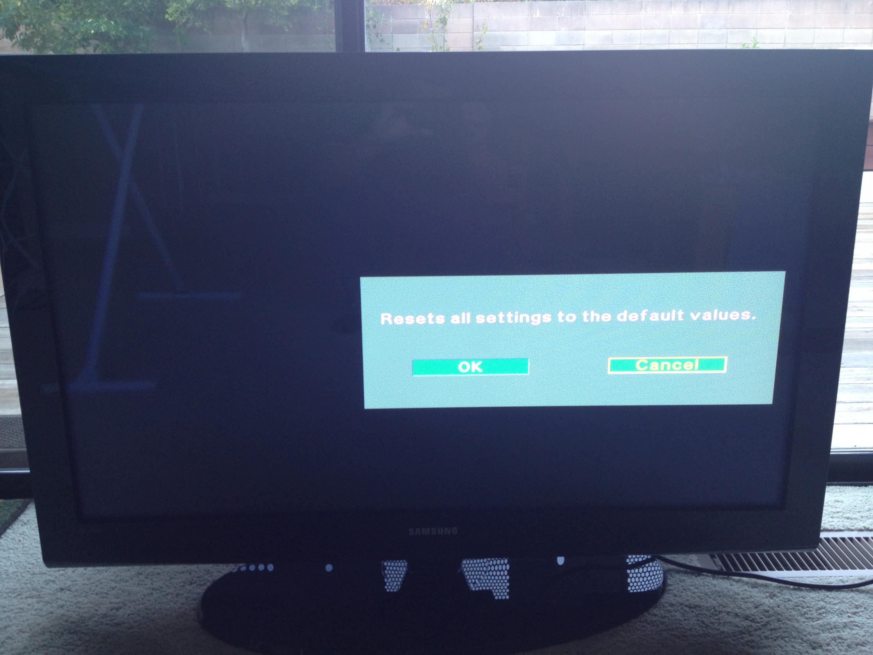

                                      I learned how to perform a factory reset while the TV is on:
                                      Press and hold "Exit" for about 10-12 seconds. The factory reset menu (see attached picture) will appear. Press the left arrow to select the "OK" button. Then press "Enter". The TV will reset and turn off in a second or two. When you turn the TV back on, you will have to go through the normal TV setup procedure as if you just bought the TV. Also, the "Panel On Time" counter resets to 0 hours.
                                      Unfortunately, the factory reset did not solve my display problem.
                                      Cadiman, I also tried your suggestion to press the surface mount capacitors on the Main Board to see if this might improve the picture. It didn't.
                                      Sigh. I guess a Main Board replacement is the next step, if I can find one.
