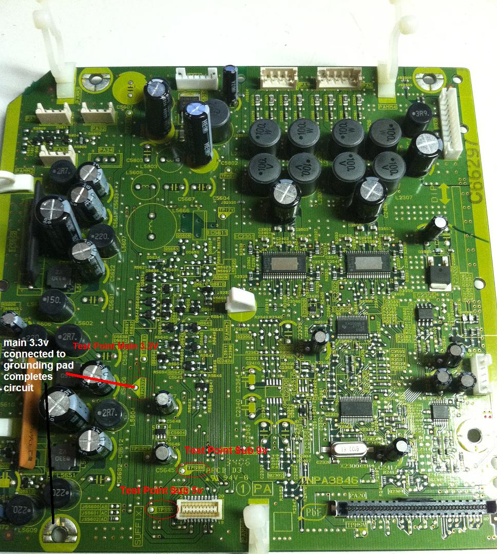

      Re: Panasonic 50PX600U Plasma 10 blinks wont turn on
      attached is a piture of the PA board that i question as faulty. the 3 test points marked in red are the ones that can set off the 10 blink error. only the 3.3v one has a conection to ground.
        That is part of the power board which is not my problem. the power from the power board is not getting to the DG board which is why the 10 blinks displays. and im thinking he PA board may be the problem.
            Well,
            with the astounding amount of help(i say that sarcastically) i finally found the problem. The PA board did in fact have a shorted Main 3.3V which put the tv into shutdown. i swapped the PA board today and im one step closer. that solved my 10 blinks but sadly now i have 11 blinks for a fan SOS and i found 2 of the 3 fans to be defective so now i need to swap those out and hopefully then see a lit up screen. but as for the 10 blink problem it was the PA board so anyone with the same problem stumbling upon this looking for answers check the test points on the PA board labeled TPM33V, TPS5V, TPS9V for a connection to the ground. one probe to the test point the other to the chassis or grounding pad where the mounting screws go. a connection to ground = bad board.
