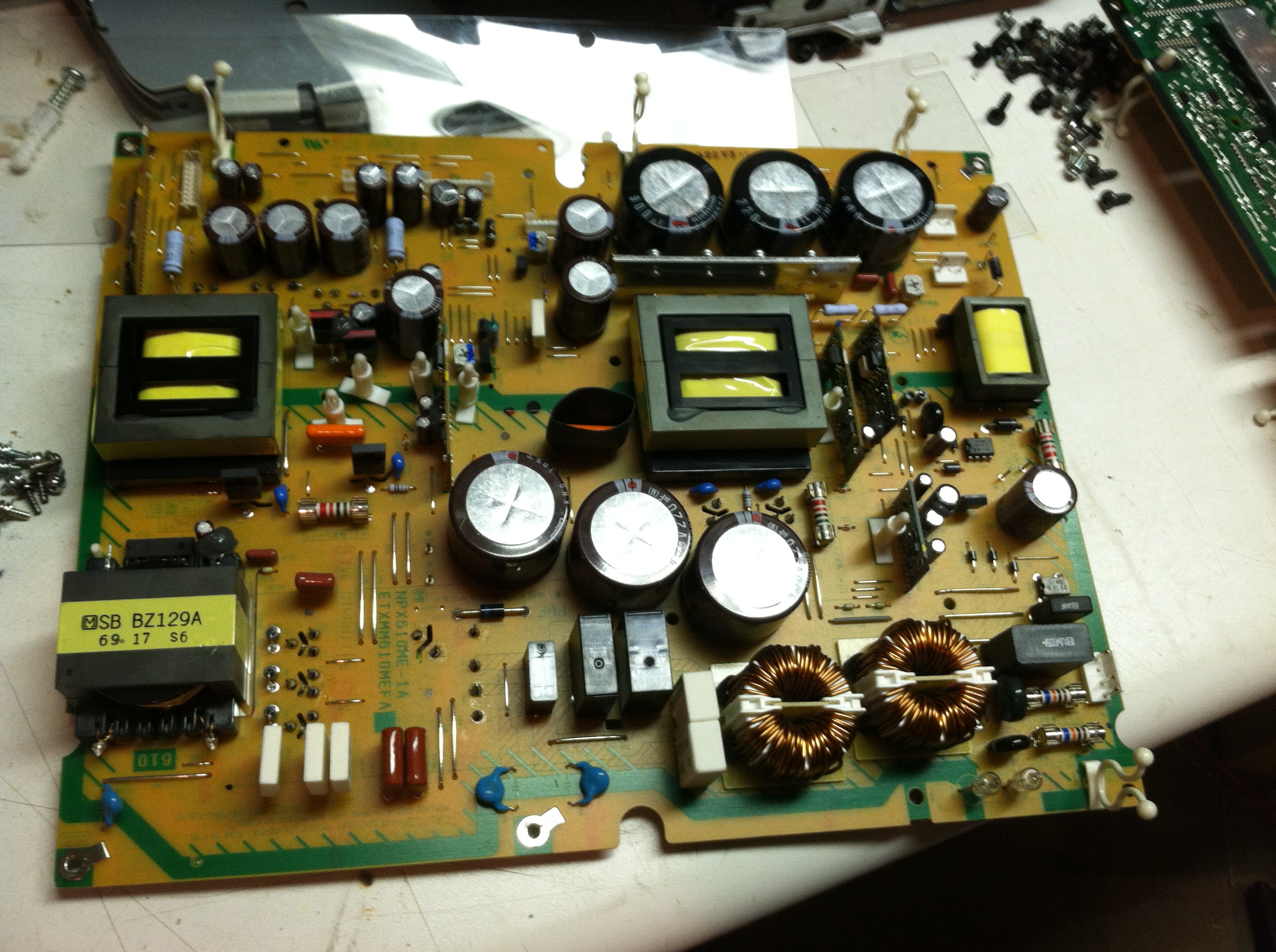

    I have a 50 inch panasonic plasma tv that is giving the 10 blink code for an error with the PA or H Board. I removed all the boards and inspected them and all i found was HDMI port 1 burnt but shouldnt affect it especially since it is on a different board. I also noted that the 3 large 220V 900uF capacitors on the cold side of the P board are slightly domed. however I have read some posts of this being normal in large capacitors. I saw nothing else suspicious so i put all the boards back on.
    I also noted from another post to disconnect P5 on the power board (P) and check for 15V DC so i plugged it in and all i am reading is 0.002V. the post also mentioned to check the voltage to the H board which should be 14V DC but i have not got that far yet.
    When plugged in the power supply board clicks twice followed by a 2-3 second pause and clicks once more and then the red LED starts blinking its error code and wont turn on.
    I should also note that the blinking error code comes up immediately and there is no solid standby light so i dont even have an opportunity to attempt to power it on before it has an error which also makes me lean towards thinking its the power supply since the error is immediate.
    I would love to fix this tv and have it in my living room but i dont want to end up buying and swapping every board one at a time until it works.
    any ideas? thanks

                        Is it possible for you to link to a picture of your PSU, or upload one?
                        • nmg555
                          • Mar 2011
                          • 21
                          Re: Panasonic 50PX600U Plasma 10 blinks wont turn on
                          There should be an attached picture in post #9.
                          I tried swapping parts but that did not go well at all. i was able to get a full refund without shipping it back so i bought another board and now i still get the 10 blinks. apparently the pansonic flowchart is not foolproof.
                          the flowchart starts off by saying remove DT board. still 10 blinks? yes, so then i move on to disconnect connector PA40. still 10 blinks soi move on to 14v present at pin 1 of p10. no there isnt any voltage. disconnect p10 is 14v present at pin 1 of p10. still nothing- replace power board.
                          I doubt that this is third defective power board. something else is wrong here and i cant figure out where to look next. this tv is costing me much more than i expected.

                              ok, so heres some numbers i just got.
                              after reading through a different panasonic manual i found this:
                              If the SUB 5V,
                              SUB 9V or MAIN
                              3.3V is missing
                              on the DG Board,
                              the unit goes into
                              shutdown.
                              The power LED
                              blinks ten times.
                              The voltages are
                              monitored on the
                              DG board by the
                              MPU, IC1103.
                              So to test these voltages there is test points on the PA board for each.
                              while plugged in and blinking the error code all 3 had no voltage but with the test points connected and unpluggign and plugging the tv back in the Main got up to 1.5V before the tv went into shutdown and the other two got up to 2.5 before shutdown. not sure if its just my digital meter too slow to read the full voltage before it shutdown. When unplugged i tested resistance with the ground to see if anything was shorted. the Main 3.3 has a solid connection to ground and the other two connect for a fraction of a second and then read open.
                              Im no expert but im pretty sure the +Main 3.3 shouldnt be grounded out. could it be the PA board has a short which is dumping the power to ground and tripping the error?

                                      yes. post #9 should have a pic of my power board which is in fact different.
                                      I have used 3 different power boards so i think that can be ruled out.
                                      but as for a test point having a ground connectionto the ground on the board
                                      is that normal? even though none of the others have a connection to ground
