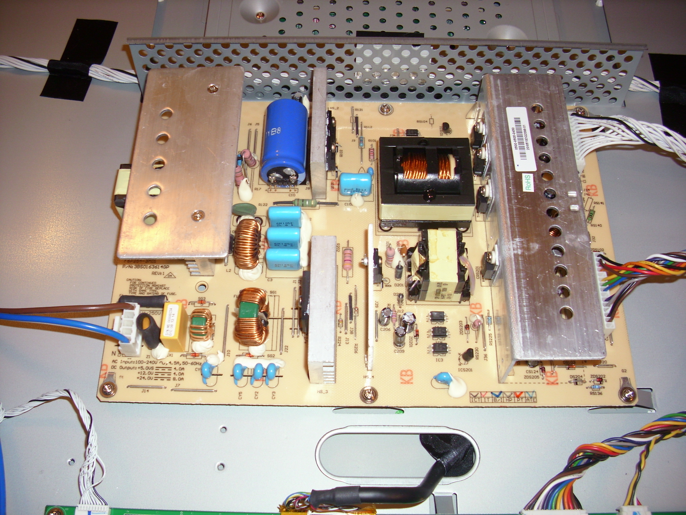

    I read a recent post by drpj23 and am suffering a similar problem. I chose to make a new thread as to not hijack his thread. The information I have below is from what I posted on another site and figured a C&P would suffice. I also viewed the pdf that Mr Bill posted on that thread and the DC-DC Converter testing procedures differ from the ones I have. So that may add some level of error for my testing...
    C&P
    OK...Page 9-5 of the manual indicates the step by step procedure to diagnose the DC-DC Converter. The problem I am having, is when powered on...no powerup.
    I checked the first step that claims J1 pin 10,11 and 12 should have 5v. In fact, it does. Next step says to power on the TV. The only indication I have of power up is the vizio orange light that turns white. Then u must check J1 pin 2,3,4 and 5 for 12v. (On the VW42L, pin 5 is not populated...must be in general for all TV;s that follow this design scheme.) There is no voltage on these pins and PIN 1, shows NO voltage for PSON and F2 is good that provides the 12v.
    I found a 3.3v reference on the power supply, removed pin1 from connector on mainboard, to prevent back feeding voltage, and jumpered to trick PS to come on. BAM!! TV powers up on I have FULL functionality and menu's and the 12v is present on 2,3 and 4.
    Here's my question...pin1 is not fed from the power supply but the main board? The walkthrough say's to check the PS. Is pin 1 not in fact a toggle that is triggered from the mainboard to power on the switch mode?
    To add some more information, the PS is: FSP254-3M01 and the mainboard is a 0171-2272-2434

    Some Vizios have bad voltage regulators on the main board. See my sig file below on how to
    1) post pictures of your boards
    2) test voltage regulators
    3) report your readings as per my guide

      Here's the pictures...I'll post the regulator readings in a sec.

            Re: Vizio VW42LFHDTV10A
            So if you forced the PS to come on and all he functions on the TV works with good pictures and sounds, then what voltages do you get at those UXX that shows 0V reading on all three pins if you leave the jumper in place?
            PS_ON signal is generated by the Main board when TV is turn on and this signal is fed into the PS (Power Supply) board PS_ON pin, >3VDC = ON, 0~.5V = OFF.

                              Yes, about 3Vdc for PS_ON to Bias on a transistor in the power supply section, it is not at logic level like the digital circuits. That does not make sense that the 12 and the 24V go away when the TV is off since we are forcing it to be on by jumping the PS_ON pin, now when I look at the way you are jumping the PS_ON, you use the 3.3V form one of the power supply pin which I have never see 3.3V power supply section on this board before. The way we force the power supply to be on, we use 1~3K resistor between the 5VSTBY and the PS_ON pin to turn on the power supply.
                              I am curious to know if that 3.3V feeding the PS_ON is turning ON and OFF by the main board. Can you tell me which pin on the connector you are using is putting out 3.3V for the jumper?
                              This is how I test the power supply by itself:
