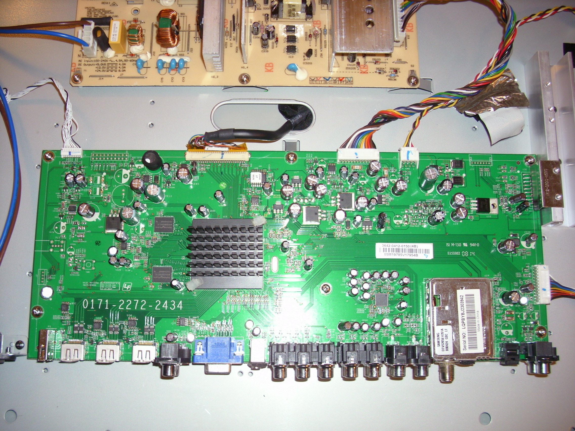

    To add some more information, the PS is: FSP254-3M01 and the mainboard is a 0171-2272-2434

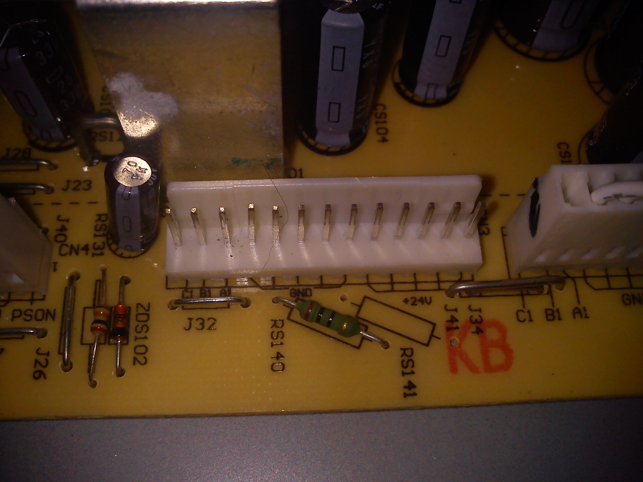

    Some Vizios have bad voltage regulators on the main board. See my sig file below on how to
    1) post pictures of your boards
    2) test voltage regulators
    3) report your readings as per my guide

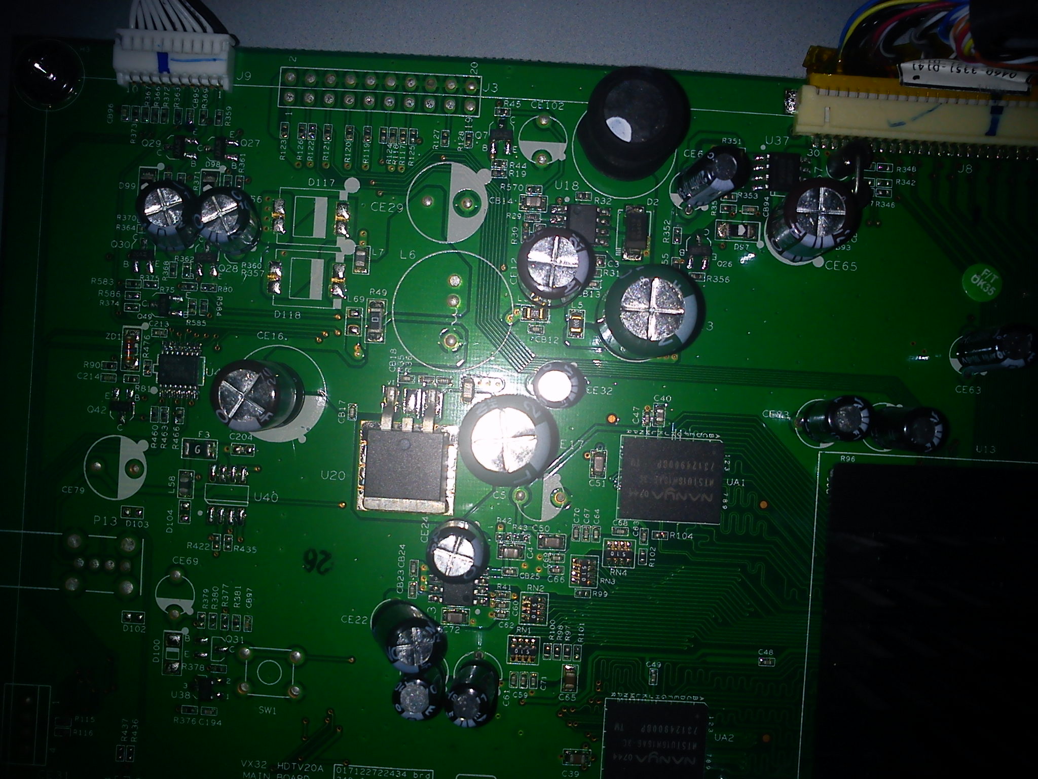

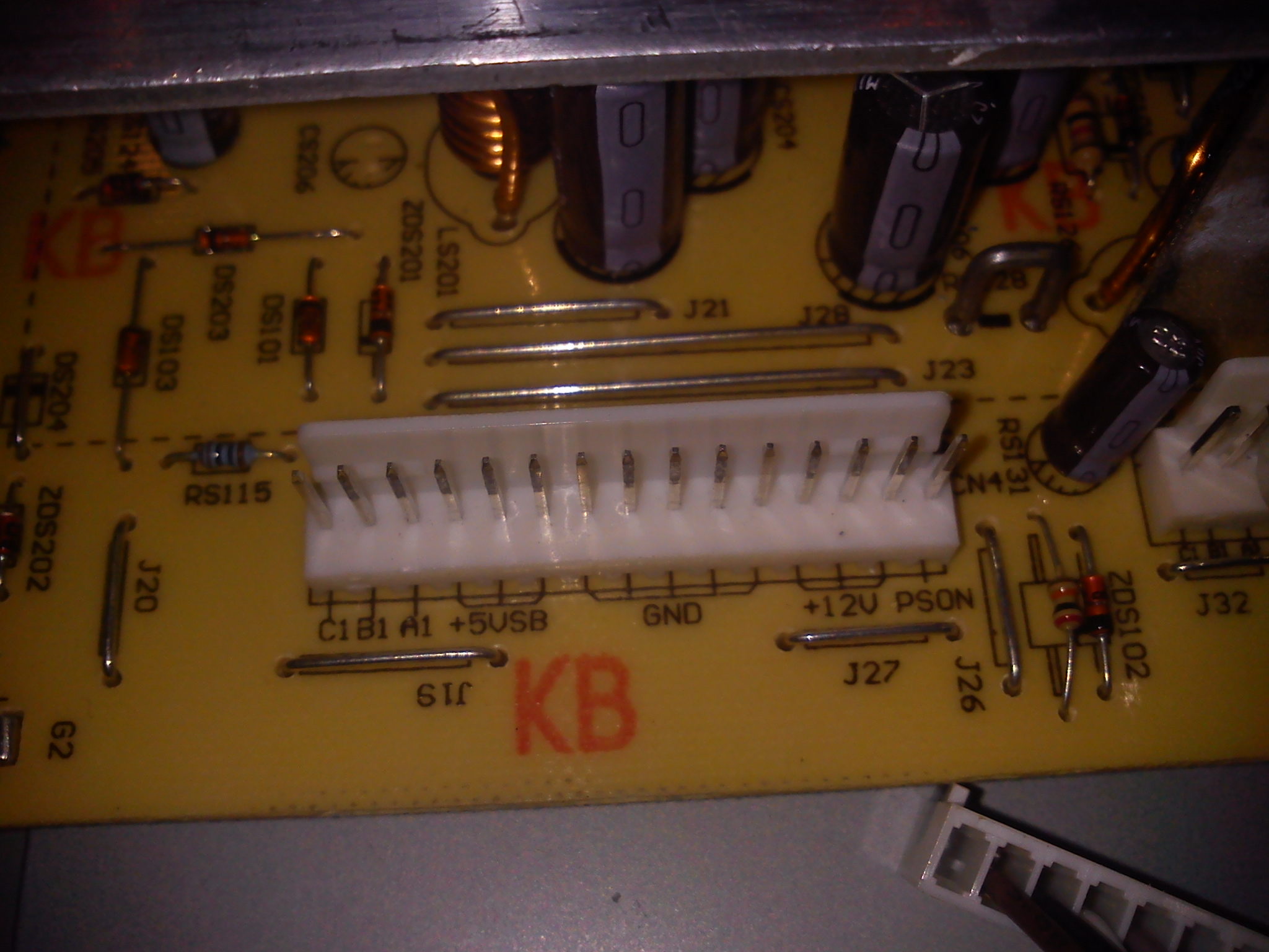

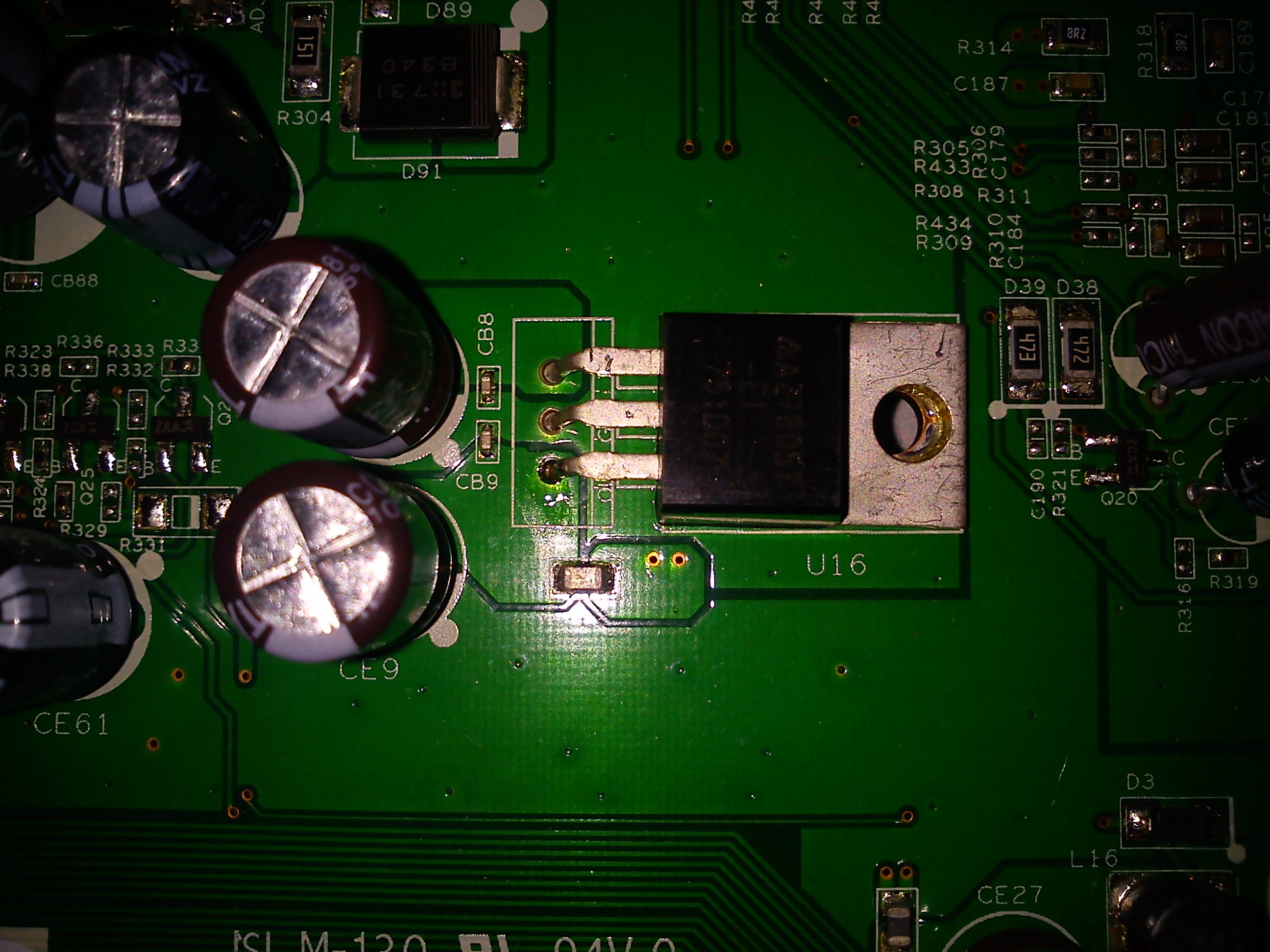

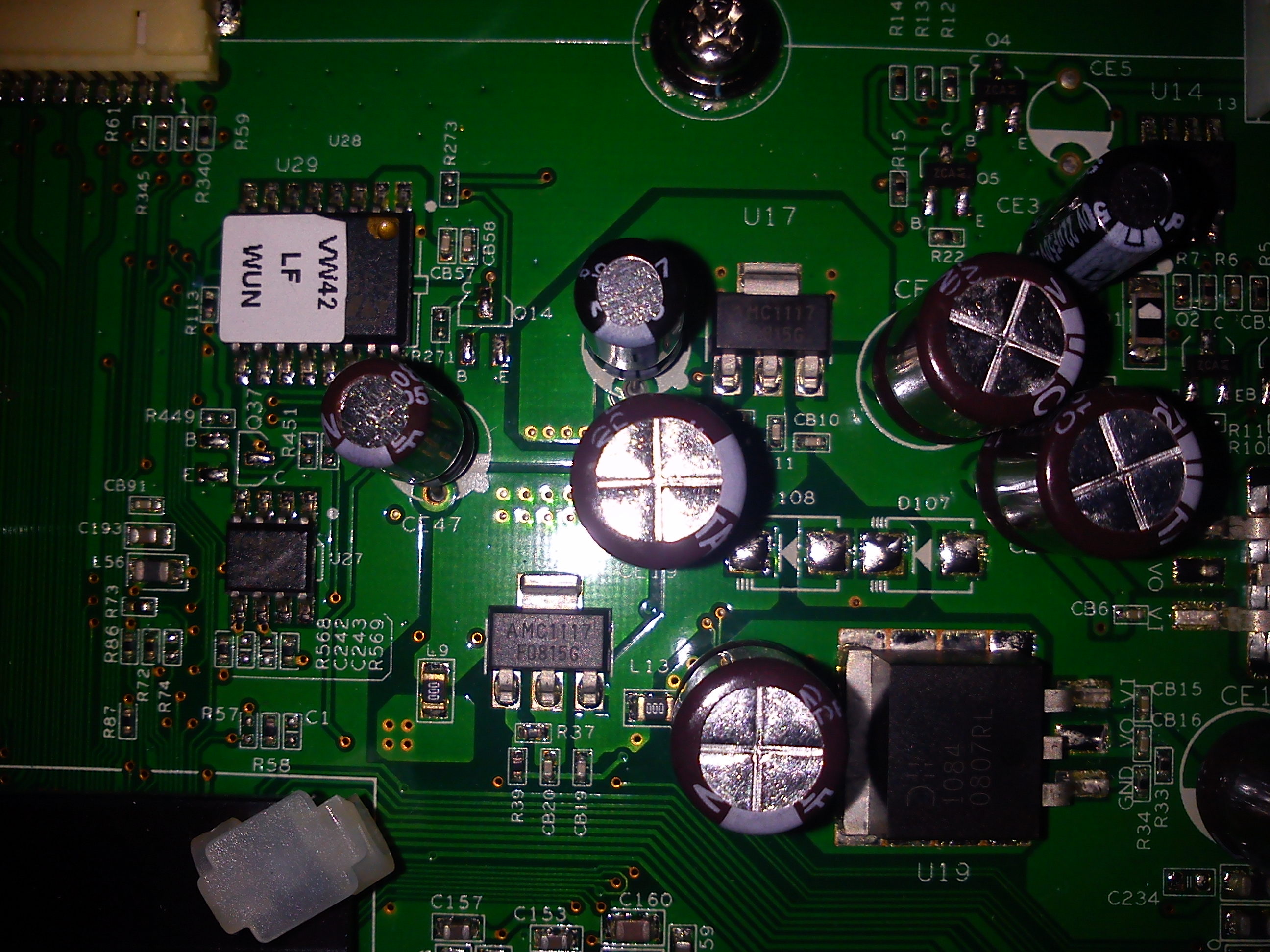

      Here's the pictures...I'll post the regulator readings in a sec.
        Re: Vizio VW42LFHDTV10A
        Ok...Updating pictures of the regulators and also the readings of the IC's. My apologies for not having the info up sooner. Got side tracked on another project.
        All reading were done with TV on (assuming orange standby light turning white means TV is on)
        U16
        AZ7805T
        Pin 1-0
        Pin 2-0
        Pin 3-0
        U44
        1117L
        Pin 1-0
        Pin 2-0
        Pin 3-0
        U17
        AMC1117
        Pin 1-2.09
        Pin 2-3.35
        Pin 3-5.13
        U21
        AMC1117
        Pin 1-0
        Pin 2-1.25
        Pin 3-2.50
        U22
        AMC1117
        Pin 1-2.07
        Pin 2-3.33
        Pin 3-5.18
        U20
        1084
        Pin 1-0.54
        Pin 2-1.79
        Pin 3-3.27
        U15
        1084
        Pin 1-2.05
        Pin 2-3.30
        Pin 3-5.12
        U19
        1084
        Pin 1-1.25
        Pin 2-2.50
        Pin 3-5.12
          U16
          AZ7805T
          Pin 1-0
          Pin 2-0
          Pin 3-0
          U44
          1117L
          Pin 1-0
          Pin 2-0
          Pin 3-0
          Recheck the above two. They is something obviously wrong with those.

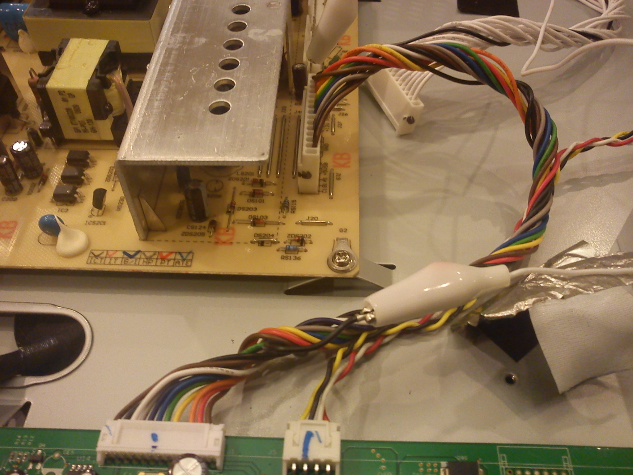

            So if you forced the PS to come on and all he functions on the TV works with good pictures and sounds, then what voltages do you get at those UXX that shows 0V reading on all three pins if you leave the jumper in place?
            PS_ON signal is generated by the Main board when TV is turn on and this signal is fed into the PS (Power Supply) board PS_ON pin, >3VDC = ON, 0~.5V = OFF.
              I agree...I checked and rechecked. Obviously one is a 5 volt regulator and it's right next to the audio amplifier IC. Odd that when I trick the PS in coming on everything works...gonna jumper again and get back with ya on that one.

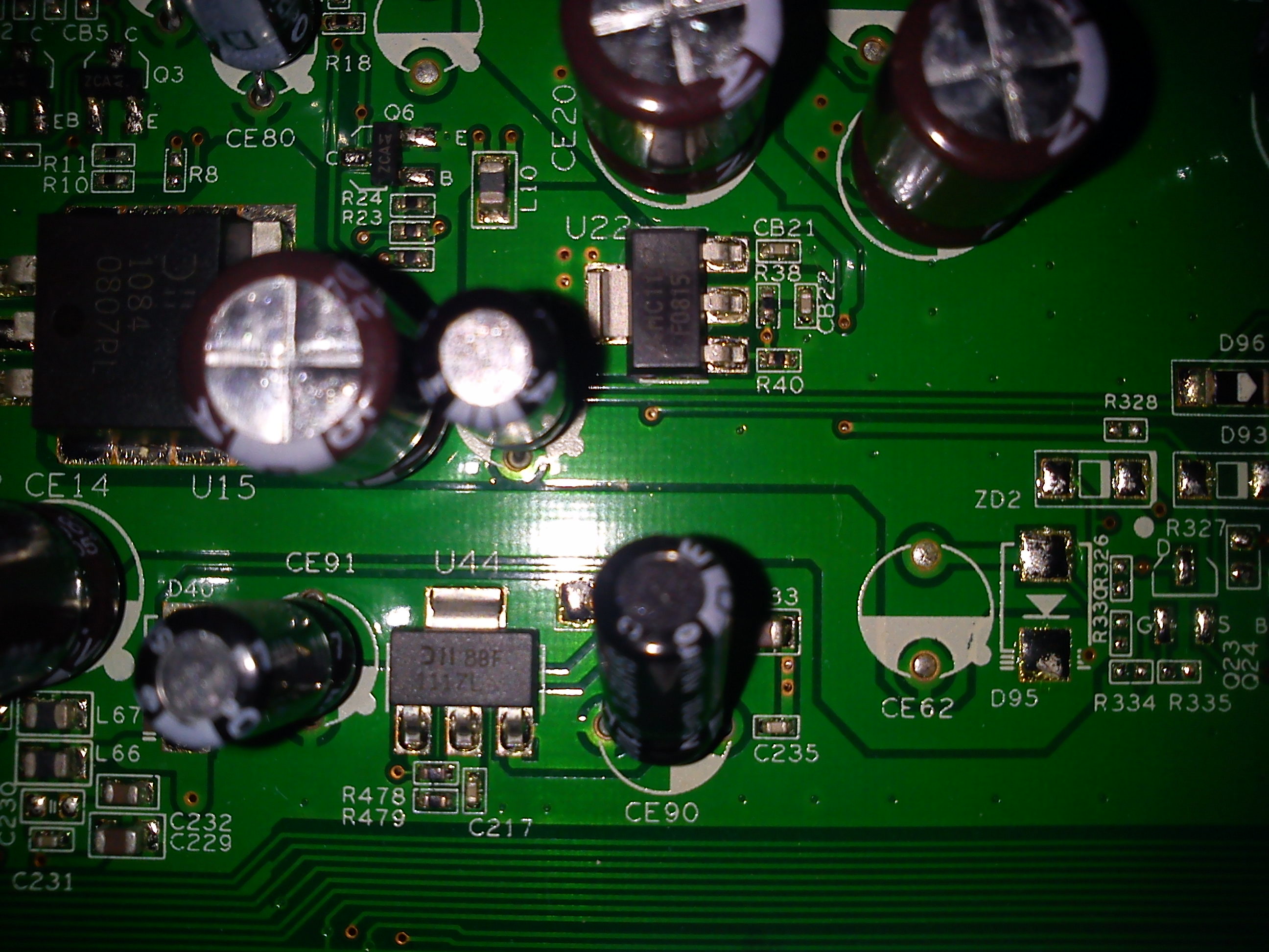

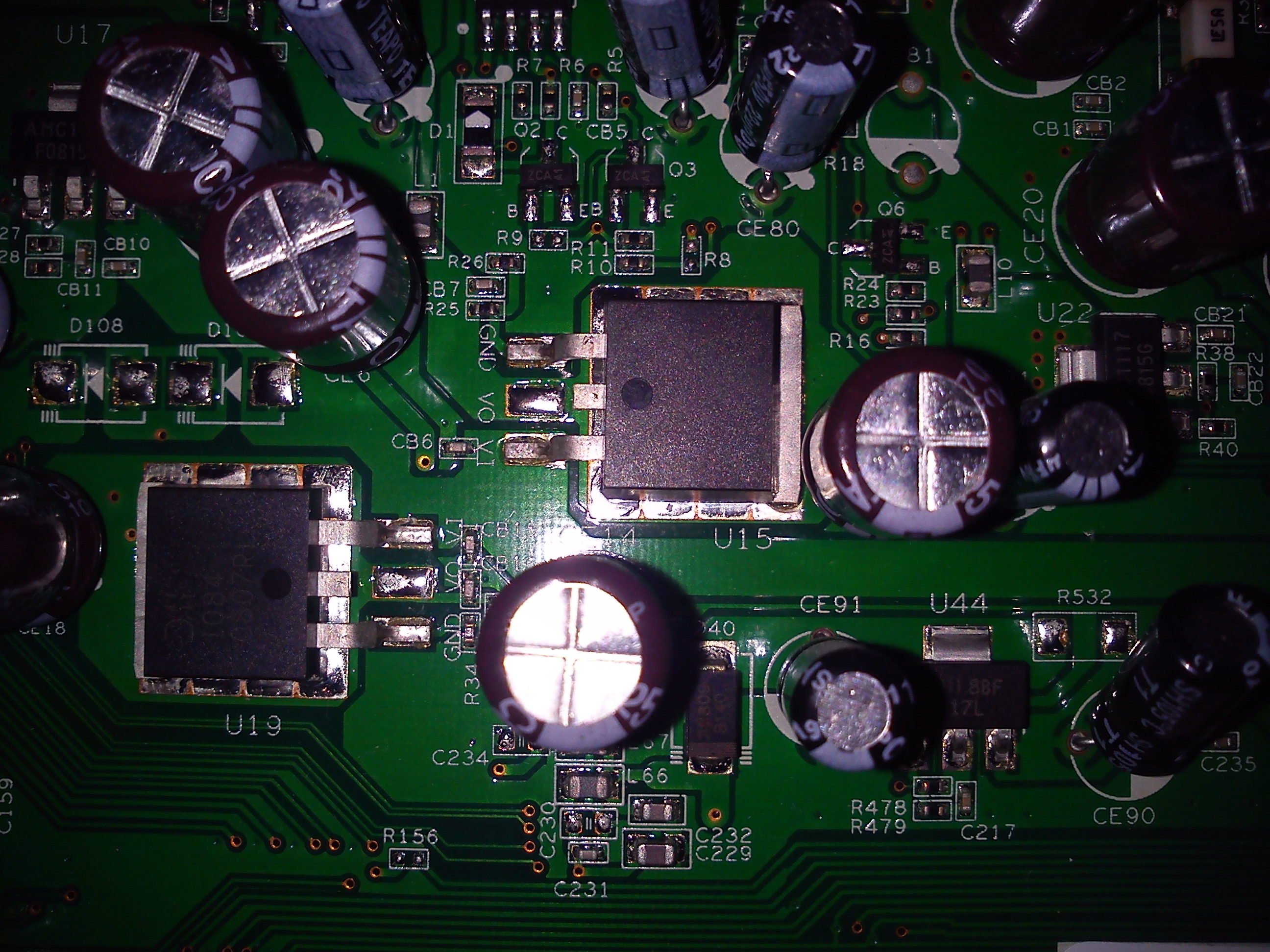

                For U44 and U16, see if they are shorted. With power off and lcd unplugged, measure the resistance between pins 1-2, 1-3 and 2-3. Report your resistance measurements for all 3.
                --- begin sig file ---
                --- end sig file ---
                  With system jumpered:
                  U16
                  pin 1-11.44
                  pin 2-0
                  pin 3-5.01
                  U44
                  pin 1-8.43
                  pin 2-9.69
                  pin 3-11.46
                  Resistance readings:
                  U16
                  1-2 I stopped @ 10k...acted like charging a cap
                  2-3 2k and rising, cap again
                  1-3 15k and rising
                  U44
                  1-2 .300 ohms <----maybe??
                  2-3 18.4k steady
                  1-3 5.4k and rising
                  Uncertain with the IC U44 being .3 ohms without looking at the datasheet. What gets me, and also worries me cause I know it will cause damage if I leave the TV on while jumpered, why is the stupid thing initializing post when jumpered if the IC's r bad..granted it's the 3.3v not being satisfied. The power button, un-jumpered, will only turn TV on and then I have to kill AC and wait 3 minutes to try again. Power button will not turn TV off. However, jumpered, the TV will power on and off with the button.
                  You think you know electronics and you get something like this thrown in your lap.
                      U16
                      pin 1-11.44
                      pin 2-0
                      pin 3-5.01
                      U16 is working fine as it is a 7805 type so pin 3 is correct.
                      U44
                      pin 1-8.43
                      pin 2-9.69
                      pin 3-11.46
                      Technically U44 is doing its job of pin 1 + 1.25V = output voltage.
                      U44
                      Hmm, that indicates that something might be shorted. Or there could be a low ohm resistor between pin 1 and 2. What is the resistance of R478 and R479? What is the resistance of C217?
                        Ok...I need to go to DMM reading class. My meter isn't autosensing and pins 1-2 on U44 are 300 ohms.
                        R478 300 ohms
                        R479 1.99K (2K)
                        C217 1.14K
                        The initial readings of U16 and U44, PS unjumpered are zero on all pins. The voltage readings I gave after intial readings are with me jumpering the A1 on the PS to J1 pin1. So, factory setup...those two IC's have no in, adj or out voltages.
                          According to my calculation, the output voltage of this U44 should be 9.583V.
                          1.25 x (1 + (2000/300)) = 9.583V.
                          "However, jumpered, the TV will power on and off with the button" but if you check the 12V and the 24v OUTPUTS, they will still be there even when you turn off the TV (jumper in place).

                            I agree with the calculations...just wanted to clarify that the first readings were indeed correct and 0 volts. (Post #4)
                            On the second part, negative ghost rider...power off, no 12v or 24v. Power on, voltages are present.

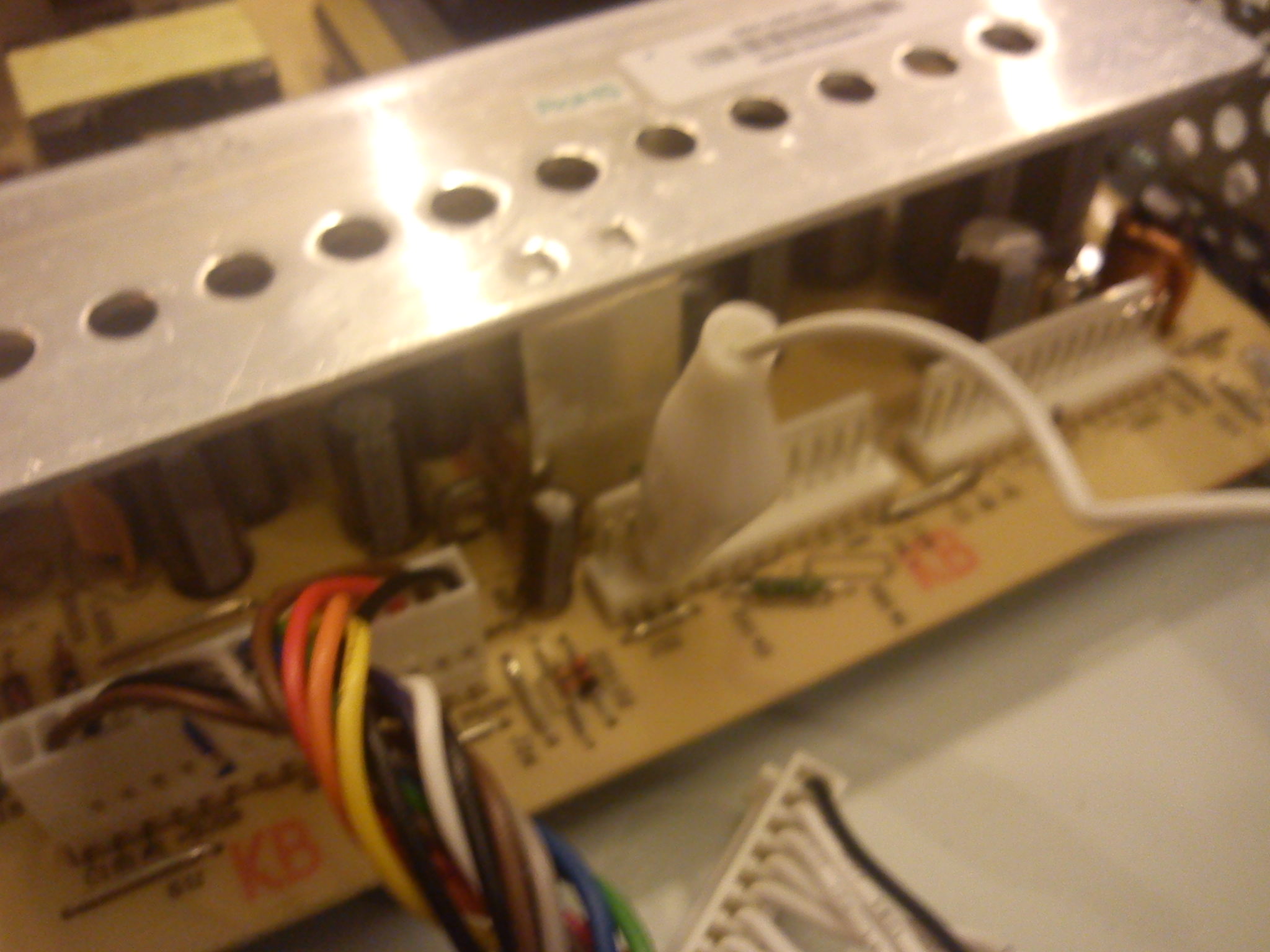

                            You are talking about J1 for 12v and the plug going to inverters for 24v, right? I attached picts...
                              Yes, about 3Vdc for PS_ON to Bias on a transistor in the power supply section, it is not at logic level like the digital circuits. That does not make sense that the 12 and the 24V go away when the TV is off since we are forcing it to be on by jumping the PS_ON pin, now when I look at the way you are jumping the PS_ON, you use the 3.3V form one of the power supply pin which I have never see 3.3V power supply section on this board before. The way we force the power supply to be on, we use 1~3K resistor between the 5VSTBY and the PS_ON pin to turn on the power supply.
                              I am curious to know if that 3.3V feeding the PS_ON is turning ON and OFF by the main board. Can you tell me which pin on the connector you are using is putting out 3.3V for the jumper?
                              This is how I test the power supply by itself:
                              http://s807.photobucket.com/albums/y...ply%20testing/

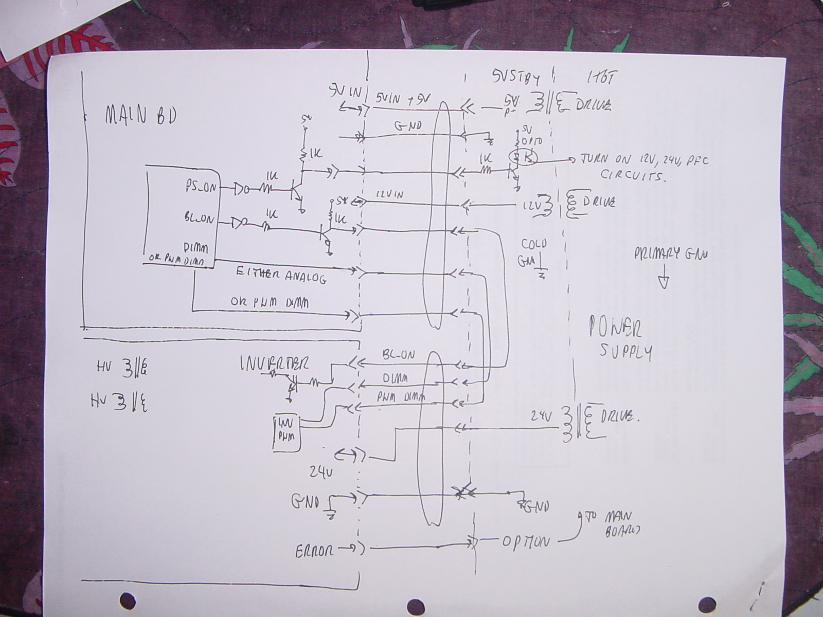

                                The pins labeled with C1, B1, A1; they are feed through connections, the power supply board is used as the junction box only, those pins are not connected to the power supply circuits at all.
                                They are
                                Dimming signal (0~5V, 5V= max brightness) if inverter board is setup for analog dimming controlled.
                                PWM Dimming (it uses PWM for brightness control) if the inverter board is setup for PWM dimming controlled.
                                Backlights ON/OFF (for turning on the inverter, >3V = on).
                                To have backlights work, it needs two voltages, one is the swiched 24VDC which is controlled by the PS_ON, and then the Inverter ON/OFF signal.
                                So right now you are using the Inverter ON/OFF to turn on the power supply AND then inverter ON/OFF, that is why the 12/24 go away when you turn off TV. There is no 3.3V power supply section on that power supply board.
                                If you look at the bottom side of the board you will see how A1, B1, and C1 are routed, this is very common setup for most TV to keep the wiring clean. I can draw you the simple diagram if you need it.

                                      Simplify diagram.
                                      Example of LCD panel spec, see page 15 for control signal for the inverter board.
                                      We know the inverter board is OK so no use to look at it.
                                      You need to figure out the PS_ON pin on the Main board, and since the TV functions OK when the PS_ON is forced ON, more likely the transistor interface that control the PS_ON line is stuck ON so it grounds the PS_ON line.
