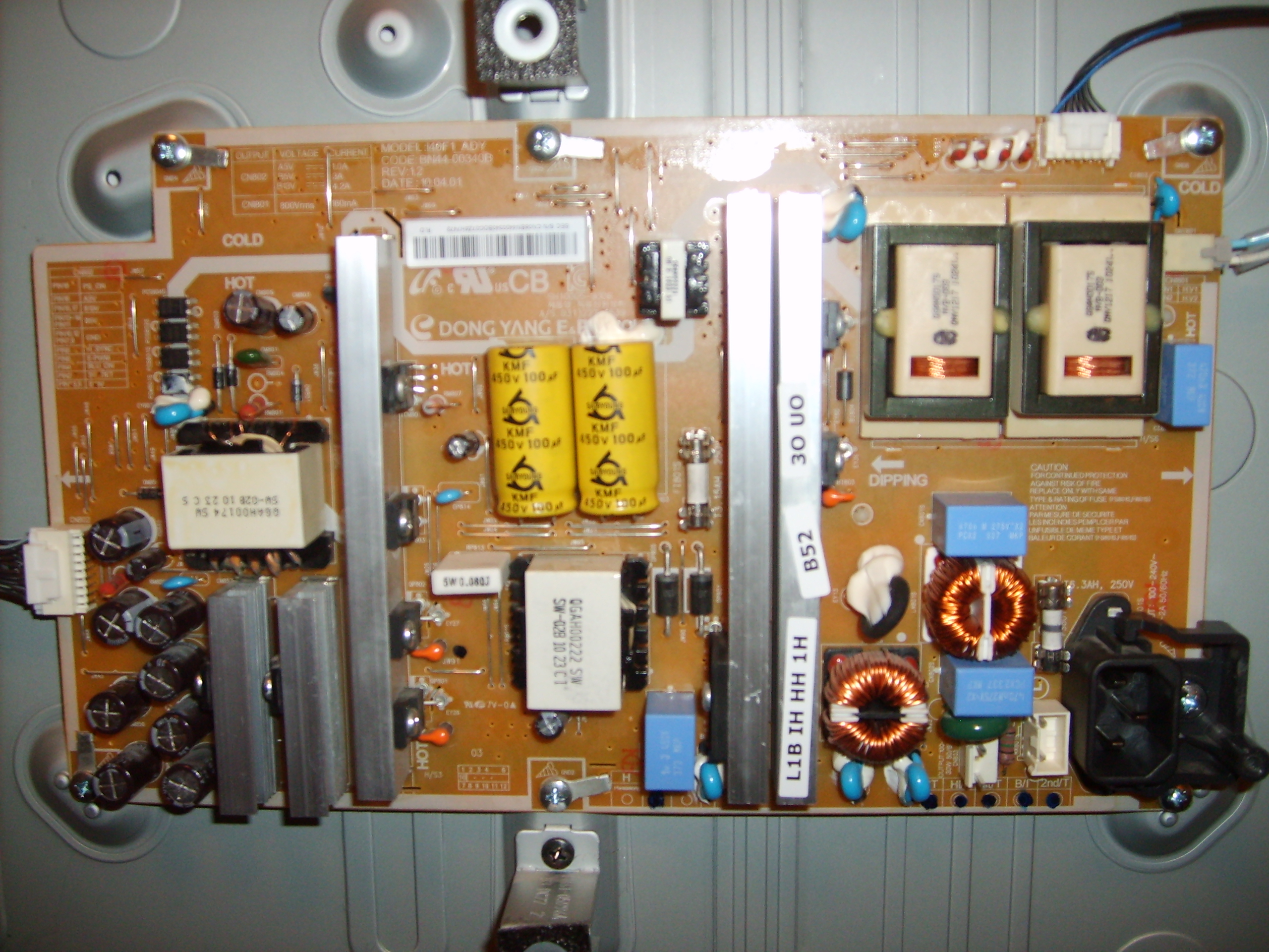

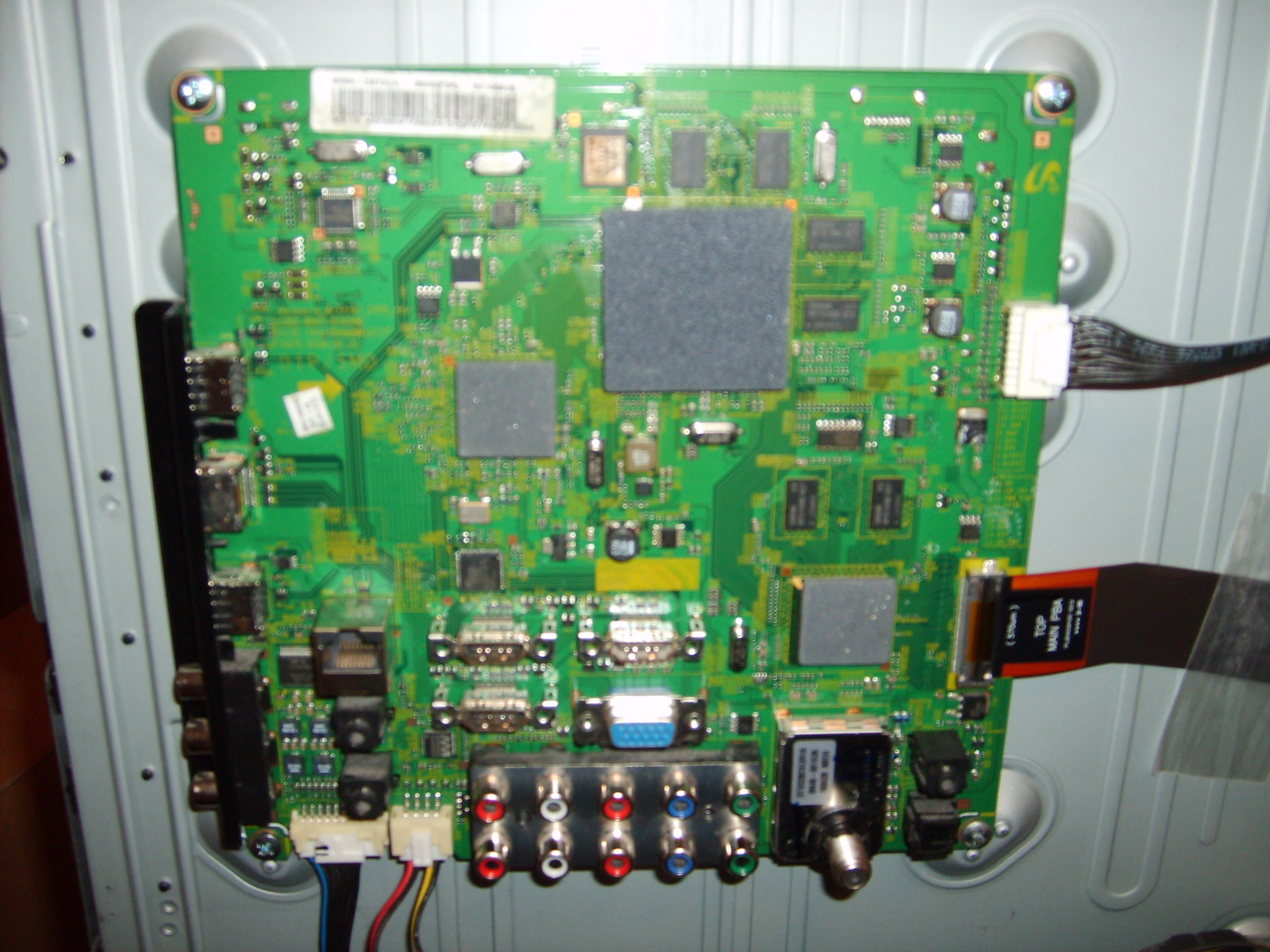

            Thanks again for all the replies... I am about to take pics now. I read somewhere about unplugging the power supply board from the main board and seeing if the backlight comes on and that will help with identifying the problem.
            Just did it and the backlight did come on.

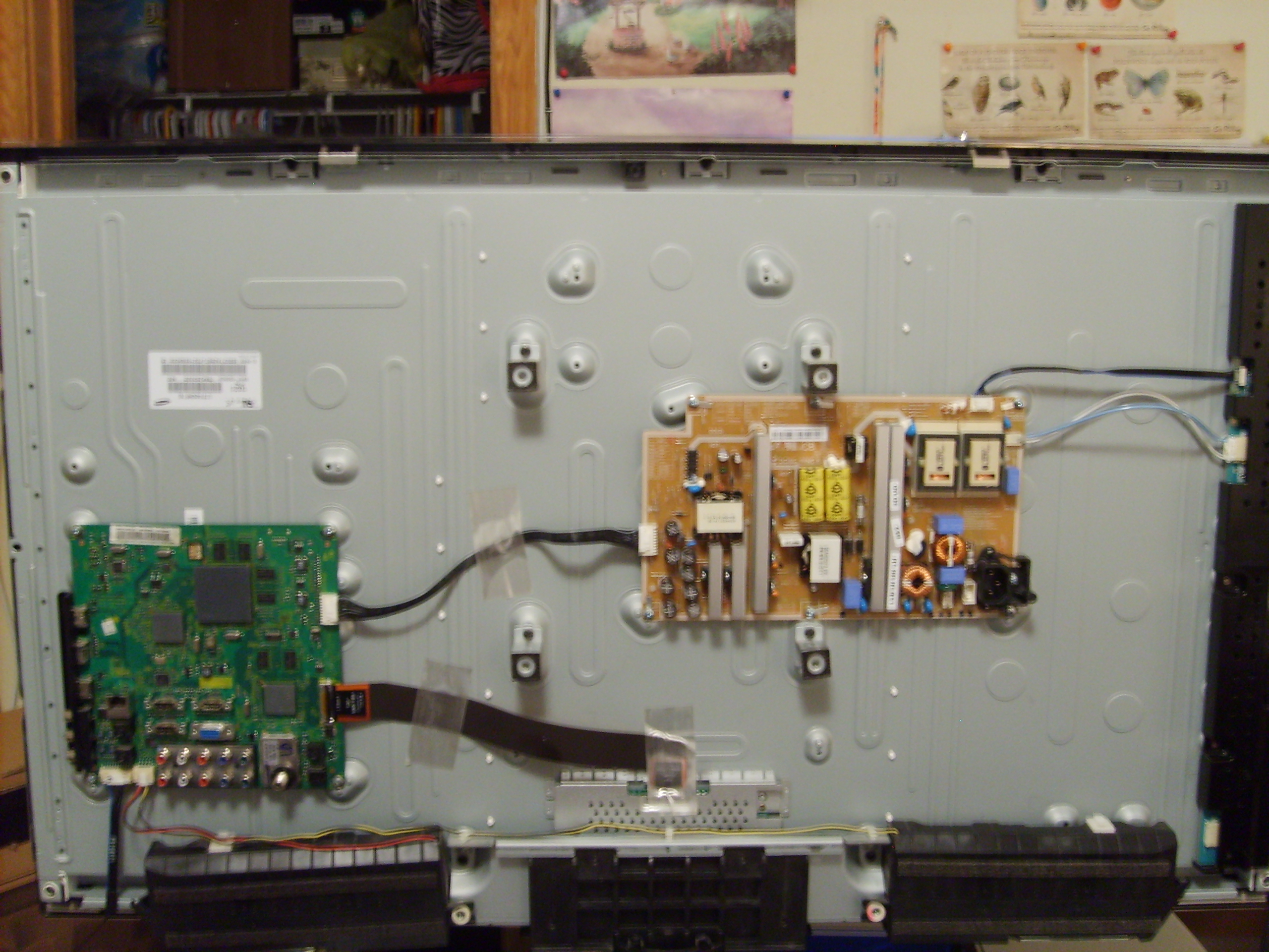

            Taking pics now....thanks again!
              Re: Samsung LCD will not power on!

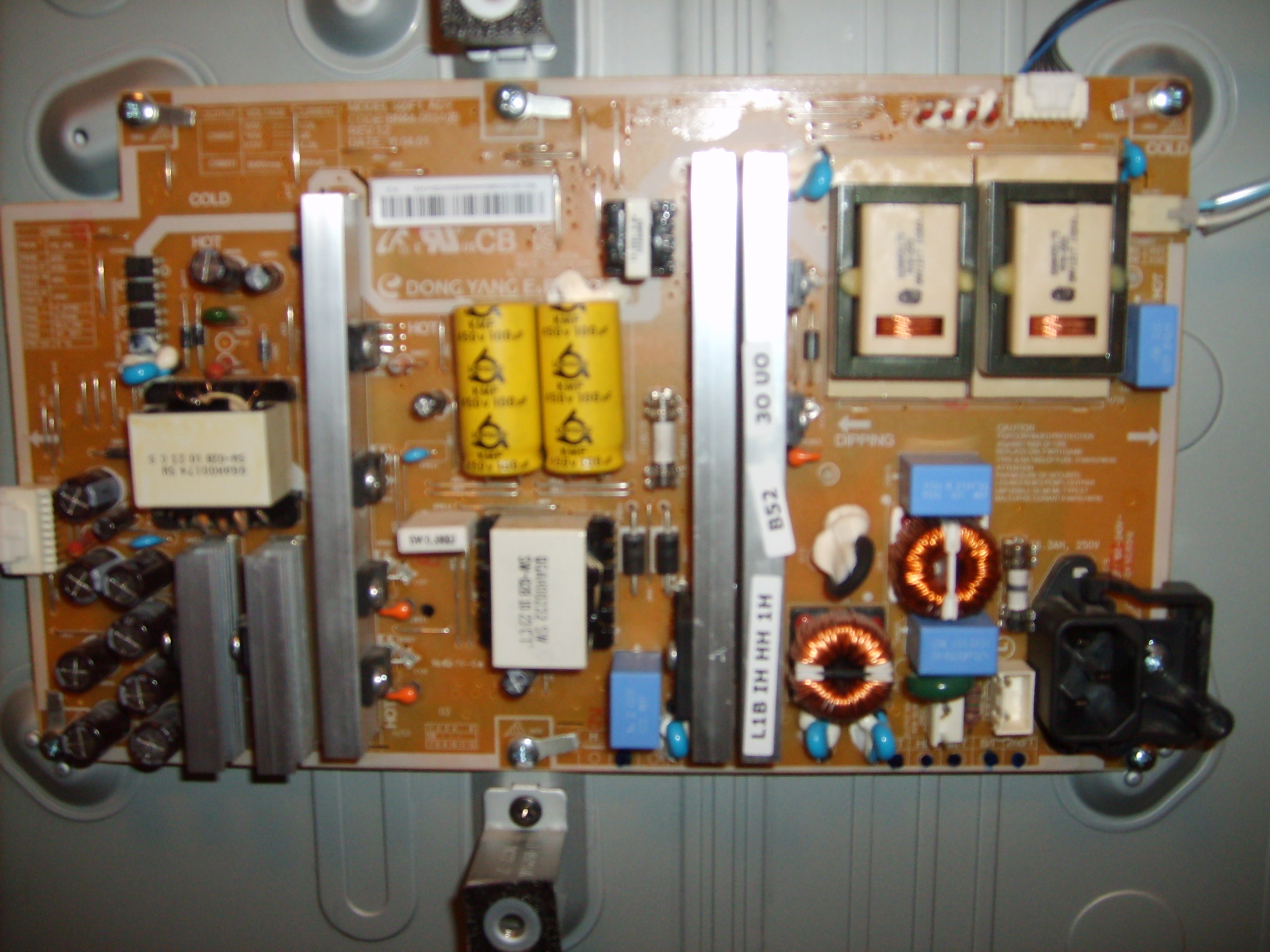

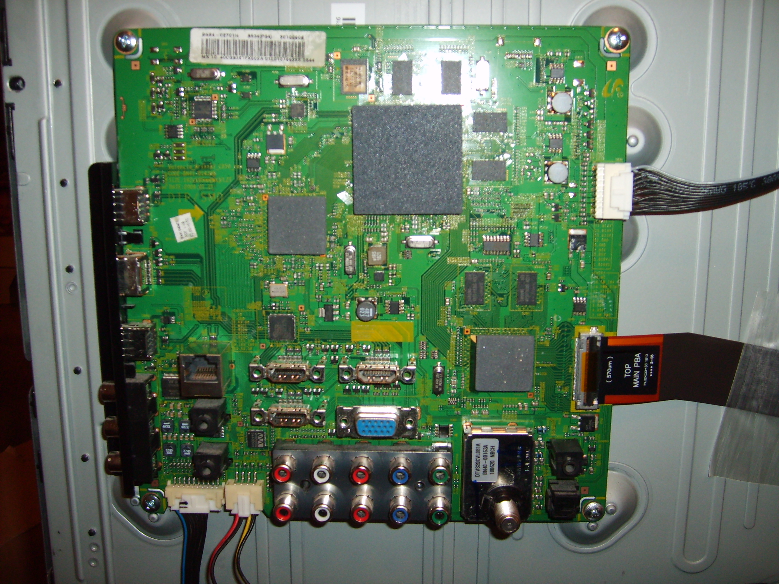

              ok, here are pics..... the caps do not look bad.
              hope the pics are ok... cam is old.
                On the left side of the power supply/inverter combo board just above the connector with black wires, there is a label telling us what the pins are for, the picture is not in focus to be able to read. Can you post better pictures that are in focus? we need to be able to read and see what are on the boards
                  Do you have a multimeter and do you know how to take DC voltage readings? If yes, measure all the voltages on CN802.
                  BTW, we are going to need clear focused pictures of the top left hand corner of the power supply so we can see the legend.

                              Just wanted to update the status of this post. Turns out the problem was the main board. I ordered the repair kit from shopjimmy.com, (seemed like such a better deal than ordering just one part, and was in stock) replaced the main board and five minutes later the TV was up and running. My next objective is to learn how to use the equipment needed to test and repair the old main board. Thanks all for the assistance!
