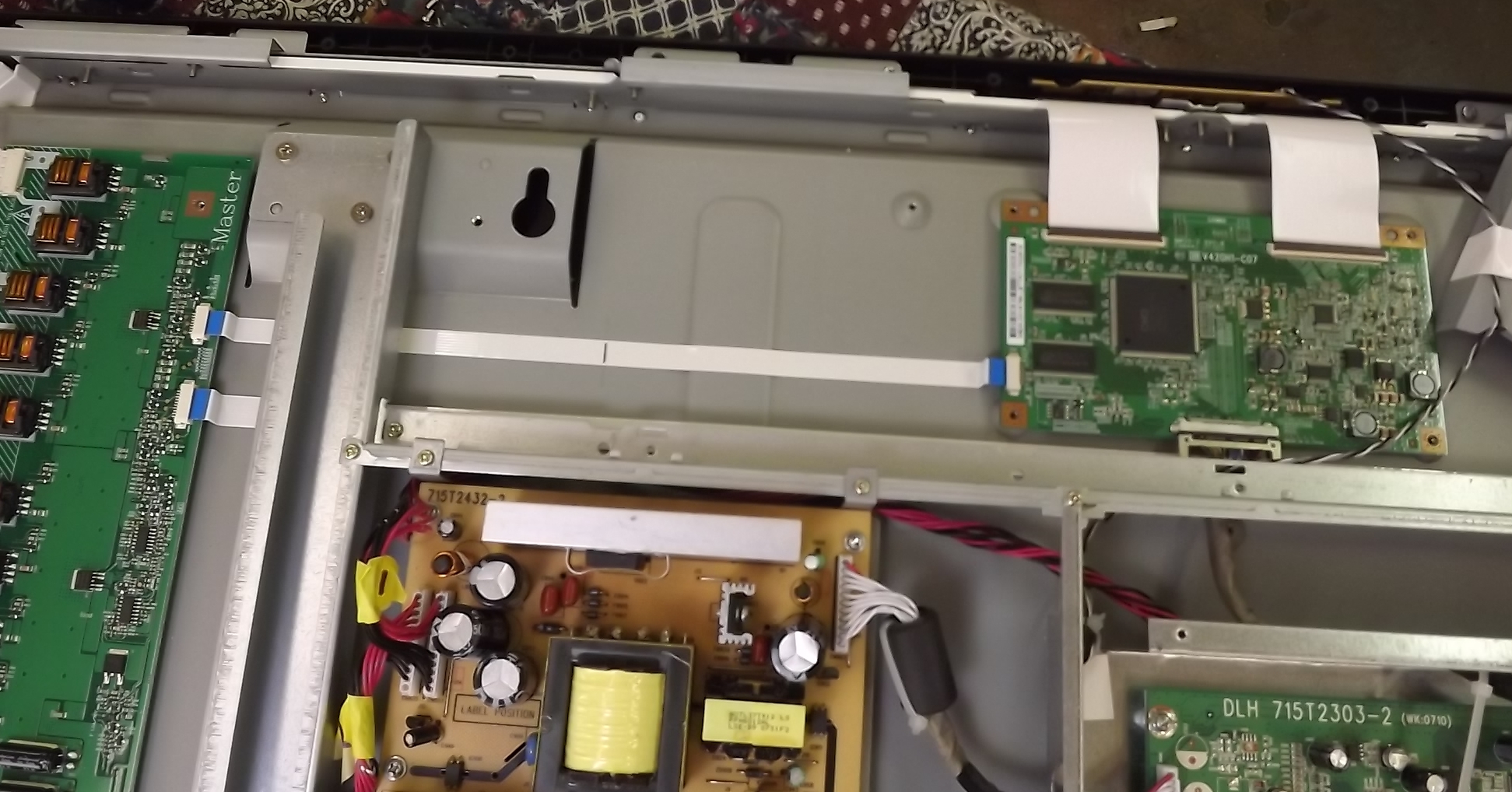

                                  I recieved the master and slave inverter boards that i ordered from shopjimmy today,but I still have no backlights guys.
                                  I double checked all the connections,and pretty sure i got everything hooked up right.
                                  I still hear that one tiny quiet chirp on the main inverter board when turning on tv.
                                  I can also can hear one tiny chirp on the main board,when turning on.
                                  I still have sound, but have not been able to see an image on the screen with a flashlight.
                                  The main board is getting warm( some places around 100 degrees tested with infared temp gauge)
                                  Im still getting 24.4 v on each inverter board,and 3.3v on BL_ON.
                                  I notice that there is a ribbon connection on the master inverter board that goes to the small board thats above the main board(I think i have read that it is called the P CON board??)
                                  Could that board cause the inverters not to kick in?
                                  I did fail to mention before that there is a small scuff/scratch in the screen that just barely got into the coating on the screen.(around 1/8'' long)
                                  Dont appear to have been a violent scratch but just maybe happend when the other people had it on its face and was working on it?
                                  But its possible it could have took a blow,I dont know.
                                  Could lamps break from an impact? If one lamp was say broke or burned out would the rest of the lamps still work?
                                  Any other ideas guys? Any help would be appreciated

                                      #58
                                      Re: philips 42pfl5432d got sound no backlight
                                      Post a picture of it.
                                      It all depends on the implementation of the pwm chip on the inverter. Some pwm chips turn on all the ccfls at once and then check with 1 to 2 seconds if everything is okay. If yes, the ccfls stay on. If not, then the pwm chip shuts down all the ccfls. We call this "2 second to black". My sig file has more info about it.

                                        #59
                                        Post a picture of it..
                                        Sorry still cant get the hang of getting good pics,Im trying
                                          #60
                                          It looks like they are for Dimming control signals for the backlights. That is the T-CON it is connected to.
