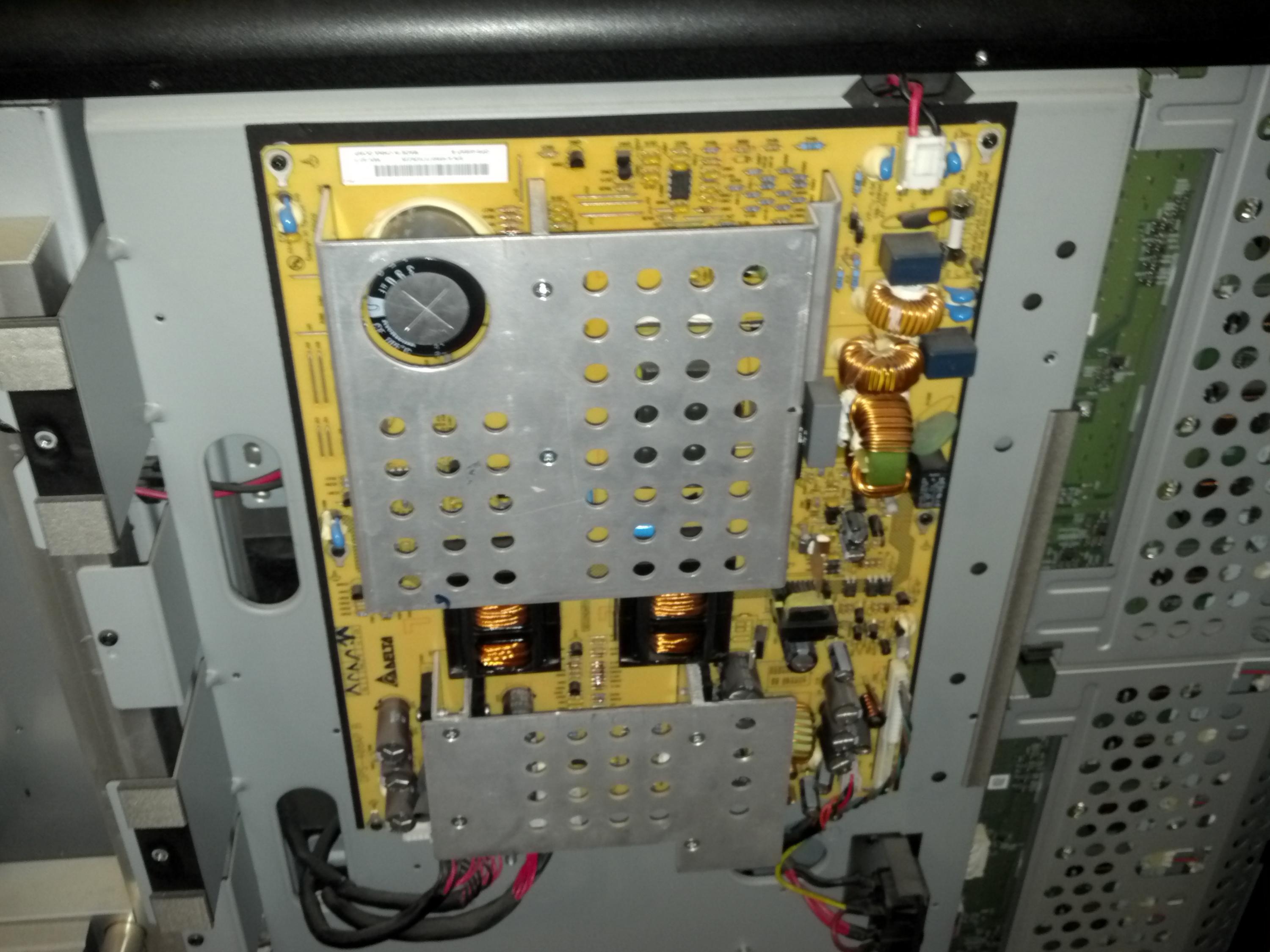

    I have an Olevia 265tfhd type 11.
    Sometimes it will work great, other times when you turn it on you get a blank screen. I can access the Service Mode just fine and I even updated the firmware just in case. I've visually checked all the caps and none show any signs of failing.
    When it works I can cycle it on and off with no issues cold or hot. If I leave it on when it works it will run just fine for hours on end. I will post pictures shortly.

    Unplug clean and reseat ALL removable connectors.
    Just in case you struggle with the pics
    Welcome to the forum-
    We can help a lot more if you please post good clear pictures of the whole chassis, and then pictures of each board, front and back and close up of connectors, (max resolution 2000x2000 and 2MB) using the manage attachments button, which is found by clicking "go advanced" under quick reply.

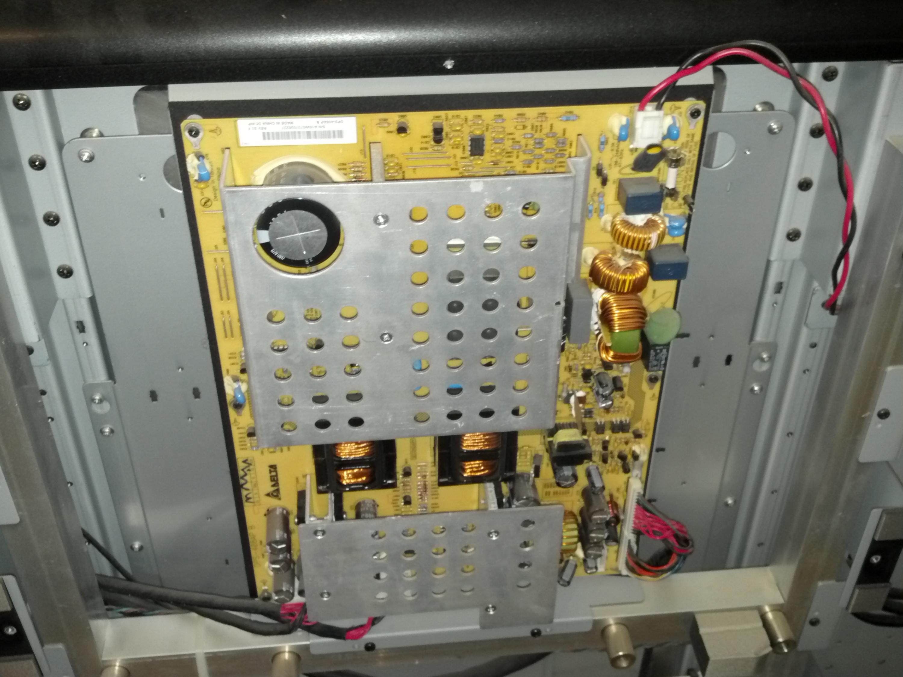

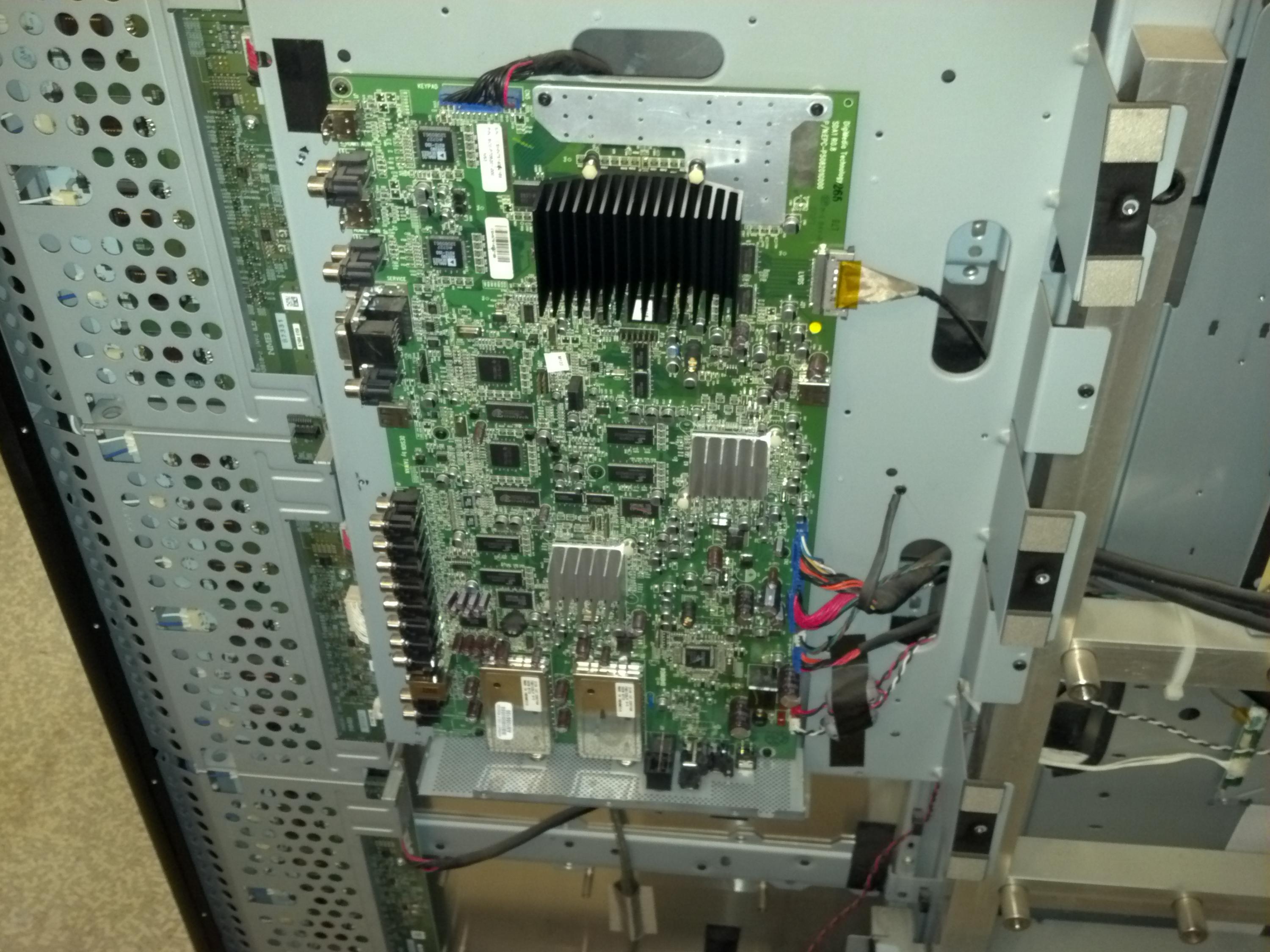

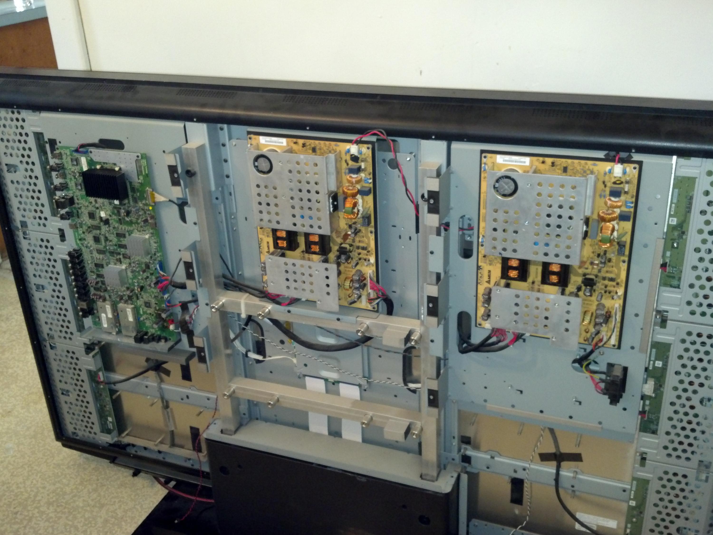

      Here's the pictures.
      A little about me: I've worked on electronics to include cell phones, computers, etc since I was a child. I can fix everything from a busted cinder block to HVAC, Squeaky door to a blown head gasket. I have an EMM for each workshop and truck.

        Update: I checked out the power supply caps and they all tested within acceptable range. I have 2 caps on my Main board that are showing some funky numbers they are 35v 1000uf caps, one of them draws down my DMM power when I try to ohm it. I also swapped the two power supplies around and had no success.
        In the past I have noticed a sizzling or static noise from the main power supply area when the TV would start up and function. Since I've had the back off I cannot get it to function properly so I can track down the noise. All I get when I press the power button is the click of the Relay on the main PS and an energizing noise from the Tcon board which lasts about 1 second.

          It is no longer Intermittent, it now does not function at all. I replaced a couple questionable Caps today with no results. I am no longer able to get the TV into Service mode either.
          Steps I have taken:
          * Clean and reset all connectors
          * Replace questionable Caps

            Check again using your pictures that you have ALL the cables re connected (it does happen believe me) Also if speakers are disconnected re connect as someone has said recently that some sets go into error mode if none detected.
            Check there is an earth screw on each board that is in contact with the frame
            This is the first time I have seen a set with twin power supplies - the pictures are not really clear enough for troubleshooting
