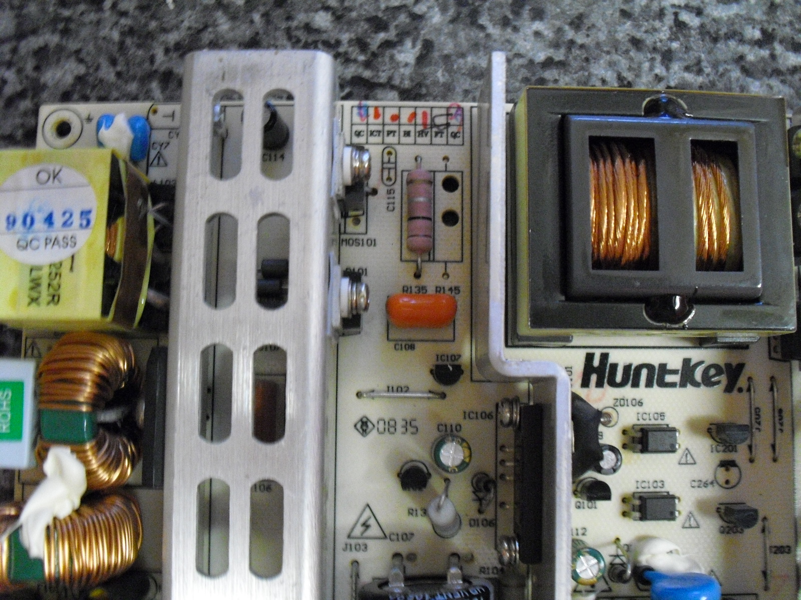

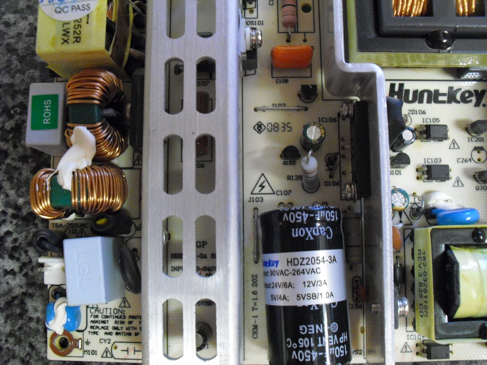

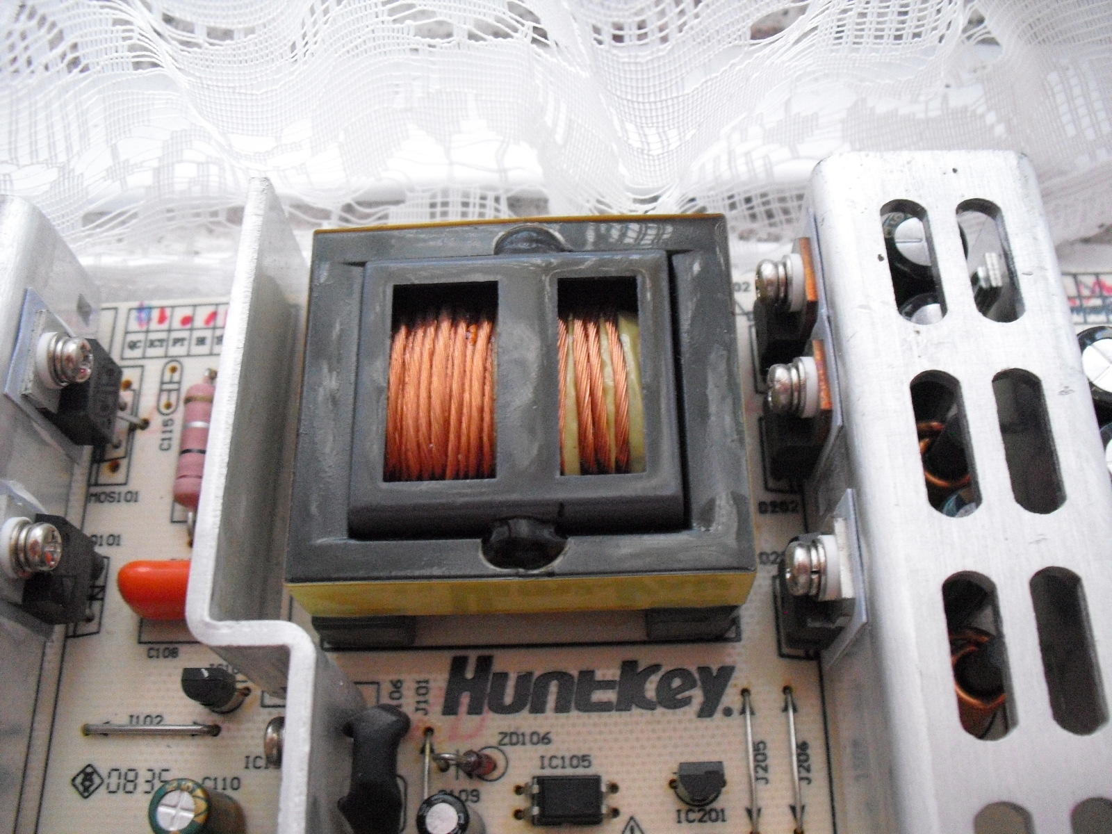

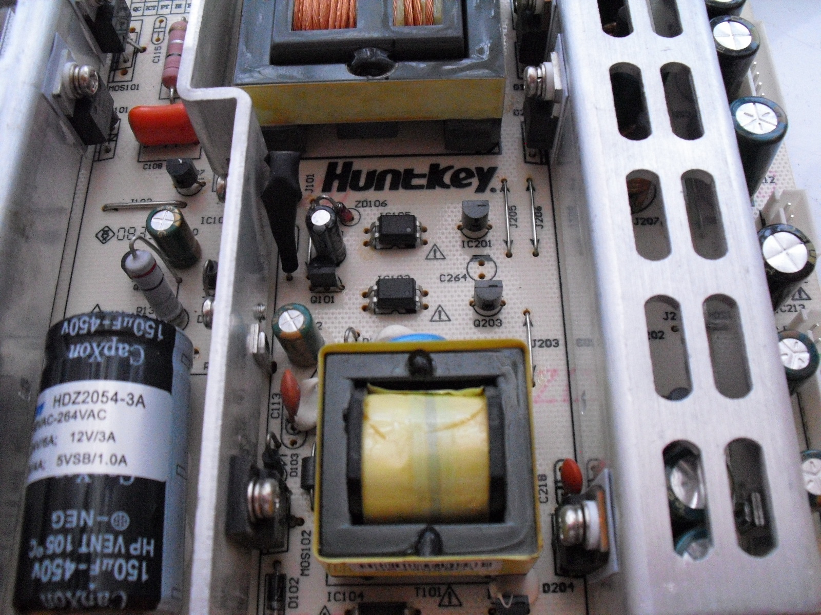

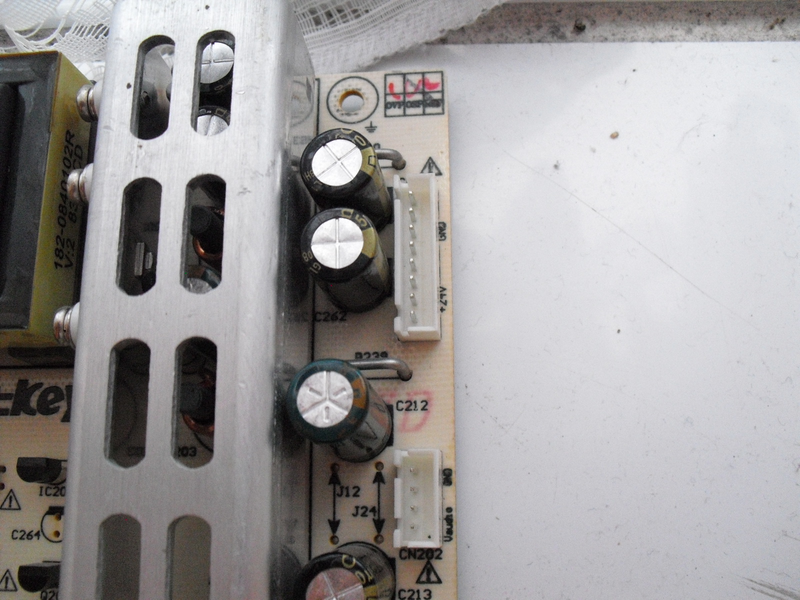

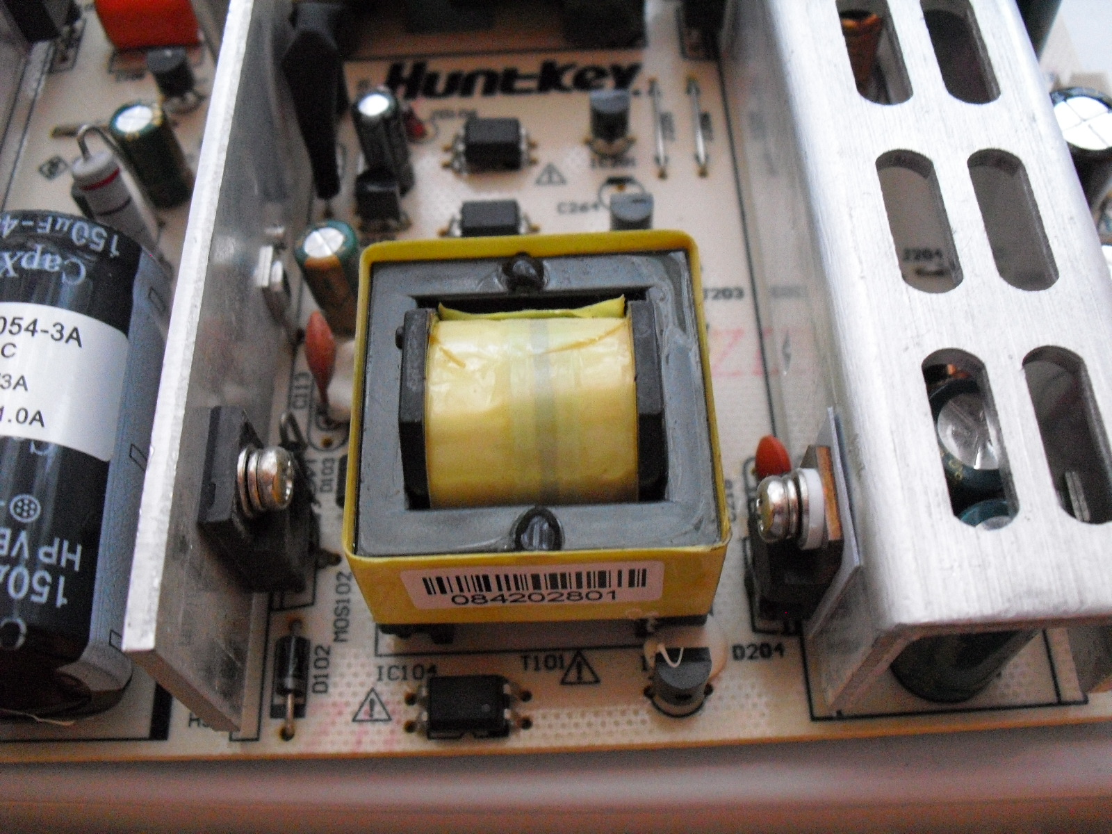

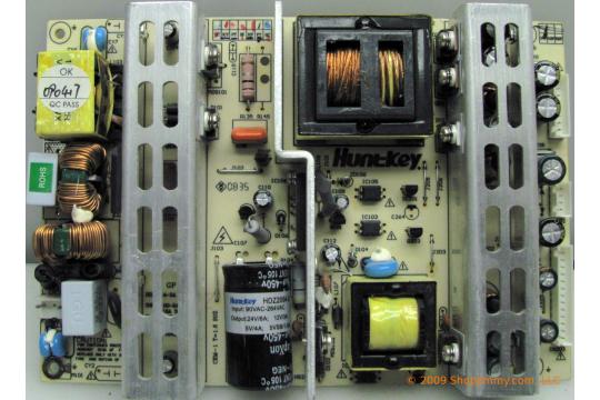

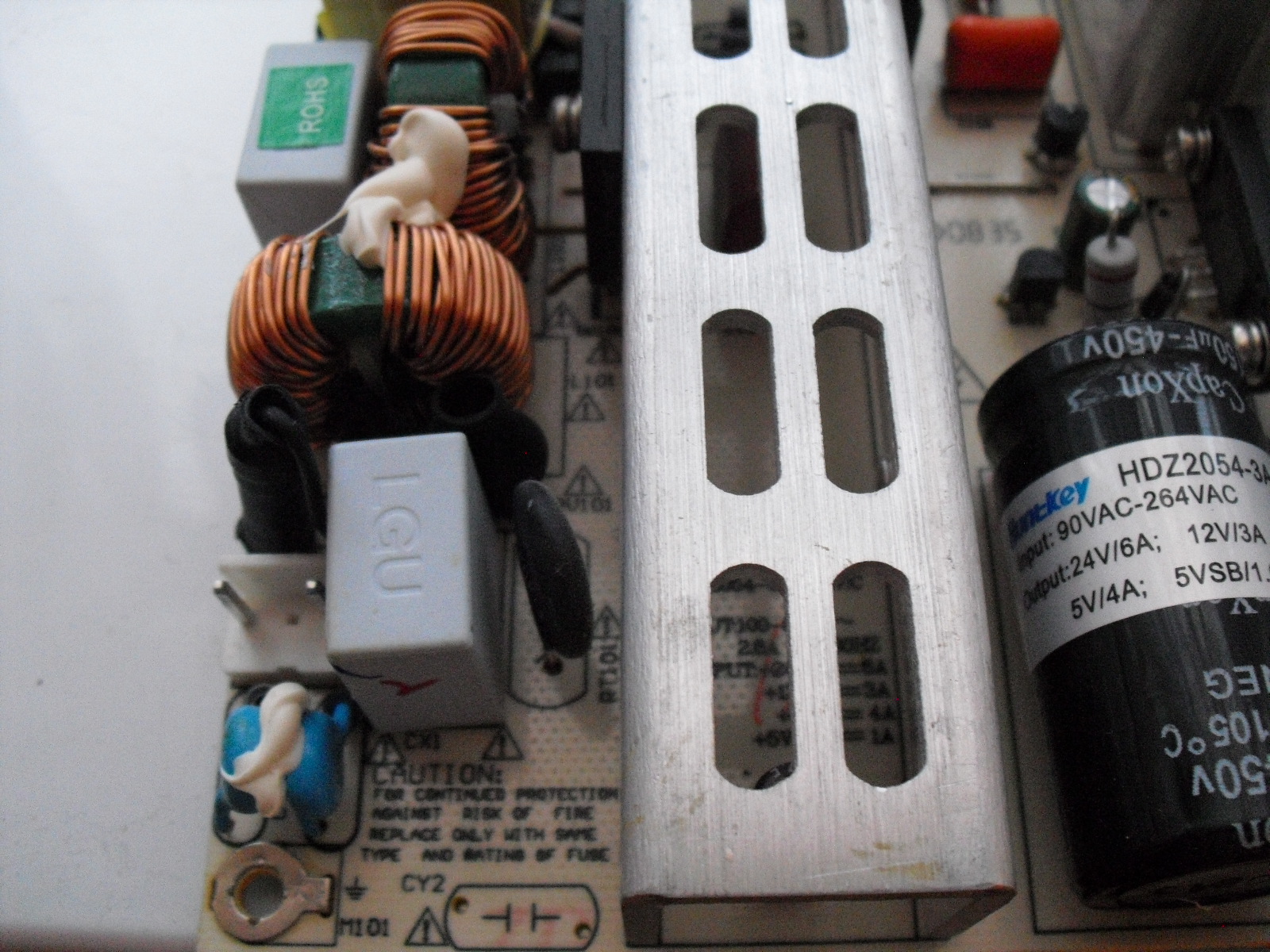

                                      • sienoki
                                        sienoki
                                        • Jan 2012
                                        • 314
                                        #39
                                        Re: Neon C3298DVB stuck in standby
                                        Originally posted by sienoki
                                        Thx fella 4 sticking by me i really appreciate it..im gonna get good photos sorted soon so i will leave it till then..thx again

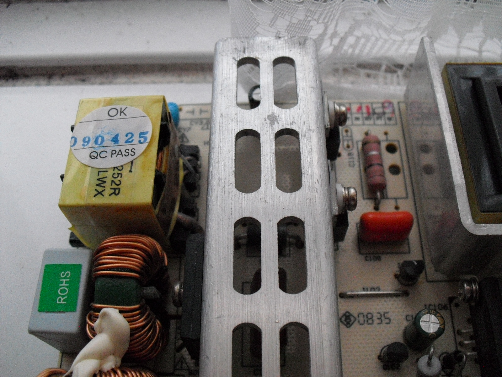

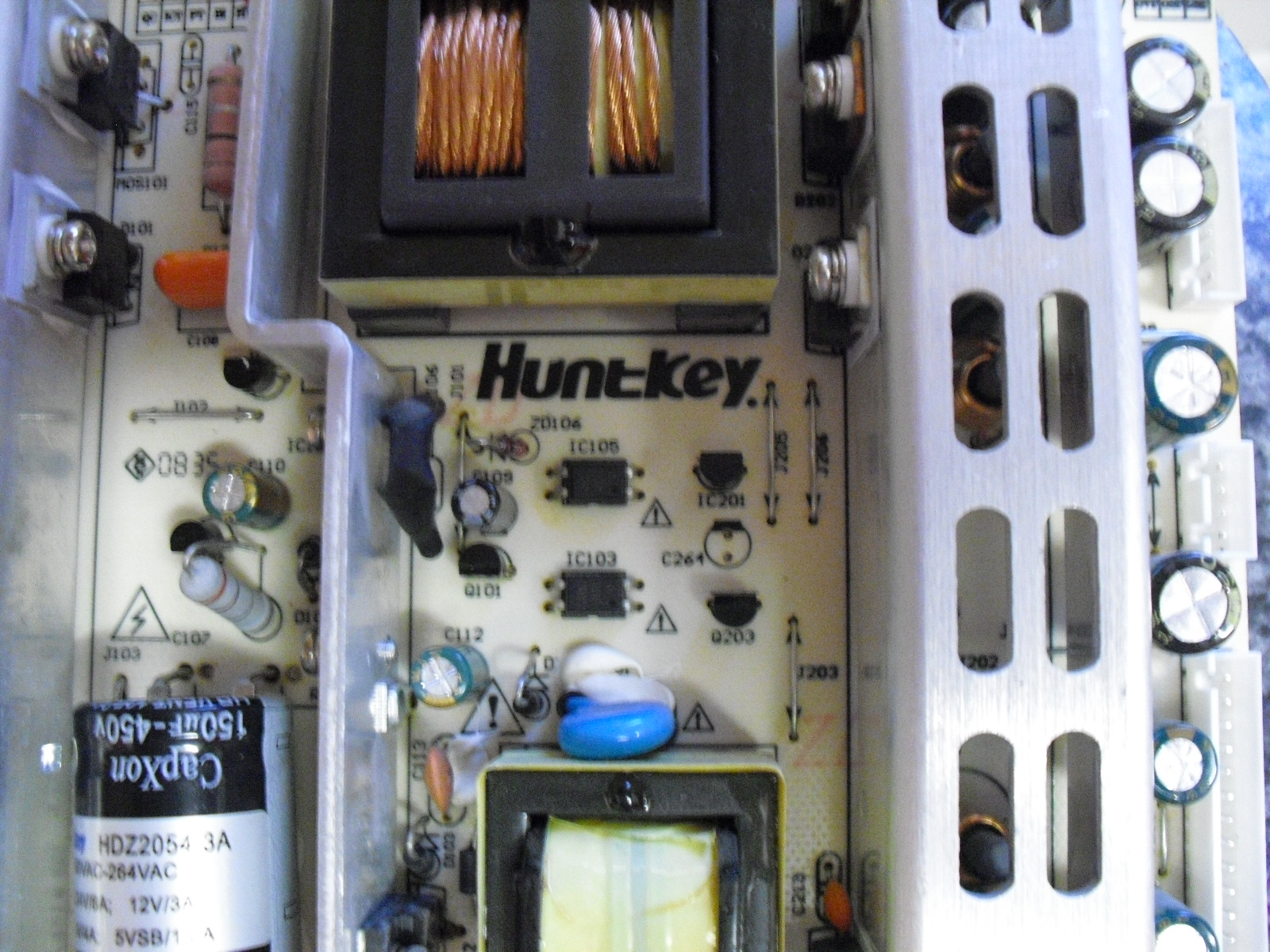

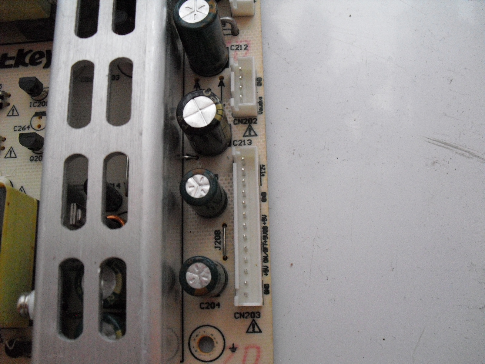

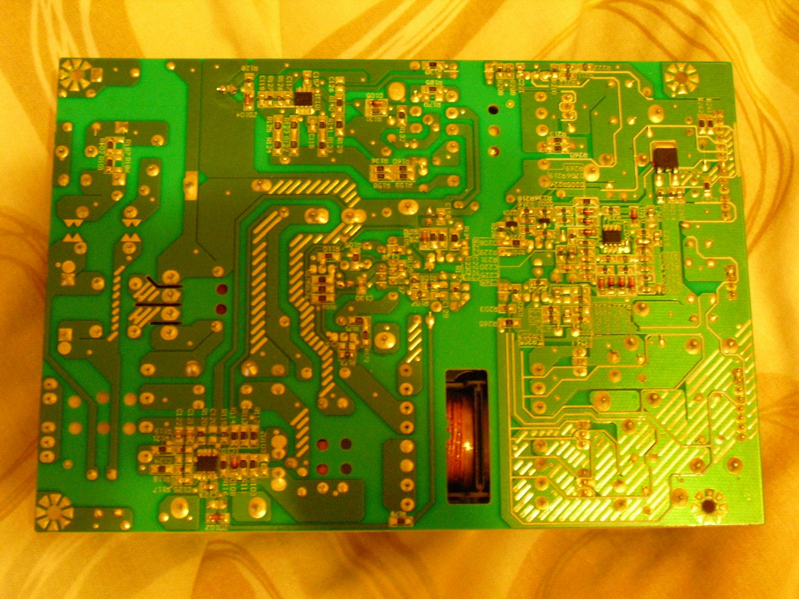

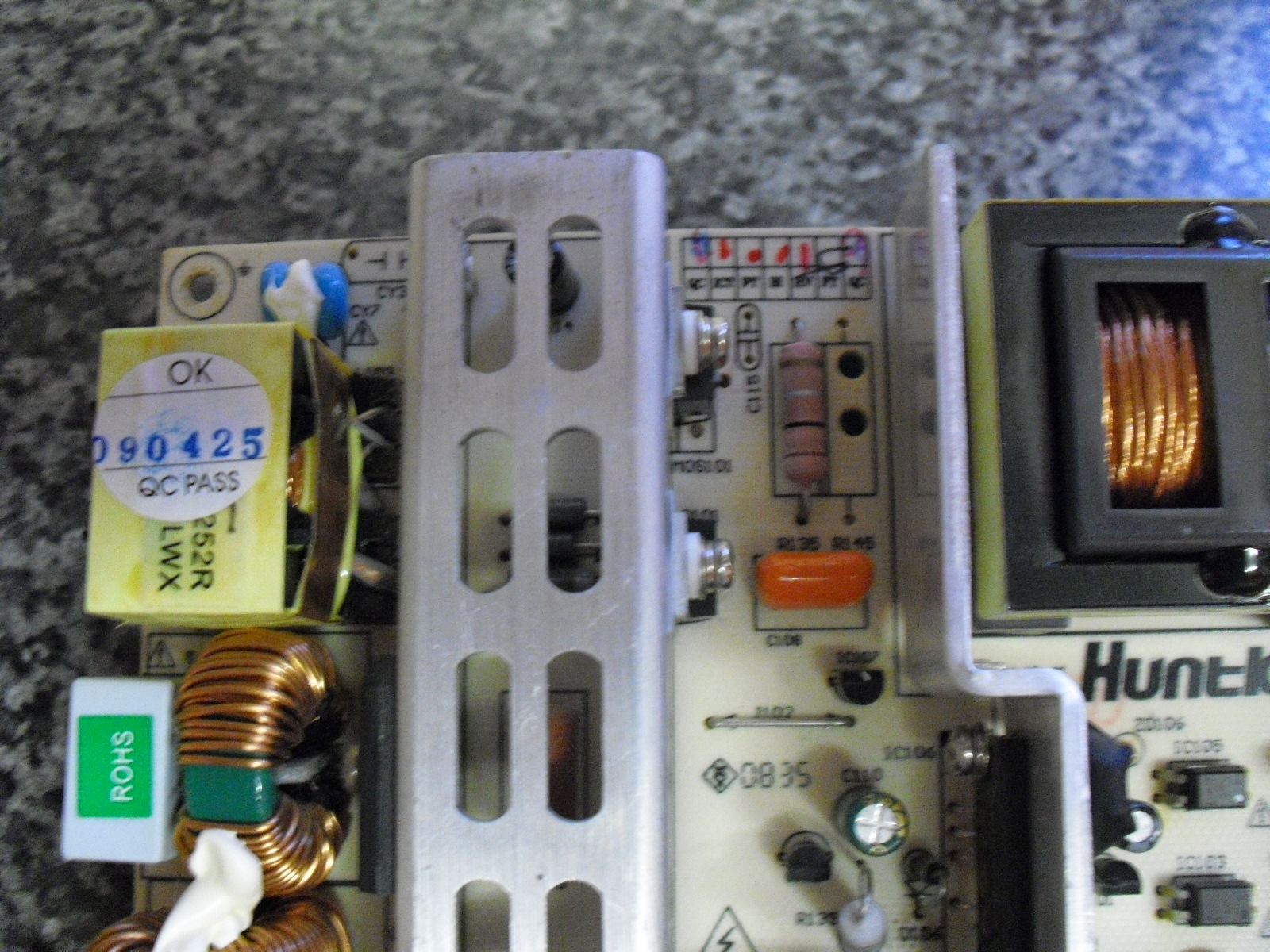

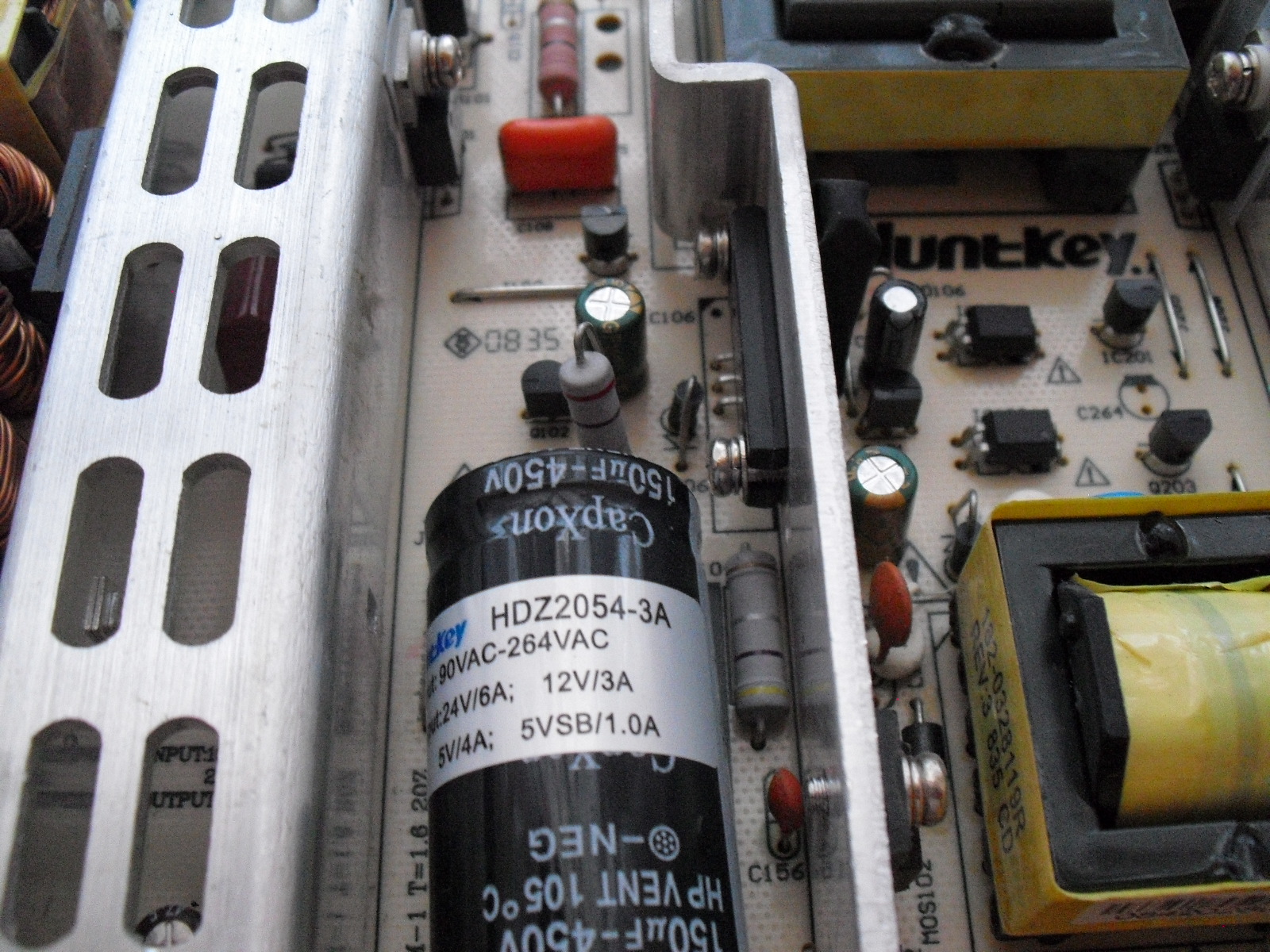

                                        These are best pics i can do 4 now..hope they help..thx
                                        • sienoki
                                          sienoki
                                          • Jan 2012
                                          • 314
                                          #40
                                          A pic ok underside psu
