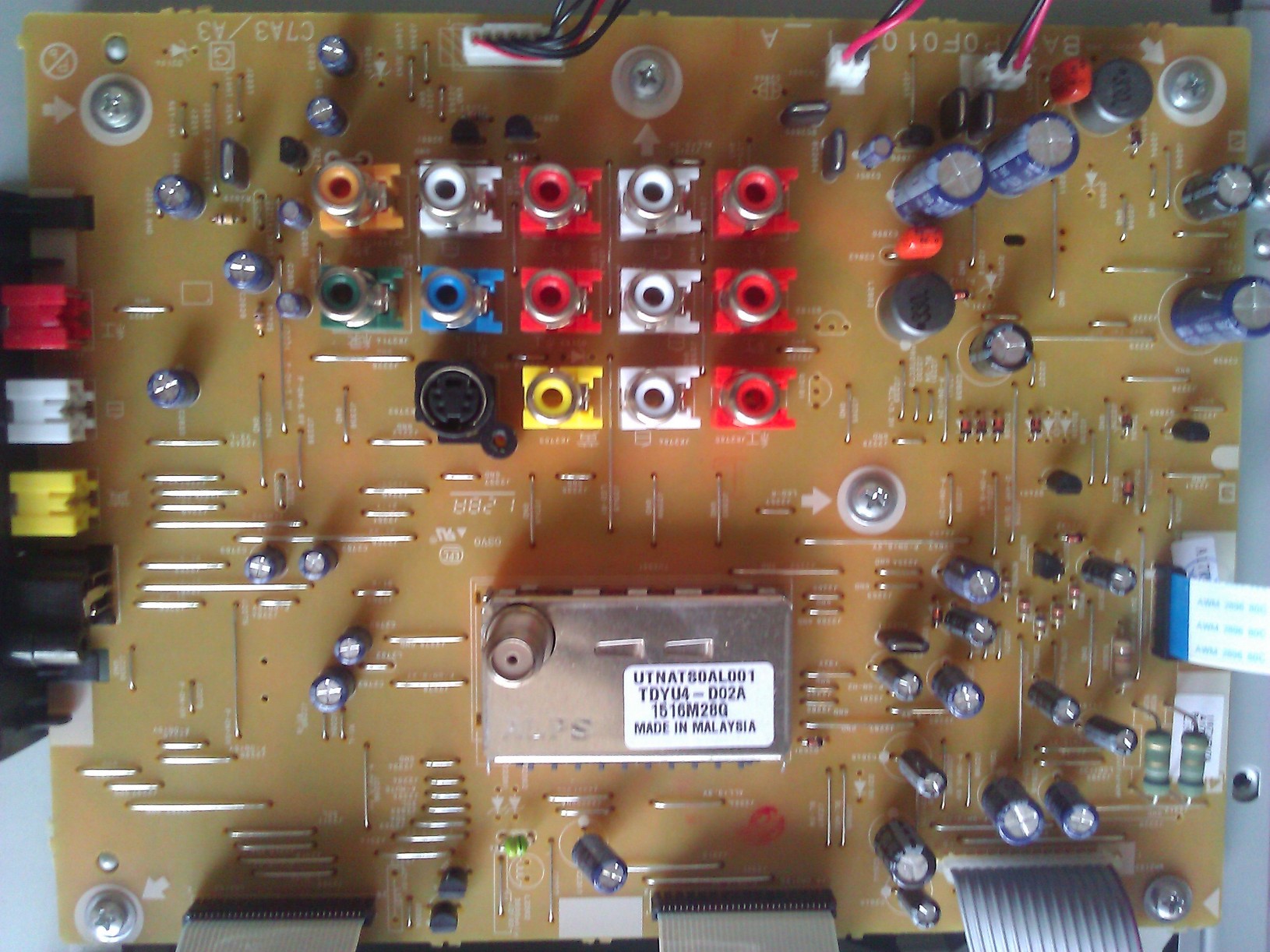

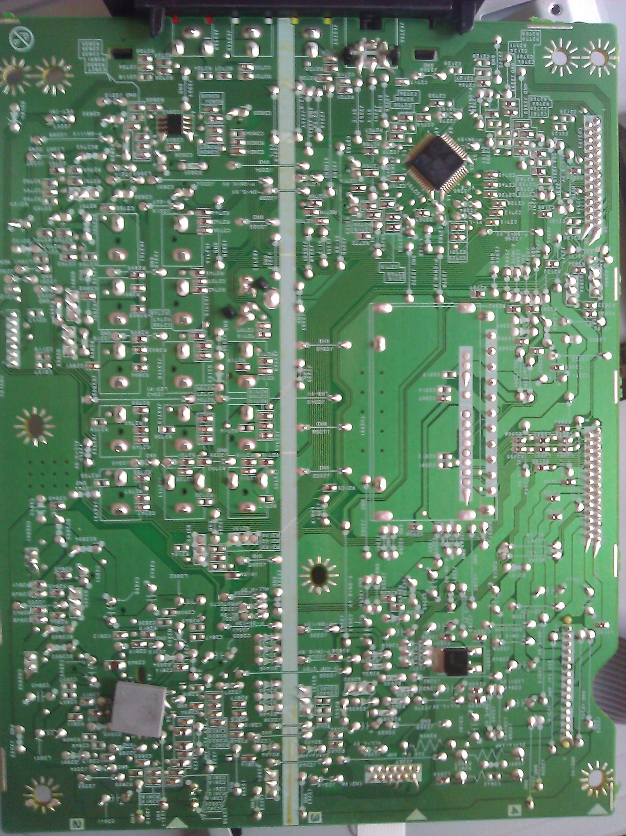

          Re: Emerson LC401EM2F
          Looks like a short on the main board then? Picture s of both sides will be required.
          Check the cable is not shorted/damaged. Pins bent touching etc - look at sockets for same.
            #45
            Hope those are good enough.. I think I had to many beers last night at the BBQ and have the shakes
              #46
              I am starting to think that the PS and this board both have some issues.. About ready to take the easy road and order the boards..
                #47
                Pics too fuzzy did you test the cable try it with all the cables unplugged
                except the one to the ps.
                  #48
                  I messed with it some last night... I tried all diff combos of boards unplugged..There are 2 flat cables that go from the main jack board to the digital HDMI board.. When I unhook those 2 cables, then it does not blow the fuse... But I still get NO life from the TV... I will try to get clearer pictures after the sun comes up and I have better light..
