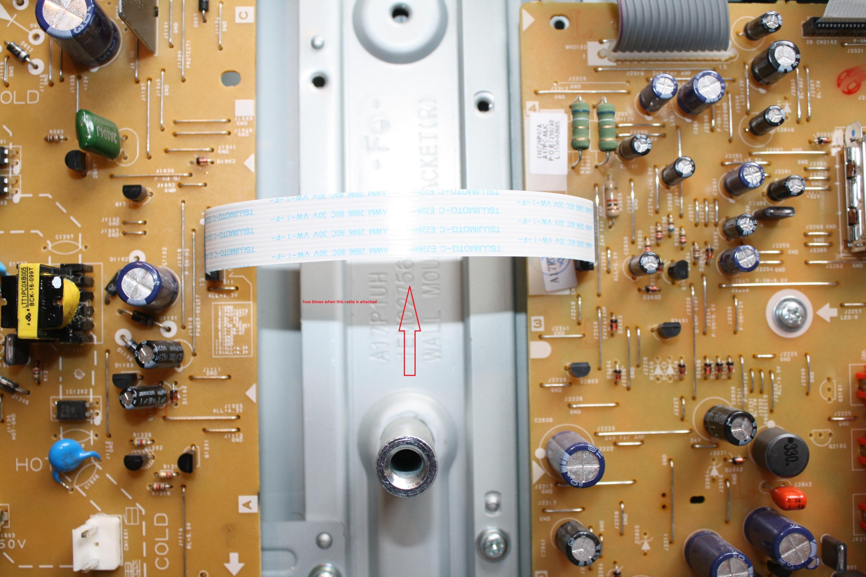

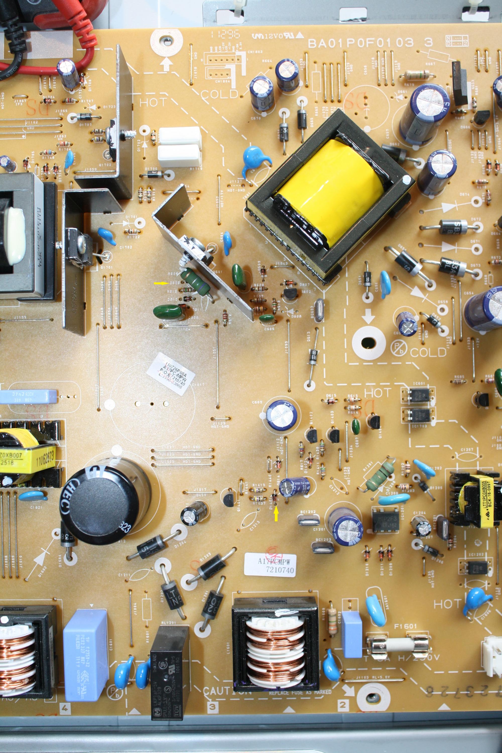

    Hello. I have an Emerson 40" LCD TV that stopped working. I removed the back panel and noticed the 8A 250V fuse near the AC input was open. I'm pretty familiar with working on computers (replacing caps, power jacks, etc.) but I know little about TVs.
    I can simply replace the fuse, but I'd rather check around and make sure everything is good before I put power to it again. All the caps look fine, no signs of damage visually.
    I saw a Youtube video where someone had the same problem. He determined, without saying exactly how, it was on the AC side. Then he determined he had two bad diodes. Again, he didn't say how. Can someone walk me through what I should test?
    Thanks!

    Did anything accompany the not working? Bang Flash?
    Was it subjected to any powersurge.
    One way instead of testing all components is to rig a lightbulb in place of the fuse - see here
    http://antiqueradio.org/dimbulb.htm
    Dont think we fixed it but this will give you some ideas
    https://www.badcaps.net/forum/showth...M2F#post250318
    You will need to post pictures of YOUR boards.

              Same model here and same problem... Blows the fuse as soon as its plugged in. Been busy with back to school stuff so I have not had time to mess with it.. But, I have unhooked all boards.. And one by one I hooked them back up..
              Grey flat power cable going from PS to Main, fuse fine but no life on standby lights or power.Next was Flat white slip in ribbon cable going from PS to main
              and thats when the fuse blows..Hopefully I can find time soon to get back to my TV stuff.

                Ok I have some time to mess with this.. Here are a few results from some diodes that I have tested
                D1215 Is reading large # s in both directions
                D1401 " "
                D1603 " "
                D606 Reading 000 both directions

                  Remove D606 and retest. I normally use diode test function on the multimeter.

                        Readings in diode mode with D606 Removed
                        D606 OL .663
                        D1215 .027 .027
                        D1603 .125 .142
                        D1401 .665 other way Climbs to .980 then OL

                          D1215 and D1603 are both shorted in circuit. Remove both and retest out of circuit.
                          D606 is good out of circuit. Leave it out of circuit for now.

                            D606 may be in parallel with something with low Ohm usch as inductor/transformer widing or very low Ohm resistor.
                            D1215 .027 .027
                            D1603 .125 .142
                            These two looks bad, are you measuring them in the circuits or they are removed?

                                I always test them out off the board when they read bad/strange on the board, it just a way to verify for sure.

                                  Ok all of the following out of circuit..
                                  D606 OL .663
                                  D1215 OL .547
                                  D1603 OL .660
                                  D1401 OL .653

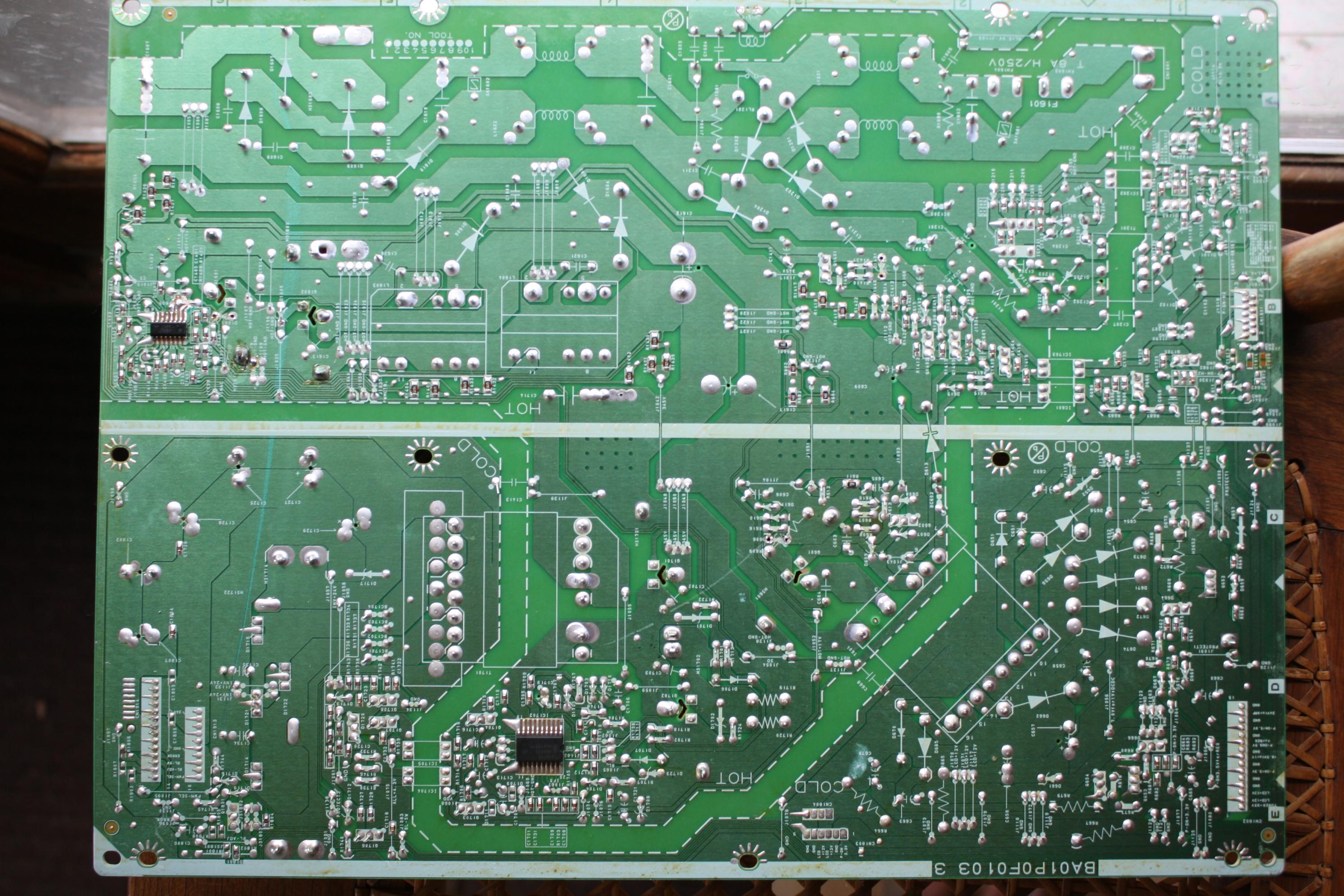

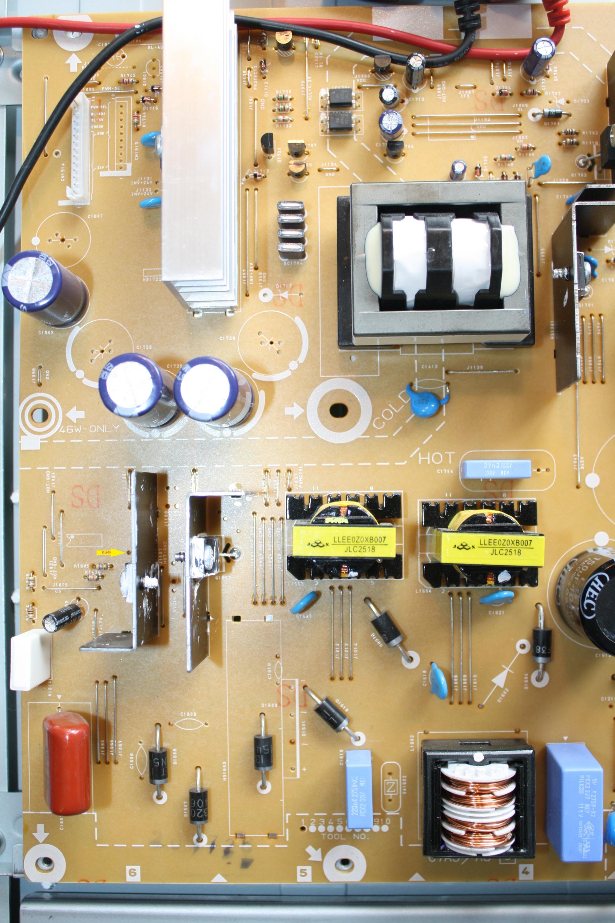

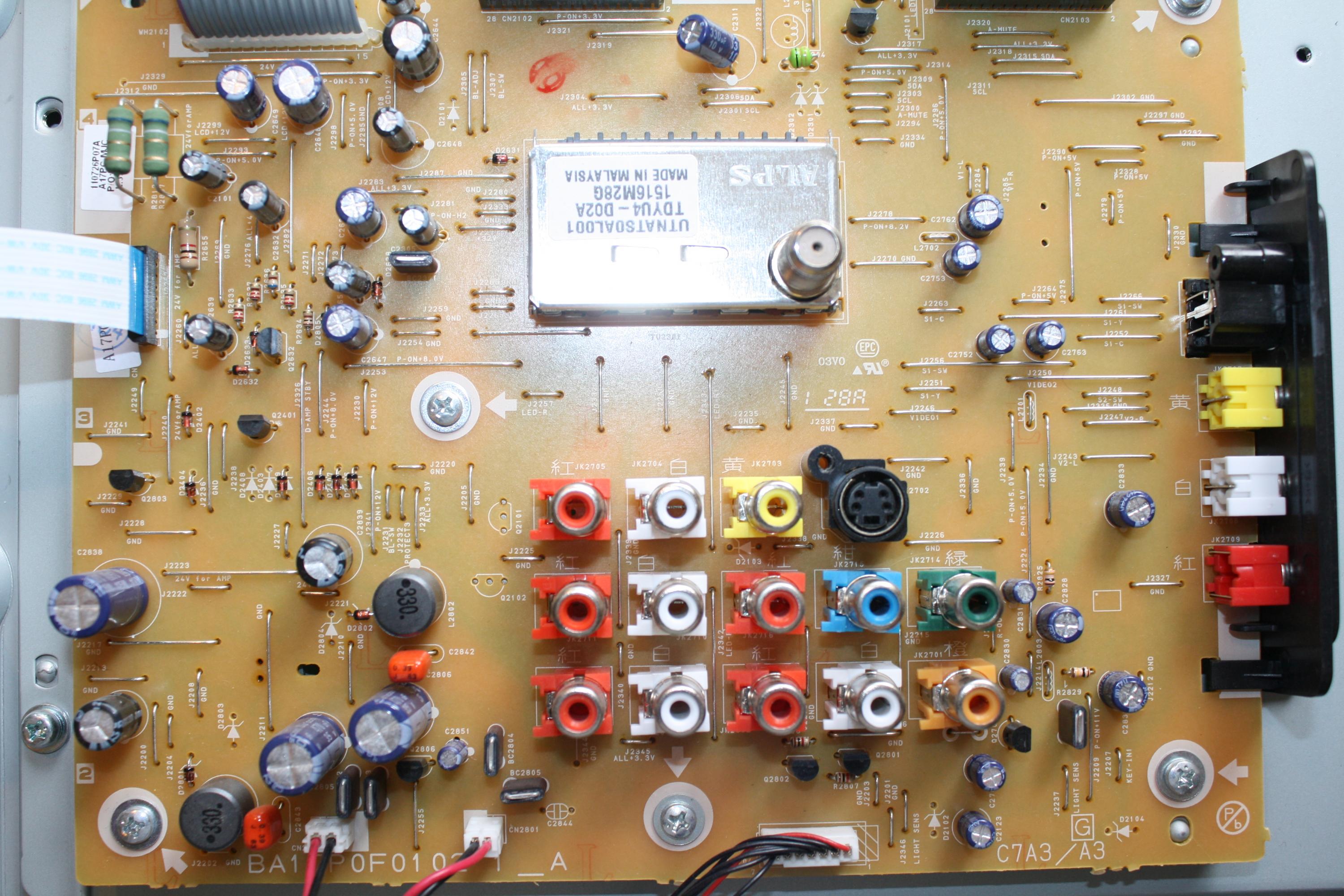

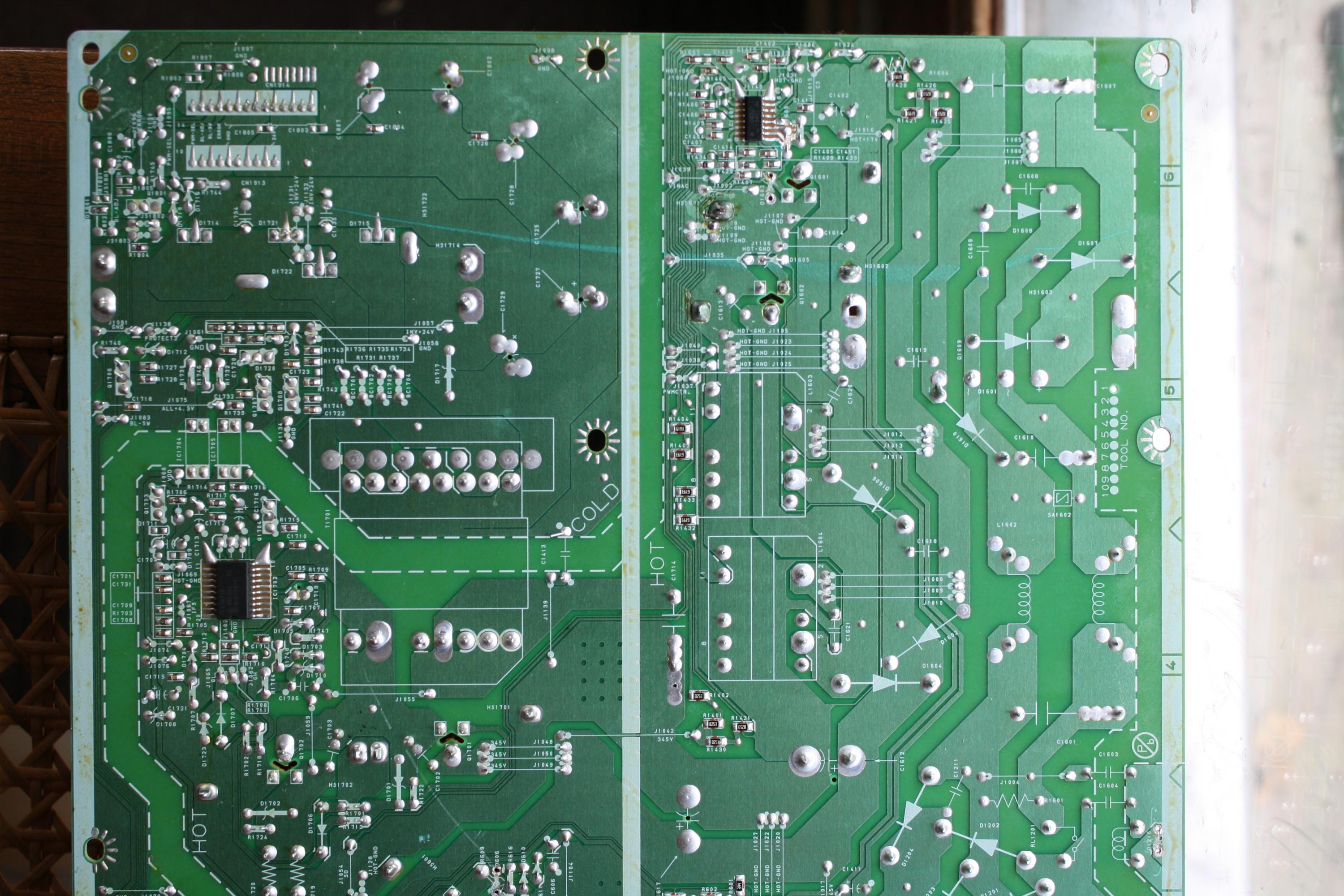

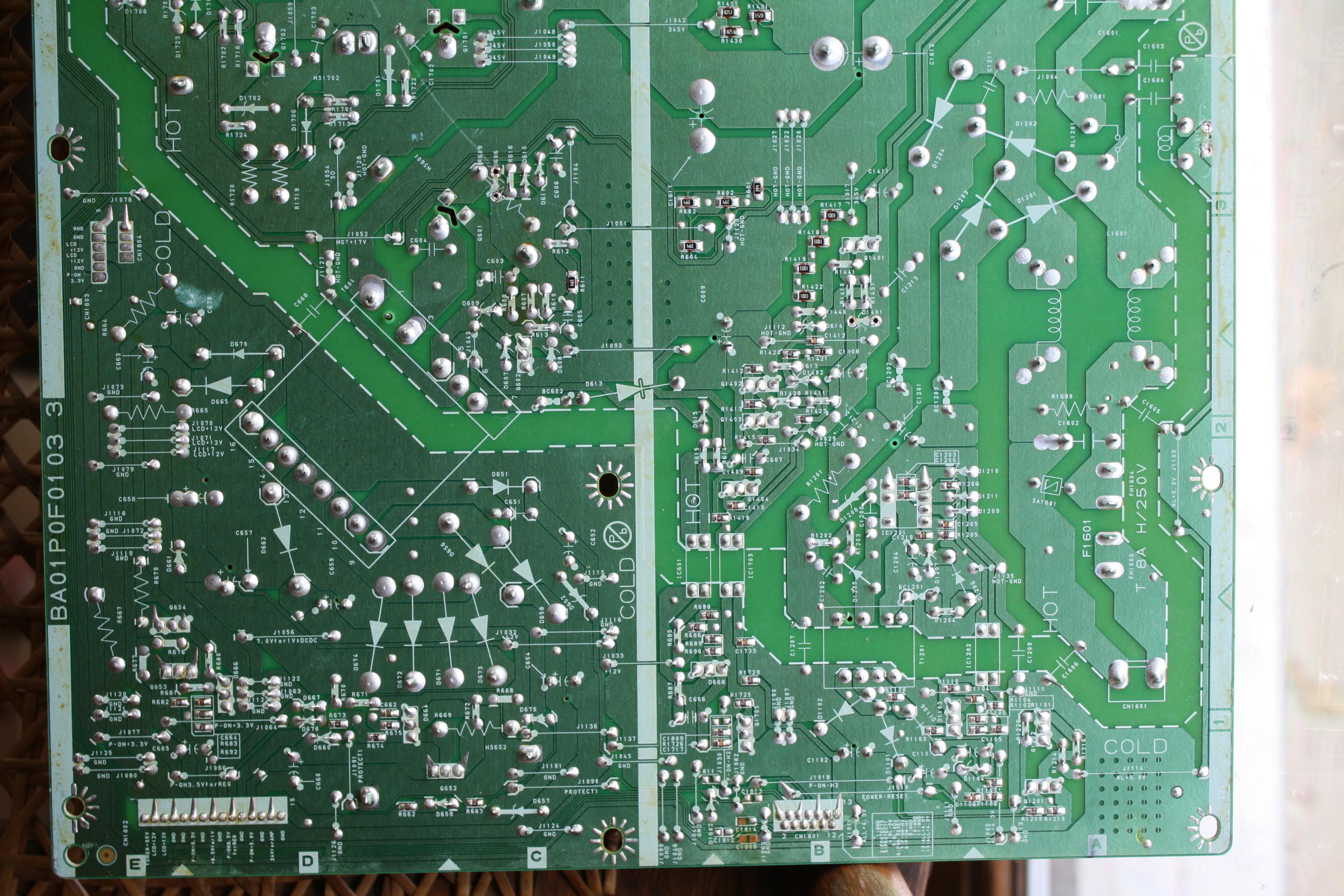

                                    Re: Emerson LC401EM2F
                                    At this point I will need really good clear pictures of the bottom side of the board to trace out the connections and see how these Diode are hooked up. They tested OK out off the board.
                                    • lilmonk3
                                      • Apr 2012
                                      • 259
                                      If those are not good enough, another member posted some pics here https://www.badcaps.net/forum/showth...M2F#post250318
                                      Its cloudy here today and I have crappy lighting in my house
                                        I rather use yours clear pictures since other board may not be the same revision, it is already hard enough try tracing the connections without having the board in front of me while toggling back and forth between the picture of the top of the board and bottom of the board to get correct part locations. I may ask for closed up later.
                                        Can I get the picture of the top board that I can see the whole board, your earlier pictures cutout part of the board.
