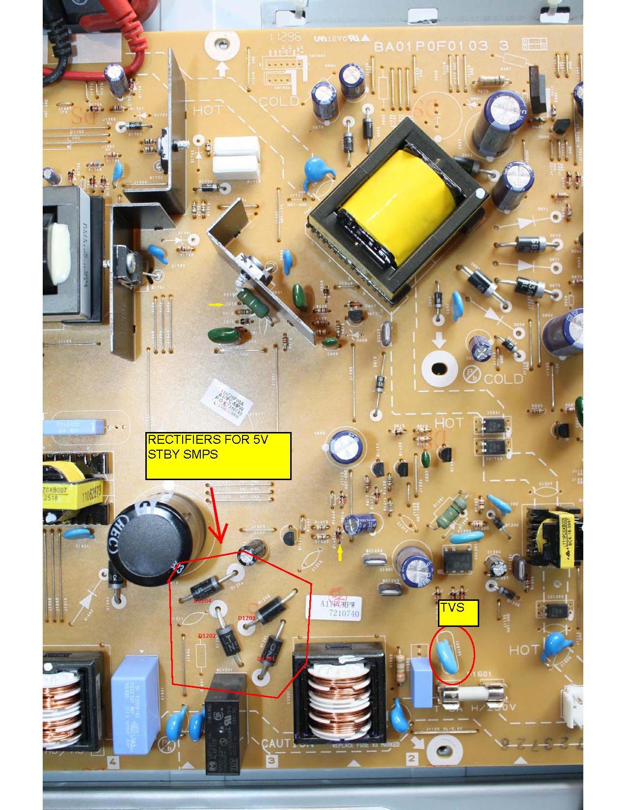

      It is blowing the main fuse the minute you plug it into the outlet?
      Please check the resistance reading (meter set to Ohm mode 200 Ohm range) for me as noted (board not installed or plug in).

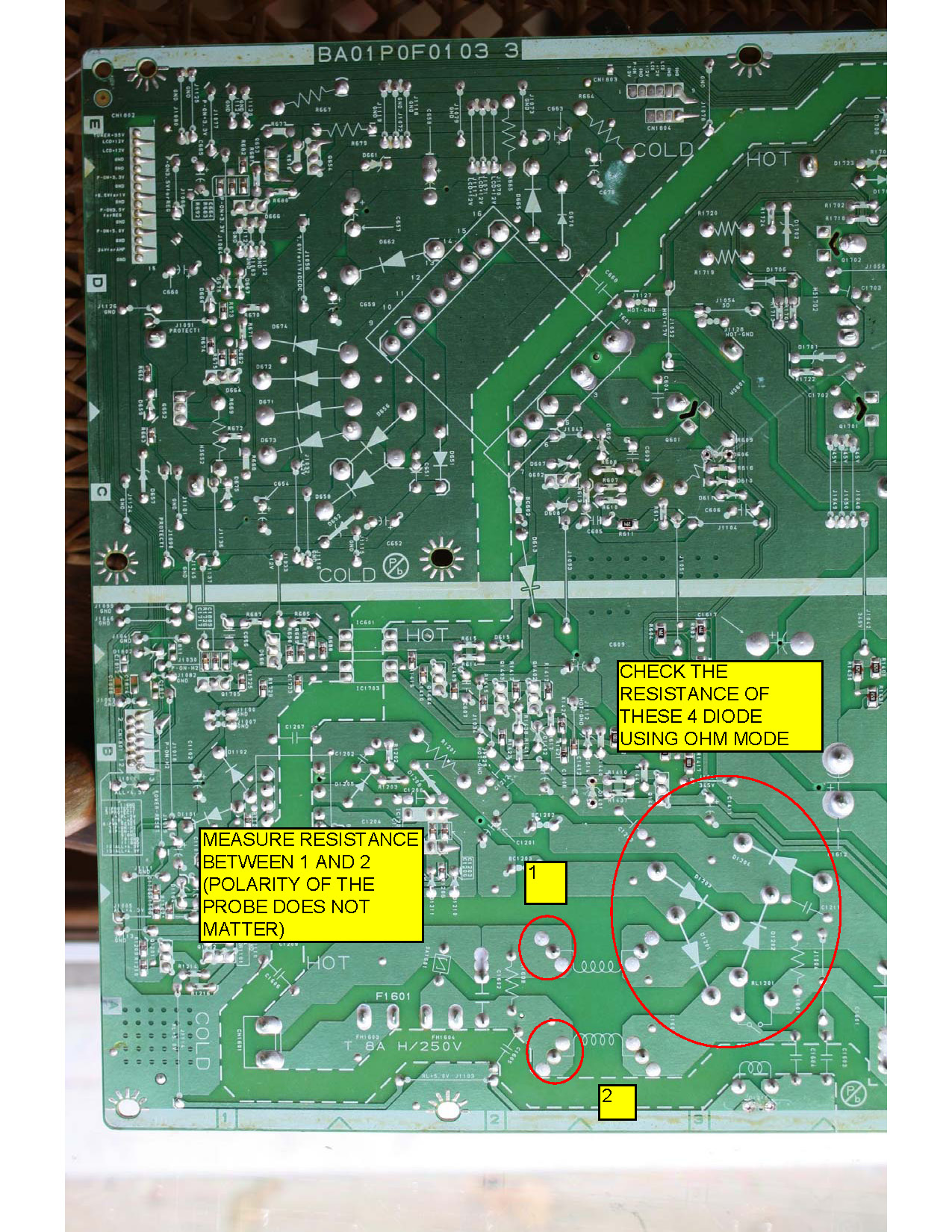

            Re: Emerson LC401EM2F
            OK, please check the resistance of the Diodes I red-lined in picture 1 & 2 tell me what you get.

                Set meter to Ohm mode, auto range is fine, we are looking for shorted parts which will no longer act like semiconductor any more, it will read low Ohm in both directions.
                Again, take the reading of the bad part off the board when it shows bad on the board to verify, you can just lift one leg off the board and take the reading also.

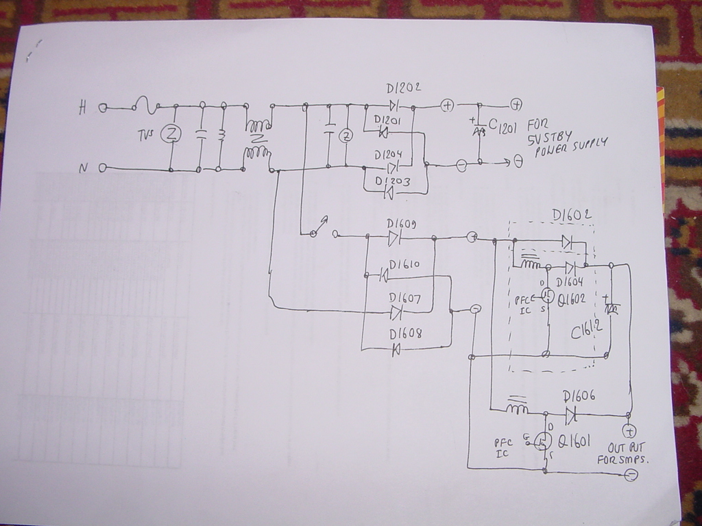

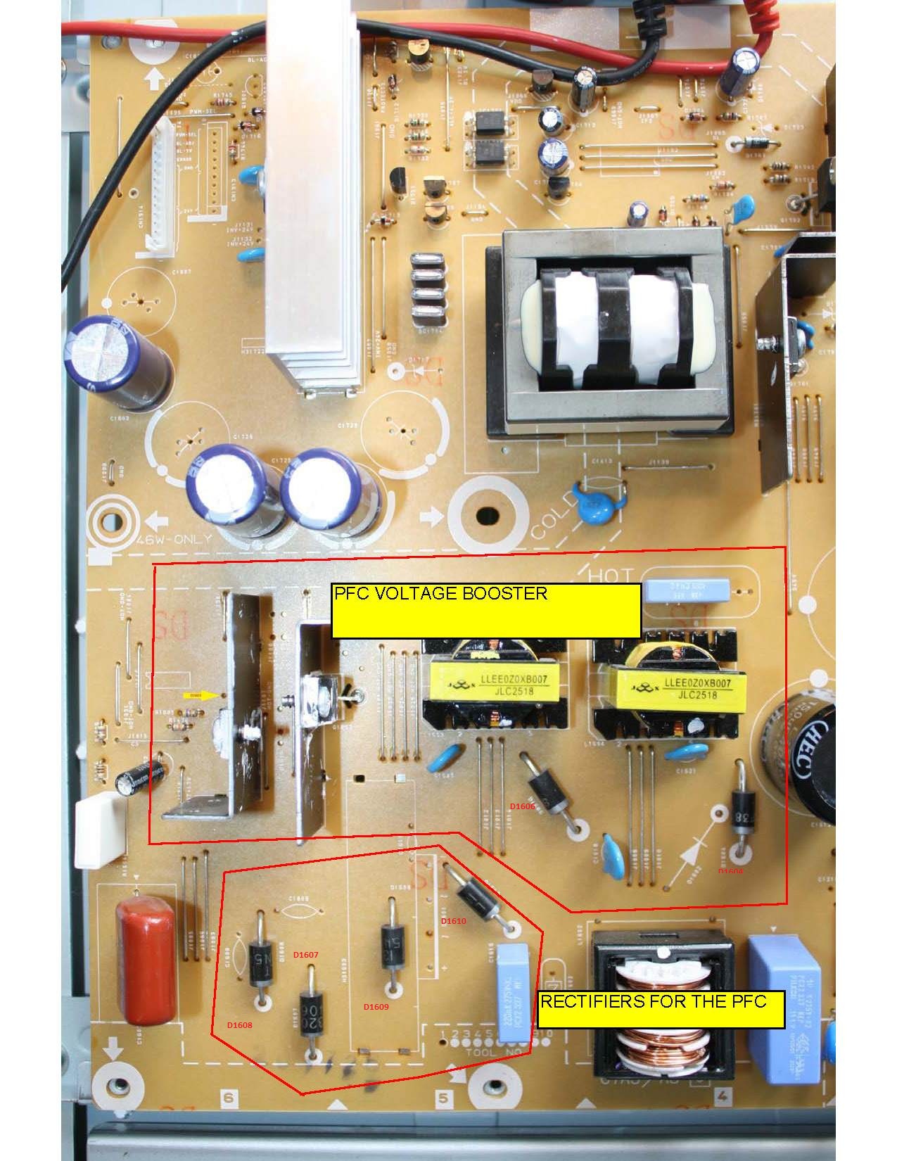

                This power supply uses dual PFC circuits. The two MOSFET's may be shorted out, the B+ to the PFC is supply through the relay, so if the main is not connected, the PFC will not get any power to it, which is why it did not blow the fuse when main board is connected, the 5VSTBY SMPS is before the relay so it is always running with its own rectifiers which is OK since it did not blow the fuse.
                I cannot see the number too well in the pictures.
                Where are the D1604,D1606? Are they in the second pictures? the group of 4 in the bottom left of pic#2? My eyes are not that good.
                This is what I come up with. The MOSFET or DIODE for the PFC may be shorted, or MOSFET for the SMPS may be shorted also.

                  Ok here are the readings of the diodes in pic 1 and 2 with one leg lifted..
                  D1201 OL 4.60
                  D1202 OL 4.90
                  D1203 OL 4.39
                  D1204 OL 4.21
                  D1604 00.3 00.2
                  D1606 OL 2.94
                  D1607 OL 4.84
                  D1608 OL 4.73
                  D1609 OL 5.26
                  D1610 OL 5.05
                  I marked up the board in the pics below .. My eyes are not very good either

                    D1604 00.3 00.2
                    D1604 is bad if that is tested out of circuit.

                              Please check Q1602 as shown in my drawing also, just to be sure it is not damaged.
                              just label the pin as 1, 2, 3. Then using Ohm mode and report the readings:
                              1 & 2 =
                              1 & 3 =
                              2 & 3 =
