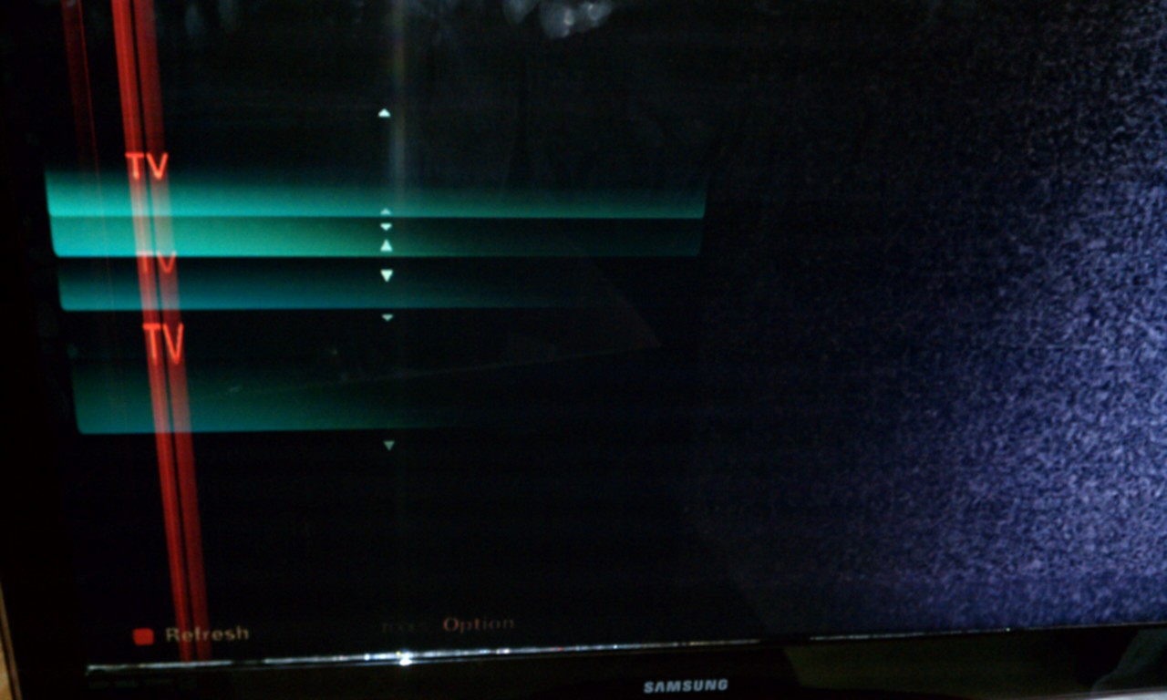

    Hey yall. I got a Samsung 40" LCD TV that turns on and functions fine, but everything on the screen is tripled. Like double vision, but tripled. I have never seen this kind of thing before. Please help me I am not sure where to start here. Thanks

    Without seeing any pictures of this problem my first guess would have to be main board, is the problem on all imputs as well as the On Screen Display (OSD).

      Sorry I have no pictures, it is disassembled at the moment. I will button it together and get you pictures. Also It does it on all inputs at all times. Sometimes if it sits powered on for an hour or so, it will start to clear up.

          Yes the channel number is tripled, the menu box is tripled when I watch a channel, everything is pretty clear, just tripled.

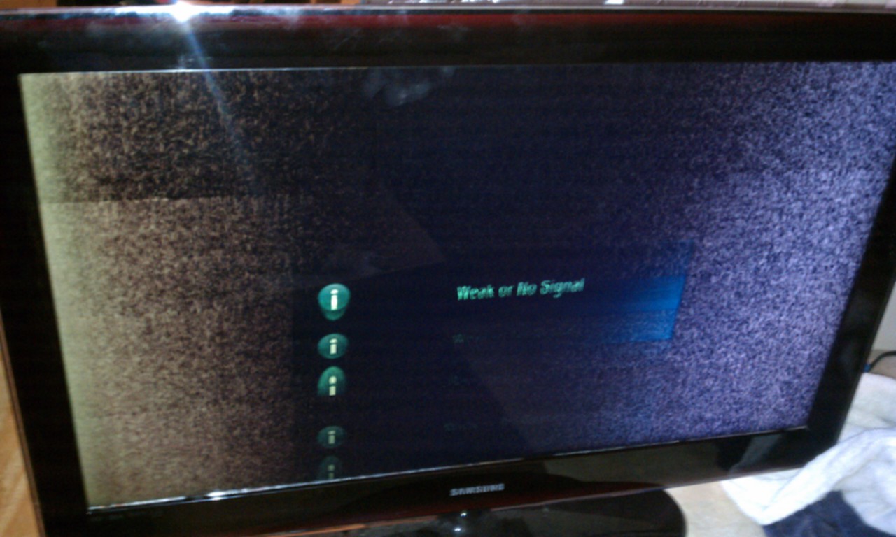

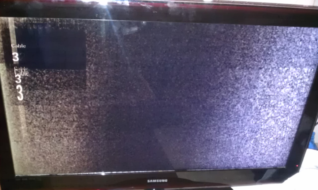

                Here are some pictures of whats going on.
                  Re: Samsung LN40A650 triple vision picture help!
                  That is most likely a bad LCD panel (the actual LCD is failing.) It may or may not be fixable. Can you get hold of a freeze spray can or compressed air can?

                      spray all four edges of the lcd panel where it meets the plastic with freeze spray,if the picture comes back tempory,then its the panel at fault,the freeze spray will tighten up the contacts around the tab bonds.

                          Ok so I sprayed it so much, that there is frost on the tv...lol. It didnt change...could the Tcon cause this?

                            Try to wiggle the panel .is there any change?

                              when I shake it it flicker but the picture stays tripled and doesnt change.

                                Ok so I spray it a lot more, and the picture came back to normal. How long will it stay good? Is it worth buying a new panel?

                                    ok so I went to this forum http://www.highdefforum.com/flat-pan...ln-t4661f.html and I did the foam fix and it works great now! Just thought I would let yall know.

                                      I hope it lasts. It works sometimes, but not always.
                                        I do not have much luck my screens, the foam (I use high density foam) will shrink down as time goes by and the tabs become loose again.
