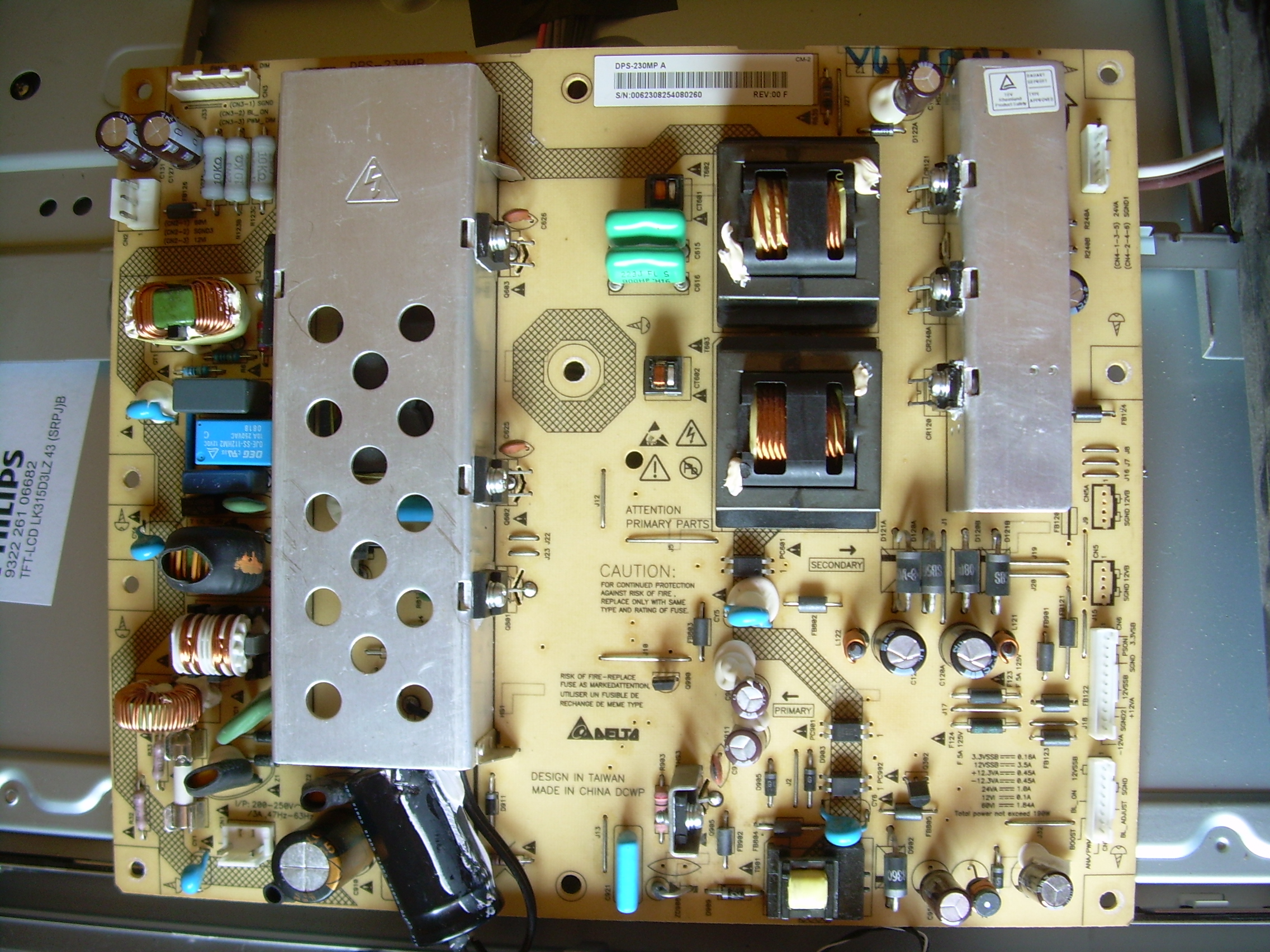

          I guess you then have the same PSU board as I?
          Part number 310432852762 or 310432852761.
          Maybe we can help each other out. See my thread.
            Re: Philips 32PFL9603

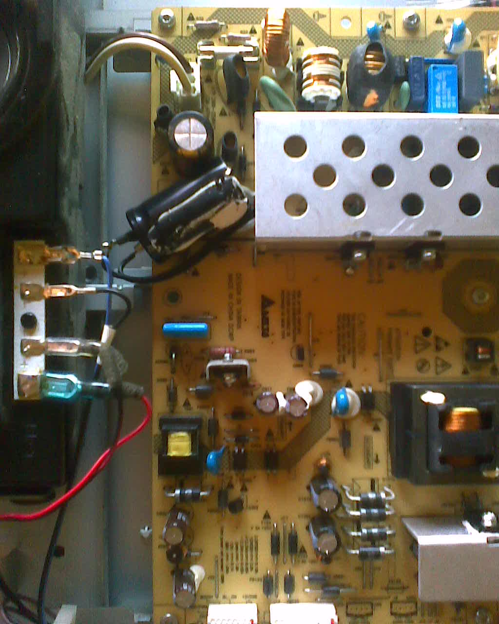

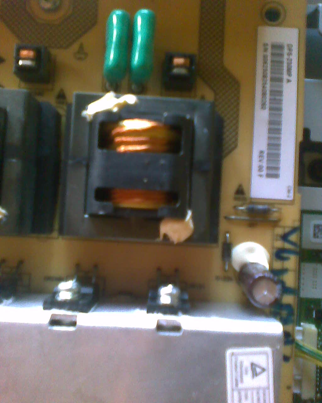

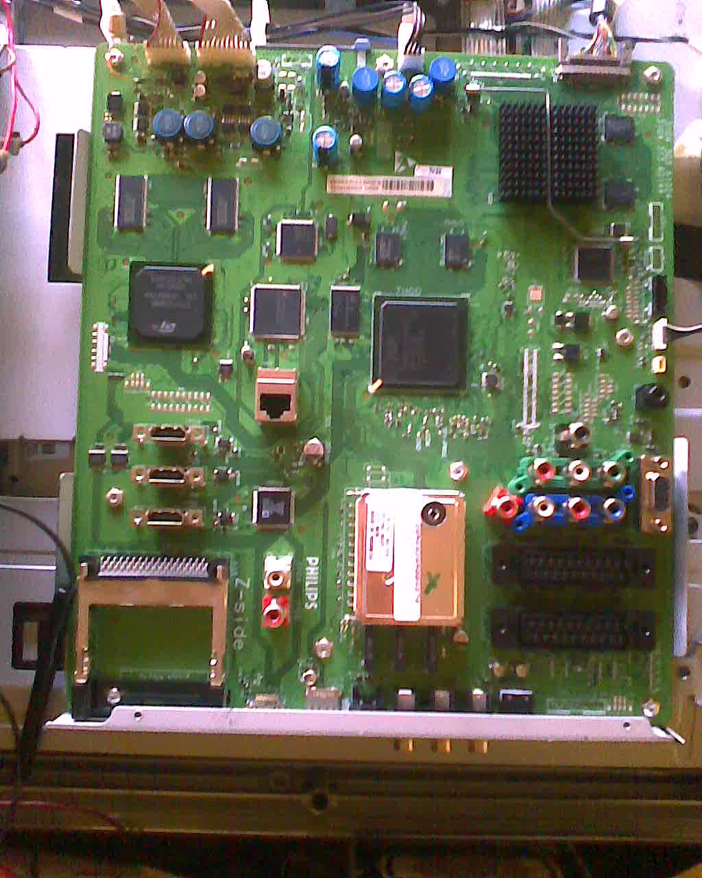

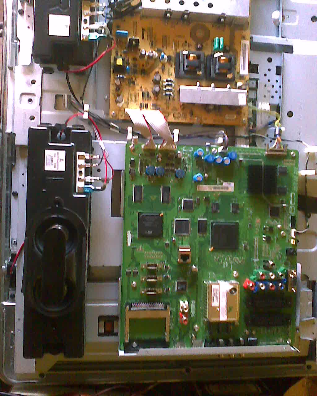

            Hi.
            selldoor according the service manual three blikns means 12V supply.
            I tried to messure the voltage and before swiching the protection it apperars but after obviously it isn't.
            pymic my PSU isn't exactily like yours.
            I attached images, sorry for the quality, I have no camera with higher resolution

              Have you tried with the back-cover fitted on the TV?
              (I read somewhere in that when the speakers are not connected they could trigger protection. On my set the speakers are mounted to the backside of the TV)
              It makes it a lot harder troubleshooting..
                Yes, I tried with all connected and the trouble continue.
                I think the problem is in the PSU, but I can't find it.

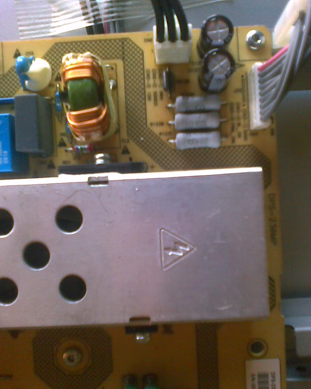

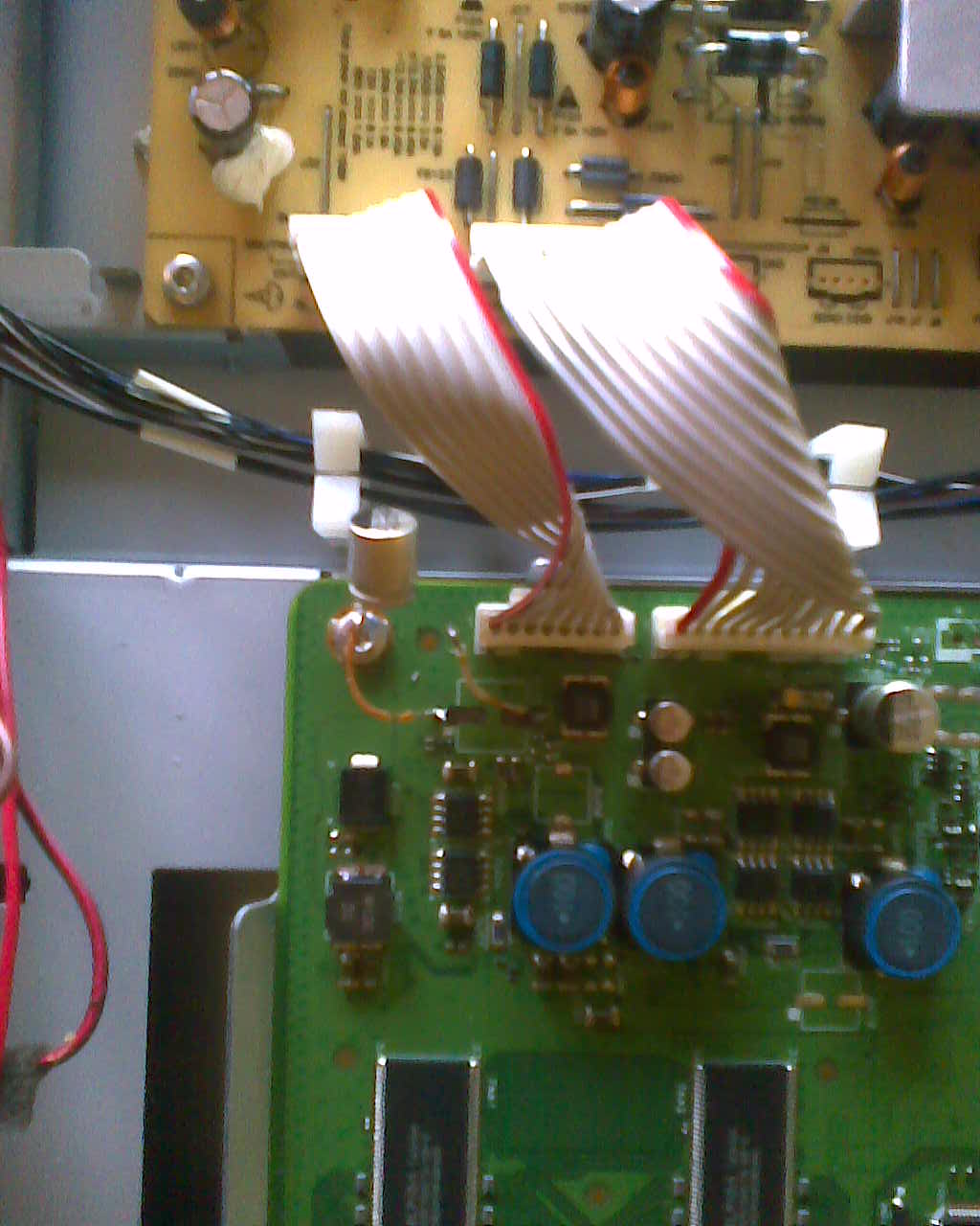

                  the big cap that is sideways in pic 4, did it come like that or is that a replacement!
                    Hello.
                    This is the original, but I put another new identical and the problem persisted.
                      That cap is in the Line side of the circuits, I do not believe it comes like that from factory, no way it will pass UL/CSA/TuV/ETL/CE testing.
                        Obviously, it's the same but I have it out for testing.
                          a funky set up! could some one been in there before you?

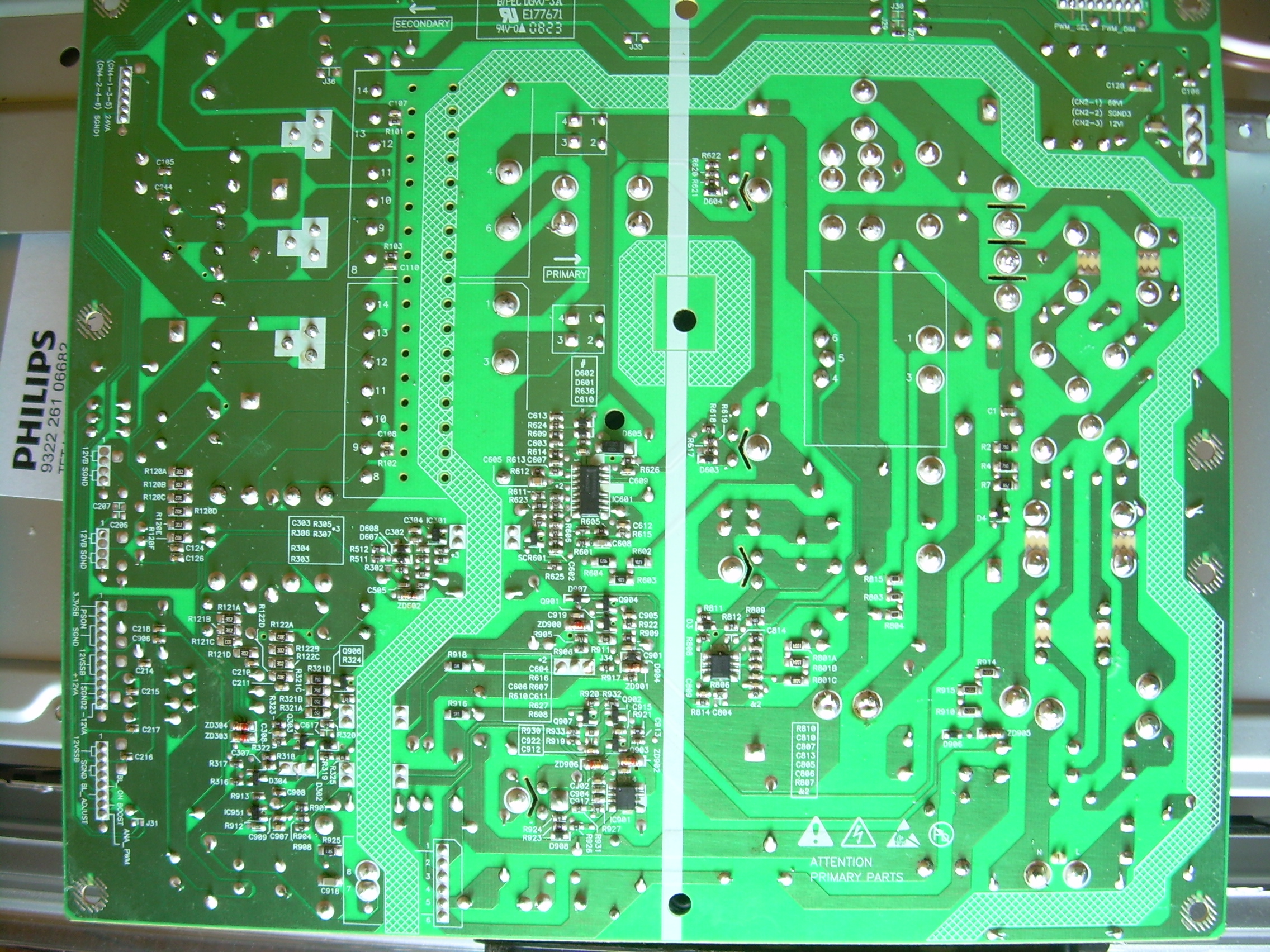

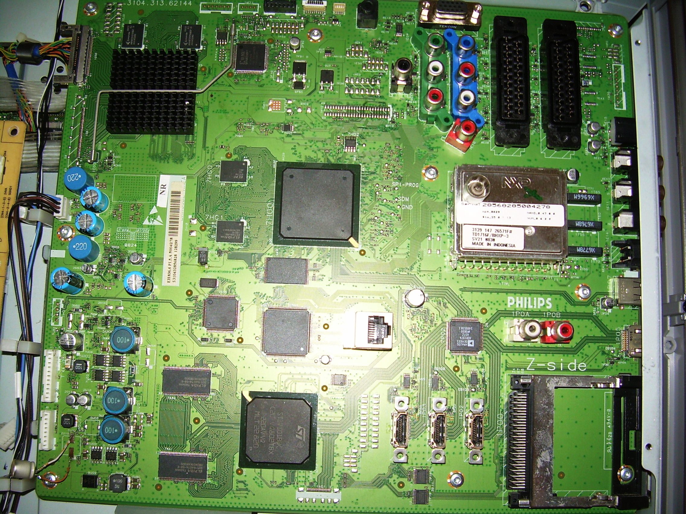

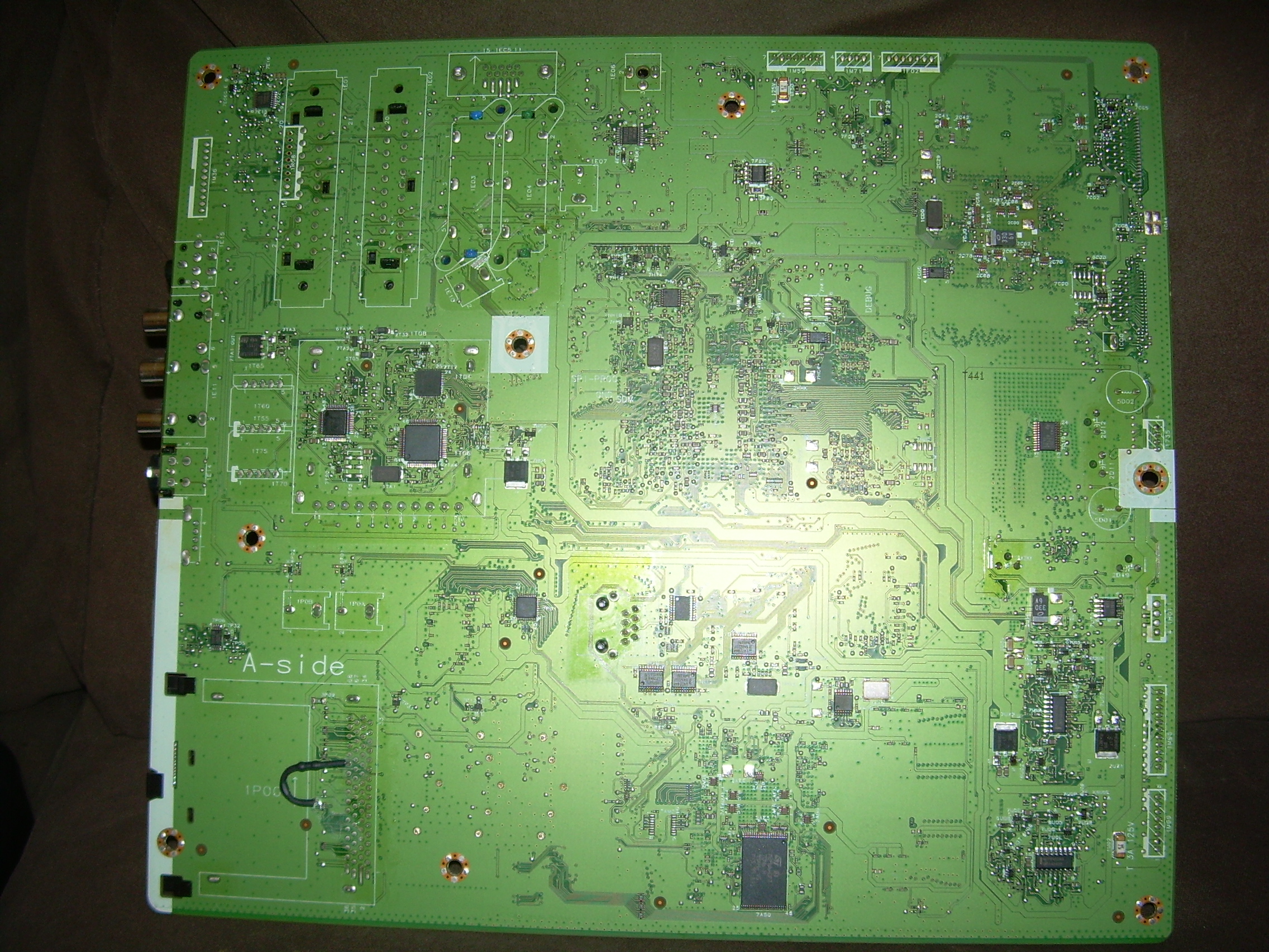

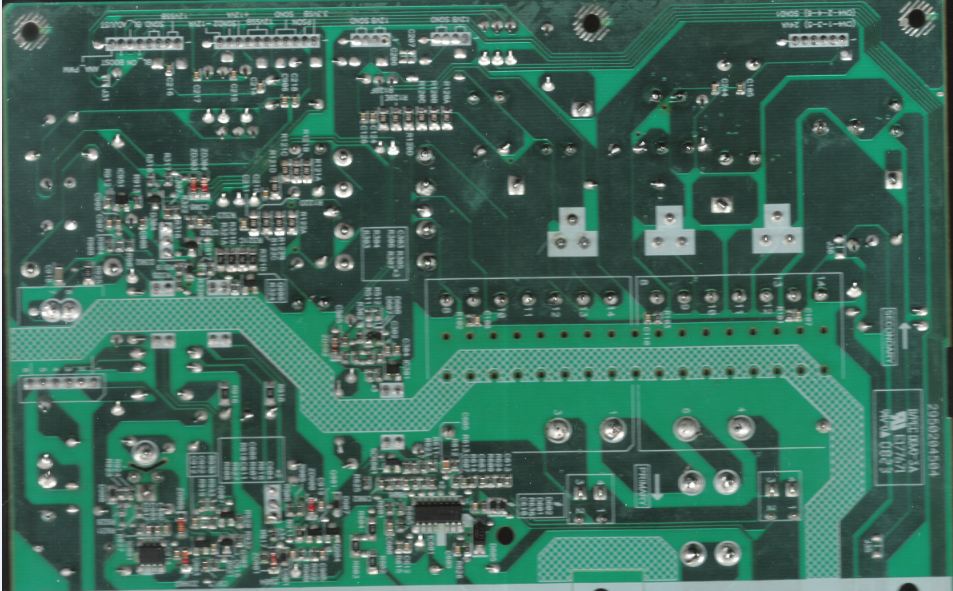

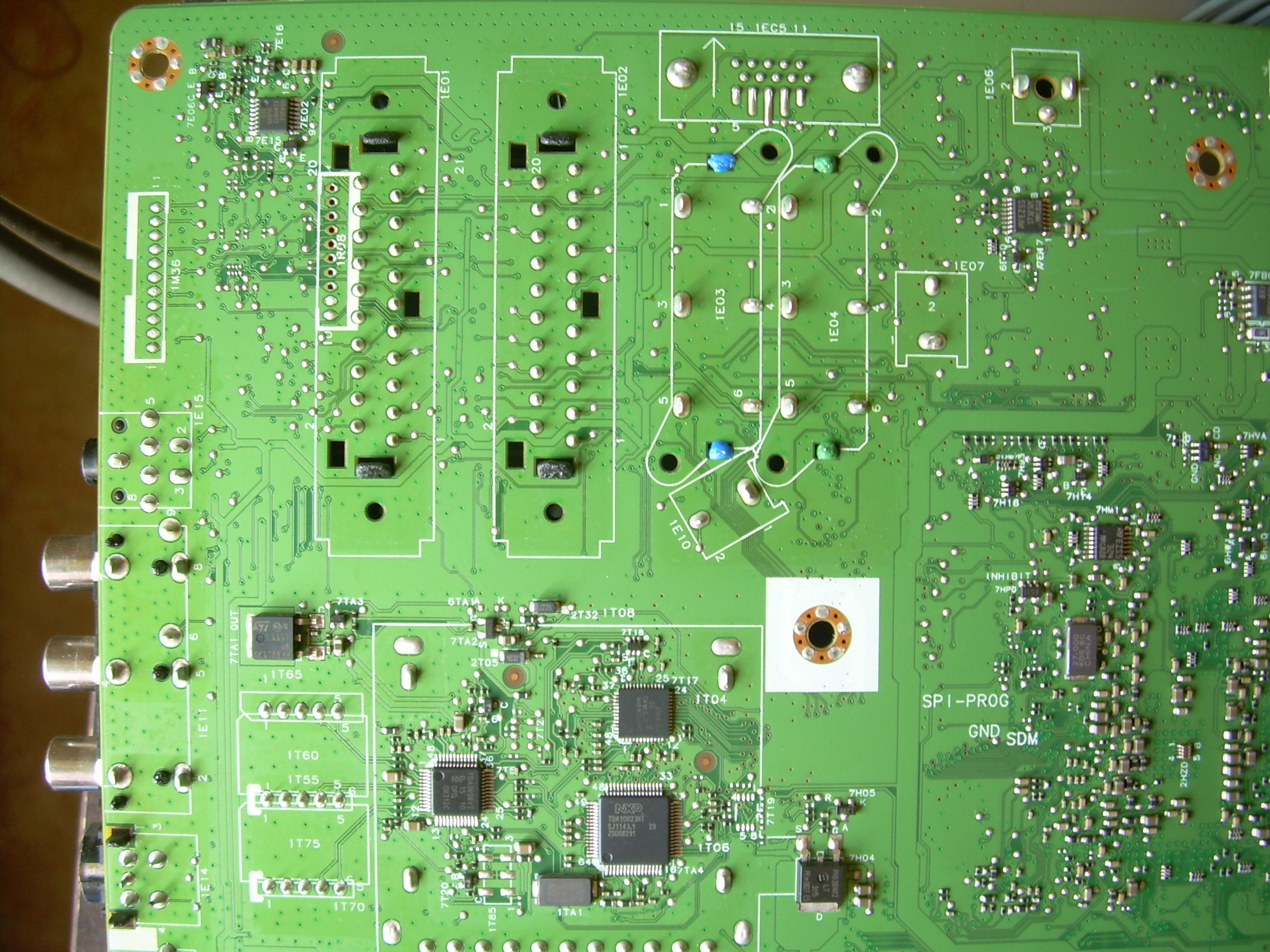

                            Can we get closed up pictures of the connectors on the power supply board so we can see the labels on them and figure out what the pins are? Good bottom size of the board in hi res picures are needed too.
                              Hi.
                              t.j. No, no one have open it before.
                              budm: I attached the back side (I've scanned it), the top side I send it as soon I get a high resolution camera.
                              Thanks again.

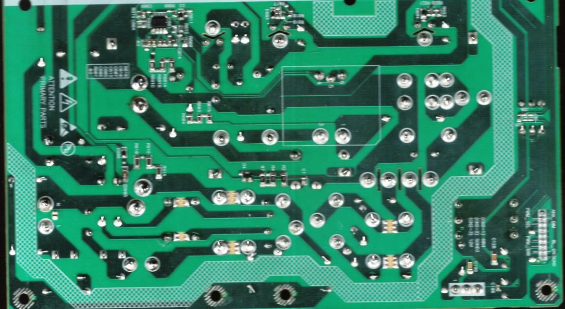

                                What voltage do you get when you measure across the BIG Cap.
                                Care High Voltage - meter on 600vDC red probe on positive black probe on negative.
                                If you can get help try to measure when a) set is plugged in b) when power button is pressed

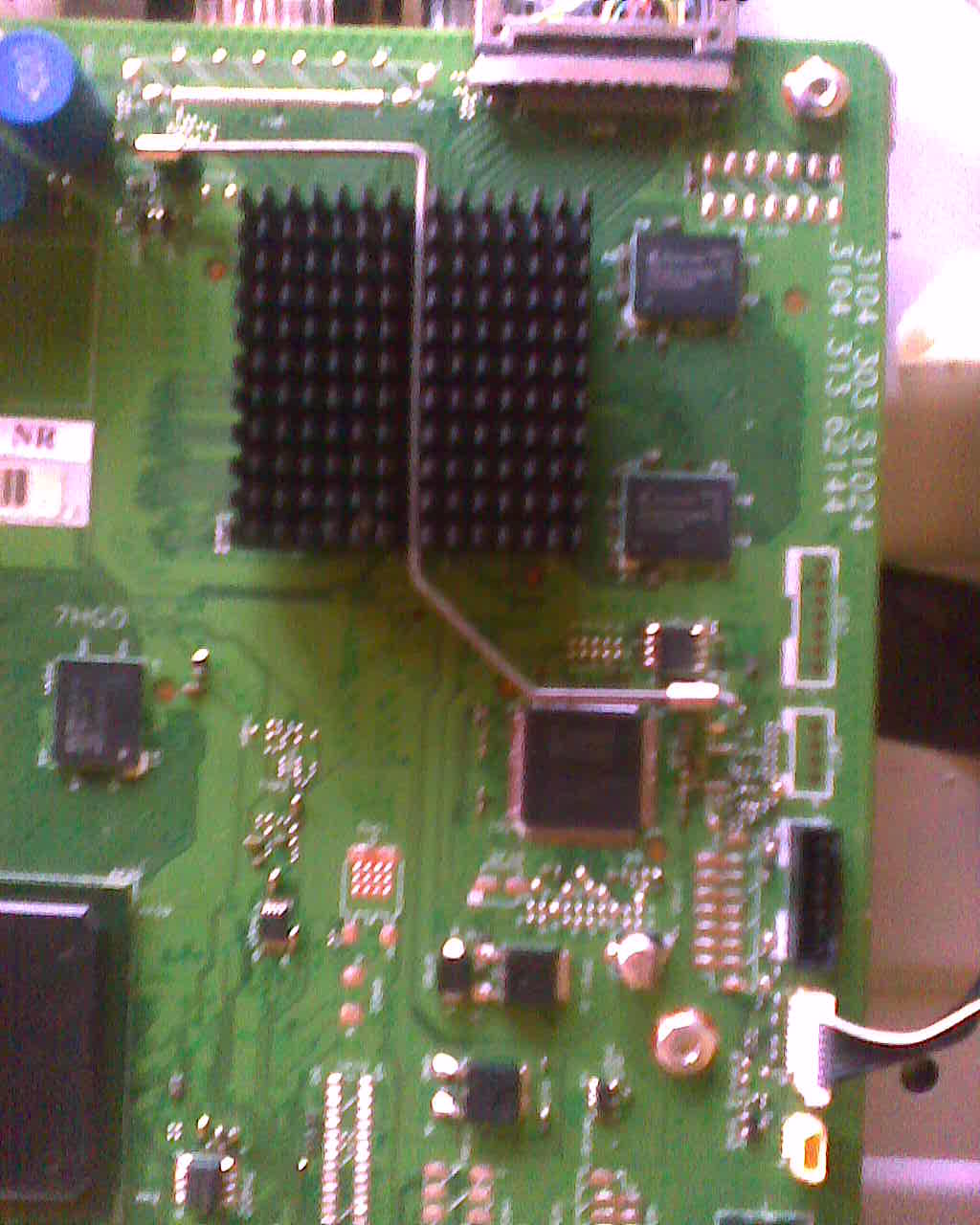

                                In Pic 5 there are 3 grey resistors which I think may be fusable - can you test them
                                  selldoor:
                                  The voltage on big cap is 400V when I plug it and then entering protection begins to fall until it reaches 0 volts.
                                  If I press the power button nothing happends.
                                  About the 3 grey resistors I mesured it and are ok.

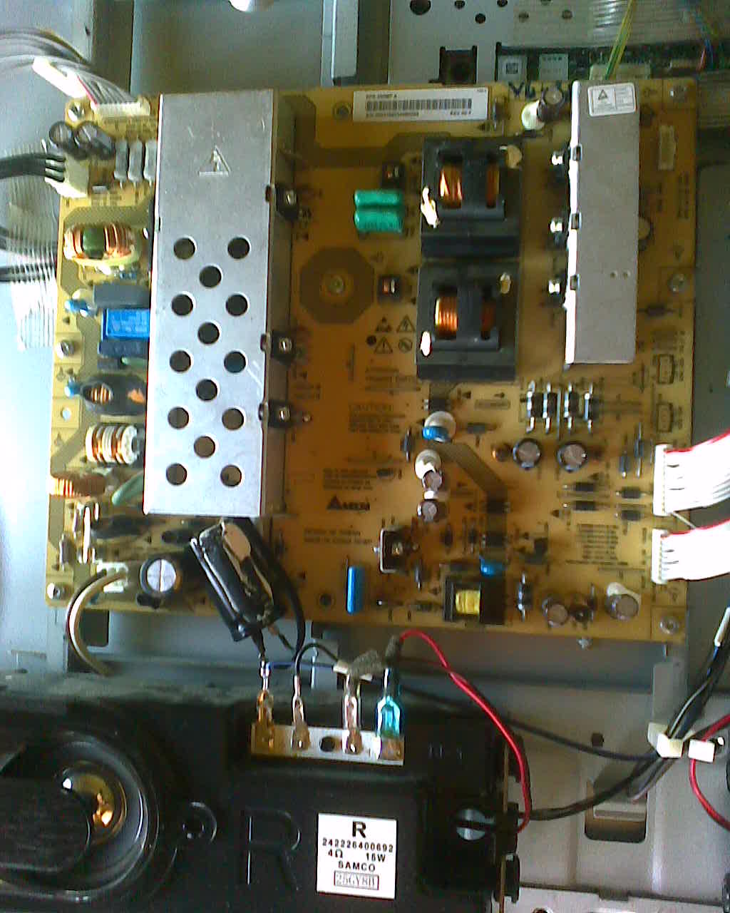

                                    Hi.
                                    I attached new pictures with more resolution.
