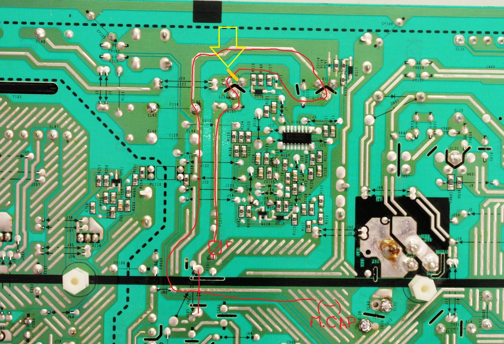

        If I cut the trace here, that red continuity line is interrupted and the FET doesn't show continuity either(the one next to the cut). The other FET still shows the continuity. I have started removing SMD components, jumpers, but I still haven't found anything wrong yet. Maybe something is in other areas of the board.

            #45
            Re: LG 42LG70 blowing fuse
            I have removed it completely and it's the same. I have cut the line from the IC's pin #14, still no difference.
            I have removed the little SMD diodes(2x), capacitor(C112) going to pin #16, resistor R117, J29/J123, C114, still no difference.
              #46
              If you remove Q111, is the short still there betweeen Source and Drain pads on the board? Something defying the rules here.

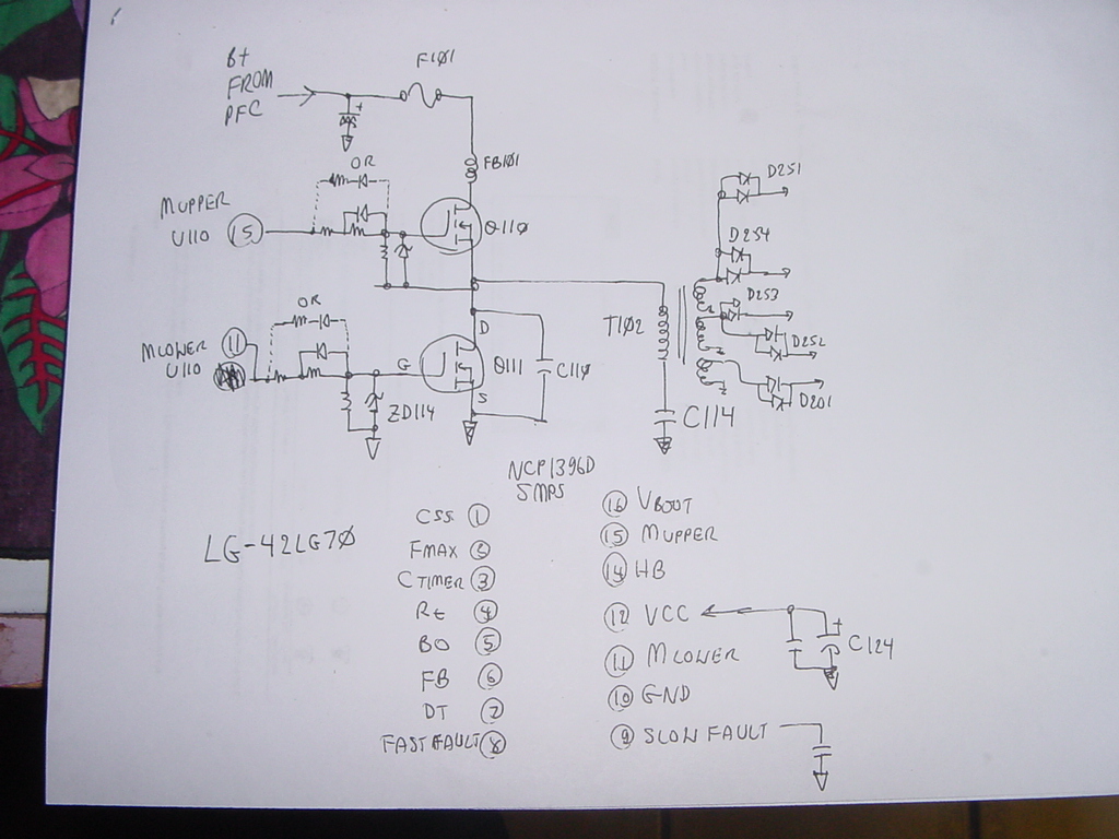

                  OK, I tried tracing out the connections from the pictures, the Gate drive may not be exact but close enough. I do not see what can cause the new MOSFET's to be damaged since you had already installed the new SMPS IC already, both outputs of the IC has to be stuck high or turn on at the same time to wipe out the MOSFET's. You may want to Ohm things out around the Gate Zener, resistors, etc.

                    #49
                    I have tested both FETs, using the Youtube video and both are switching. They are not bad, but to tell you the truth, I don't know how to test these type of transistors.
                    That short it showed right after replacing the IC and both FETs without powering the board.
                    It blew the main 6.3A fuse this time.
                    Today I didn't had time to work on this TV, I have worked on others. I will post these in there proper thread.
                    Thanks for the drawing, I was about to do it myself, but to me it looks like it's pretty close to the generic drawing.
                    I will be removing components one by one, until I will find the problem.

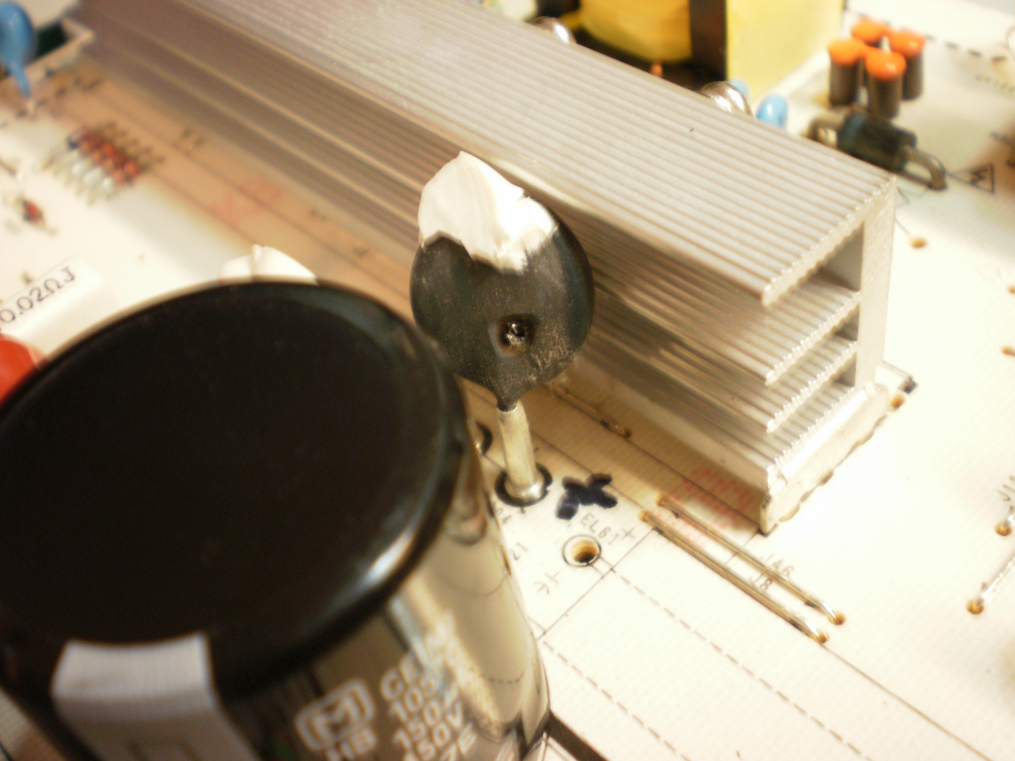

                                  #56
                                  I have installed two new FETs and a new IC and turned it on without the bulb tester and I blew up a thermistor. Sparks were flying.
                                  I'm frustrated with this board, I'm ready to get a new(replacement) board.
                                  I measured the short and it was there, but I was frustrated and I wanted to blow it up.
