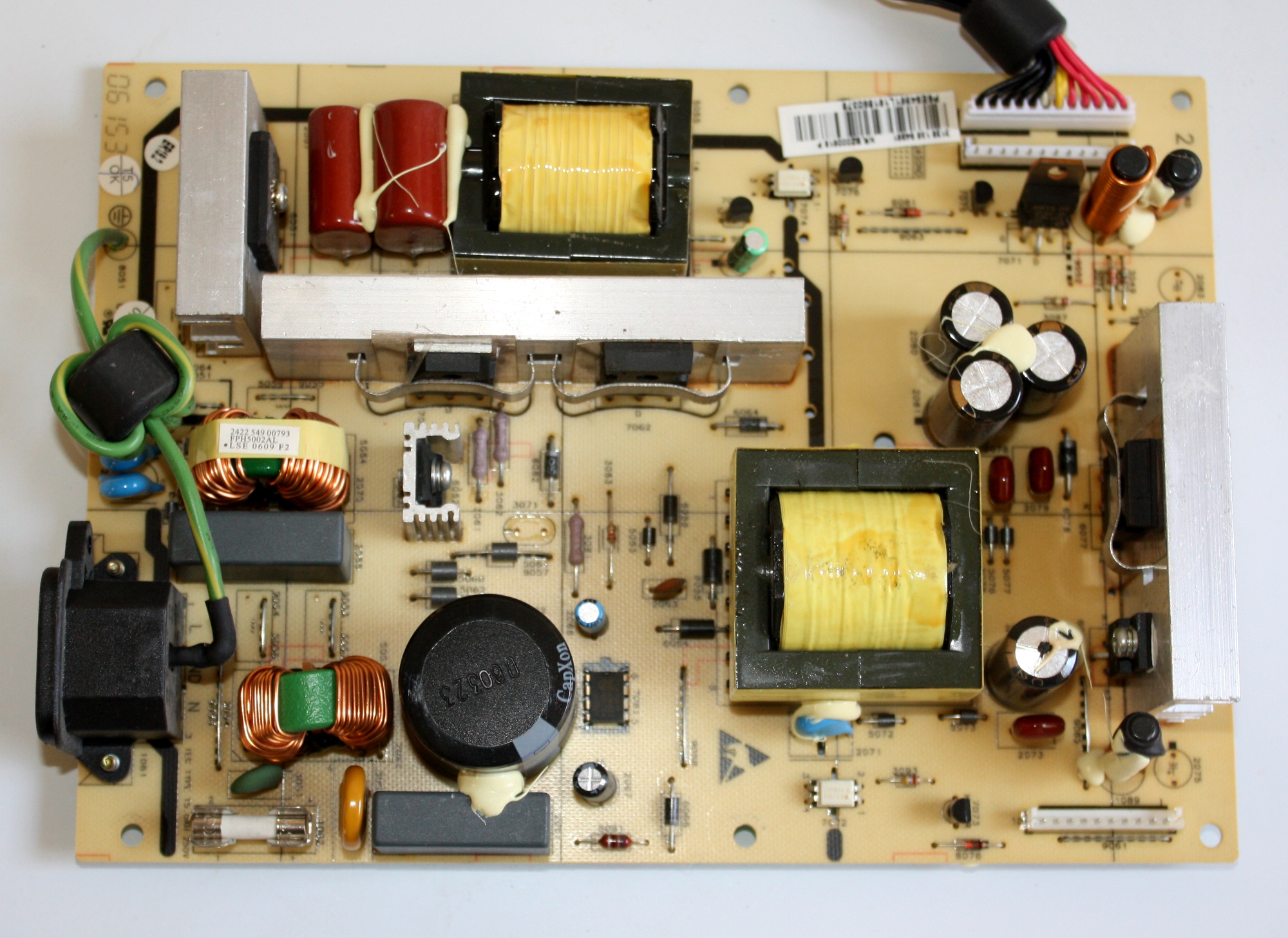

    A few weeks ago I was at yard sale and they were selling a broken 37" flat panel TV (Magnavox 37MF231D/37). The screen was fine (no cracks), so I suspect the problem is power board related. I talked them down to $10 which seemed like a good price to me.

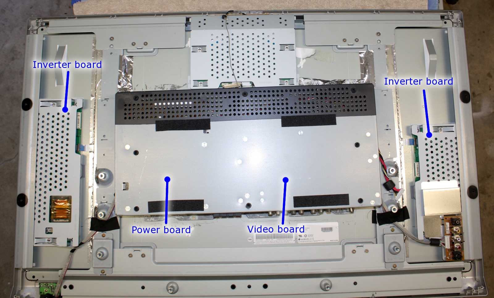

    The back comes off pretty easy, just a bunch of screws around the edge. Once open, a few more screws and you can release the cage holding the power and video boards.

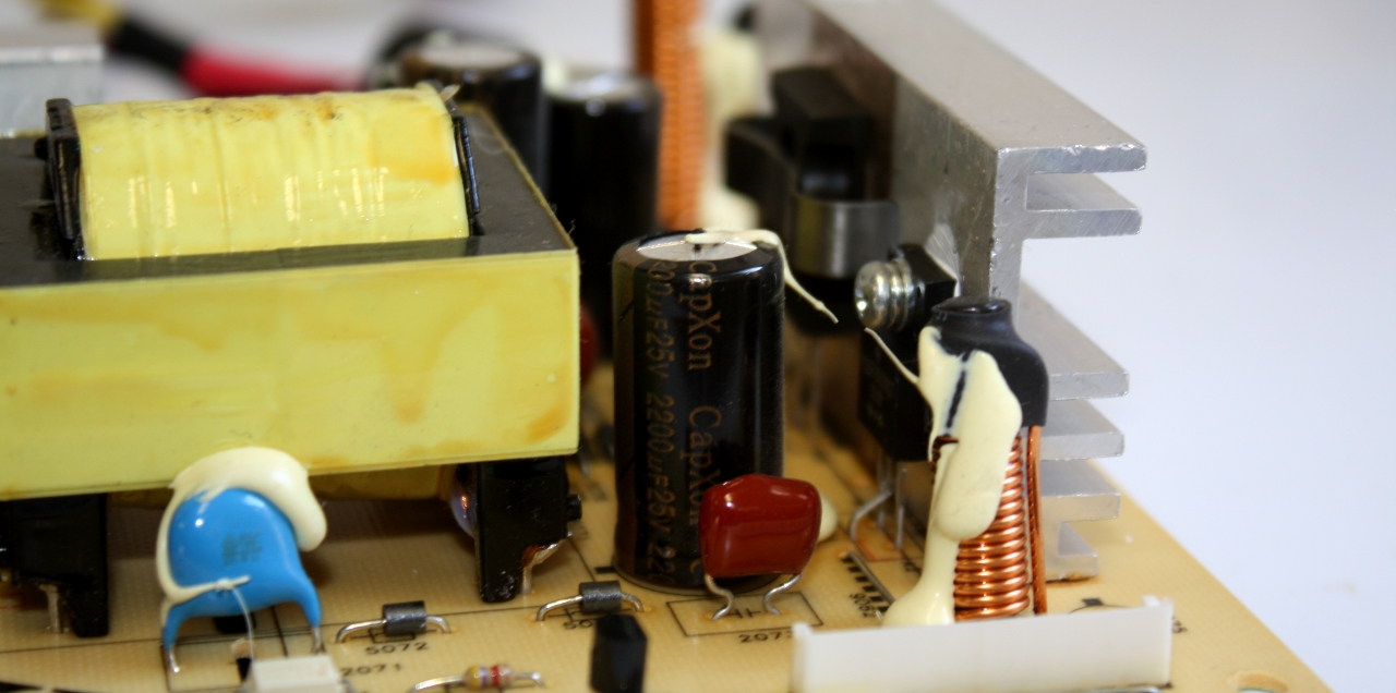

    After removing the power board I see one obvious problem. Cap C2074 (2200uf/25V) is bulging. The power board only has 7 caps (not counting the big fat one), and they are all CapXon board. so I just ordered replacements for all of them. Before ordering replacements, I also checked the video board. To my surprise, it only had 2 electrolytic caps - both of which tested fine. And lastly I checked the two inverter boards. They each has 3 caps, they tested fine plus they were good quality Rubycon. So in the end I only recapped the power board.
    After soldering in the replacements the TV powers up and works perfectly. So $10 for the TV, and less than $5 in caps. Not bad for a good looking 37" flat panel TV. I wish all TVs and monitors were as easy as this one to work on.
