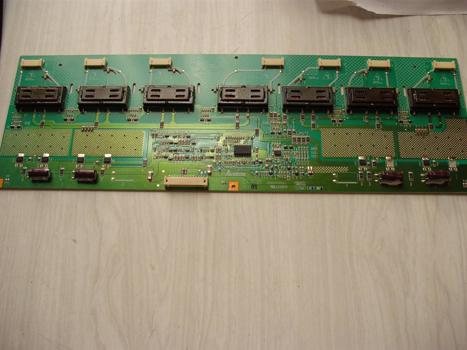

    Technika LCD32-207 Tfmr or Inverter Board wanted
    I have a Fault on this TV, and have identified the problem to be a failed Inverter Transformer on the Board.The Transformer number is 2874012900,the Board is a DAC-24T051,the latter being old and looks like it has been superceded by VIT68001.95 Rev 01.The boards are also used I understand on the following,Goodmans LD3265D,ONN LE32LCD0802ID and Grundig GU32BLKS.Would appreciate any info ref obtaining the Transformer preferably, ot the Board if necessary.

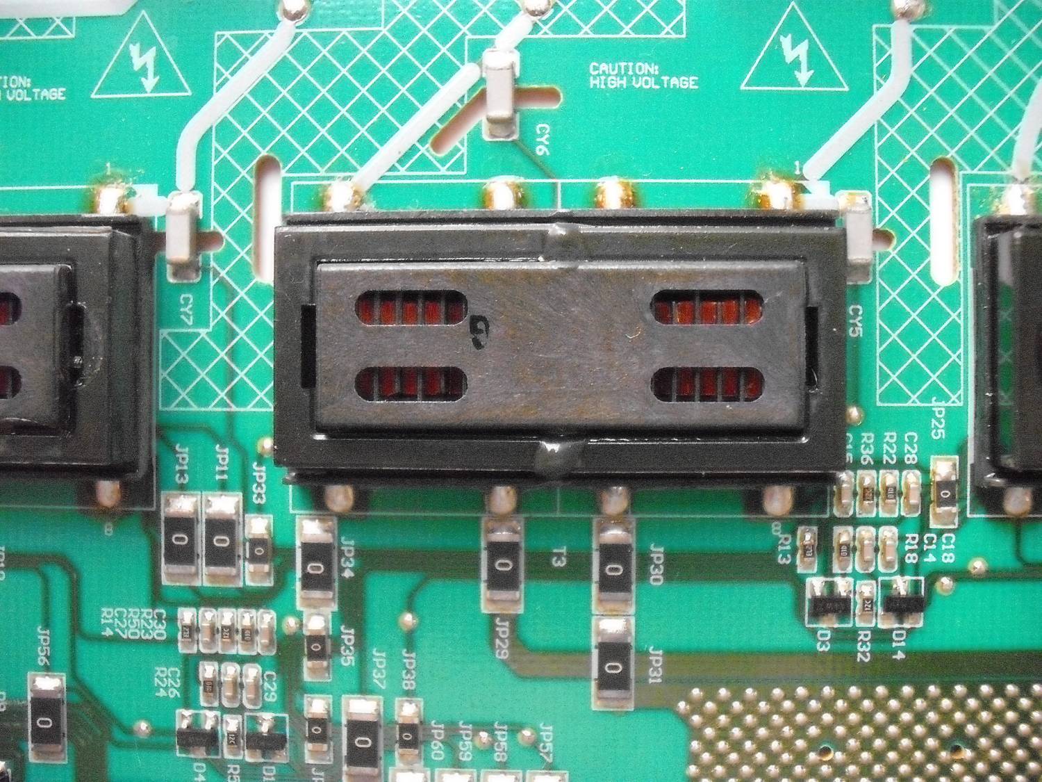

        Re: Technika LCD32-207 Tfmr or Inverter Board wanted
        No luck finding that - have a picture?
          These possibly might be a fit? The first 4 numbers might be the only ones that matter? The rest might be a date or lot code?
          http://www.lcdparts.net/TransformerD...ProductID=3359
          http://www.lcdparts.net/TransformerD...ProductID=3360
            Here you are !!
            Also unusual in that they are NOT through Hole, and Sec Res about 1.95Kohms
              Originally posted by Rtech
              Here you are !!
              wrong measure
                I found this http://www.ohmsupplies.co.uk/INVERTE...MER-2974012900
