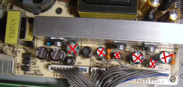

    could you please post a picture or give the name of the capacitors you have changed to solve the sound issue?

      I never pinpointed exactly which capacitors were needed to fix the sound, all I know is that repairing the 6V line fixed it. As I remember, I ended up replacing all caps near the connectors, except the 2 big 3300uF caps. This fixed the sound, and analogue and digital tuner issues.
      As I remember, some of the caps that I didn't think were associated with the 6V line, when I changed them, the 6V was eventually repaired. In the absence of a schematics, for someone like me (amateur learner at best), it's not always easy to decipher the circuits.
      Best bet is to shotgun-replace all in that area (except the 2 big 3300uFs). There are only 6 (if your picture is fine, you don't need to change the 4 caps associated with the inverter), so get good replacements, set aside an hour or two, and replace them. I've attached an edited photo from the first post of the relevant caps, the ones with the red X on them.
      My set is still going strong about a year on. Good luck!
