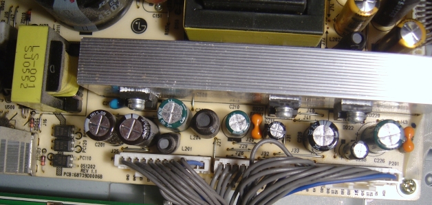

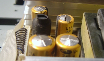

So I take off the back and instantly I can see the four 1000uf (25V/35V) caps at the top (near connections going to inverter) are domed. Gold and black Sanwha VA. When I took a couple of them off, I notice that they are 130dC caps, bulging top and bottom.
Q: Would I get away with some 105dC FM's? Don't have any 130dC's to hand, and they're probably not the problem with the sound at the moment, are they?

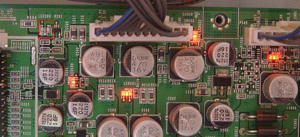

Anyway, I've read a few of the other threads regarding similar sets, with similar issues, so turning my attention to the 3 connectors going to the av/jack boards. None of the caps around there are obviously bloaded, and are a mixture of Samxon (GF M) and (KMOD UNA/UOA) and Sanwha (RD). I measured the voltages coming off the connectors, and am getting the following (board marking - actual), I've left out any GNDs:

So, where to go from here? Replace the 8 Samxon and Sanwha caps anyway, retest, and take it from there? Or can it be narrowed down further, it looks like it only the 6V that's considerably out at the moment. Is it likely to be a cap issue, or a power transistor problem?
