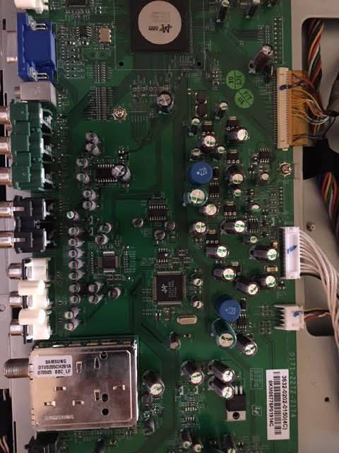

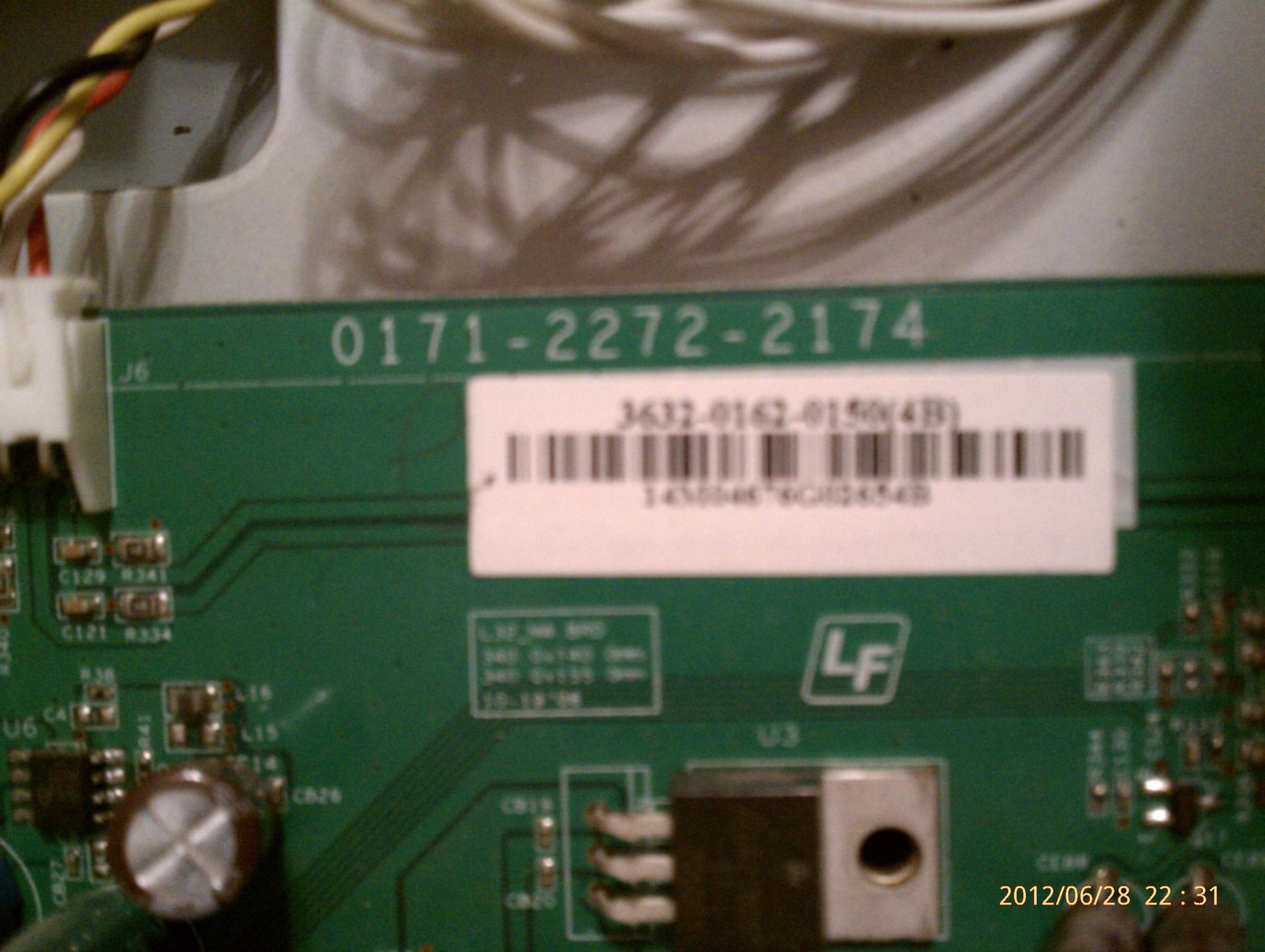

    I have a Vizio VX32L that I've determined to have a bad main board. Numbers on the board are:
    0171-2272-2174
    3632-0162-0150(4B)
    My question is there are endless amounts of boards for sale with different numbers but they all are for this model and look the same. Is there a way to determine compatibility or does someone have some experience with these? Thanks!

    Re: Vizio VX32L Main Board

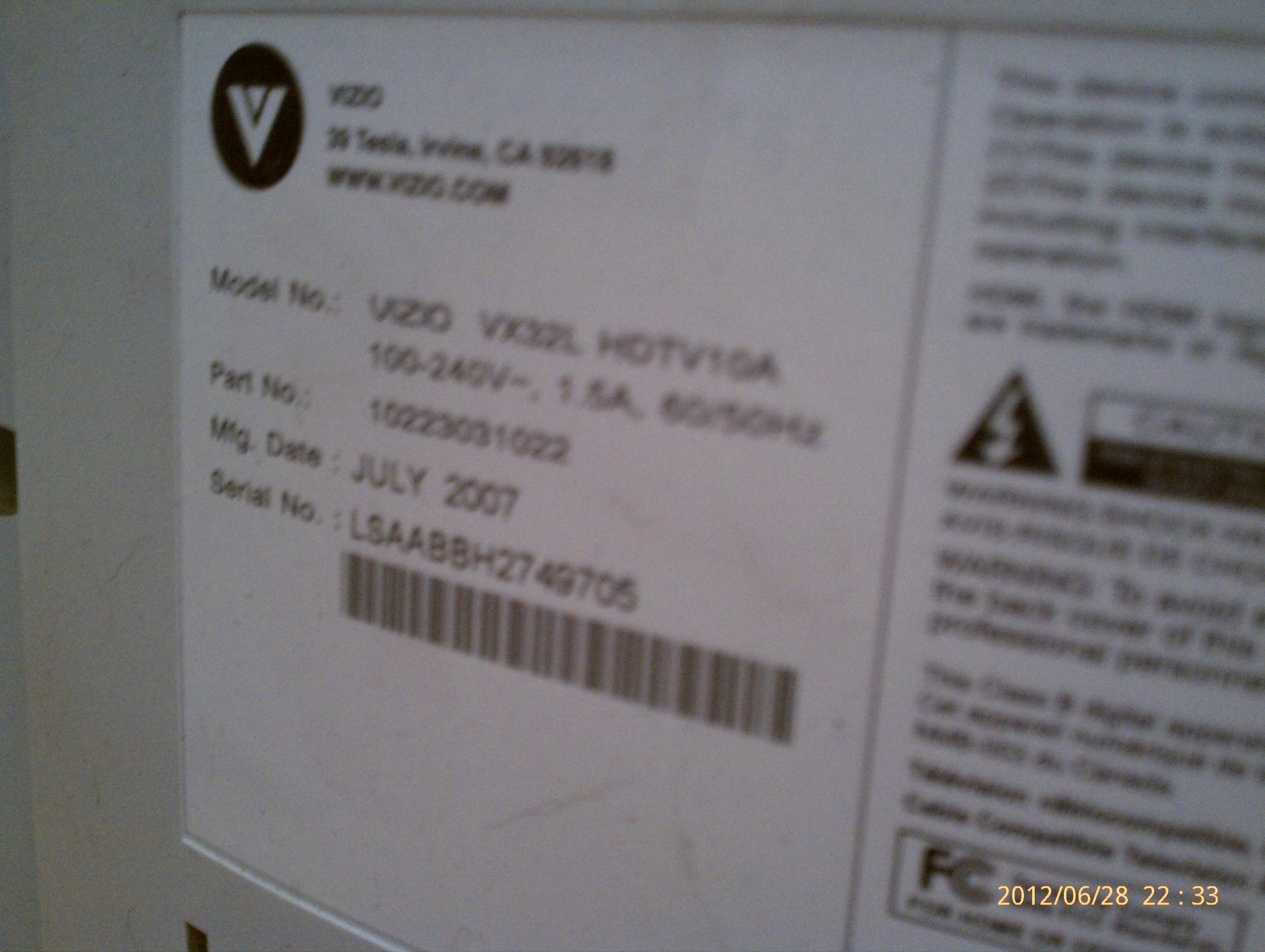

    to insure of obtaining correct part using the part number form the bar code area of the main board is correct also since there many varations of that model set, the 1st 7 letters in the serial number will also confirm proper version of main board also.Is there any more numbers or letters in the model Example: VX32LHDTV10A ?

      Here's some pics I did a search on ebay for "vizio vx32l main board" to compare.
        from your additional info part number 3632-0162-0150 subs over to 3632-0162-0395R
          Is this part compatible then?
          http://www.ebay.com/itm/3632-0162-01...item2c6665a0c0
          • RON_CET
            • Jun 2012
            • 217
            only by the number 3632-0162-0150 number, the other number he listed does not show in the sub cross I would email seller and ask for confirmation of the number off his board like the photo of the number from your bar code
                      Vizios have a problem with a lot of the voltage regulators on the main board. If you haven't tested them, it could be a 52 cent fix versus $113 for a main board.
                      See the most recent post at
                      https://www.badcaps.net/forum/showthread.php?t=21308

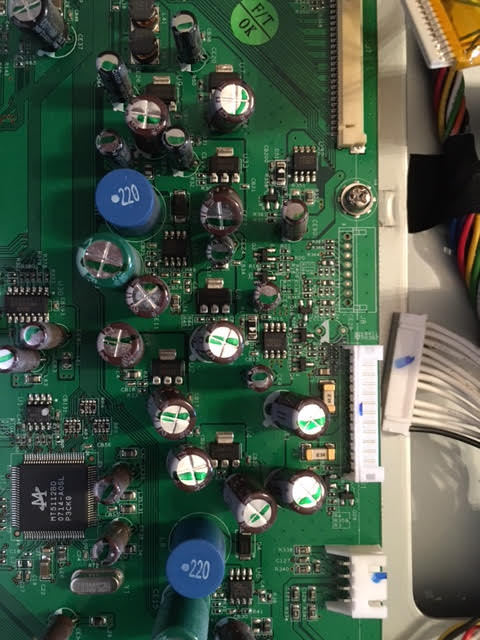

                        I am a old timer trying to keep my 32 TV from the landfill. Spent the last couple of days reading many post and would like some help . Measured as suggested in many post here are my readings.
                        U7
                        3.28
                        1.24
                        0
                        U9
                        3.28
                        1.49
                        .250
                        U33
                        5.08
                        3.29
                        2.04
                        U8
                        5.12
                        3.30
                        2.04

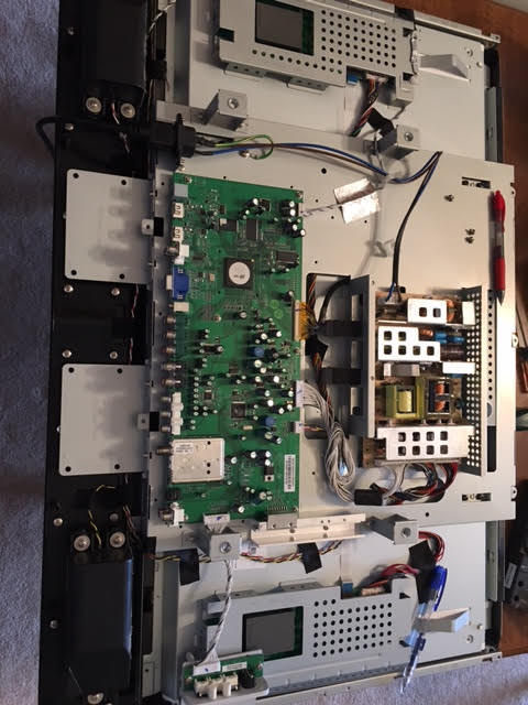

                        Not sure I have measured all the right transformers or not , but my power board is not getting 12 volts or 24 volts, It does have the 5 volts. So I assumed I must have a mother board issue , based on all the readings I hope I am on the right track , Any advice ??
                          The regulators are OK, but I see 6 (1117 series) of them in your picture but you only report 4 of them.
                          To get the switched 12V/24V the power supply board as to receive the PS-ON (Power supply ON) signal from the main board.
                          You can try disconnecting the cables between the power supply and the Inverter board to see if the 24V will be present, also check the PS-ON signal (>2VDC = ON) to see if it is present.
                          Good clear pictures of the whole backside of the TV will also help.

                            when you say unplug the connectors do you mean to the mother board? or to the other two components on the back of the unit that come off the power supply , I tried both and still no 12 or 24 volts,, update finally kept hitting and playing with on off switch got the unit to turn on now I have the 12 &24 volts also the turn on signal is there and the screen actually turned on. its almost like I had to play with on/off switch till it finally caught and turned on
                              OK, those two regulators are good.
                              There are two power connectors (24V) on the power supply board, one goes the Inverter board on the left side and another one goes to the inverter board on the right side of the TV, those are the ones I want you to disconnect and see if you will get the 24V back on the power supply board.

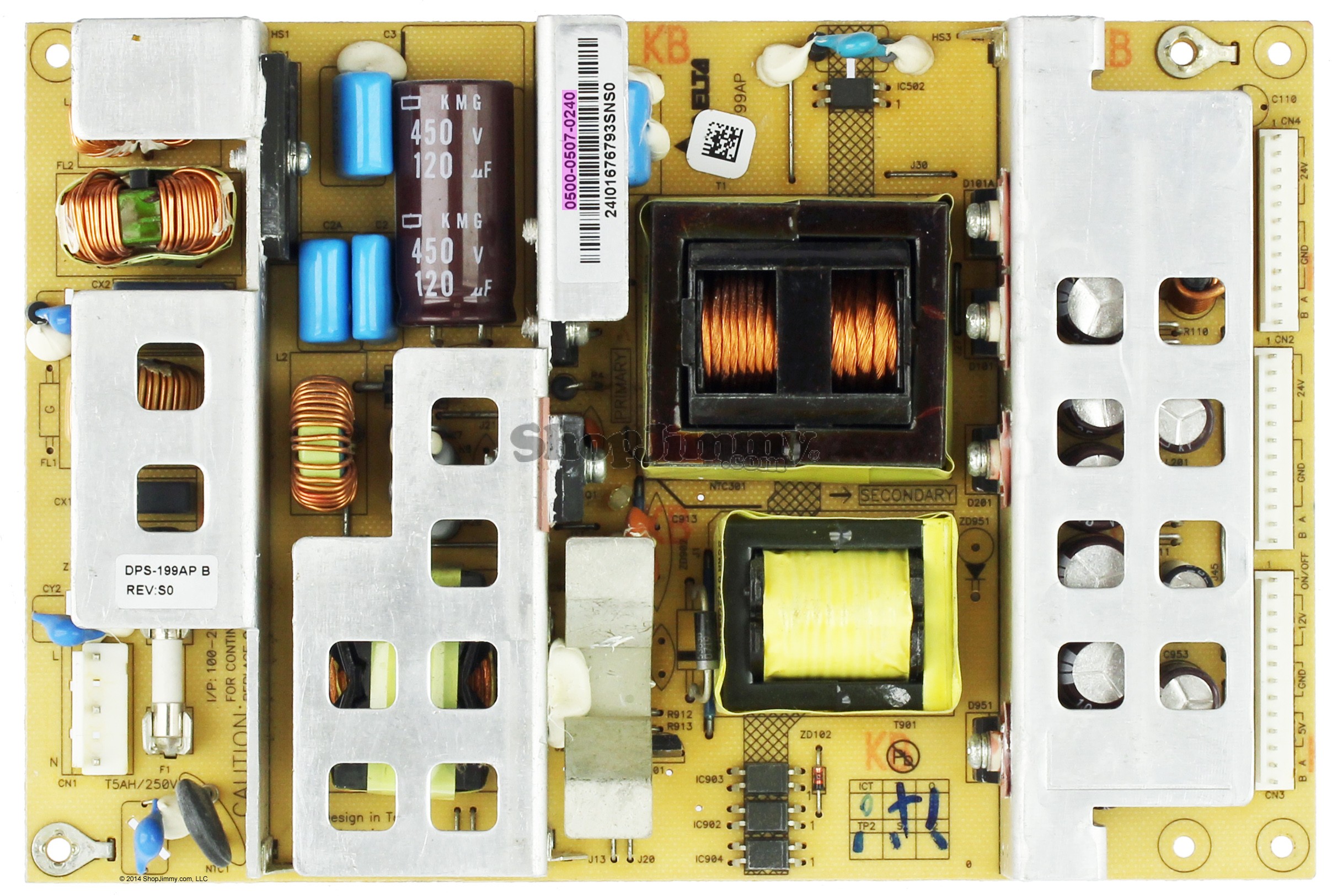

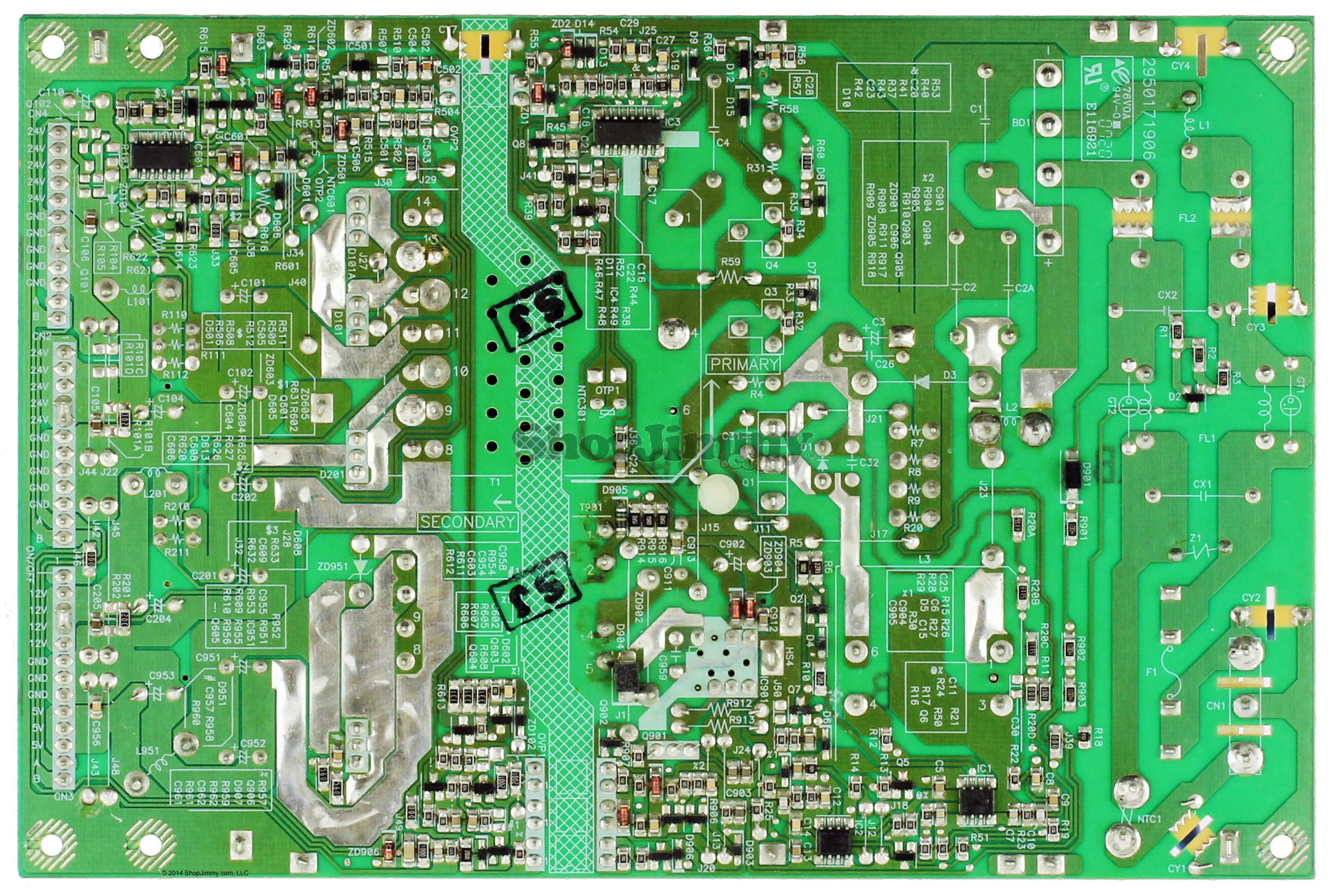

                                        This one is your board?
                                        Vizio 0500-0507-0240 (DPS-199AP B, DPS-199AP) Power Supply VW32LHDTV10A
                                        http://www.shopjimmy.com/vizio-0500-...wer-supply.htm
                                        Pictures provided by shopjimmy.
