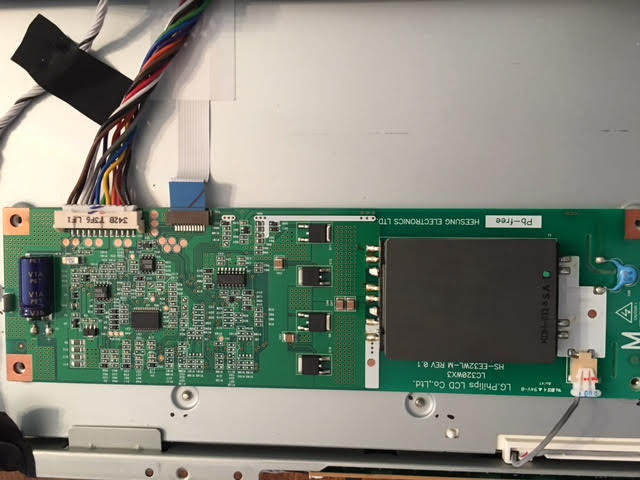

      Well you do have correct command signals (BL-ON and Dimming commands) to turn on the inverters and you also have 24V to run the inverter boards, so if they are all present but the backlights are still not on, then you have problem in the inverter boards.
      You should remove the metal shields on the inverter board so you can inspect the caps.
      Please upload the pictures of your inverter boards next.
      BTW, the power does have to be held for a couple seconds, it is normal to protect accidental turn on if someone accidentally brush on the power switch, same when you turning the TV off.

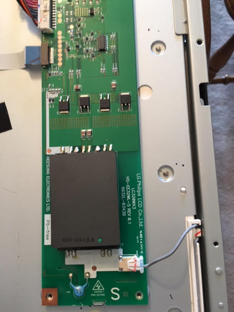

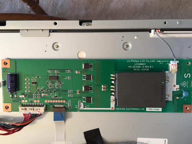

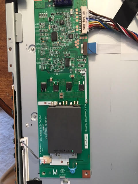

        Re: Vizio VX32L Main Board
        ok here they are
          OK, the filter cap on each board has no sign of bulging top and the white fuses are OK?

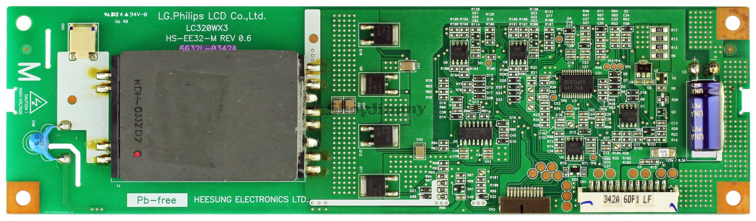

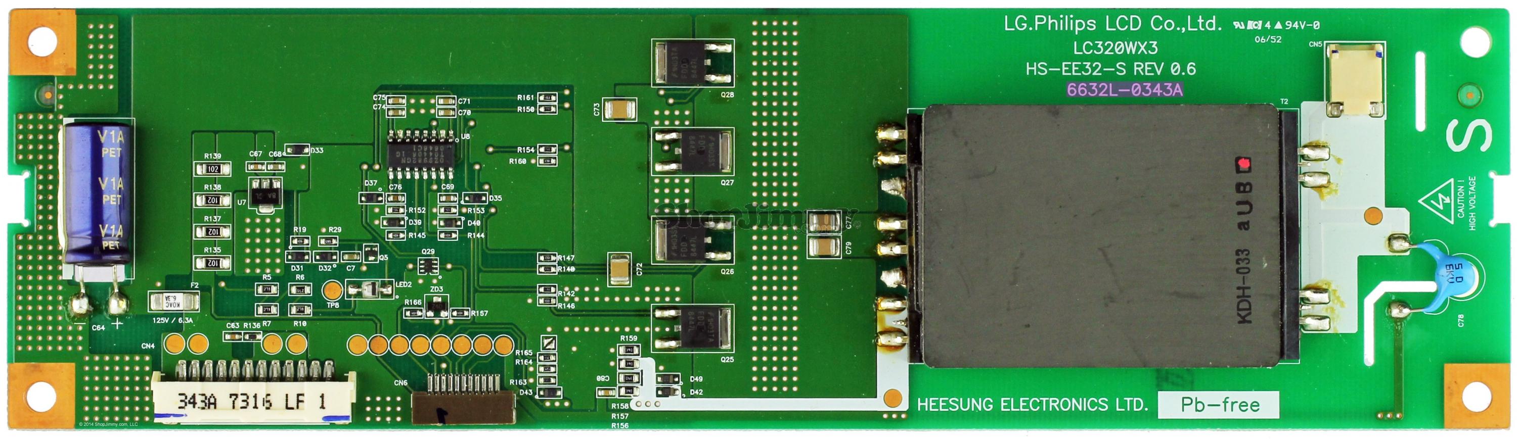

          http://www.shopjimmy.com/catalogsear...?q=Vizio+VX32L
          Pictures provided by shopjimmy.
            no bulging and the white fuse on each board is good
              OK, so the conclusion at this point is that you do have 24VDC, and Command signals at 'A' and 'B' pins but still no backlights, if that is correct then the inverter boards are bad, what exactly failed I do not know at this point.
              They are < $5 each at shopjimmy.
