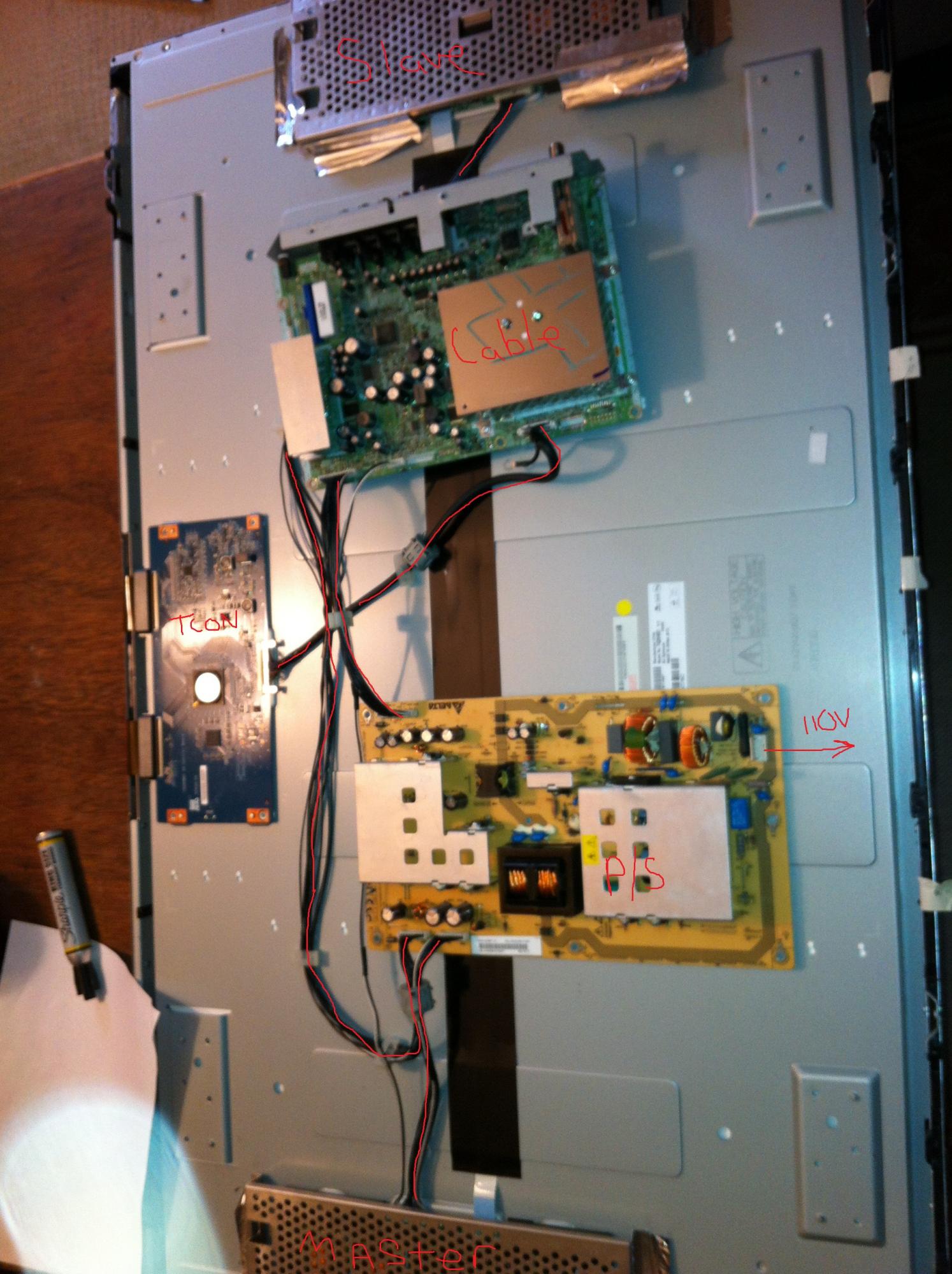

    I have other TV its Sanyo DP42848. I replaced both master and slave inverters on this TV. It power up for like 2-3second then went off. I use my flashlight and I can see something on LCD. That mean the backlight went off, does it mean T-Con control is bad?
    Bryan
    Re: Sanyo DP42848 sound ok but no picture...bad t-con control?
    No, it likely indicates a fault with the inverter boards. Did you connect the wire from master to slave? Is there a control cable from the T-con to one of the inverters?
      Here picture I draw and lines...tell me anything am I missing? I know this is the right way connect but still no back light on.

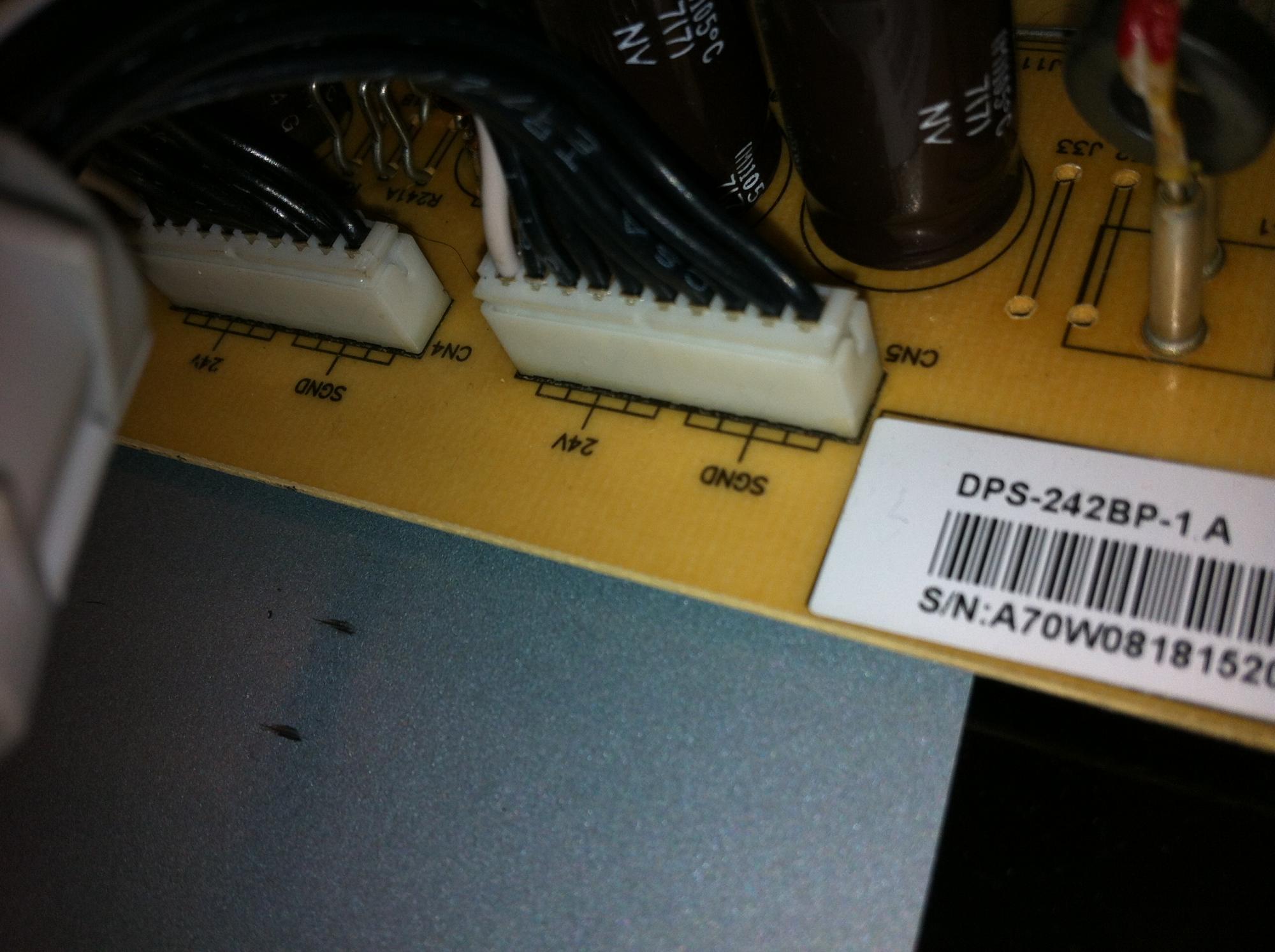

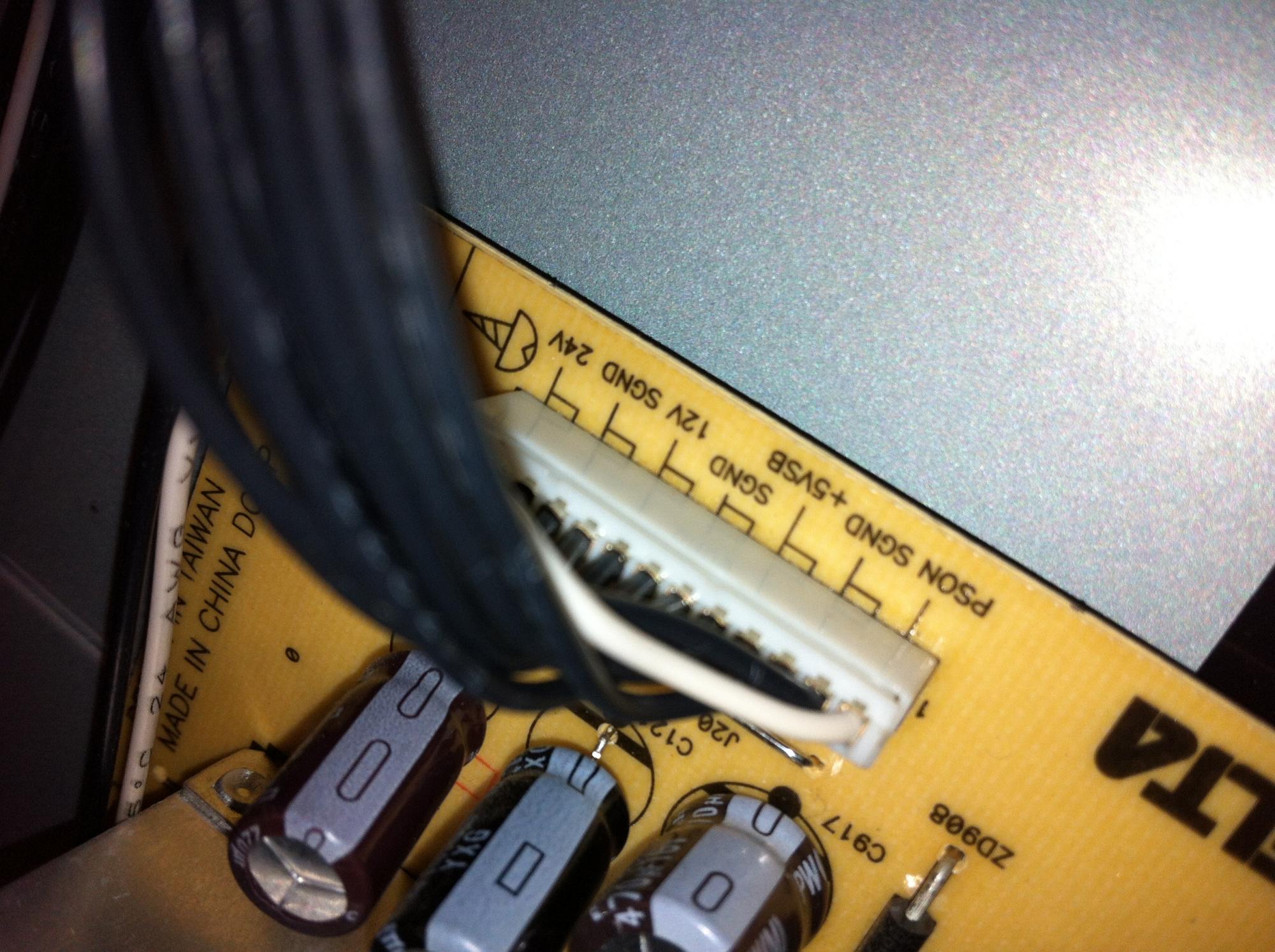

        Can we get closed up pictures of the power supply board so we can see the labels on the connectors to see which pins ae for? I am looking for 24Vdc, BL_ON, etc.
          here 2 pictures
            Using a multimeter on the DC 200V range, check the "24V" to case ground (red probe in 24V and in volts-ohm; black probe in a spare screw hole (make sure at least the power board is screwed to chassis for this test) and seated in COM.
