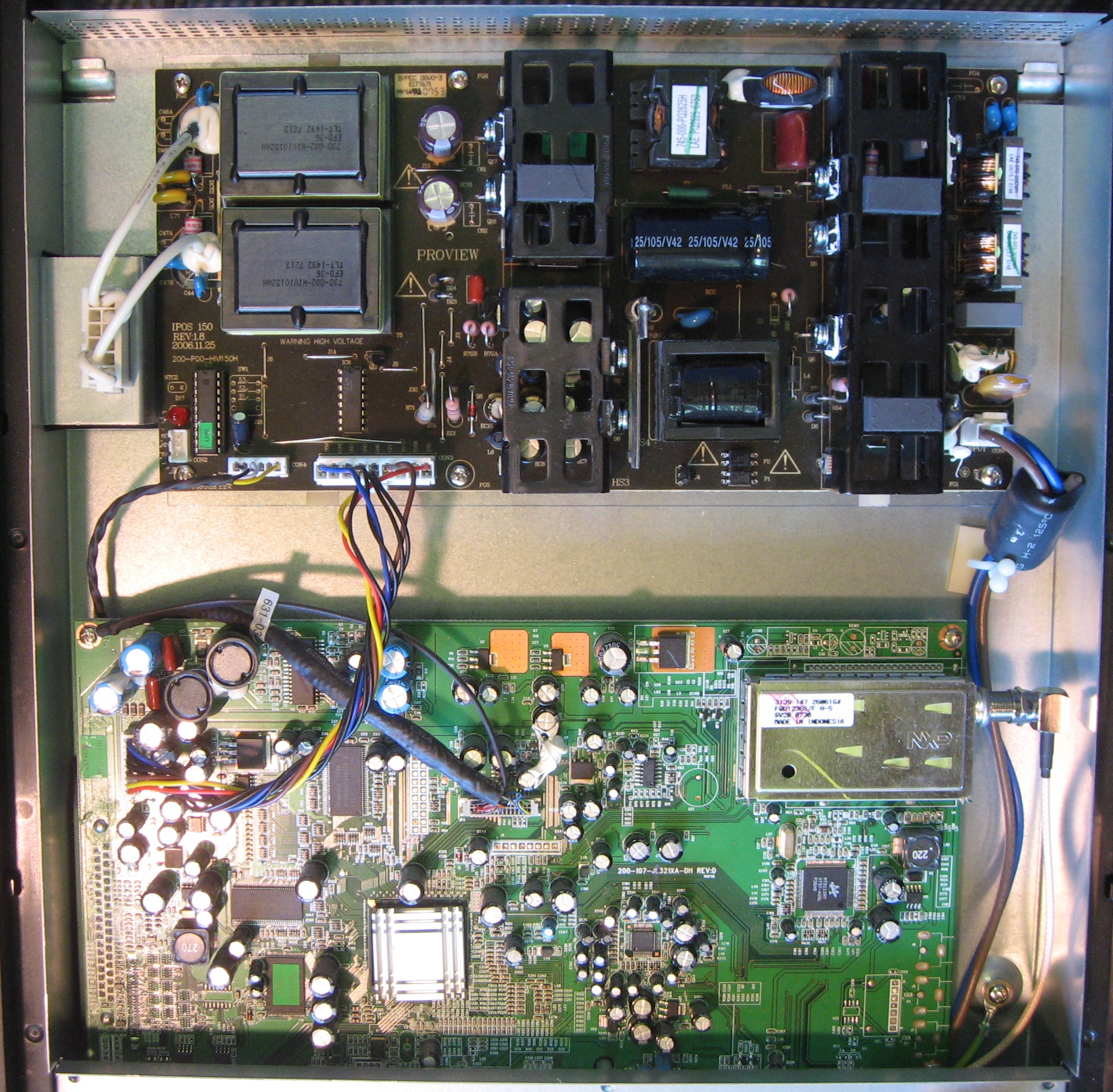

    I have an Element FLX-3211B LCD TV that will not turn on. Before I received it, somebody installed a "cap kit" in the power supply. I was told that before the cap kit, it would often not turn on or sometimes even off when the power button was pressed. It eventually died completely. After the cap kit, the only signs of life are the standby indicator on the front of the TV turns from red to blue when the power button is pressed. On the power supply, the red LED flashes most of the time when "on".
    In the "on" condition, the power supplies voltages are correct as marked on the board at the output connector with the exception of the 20v pin which is actually producing 24v.
    I have checked for a "no backlight" condition and can not see any faint image.
    My question is, is it normal/O.K. for the 20v pin to actually have 24 volts? If so, then is it safe to assume that the main board is defective?

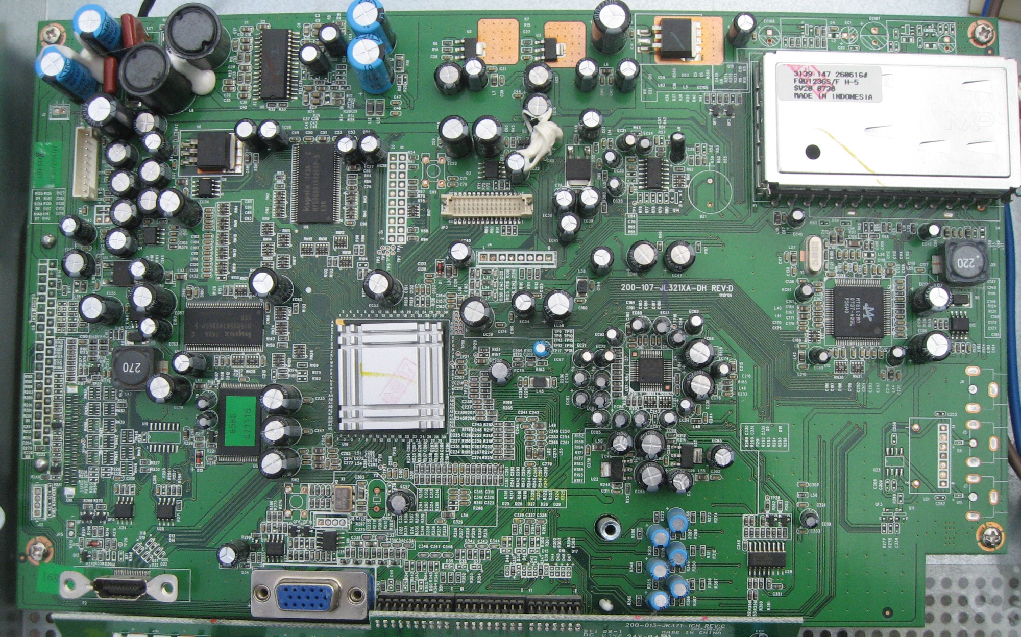

    Please post the pictures of the boards using GO ADVANCED/FILE ATTACHMENT UPLOAD function.
    Pictures will help troubleshooting.

      I have added a photo of the power supply and main boards to the original post. PS is the Proview design...part number IPOS 150, REV. 1.8

        Yes same chassis as used in Polaroid FLX-3211, ELEMENT FLX-3210.
        The 3210 had bad caps in the panel assembly:
        http://s807.photobucket.com/albums/y...nt%20FLX-3210/
        and bad caps in the power supply.
        Take the reading of the 12v and the 5V also.

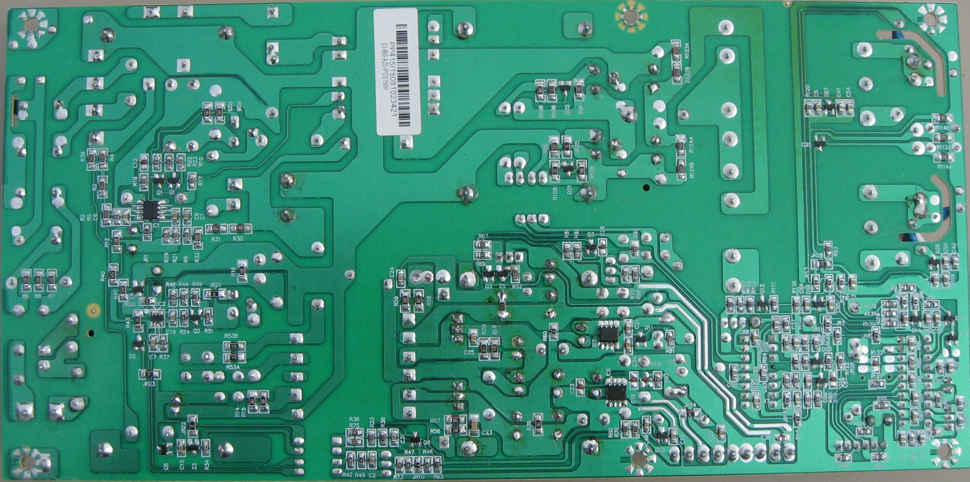

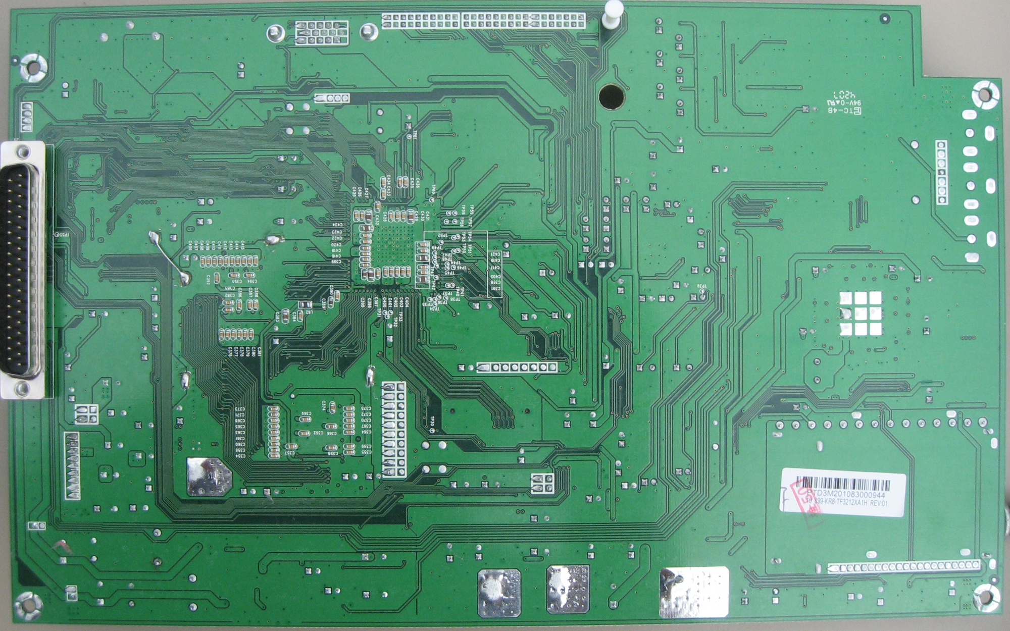

                  Can we have pictures of the back of the power supply and main board and can you do
                  a sharp focussed picture of the main board without the glare.

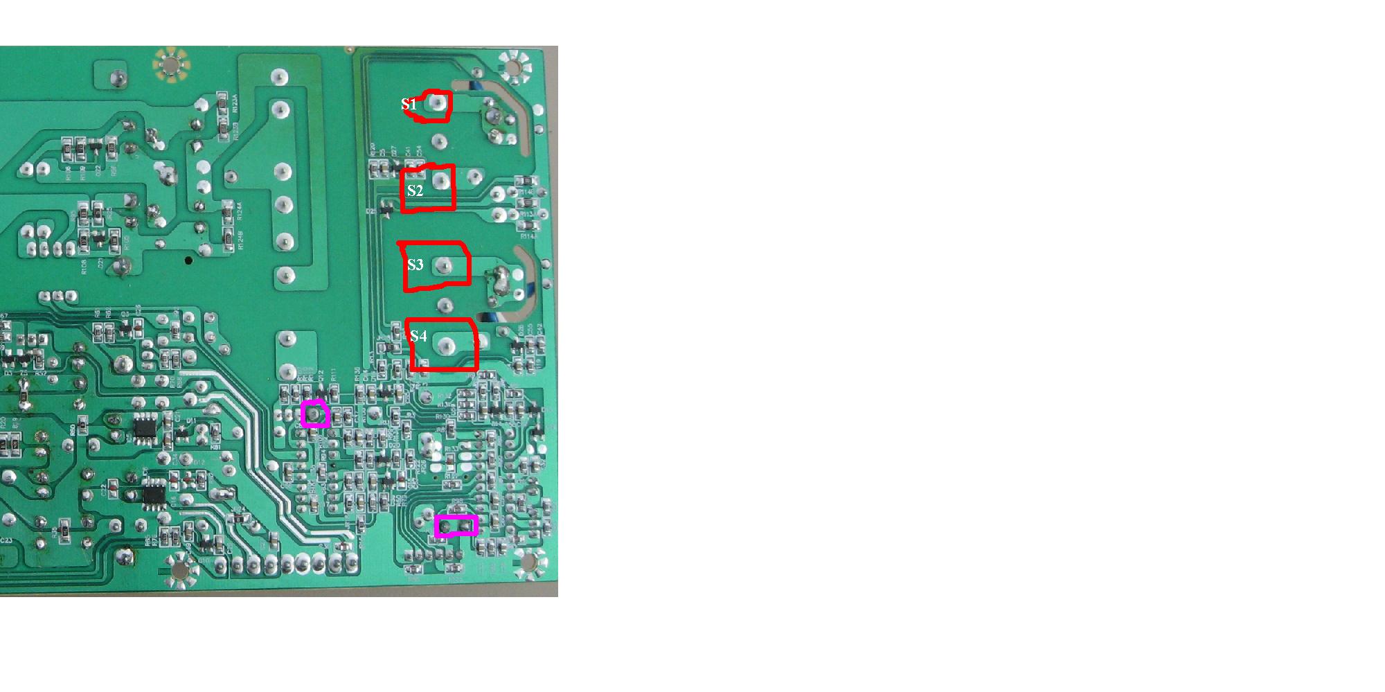

                                  Great picture thanks - wish i could spot something wrong. I have marked a picture with what I thing are the secondary windings although as there was no flash at all I doubt if they are the problem. To Check (Power off)Meter on Ohms 2000 measure S1>S2 and S2> S3 and post results. Whilst looking for these I notice some grey solder joints. May just be the pic but one at least looks a bit odd - perhaps you could reflow them and check continuity with trace.

                                    Thank you for your help. The readings from what you have marked as S1>S2 is 36.46 Ohms, and S2>S3 is 37.34 Ohms. S3>S4 is also similar at 37.13 Ohms.
                                    Good eye on the joints...The upper one you marked is a little grey, but does have continuity. The lower two are one of the capacitors that was changed before I got the TV.
                                    While getting the readings you suggested, I did stumble on a 0 ohm resistor that was open (JR8). Since these are simply used as jumpers, I have soldered in a temporary wire to test with. Unfortunately, due to space limitations, I am not able to test the TV right now. I will post back whether or not this made a difference once I can test it.
                                      Drat, I keep doing that - I did mean S1 to S2 and S3 to S4 but they readings should
                                      be in the hundreds at least, can you check perhaps 364.6 and 373.1

                                        I double checked the transformers. Both are 36 ohms (in circuit). Is this test usually done in circuit?
                                        I still haven't had a chance to test the unit after "repairing" the open circuit 0 ohm resistor yet...too many projects at the same time right now. Hopefully I can clear some room on the bench before this weekend is over.
