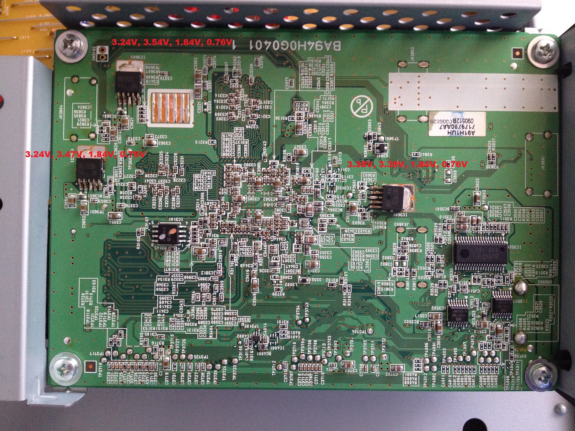

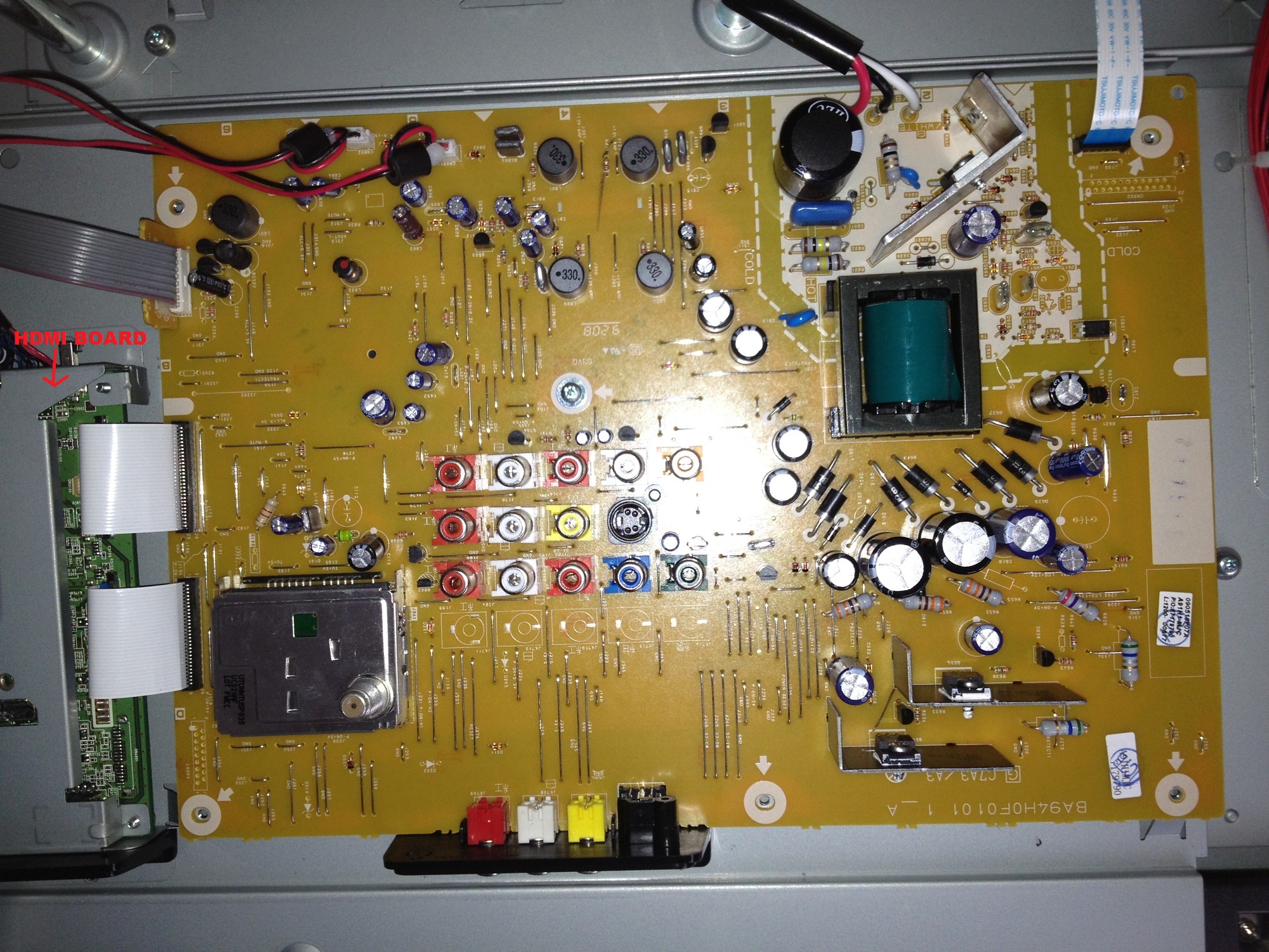

              I took measurements on the hdmi board specifically on the back of the board where the LDO are located while the TV was on and sound not working.
              How do you know if an LDO is bad? The measurements are on the given photo. First photo is of the hdmi board, second is the main board.
                Re: Sylvania 42" LC427SSX Strange HDMI Problem
                No luck on info about those regulators. Are all the numbers the same?
                  Yes all the numbers are the same. They read BD7820 94 26

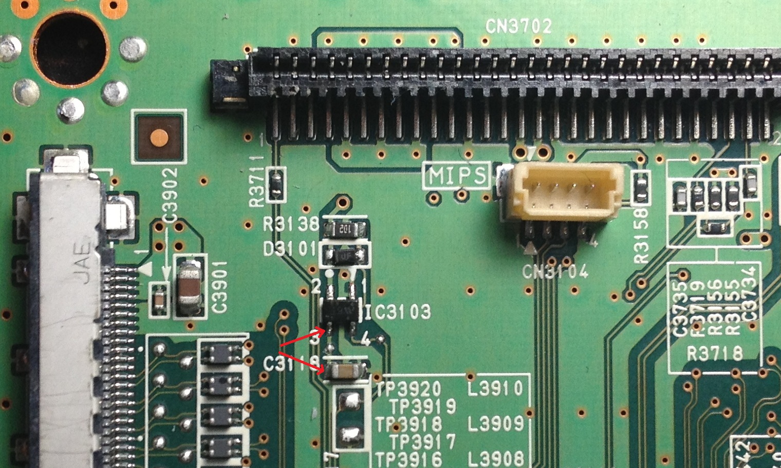

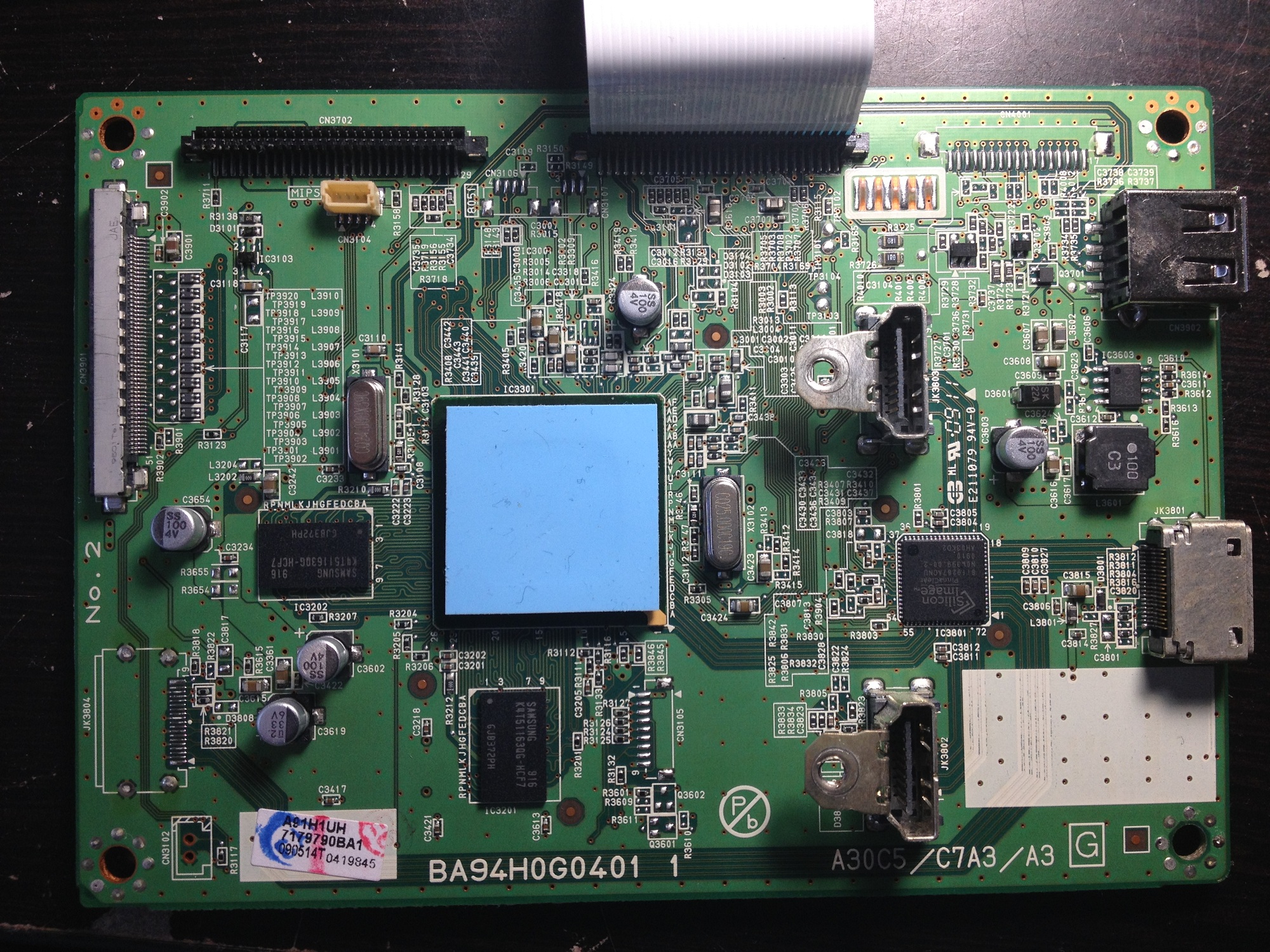

                        Well, I did a bit more probing on the hdmi board and found something very interesting. Heres a photo of the front of the HDMI board.
                        When I tried to measure voltages on the given pins (IC3101 and C3118) that i show on the second picture, the TV seems to turn off and as I remove my probe from the pins, the TV would turn back on and working perfectly with sound and everything. I checked the other pins of the same components but it was normal. At first I thought I short circuited it but I tried probing it again more carefully but still the same problem happened. Next I thought it was due to a cold solder joint so I applied a little pressure on top of the component itself but no change so I don't think thats the problem.
                        I'm not sure what it means, would it point to a bad smd capacitor or the other component (not sure what its called)?
                          Ceramic capacitors (the little brown things) are pressure sensitive. Pressing on them can induce a voltage which could cause the TV to do odd things.
                            what about the component above the ceramic capacitor? Even slighty touching and probing for a voltage measurement at the bottom left pin causes the TV to turn off as if my multimeter is preventing the TV from turning on.
                                  I tried applying pressure to the component and area around it but theres no change or reaction. Well I found that the TV will turn off only when I have one of the probes grounded and the other touching the pin (as if to measure the voltage). If I touch the pin with just a probe while the other isn't grounded, there is no reaction.
                                    I suspect it's just interference or loading by your meter, are you using a DMM or analog meter?
                                      I'm using an digital multimeter
                                        Strange, but I wouldn't consider it a fault.
