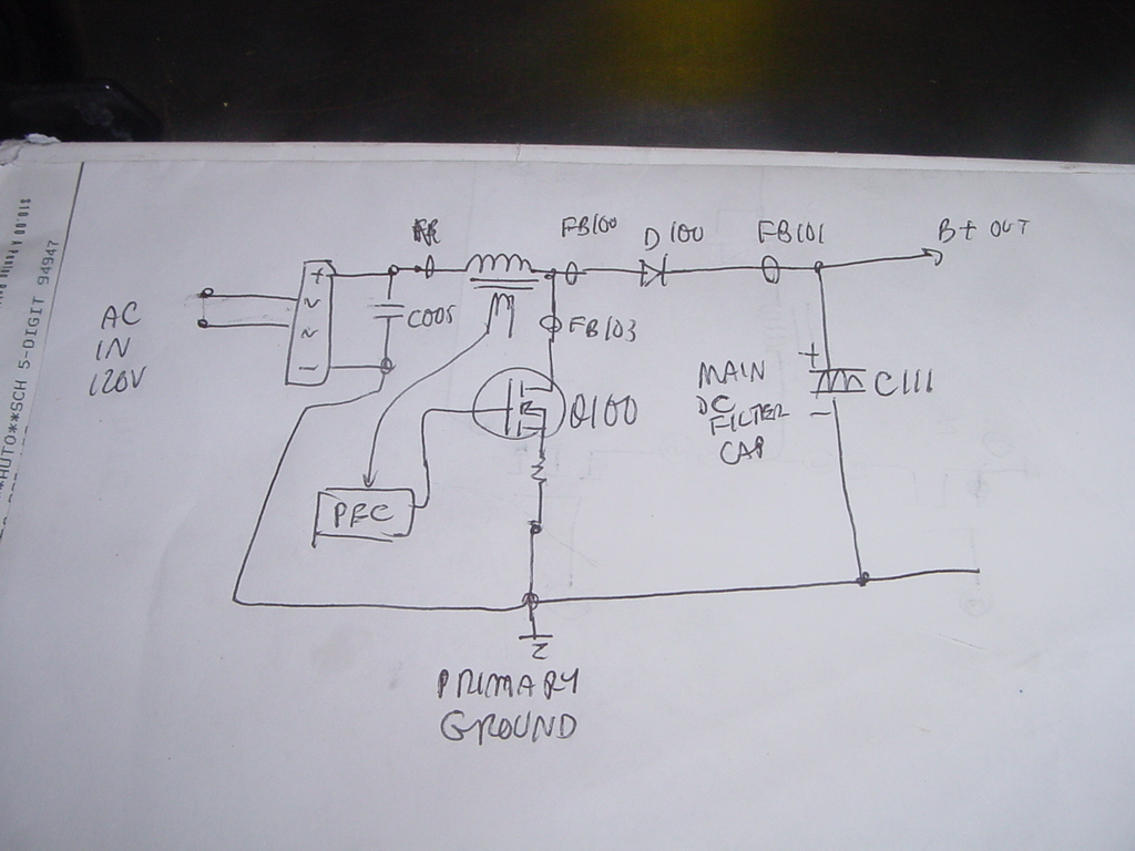

    Originally posted by Rtech
    Inside pair AC In ????
    Outside Pair DC out ????/
    Is this what you meant: DC- AC AC DC+
    If these measurement points are correct then I got: DC= 171.4V AC= 123.7V Does that sound correct?

      Re: Vizio E321VL
      If you are getting 174 Vdc at the two pins of the Bridge, that means the big cap does have connections all the way to the bridge output, but I am confused since you have indicated that you are not getting any DC voltage on the Big cap. This power supply has PFC circuits, so when you plug the TV into the outlet, the voltage on the big cap should be around AC input voltage x 1.414, and when you turn the TV on, the DC voltage should go up to around 400Vdc on that big cap.

          Re: Vizio E321VL
          That makes two of us that are confused. I will recheck the the voltage on the Big Cap and report back in a few minutes.

              • 502
              Re: Vizio E321VL
              Well I checked the cap again and I got 0.4V DC. Should I pull that cap and check ESR etc? Maybe it was bad even though it was new?

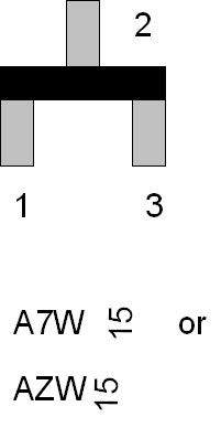

                        Re: Vizio E321VL
                        seems like i had one of these in with a bad surface mt diode it was underneath back side of powerboard. near the startup cap, i overlooked it twice and after i let it set for a couple of days i found it. try checking around the area of the cap and see if you find an open sm diode.

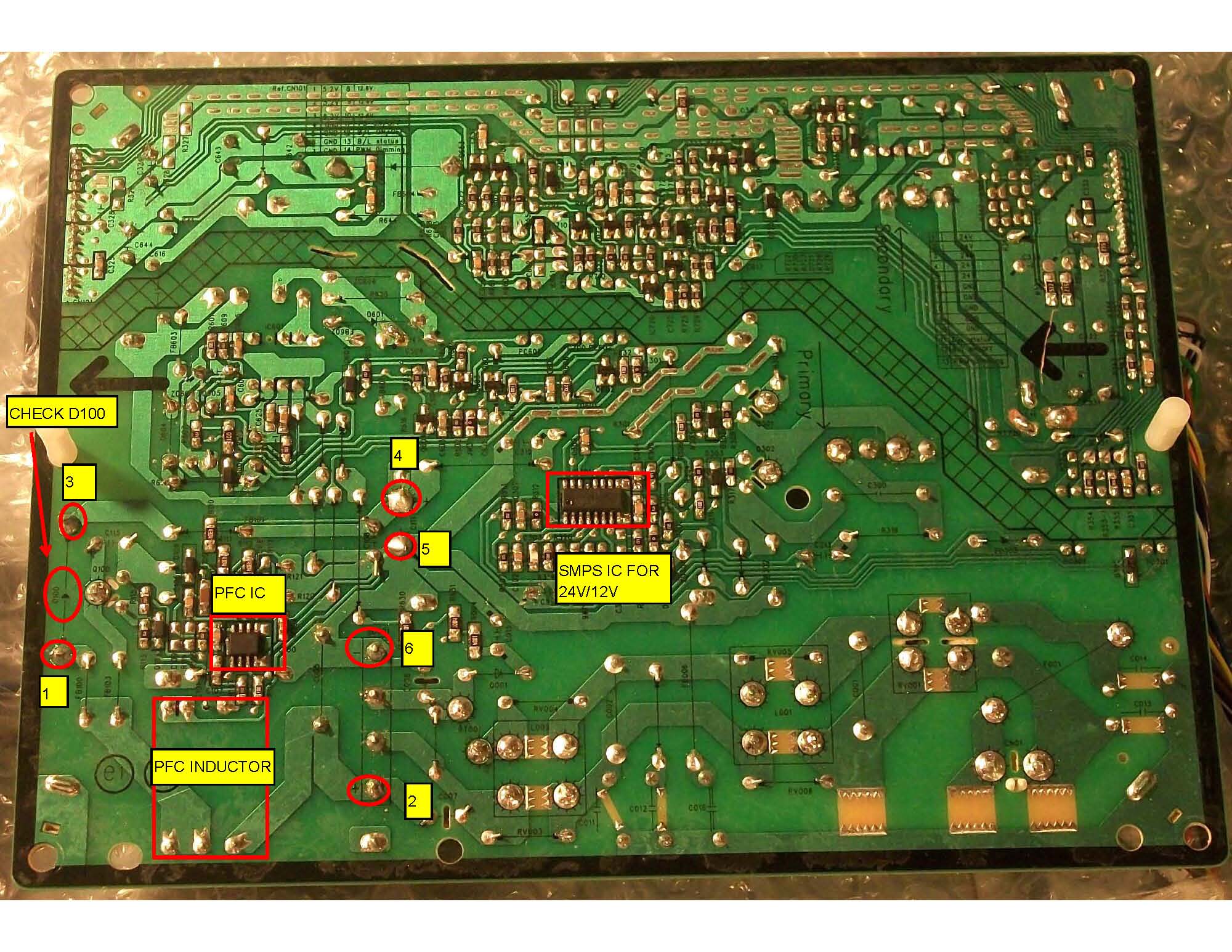

                          #32
                          Re: Vizio E321VL
                          Please see my redline on the test points and check D100.
                          Check resistance between:
                          1 & 2
                          3 & 4
                          5 & 6
                          They should be less than one Ohm.

                            #33
                            Re: Vizio E321VL
                            1 & 2
                            3 & 4
                            5 & 6
                            Checked 1-2 = 0.3; 3-4 = 0.1; 5-6 = 0.1

                              #34
                              Re: Vizio E321VL
                              The only Diode that I could find was one of those small 3 legged type. I looked for a DataSheet, but could not find one. Number on top of diode looked like either AZW15 or A7W15 the 15 was turned sideways to the letters. I measured ohms between the 3 legs. First leg on bottom of diode, second leg at top and third leg (actually 2nd leg) on bottom.
                              1-2 = 0.801mohm; 1-3= 1.737kohm; 2-3= 0.767mohm.

                                #35
                                Re: Vizio E321VL
                                OK, you do not have open trace.
                                How about the D100? That Diode is the one that feed the rectified AC into the large cap.

                                    #37
                                    Re: Vizio E321VL
                                    I am still trying to find out why you are not getting the 170vdc on that large cap, as you can see from testing the connection, the traces are OK the only thing that in the path of the + output of the bridge to the + of the large cap (inductor tested OK) is that Diode D100, you can also see it in the diagram I provided, unless that Diode is open (or installed backward), then there is no other reason for not getting any DC on that large cap.

                                        #39
                                        Re: Vizio E321VL
                                        Picture of that D100 as mounted will help also.
                                        • killian6pk
                                          • Apr 2010
                                          • 502
                                          #40
                                          Re: Vizio E321VL
                                          Well you can officially put me into the dumber than a rock catagory. It was in backwards. Took it out and resoldered it and now I am getting 171.9 volts at the Filter Cap. However I am not able to get the voltage to increase by pushing the on/off button. So I guess now I should check for 5V, 12V and 24V at the cable to the Main Board? Also I gave you wrong info above in post #36 about what that Diode was. I corrected that post in case someone needed that info later.
