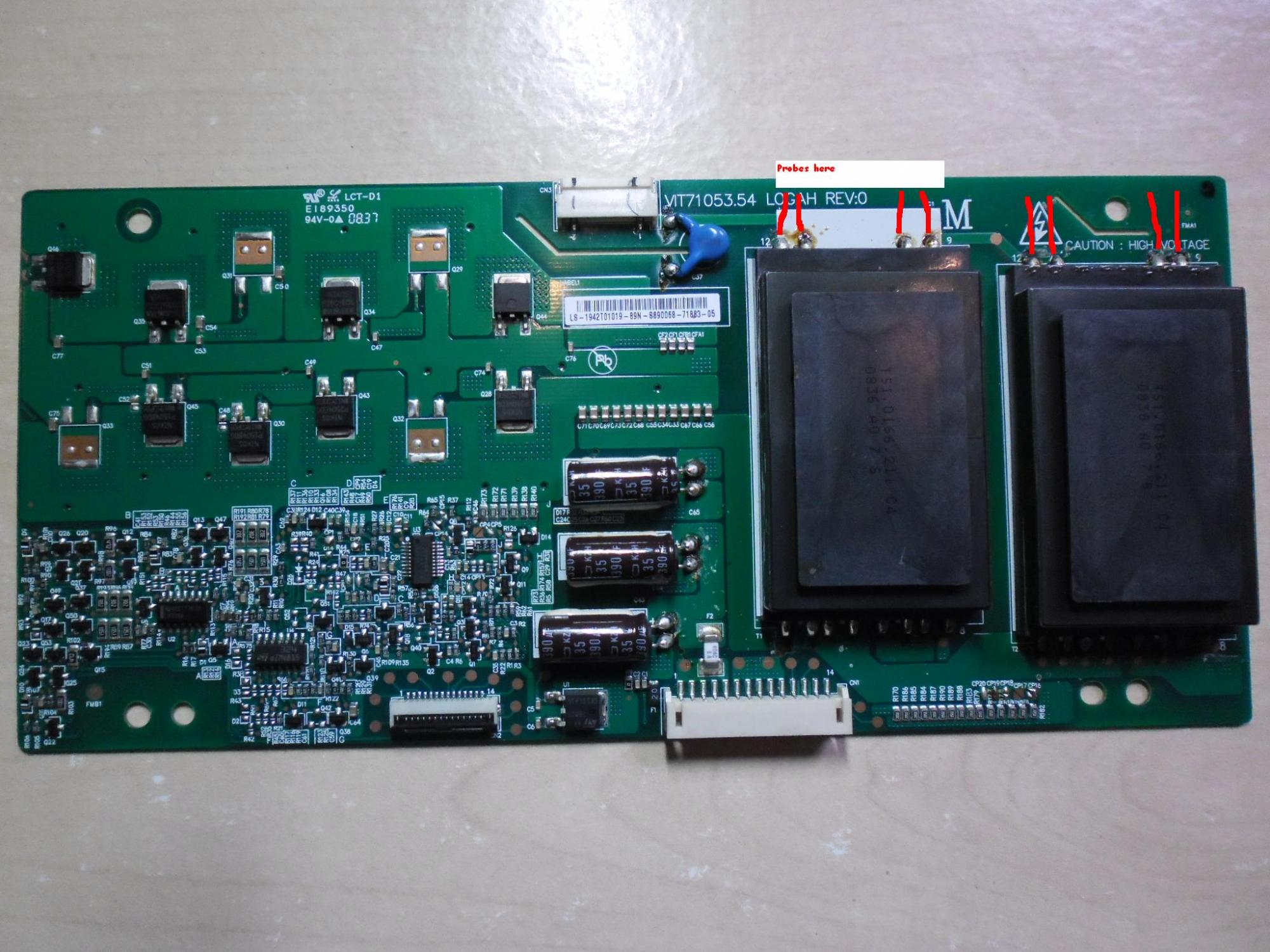

    test1=0.00
    test2=0.00
    test3=0.00
    test4=0.00
    slave
    test5=0.00
    test6=0.00
    test7=0.00
    test8=0.00
    And the same results with probes in reverse order.
    Have not got to take the cover of t-con as yet, seems a bit tricky. will do tho

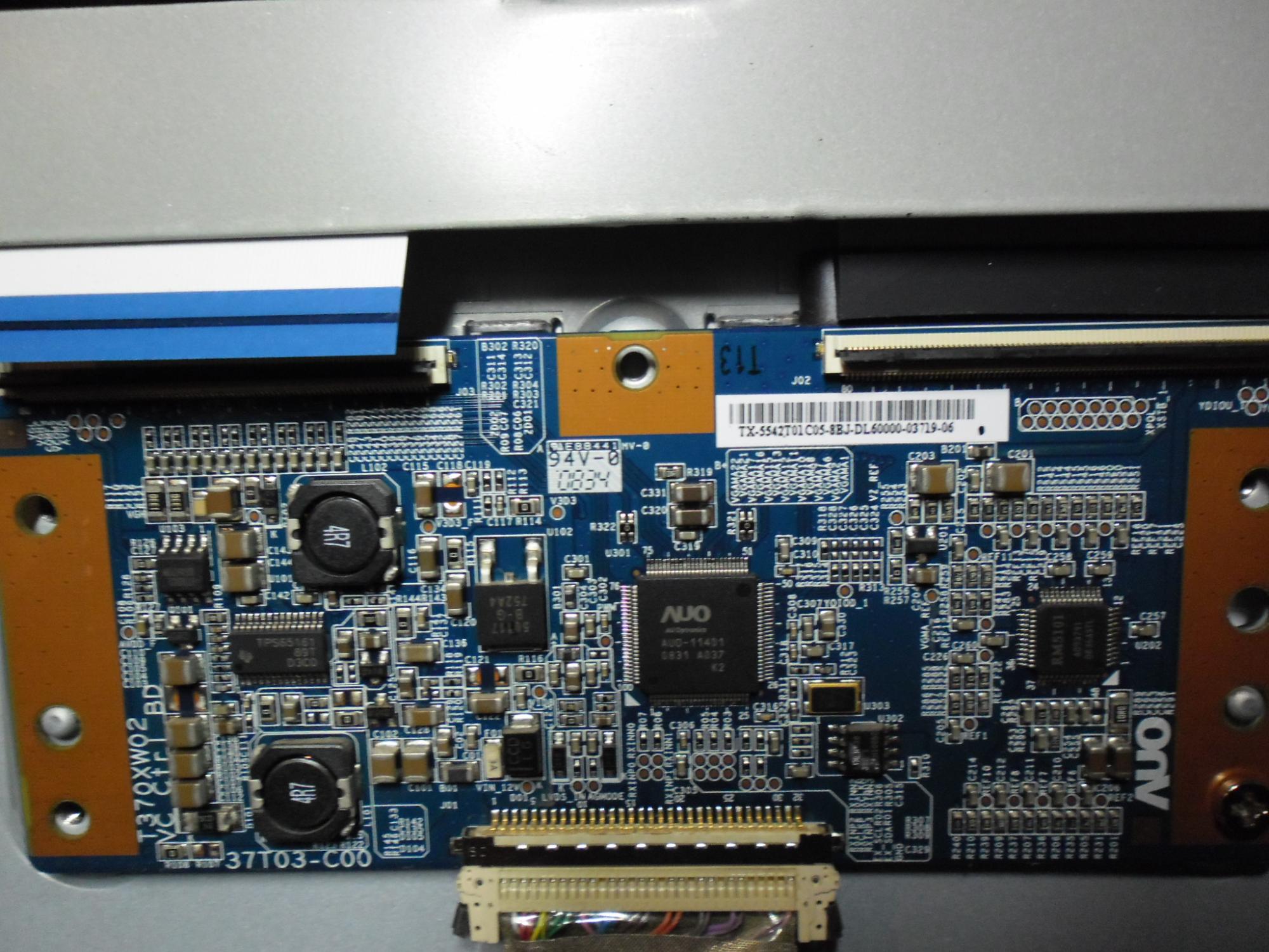

      can you post a pic of the t con and cover we may have some ideas on how they come off.

        ok got the cover of, cable a bit more harder

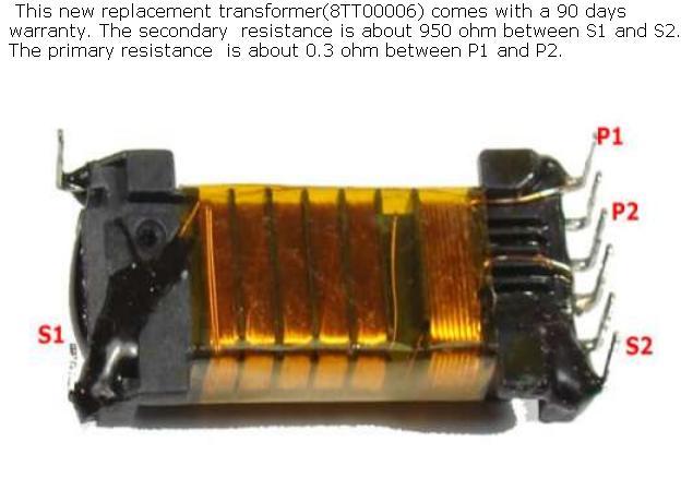

            Can you see the fuse on the tcon - small white 3A
            Think you have tested transformers incorrectly
            Put on 2000ohms (Not 20k) and put one probe on pin12 then the other probe onto each of the other 3 pins on that end in turn

              meter set to 2k
              Master
              Transformer T1
              test 1 = .000
              test 2 = .000
              test3 = .000
              Transformer T2
              test 1 = .000
              test 2 =-1 on left side
              test 3 = 1 on left side
              Slave
              transformer T200
              test 1 = .000
              test 2 = .000
              test 3 = .000
              tranformer T201
              test 1 = .000

                Yea fuse on T-con checks as ok

                      Still dont think we have the correct test for the Transformers. They usually measure 400 -1500 ohms Some of them have one end of the secondary at one end and the other at the opposite end of the transformer. I have looked on line but cant find much on these transformers - but it is good I can read the part numbers in your pics.
                      The likelyhood of all secondaries being sorted or open is like winning the lottery.

                              selldoor you see the pix in post#86
                              If you look in the center of board, it looks like bits of solder all over the gaff.
                              I know whot you saying but this looks kinda unprofessional.

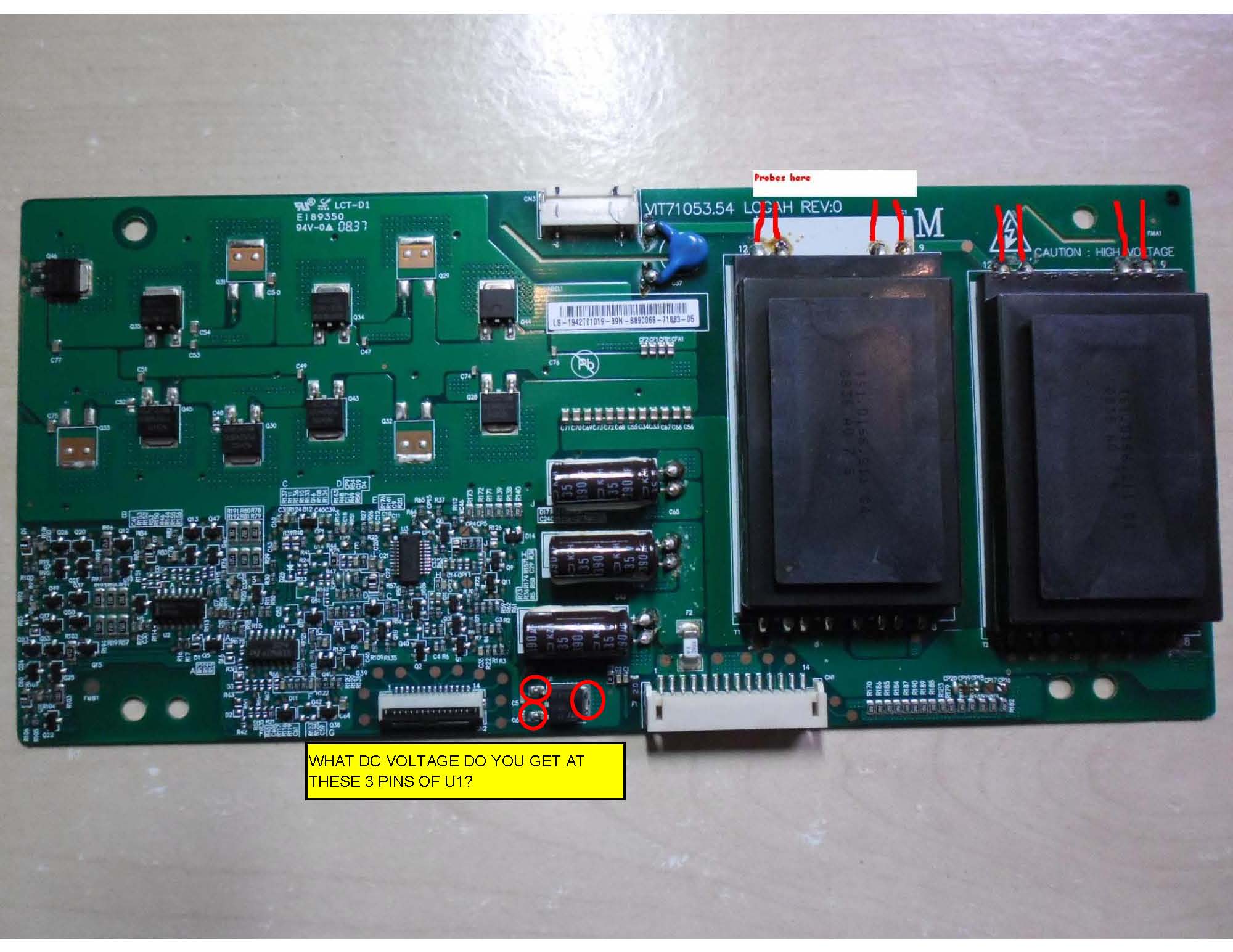

                                #95
                                Re: 42lg3000-za No Picture but got sound
                                Post #6
                                "pin 1 is a blue wire should be 24v
                                pin 2 is grey 24v
                                pin 3 is grey 24v
                                pin 4 is grey 24v
                                pin 5 is grey 24v
                                Then the next 6 to 10 are GND
                                pin 11 =BR1
                                pin 12 =on/off
                                pin 13 =pwd dim
                                pin 14 =error"
                                So do you get 2.9VDC (as indicated in post11) at the pin 12,
                                Pin 14?
                                By the way, what is the P/N of the Inverter controller IC?

                                  #96
                                  Budm
                                  post #11
                                  pin 10 on/off meter reads 2.9
                                  pin 11 pwm dim meter reads 0
                                  pin 12 n.c meter reads 0

                                      Please see the redlined test points with reference to the chassis ground.
