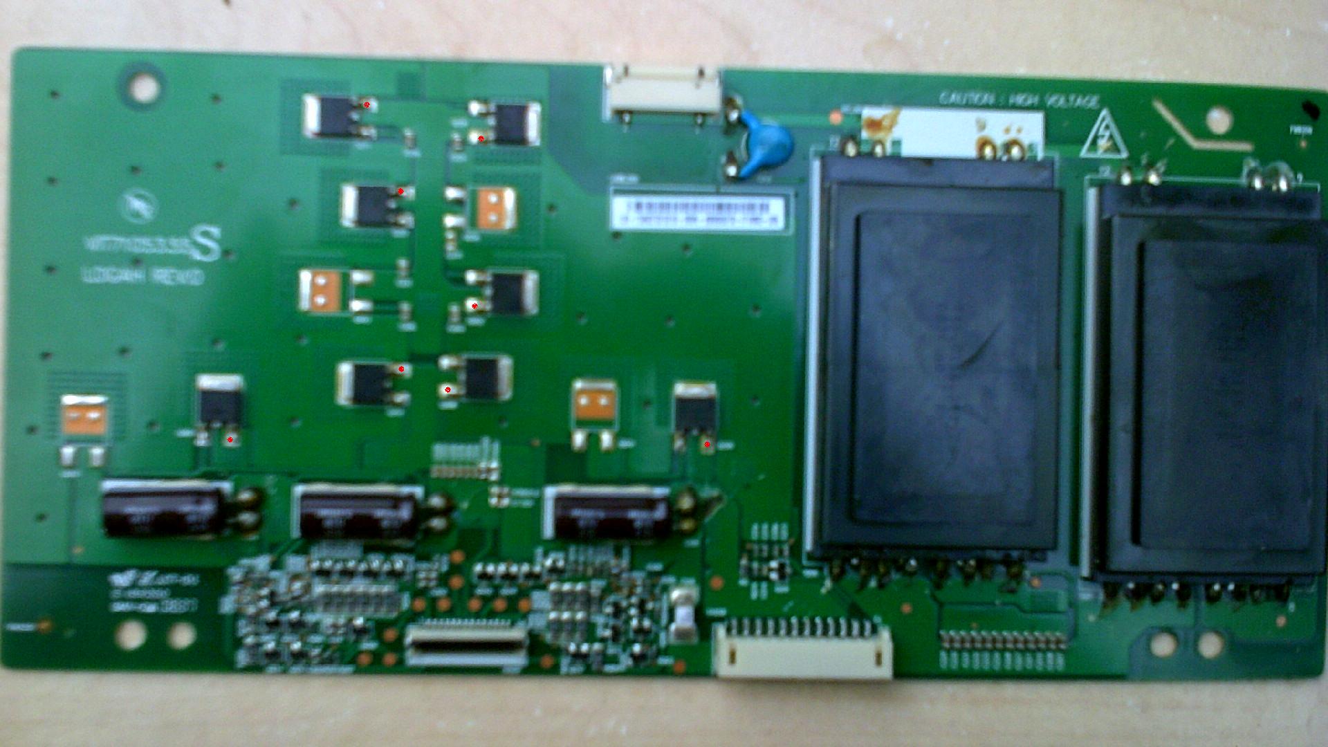

      On the master inverter all to the top reads
      The first 2 top left Nikos P1504BDG-WN19K0P05
      The 2 top right Nikos P2504BDG-WN12K0306
      The first 2 bottom left Nikos P1504BDG-WN19K0P05
      The 2 bottom right Nikos P2504BDG-WN12K0306

          Re: 42lg3000-za No Picture but got sound
          The 2 top left Nikos P1504BDG-WN19K0905
          The 2 bottom left Nikos P1504BDG-WN19K0905
            #45
            Okay so with the big fat "tab" pin facing upwards the left hand pin will be the gate. Connect your black probe to the frame of the TV and on each MOSFET probe the gate pin using the red probe, and on the 200 ohm range. You should never see anything other than a single "1" if the MOSFET/driver are okay. If you see something different, note the board the fault is on. Do this with power disconnected from TV.

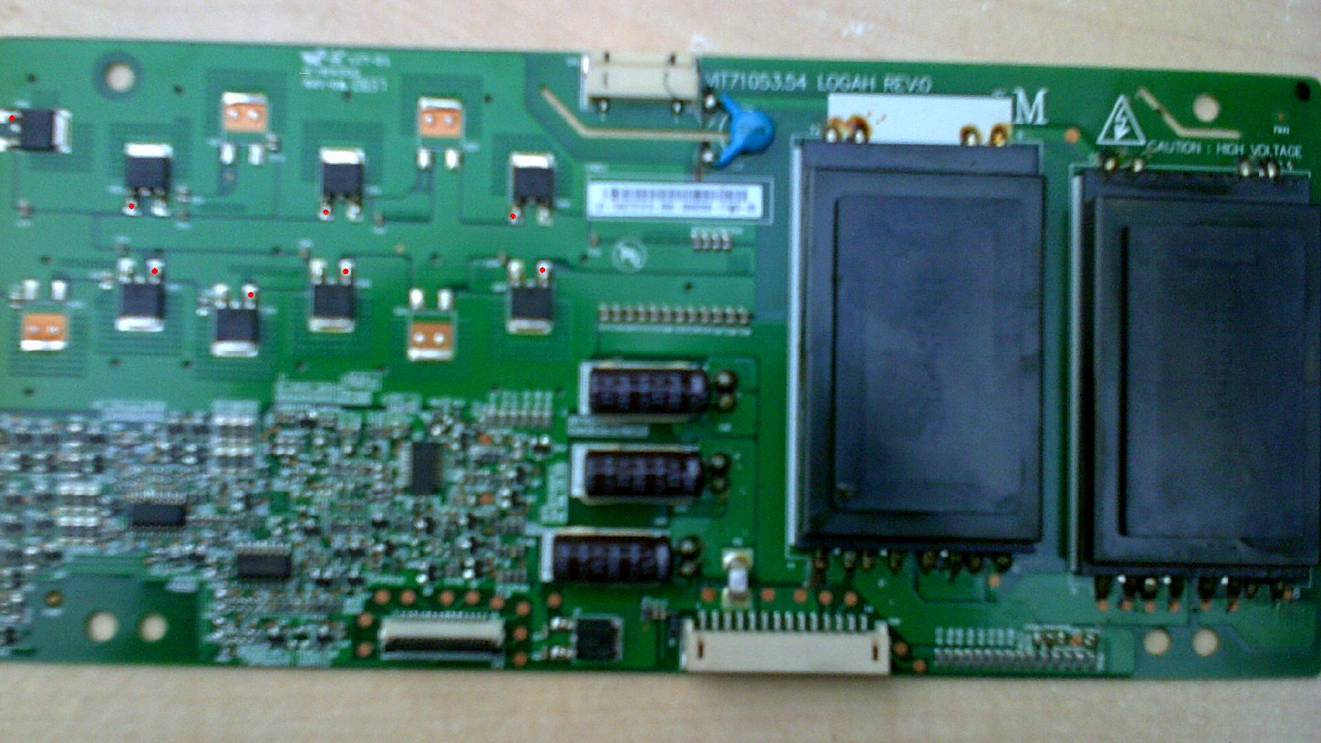

              #46
              Is this correct the legs with red dots.
                #47
                Master fine... slave you've got them the wrong way around. If tab were facing upwards, the gate is the left hand leg.

                                  #56
                                  Yea all connected, put tv not powered up
                                    #57
                                    Okay next step. Check between the right hand pin and the tab pin of each FET. You should see the same "1" reading. I'm trying to locate a short here that might stop the inverter from working.

                                      #58
                                      Do the same test again but this time, probe the other leg?
                                      Or the lil bit in the middle of the mosfet and the right leg of mosfet?
                                        #59
                                        The fat tab pin at the top and the other leg.
                                        If this passes, the next step are the inverter transformers themselves.
