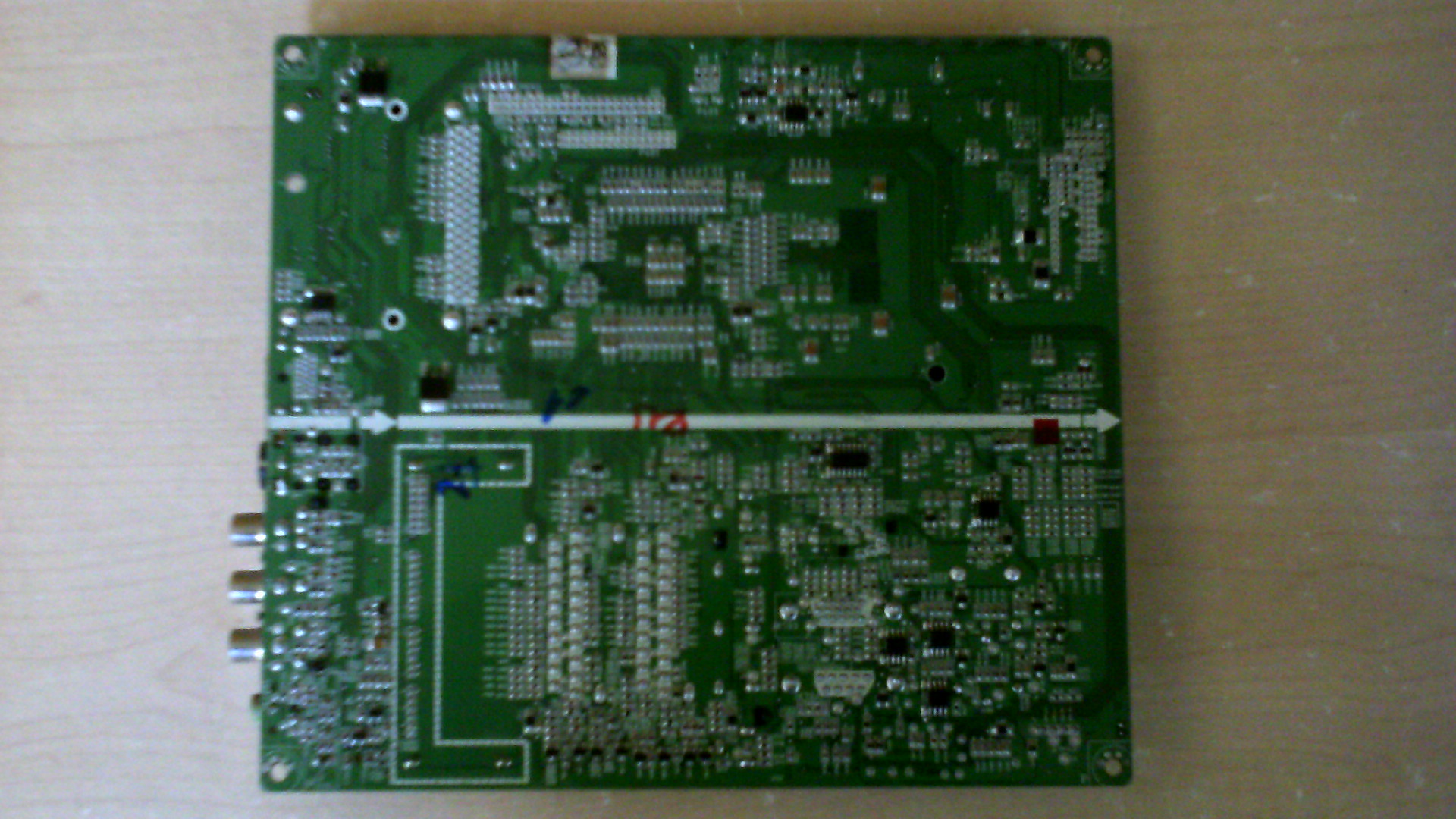

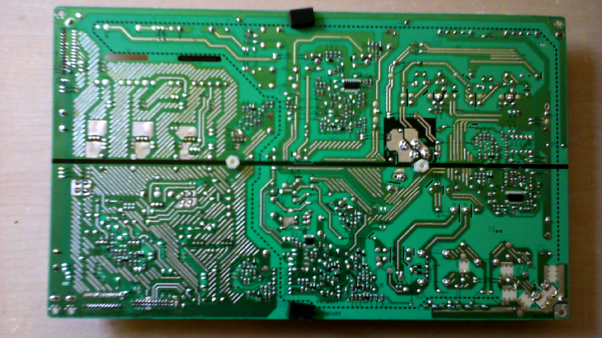

                                Here the shots as promised
                                  Re: 42lg3000-za No Picture but got sound
                                  Too blurry to see anything really - does your camera have a macro mode?
                                  My 42LC46 flashes the LED a few times when first turned on, seems normal.
                                  I would suspect the inverter board.
                                    in pic 6 by the bottom white connector to the left of it theres a white fuse does that test ok?
                                      Same goes for Pic 5 White rectangle is probably a fuse.
                                      Test with meter on Ohms one probe to each side of fuse- should be the same as touching probes together.
                                      Probably need more light for photos - can you take outside for best natural light
