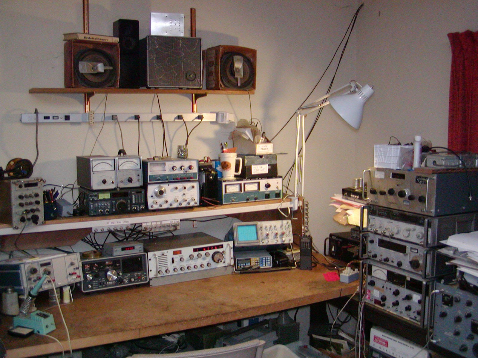

        Well, here is a picture of *one* of our benches... and some of the equipment I have at my disposal... now if I could only find my box for my TV so I could bring it in!
        Should have pics of the boards by weeks end!

          thats a helluva bench!,lucky barsteward

                      I would love to have a bench like that. There needs to be a drooling emoticon. DROOL DROOL

                        Nice workbench there Mulimeter! I see Ham radio and Heathkit items too. I used to two way radio .
                        I did not use it anymore. Kept Freq meter.Dispossessed of dummy load, SWR METER, deviation meter
