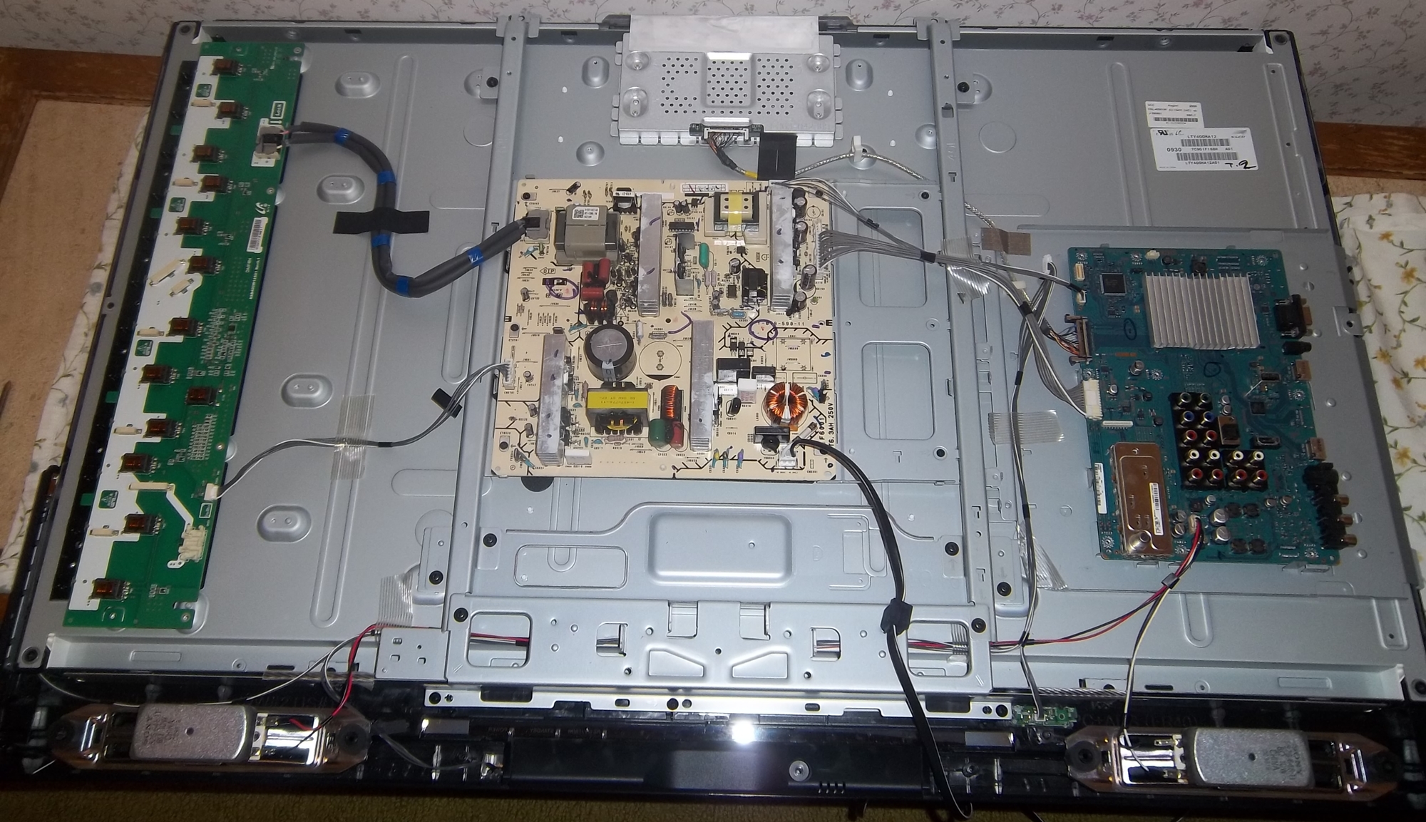

    I have a Sony Bravia KDL-40S5100. Before TV died the HDMI inputs would stop working during certain thunderstorms. But after unpulgging the TV for Awhile the TV would be back to normal.
    There was one storm that the TV did not make it through. It also killed the HDMI output of my PS3 and Comcast cable box.
    The power does come on. The green power light does come on. The Backlight does not though.

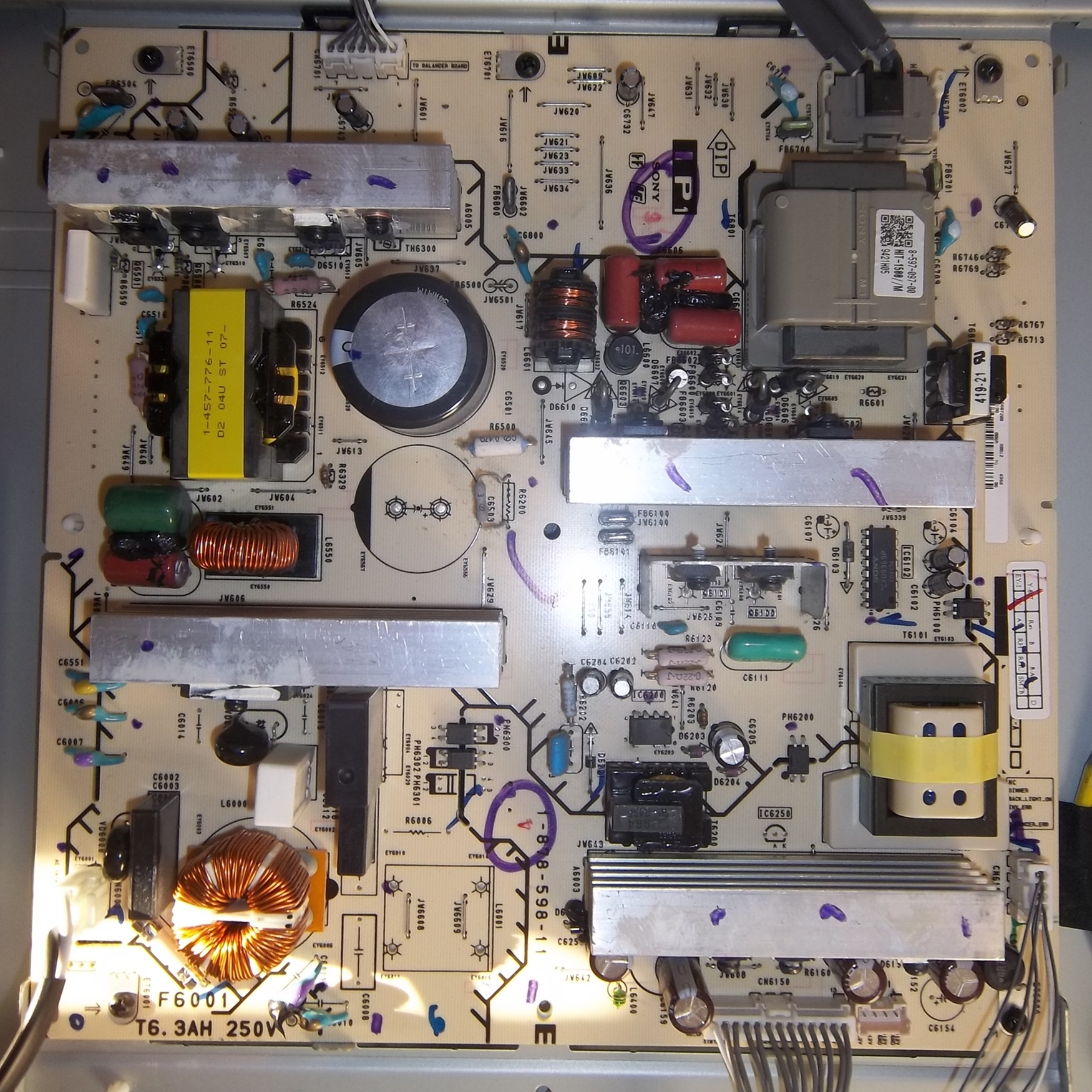

    I have tested the Volts on the power supply board where the main board and the inverter board are connected and have gotten the correct voltage.

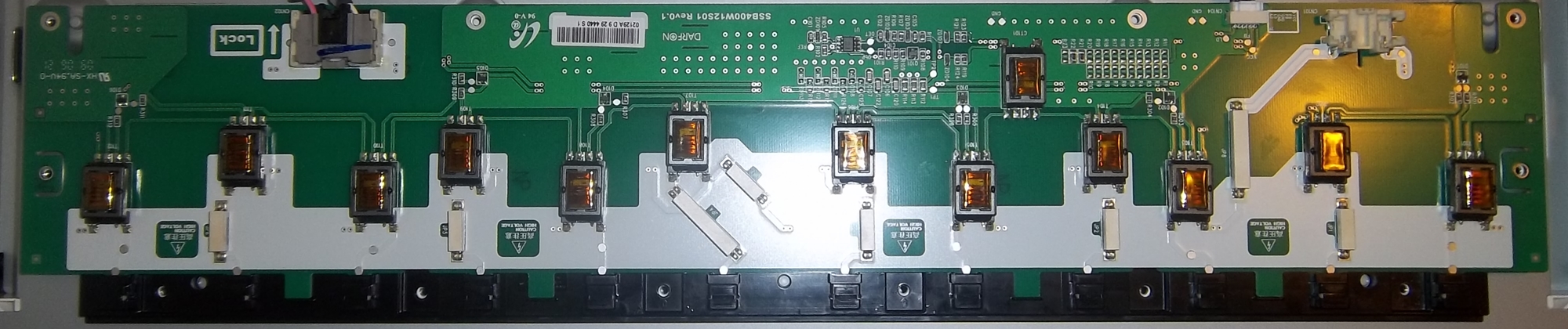

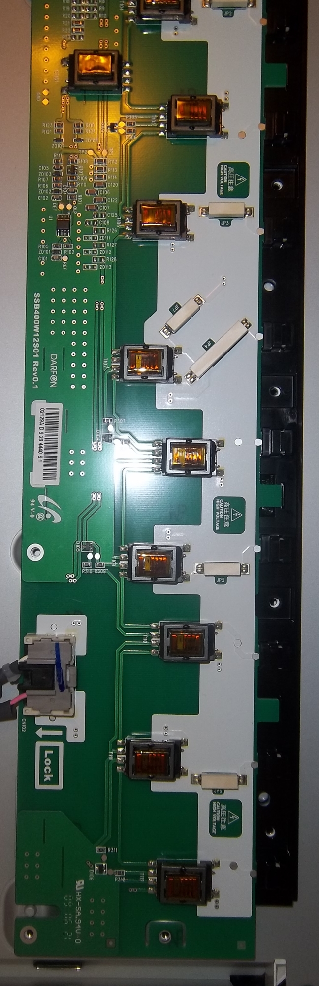

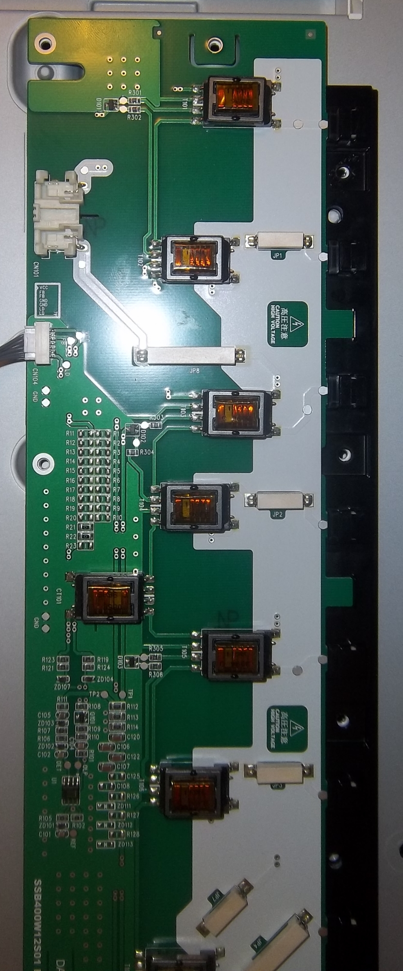

    I have not checked the HV lines between the inverter and power supply board. I have read that these could be checked and also that they cannot. so not sure about them.

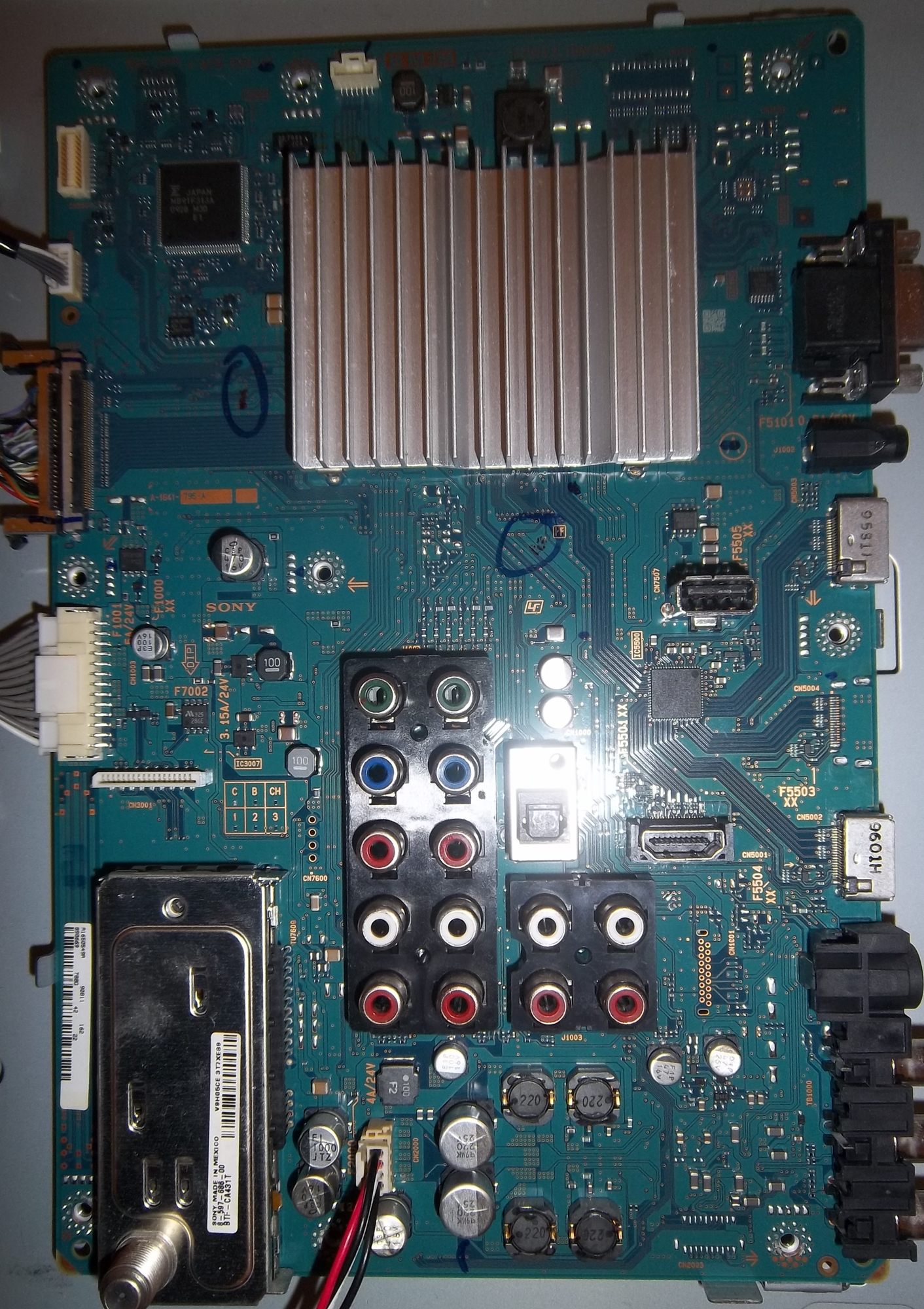

    I believe I have checked all the fuses on the main board. I tried testing the resistance of the transformers on the inverter board, but not quite sure wether i was testing correctly.
    I know i can rule out the TCON board. And I think that the power supply board is good since I get the right Volts on it. So that leaves the Inverter board or main board.
    I was thinking of buying an inverter board to see if that will fix it, since it is the cheapest on ebay. but I dont know if i can completely rule out the power supply board. I also dont want to buy a inverter board and a power supply board just to find out it is the main board.
    I am unsure how to proceed at the moment,
    Any assistance would be greatly apprecitated.

      I can see the pics first one -is great but second one needs to be better for troubleshooting. We also need the backs of the boards - try not to use flash as it obliterates the detail
      Does the green power light stay on and if so can you connect up a source and see if there is a very dark image of it - perhaps using a flashlight at various angles.
      "The Backlight does not though." not even for a second?
      "I believe I have checked all the fuses on the main board."When you say tested was that by ohms or continuity beep?
      Can you list the fuses you have checked in case we spot any more and assume you have checked them.
      "I tried testing the resistance of the transformers on the inverter board, but not quite sure wether i was testing correctly." Hmm! im not sure how to test those either but if you check the resistances on the ends with two pins and list them T1 T2 T3 etc and see if there are any odd ones
      Do you have soldering equipment and can you use it?
      EDIT HT Cable - just examine the ends for damage and test for continuity and shorts
      Any Audio also any clicking hissing sounds

        Thanks for the replies and sorry for the long absence. Other hobbies and lack of money kept me from pursuing the fixing of my tv.
        I was just going to order another Main Board, since that is most likely the problem, since i get power and cannot get any sound or video.
        This led me to another problem though. looks like someone else had the same issue as i might be having now.
        http://www.tv-forums.com/forum/TV_Eq...cture_P108496/
        I have a Sony kdl-40s5100 with:
        LCD panel : LTY400HA12
        T-con : NP_HAC2LV1.1
        Power supply board: 1-878-598-11
        Inverter Board : SSB400W12S01
        Main Board : 1-879-020-12
        I recieved the TV free from Sony to replace my 50" Sony Wega with a bad optical block, so it might not be the original boards in TV.
        All the information i can find online shows me that a 1-879-020-11 board should of been in the tv to begin with.
        Should i get a 1-879-020-12 or 1-879-020-11 to replace the probably bad Main board?
        Any help would be appreciated.
        • Jim1590
          • Jul 2013
          • 98
          Re: Sony Bravia KDL-40S5100 No Picture, No sound, No Backlight,
          I had a Sony KDL-46SL140 also go bad on me. It is a 46". When I opened it up the main board, (BM5 in my case, yours is a BM3) was for a 40" KDL40SL140. I think the only real difference was that mine was a larger screen. Everything else was the same as the lower screen size model. The manual even has both models on it.
          I looked at the -12 on shopjimmy and it is a known part for the 46S5100 and you have a 40S5100. I think you are running into the same thing. The parts are somewhat interchangeable even if there is no documentation as such. If nothing else, the -12 is for a higher end TV.
          You always want to replace the same exact board number that you pulled out that was working, so go with that first. But if it comes down to availability of the part get what you can. For the life of me I really do not recall if I got the 40" or 46" BM5 for my TV and I really do not want to pop it open to find out. I am 90% sure I got the "wrong" one because it just was not available anywhere.
          This board here: http://www.shopjimmy.com/sony-a-1727...dl-52s5100.htm shows the 1-879-020-11 in the upper right and it is for the 52" version of your TV. I found that one by typing in the -12! Sometimes I really hate Sony boards.
          So long story short, get what you can find for this master model maybe different screen size and see if it works. Just make sure the numbers match up as close as you can and it looks EXACTLY the same. But just cause it worked for me, it may not work for you.
