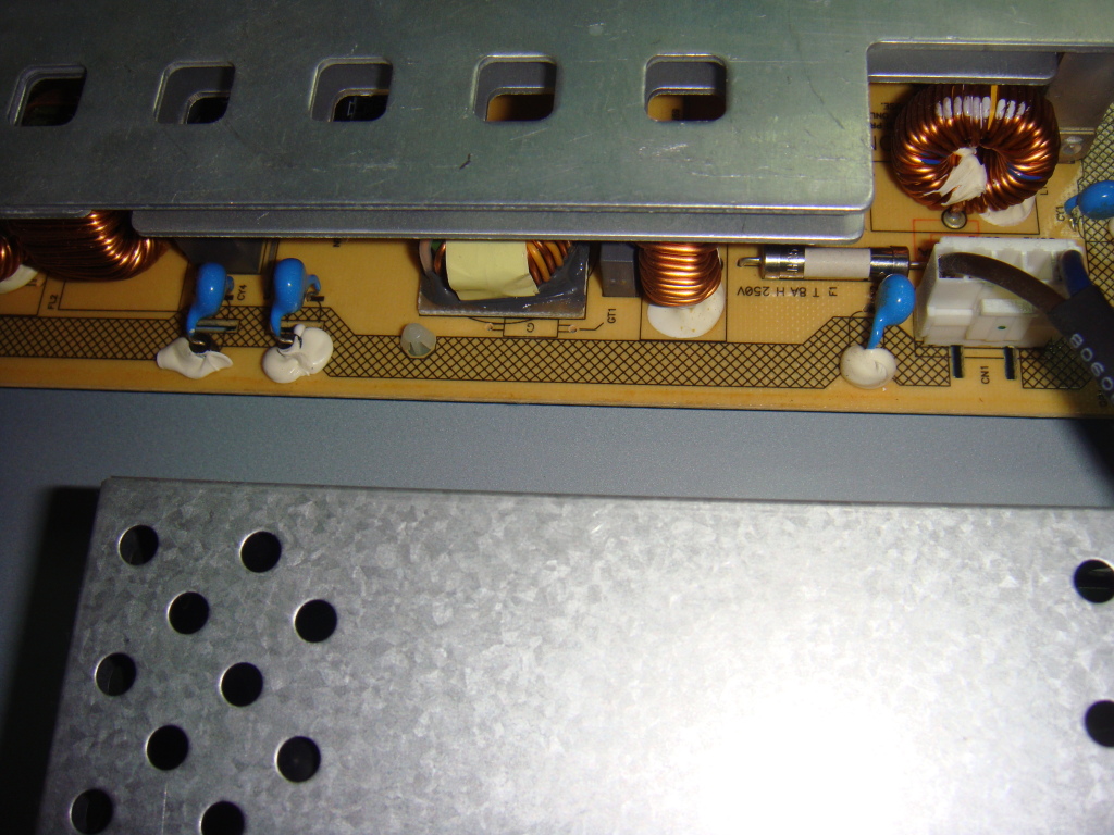

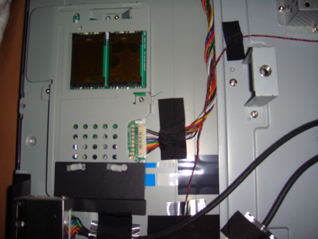

    Vizio SV470XVT1A

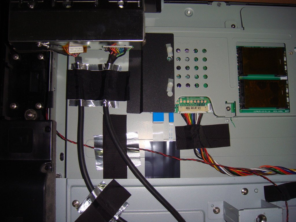

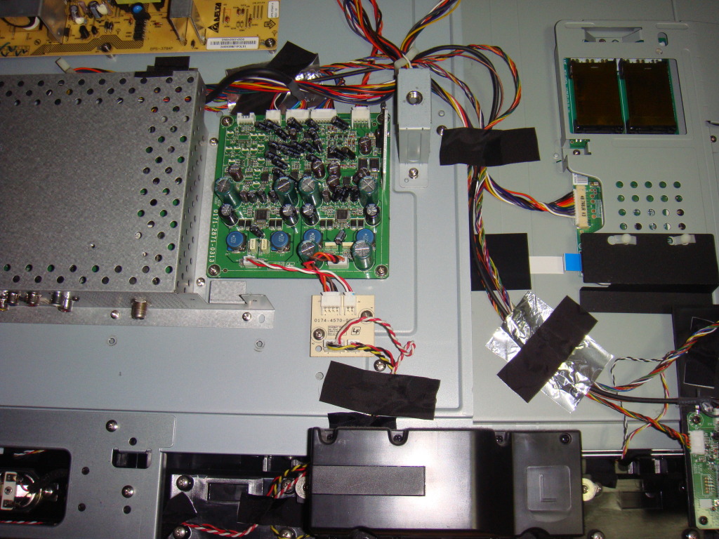

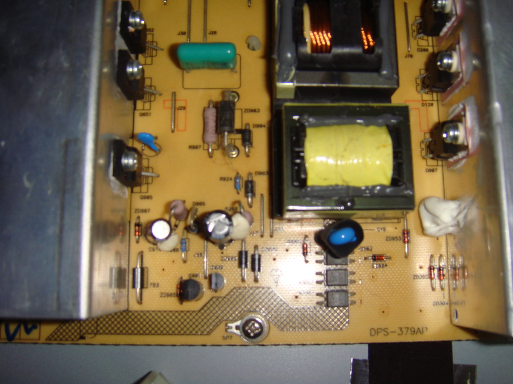

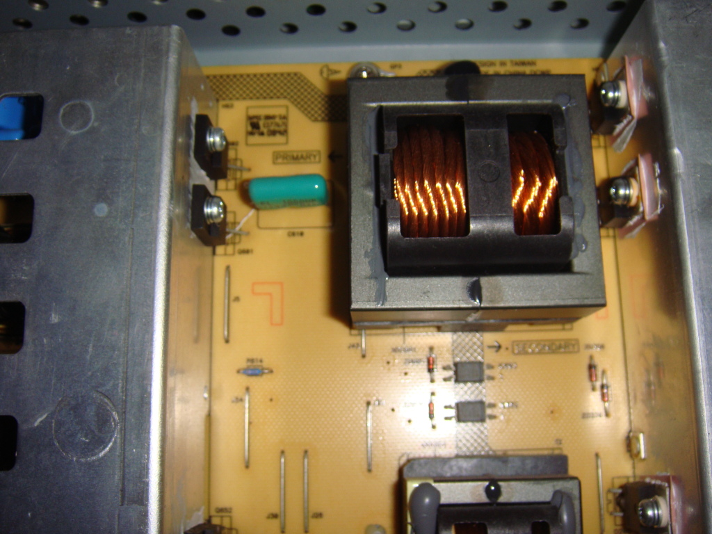

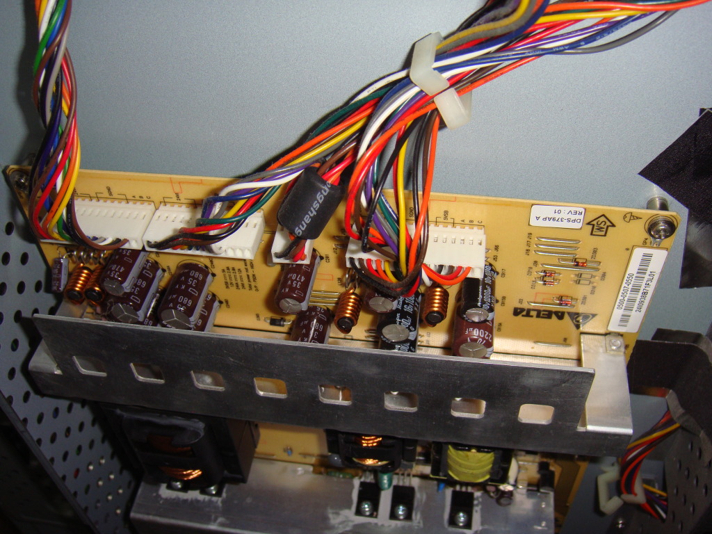

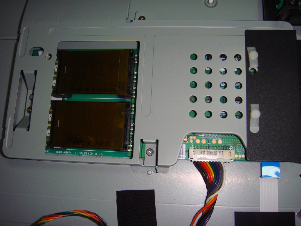

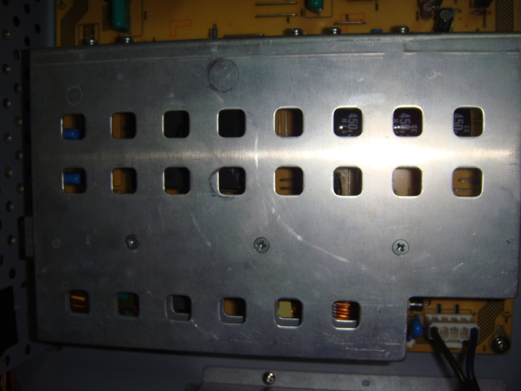

    Was watching Mayweather vs. Cotto fight and the tv suddenly turned off after hearing a sound like "tack". Now the Vizio logo is does not turn on (no longer orange) seems the unit is not getting any power.
    Any idea?
    Re: SV470XVT1A Will not turn on

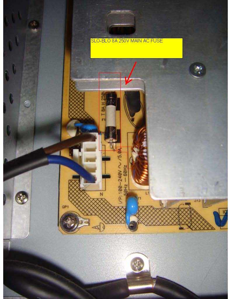

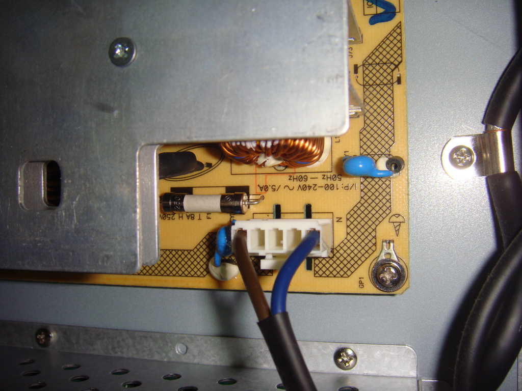

    You need to open it up and check the Main fuse first. Look for any burn parts inside also.
    Post good clear pictures of the boards using upload function.

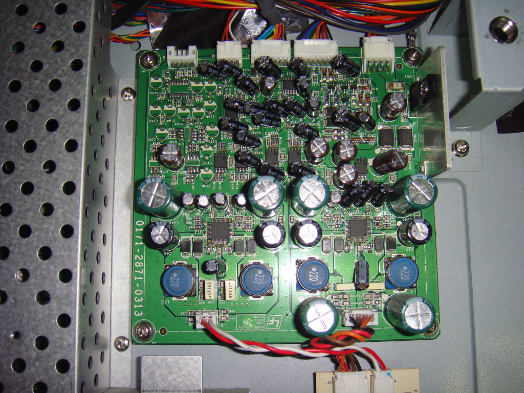

      Inline pics removed and uploaded.

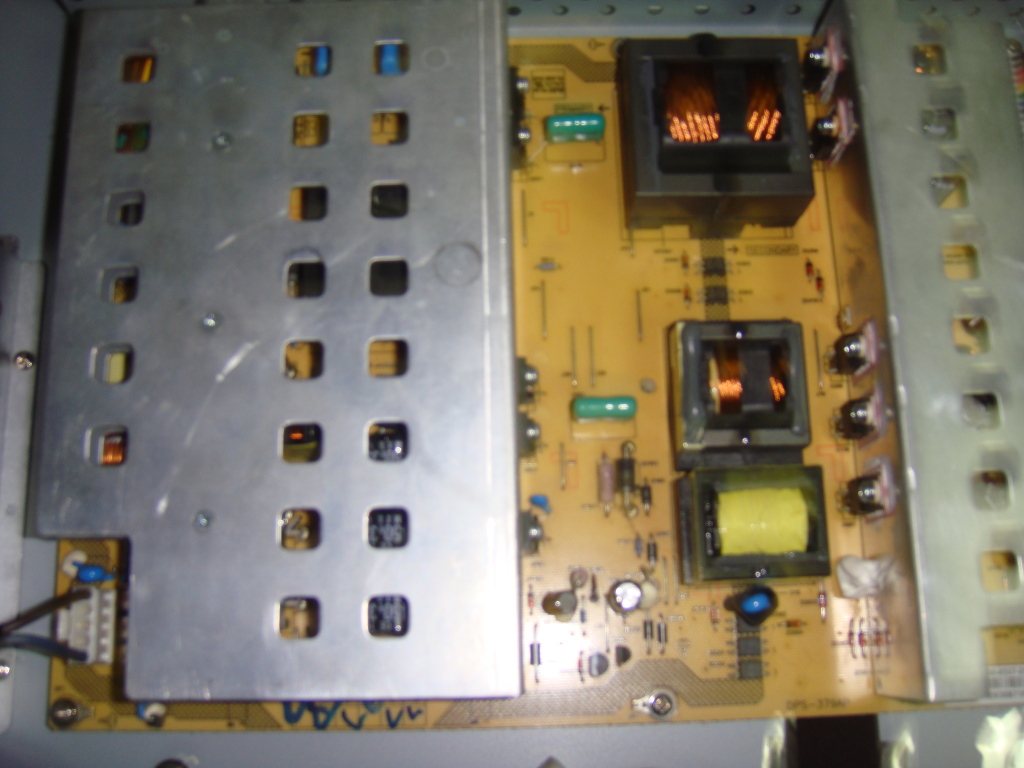

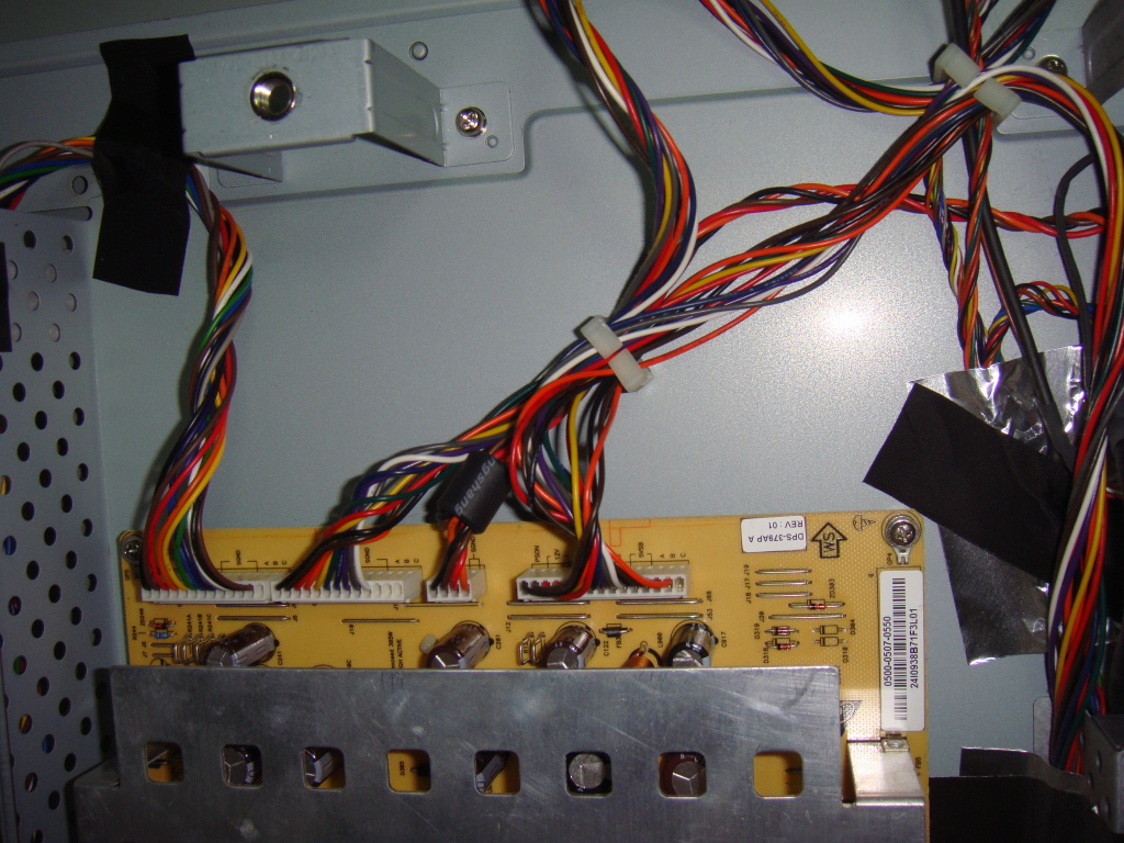

        Please ignore the iPhone photos. I don't know which is the main fuse. Any help is appreciated.
          Please reload the pictures using Go Advanced and then upload the pictures instead of posting the pictures in the message, takes a long time to load, most people will not look at this post.

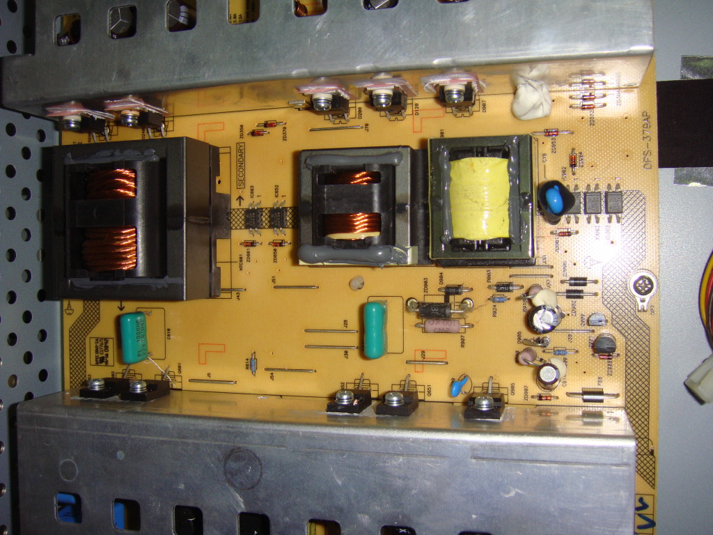

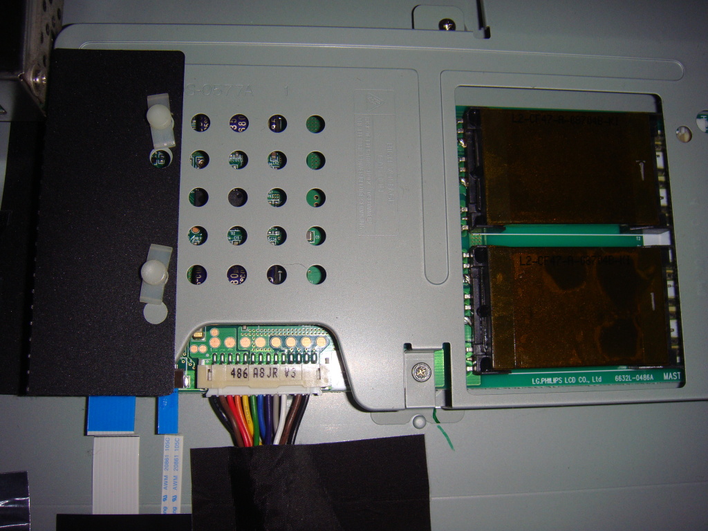

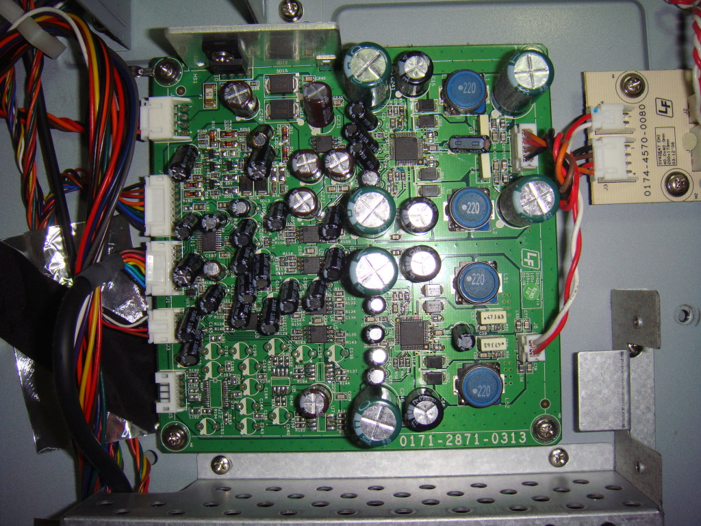

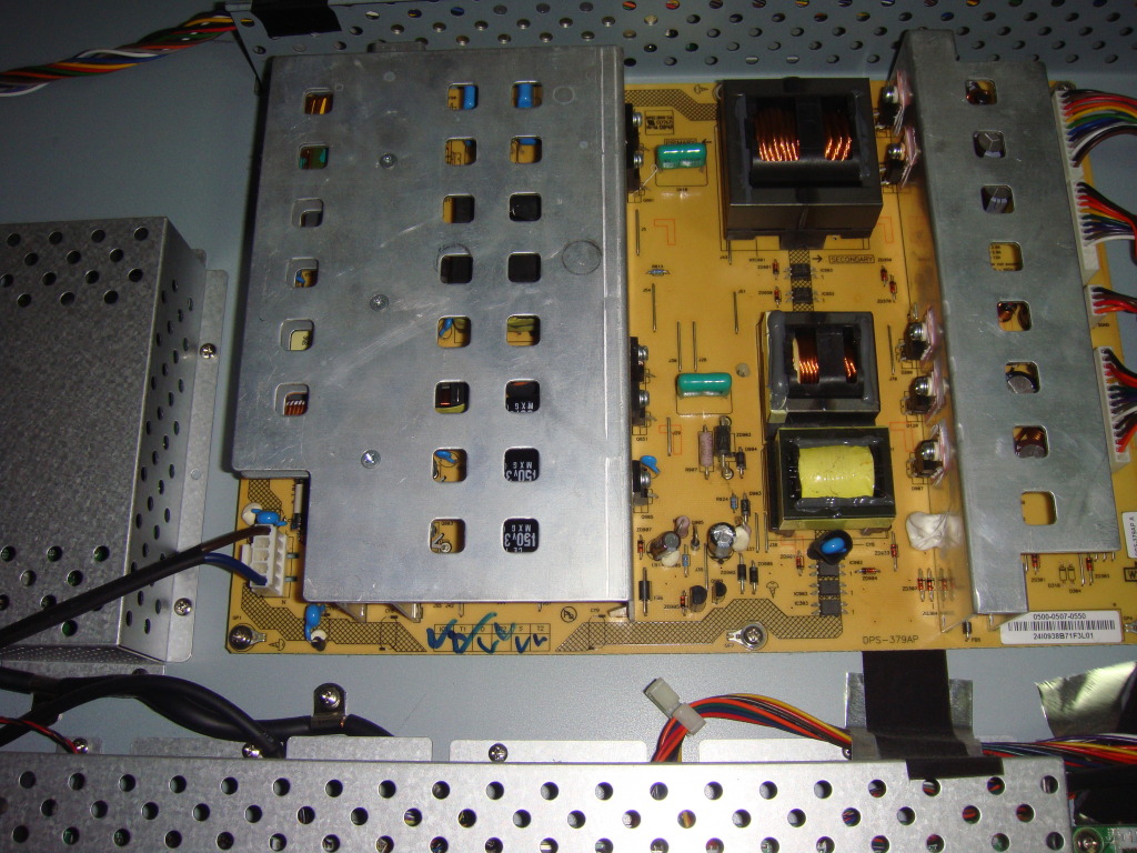

                Thanks cumlaopre for reloading the pictures properly, I will look and see and jog my menory on this model.
                i will download the pictures and redline what I need you to test.
                By the way, this model is known for having shorted out MOSFETs in the Inverter board.
                http://s807.photobucket.com/albums/y...%20SV470XVT1A/
                Also, you know how to use meter? Just to be sure.
