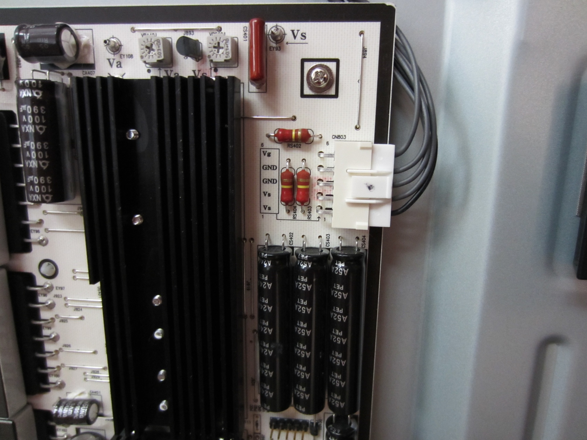

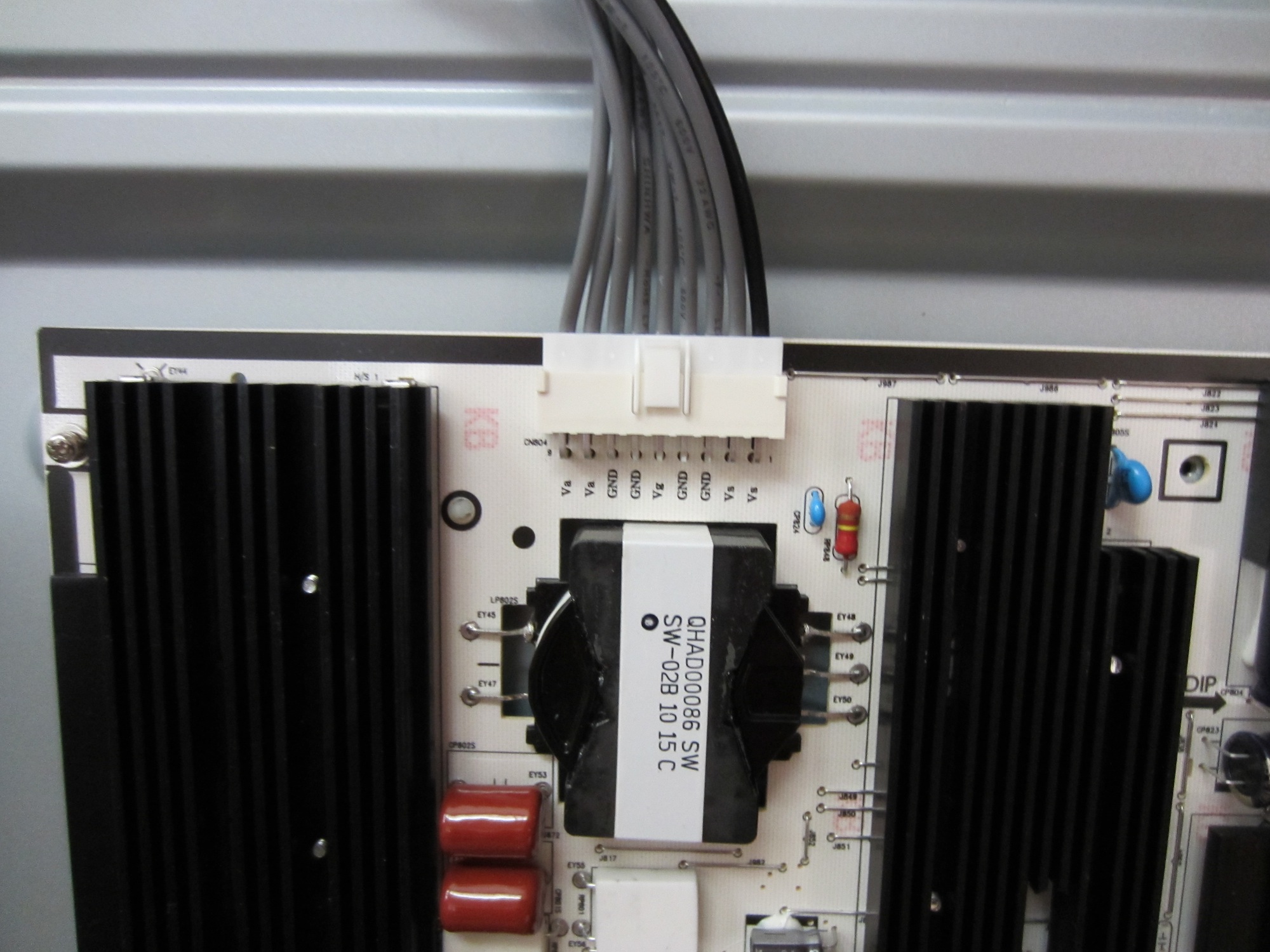

                  #88
                  Re: Samsung PN58C7000 wont power up
                  Originally posted by selldoor
                  Have you tested ANY fuses if so which.
                  Thread is getting too long have you posted good clear pictures of the fronts
                  and backs of all your boards.
                  Post pics of All the connectors on the power supply other than the one we have.
                  See pics

                    #89
                    Umm Im out of ideas too unless you want to post pictures of the boards and I will look for fuses. With it all connected ( Make sure every lead is connected) up you could go through again and test all the voltages at the connectors - if there is time when it is on and again when it is off. Now that you have chimes has the number of flashes changed.
                    There is a new vid on youtube http://www.youtube.com/watch?v=iUrqhBCjCIk
                    I have no idea what its about - might mean something to you. Perhaps you can join and leave a comment to ask. Cant tell whether its coming on or going off?.

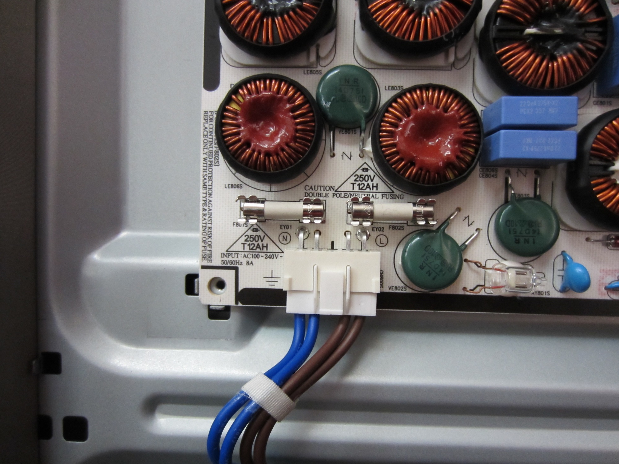

                      #90
                      Blast!!! There is another fuse I think not visible in any of your pictures - its too late for me to go back and look im off to bed. Its a green one in a picture of a connector in the other thread you posted in. F5000 https://www.badcaps.net/forum/attach...5&d=1337888734.

                            #93
                            My y board is a quite different, but there is a F5000. Looks ok.
                            Let's make sure I'm doing this right though - meter on ohms and it should read near zero, correct?

                                #95
                                Ok, i'm doing it right then. There is another little green fuse on the x main that checked out ok too.
                                • noahc72
                                  • May 2012
                                  • 63
                                  #96
                                  There are actually 2 green fuses on the y board and 2 on the x. One where the power comes in and one where the control cable connects. All of them check out ok.
