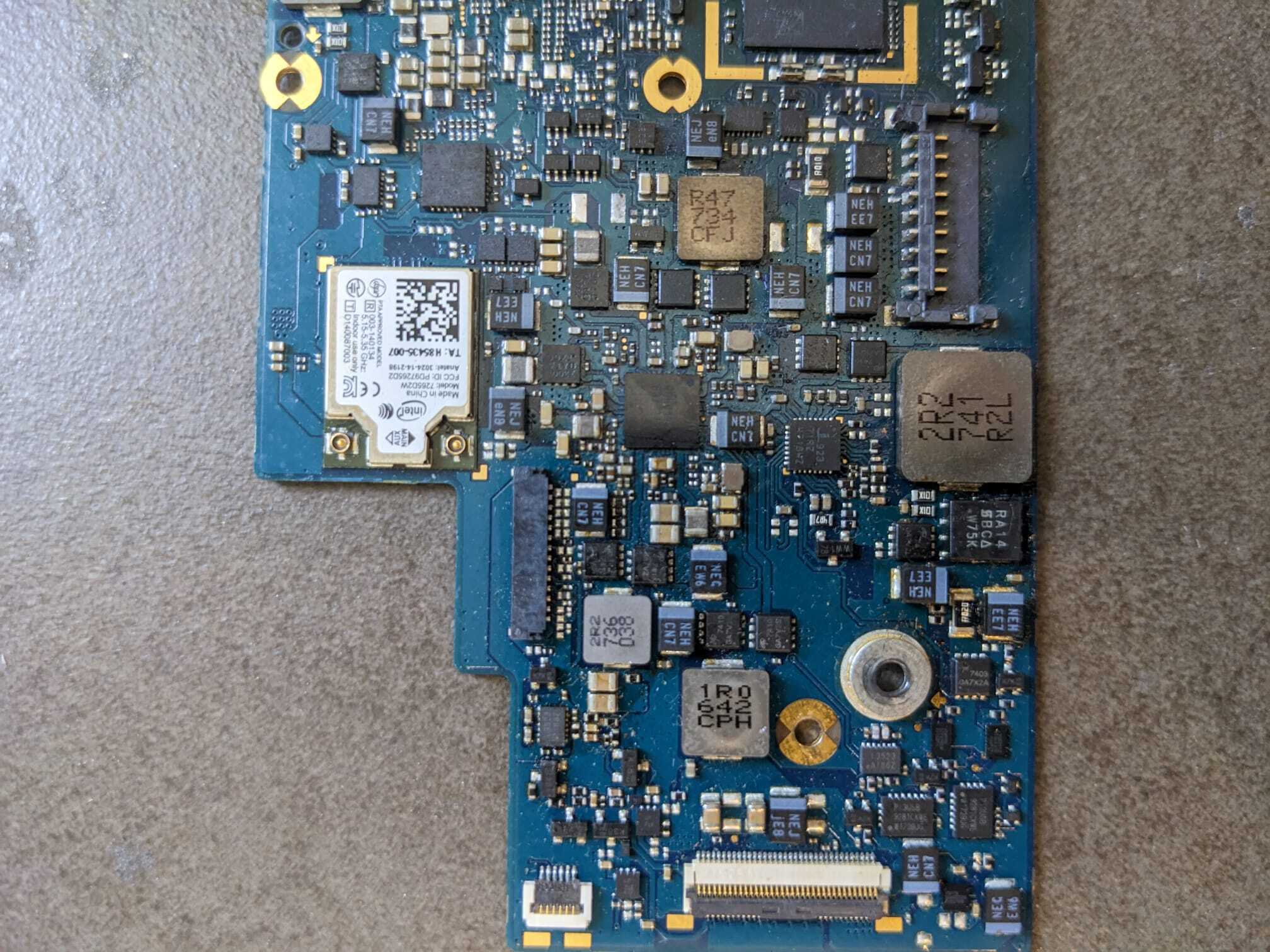

    I am trying to repair my Samsung Chromebook Pro. There is no boot. Upon turning on, the screen is blank and there is no backlight. Power LED is blue. I tried refresh with power and esc refresh with power with no avail.
    When I measure the 1.2V rail, it is pulsing. It will jump from 0 to 1.2V then 0 again. I replaced the 2 MOSFET and even power management IC and it is the same. Resistance from midpoint between mosfet to ground is 0.5 kOhm but it will show 250 Ohm first before jumping to 0.5 kOhm. So it feels like it was charging up some capacitor. Since MOSFET and IC was replaced, I was thinking it may be current limit? It is using the ROHM992 IC, but I cannot find datasheet anywhere so I really have no idea how to check the current limit.
    5V and 3.3V rail is present and stable.
    CPU also measure 1V.
    I tried using thermal camera to see if there is any hot spot and there is none. Even the CPU is cold.
    Any help is appreciated.

    From my experience what you have described can't be true. When the 1.2V is pulsing, then it should be the same with other supplies coming up later in the sequence, like 3VS, 5VS, VTT, VCCST, VCCSTG, VCCIO and so on, up to VCC Core.
    So I strongly recommend to observe all supplies from 1.2VS again to have a better understanding of the situation an share your findings her again in a structured way.

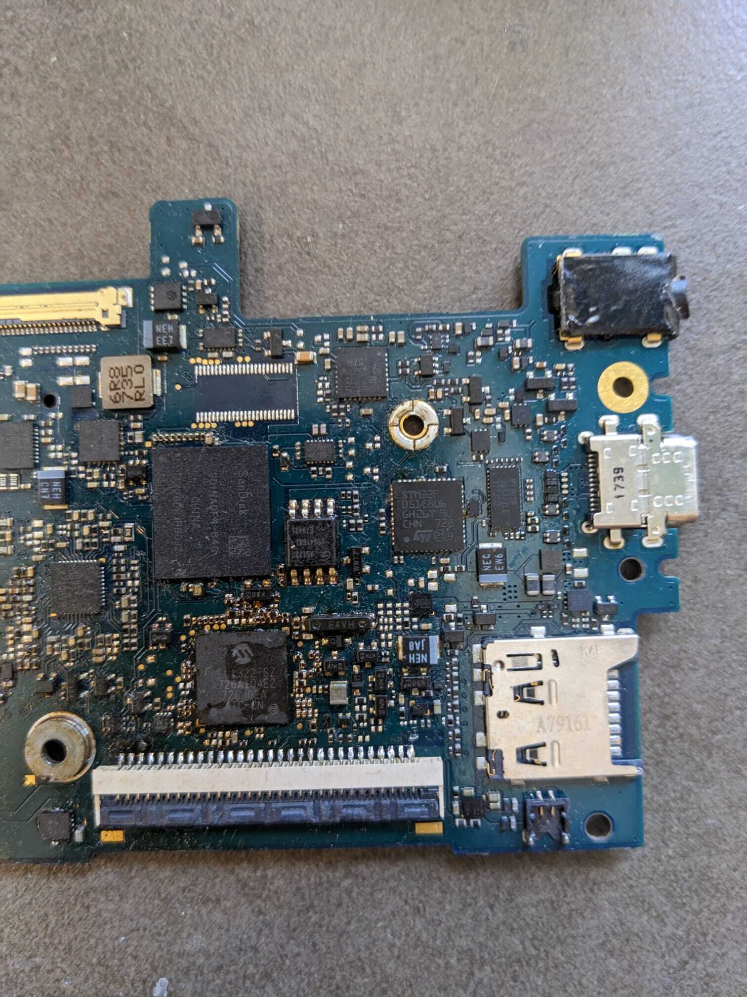

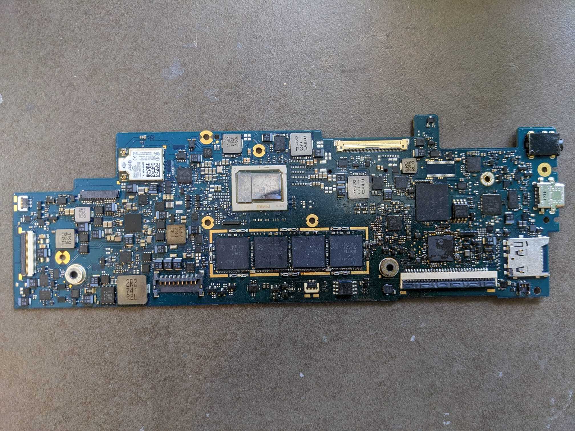

          I heated up the EMMC and moved it a bit then the 1.2V comes back stable. I have no idea what that has to do with the 1.2V, but it seems that voltages are back. Unfortunately, performance wise, it is the same. No display with the blue power led.
          I've measured the voltage on the board and marked it accordingly. I've measured the voltage when pc is on. And then turned it off and measure the resistance to ground for each choke. I also measured in diode mode with +ve to ground to choke.

          This is not a modern machine by the way. It was from 2017. I just now replaced the RAM and it is the same. 1.2V is back after I reheat and moved the EMMC for some reason. The EMMC is good though. I am not sure about the CPU. It is possible that it is bad but is there a way to check? The CPU does heat up when I turn on the machine. I do not have an oscilloscope, but I do have a ET828 that can be used to some extended. I think it can measure from 5Hz to 5MHz. I am not sure it is enough.
          Is BIOS chip the SPI flash that store UEFI?
          It does has a 25Q127C SPI flash under the RAM.
          datasheet is here.
          https://www.mouser.com/datasheet/2/8...XPSsVXZ8v2kR_m
          So I should measure SO pin 2?
          Update: I measured with my ET828 but pin 2 seems to stay at 3V. My min time range is 2.5uS so may be that is not enough?
          I am not sure which component is the CPU crystal. I think it is this one?
          Click image for larger version  Name:	WhatsApp Image 2025-06-12 at 3.08.05 PM.jpg Views:	0 Size:	190.4 KB ID:	3658066
          It is SMD. I am not sure how to measure it.

            Pretty modern for a samsung tho, this is the cpu oscillator (check pic), you should have a value (on diode mode) on this resistor on both sides and a wave (using oscilloscope), sometimes you lose connection under the cpu and the laptop turns on, but with a dead cpu it does nothing, it can be the oscillator, but the only way to know is using an oscilloscope.
            And on the bios pin 1 or 2 you can check the cpu activity, again using an oscilloscope, this is mostly experience but first data you see there is stuff like EC and pch, after that ram and cpu. In other words a lot of waves, that's a healty laptop.
            Now if you got issues on the emmc that can be the issue too. I replaced one of those on a small acer tablet (32gb-->128gb) just took one and solder the other and is still working fine (couldn't install windows).

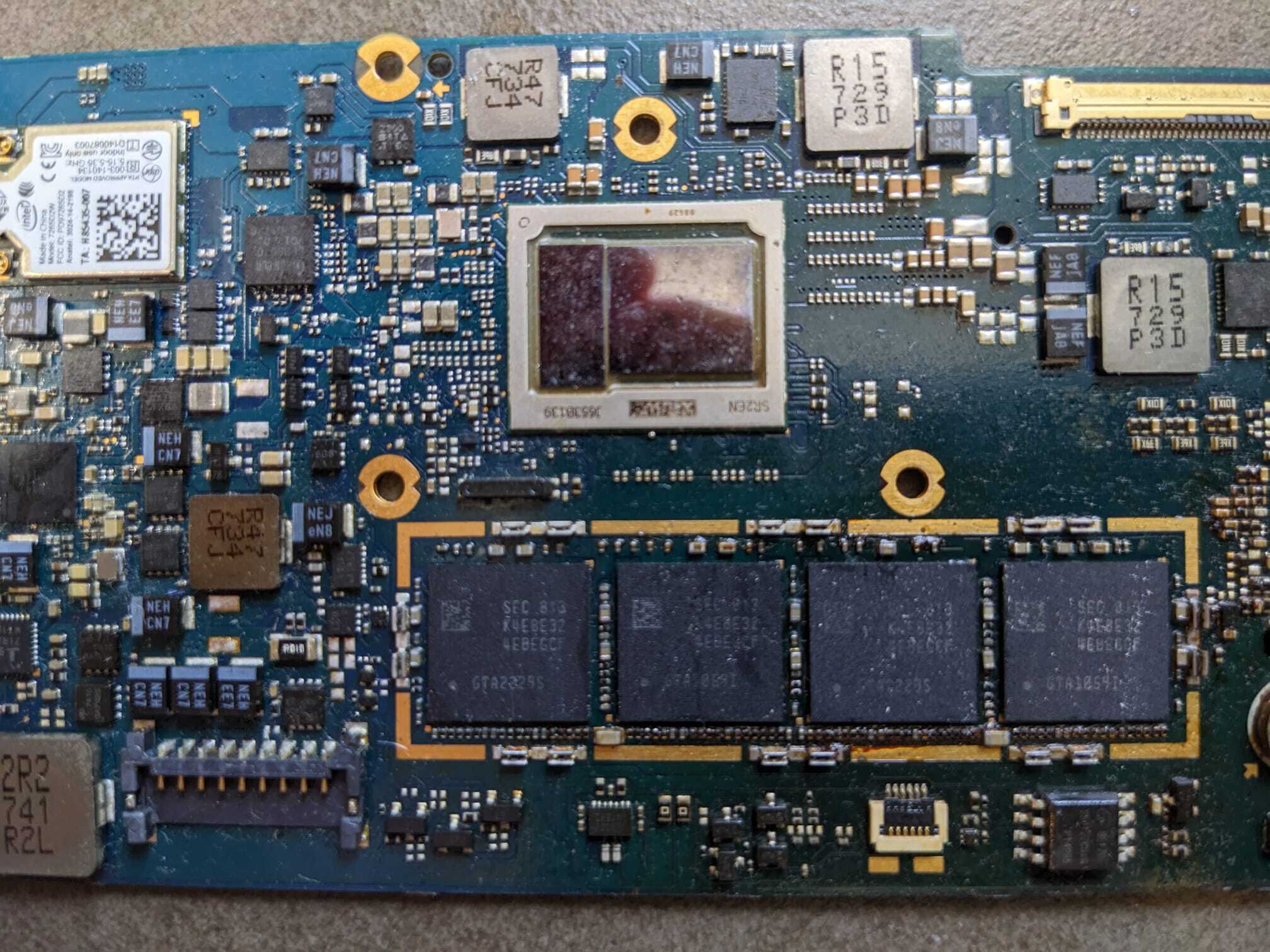

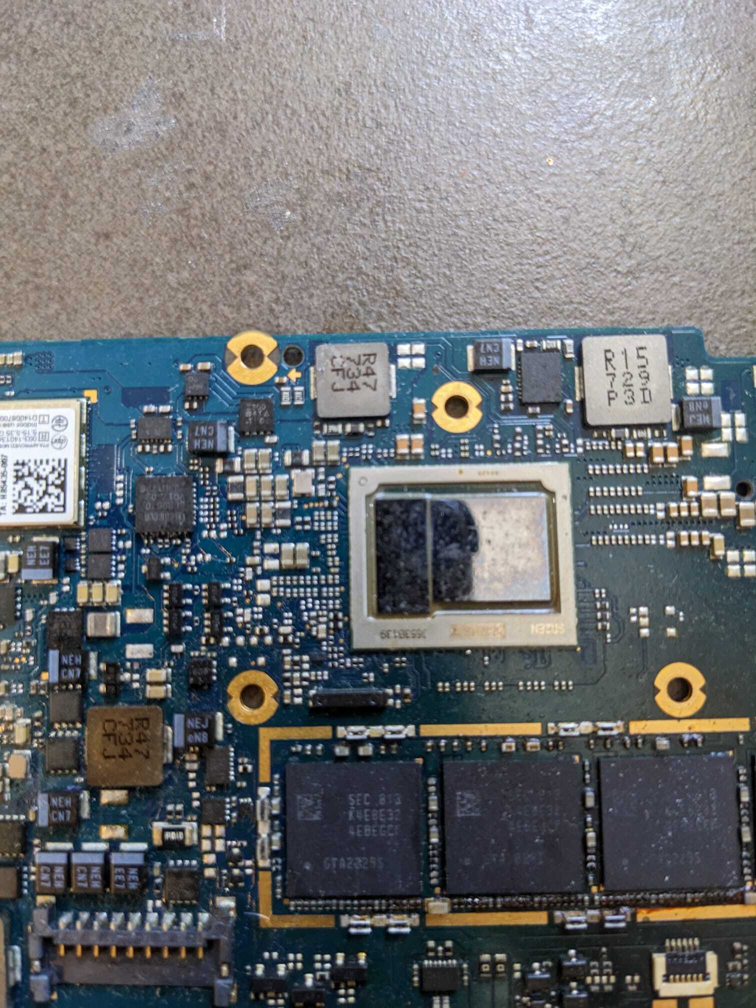

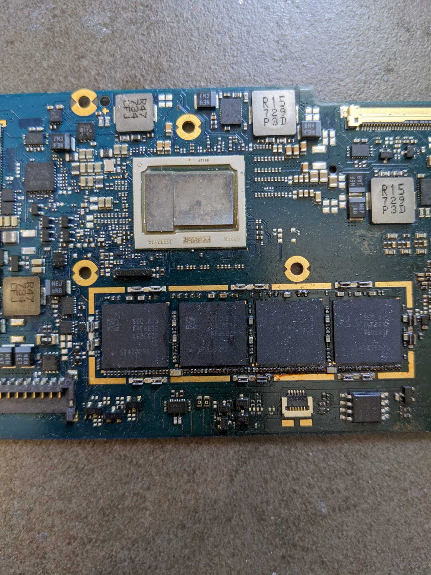

                A question the cpu looks funny, is that dirt or it looks like that, have you checked the die closely?

                  The thing on top of CPU is just some remain of the thermal pad. It looks normal.
