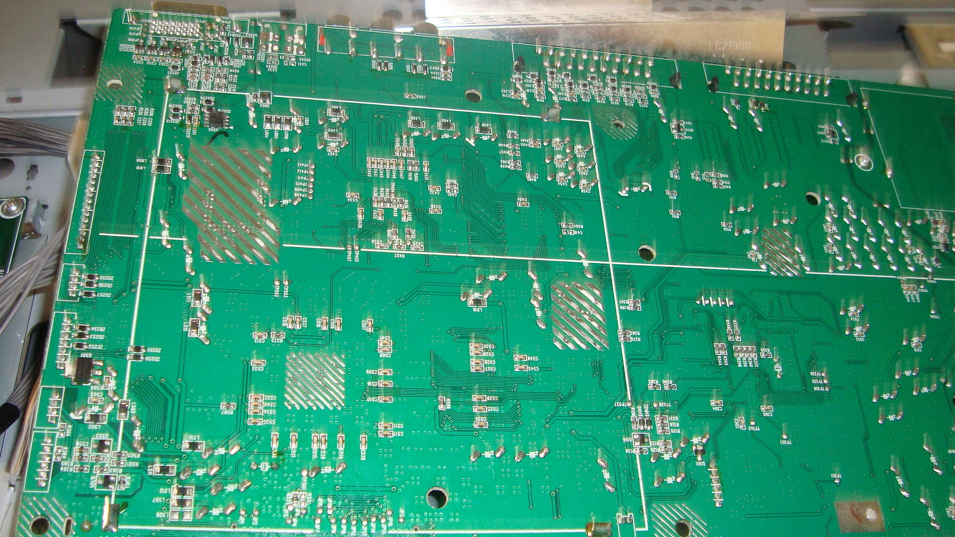

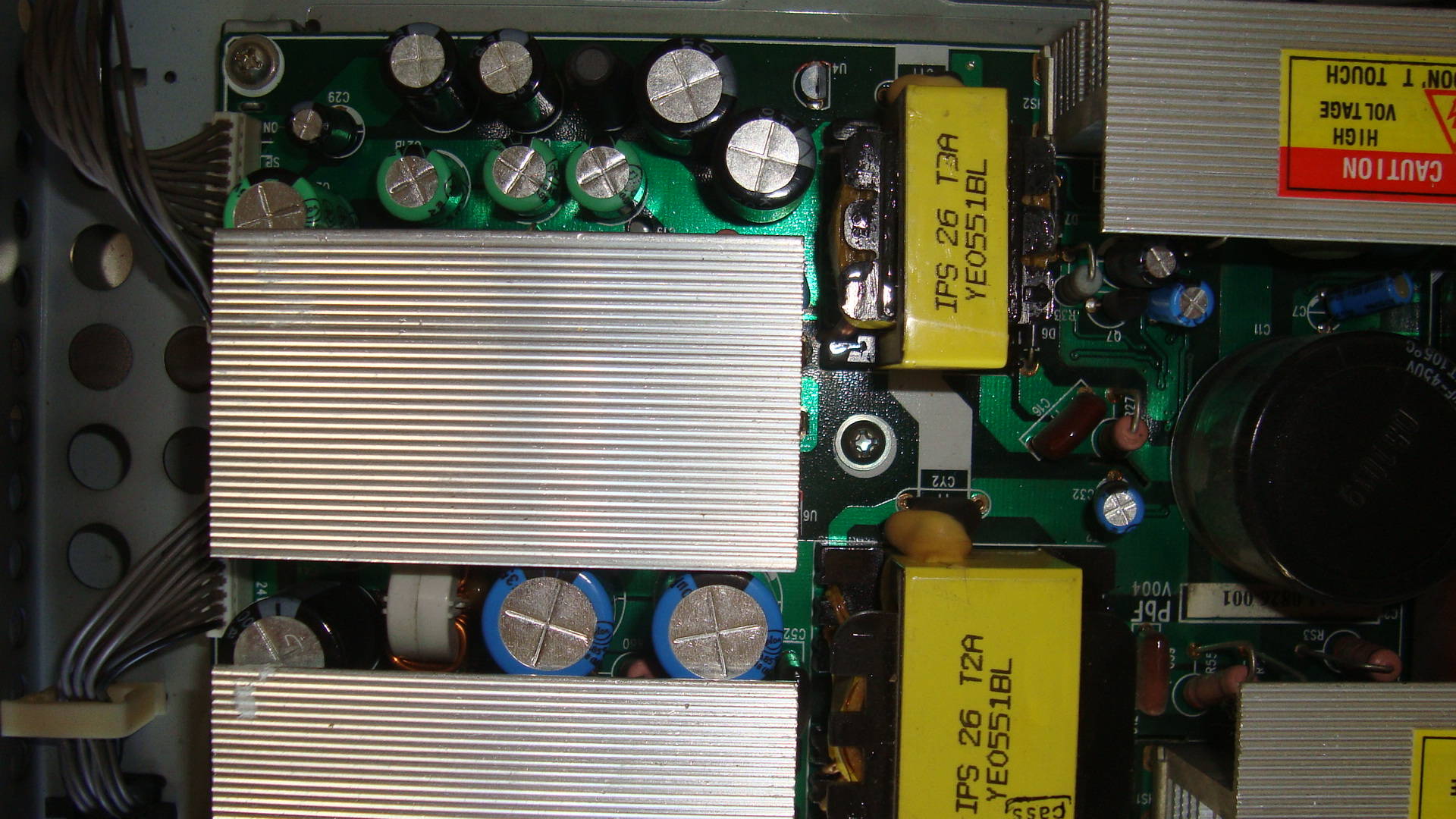

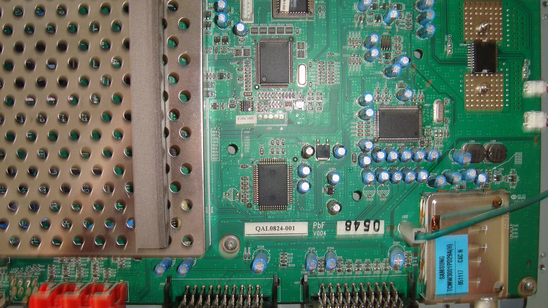

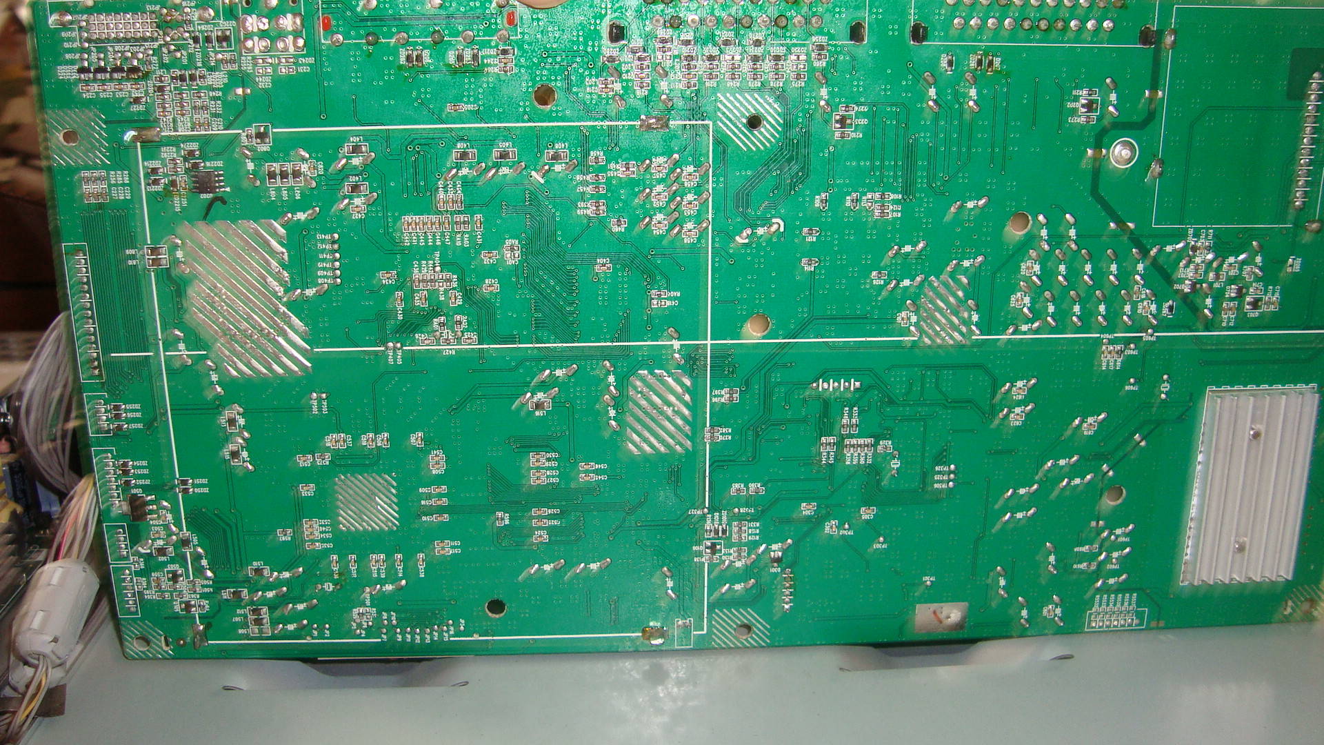

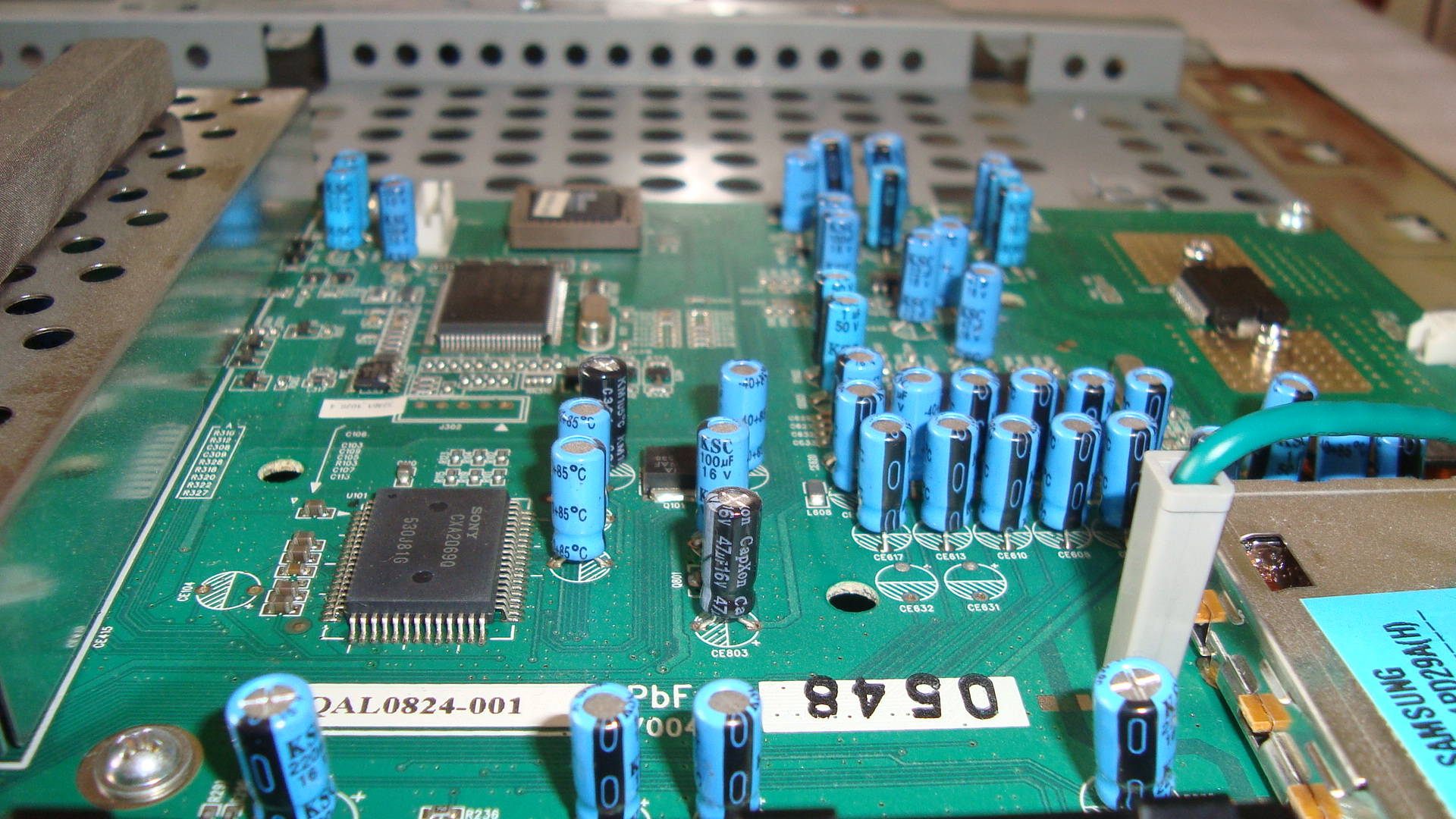

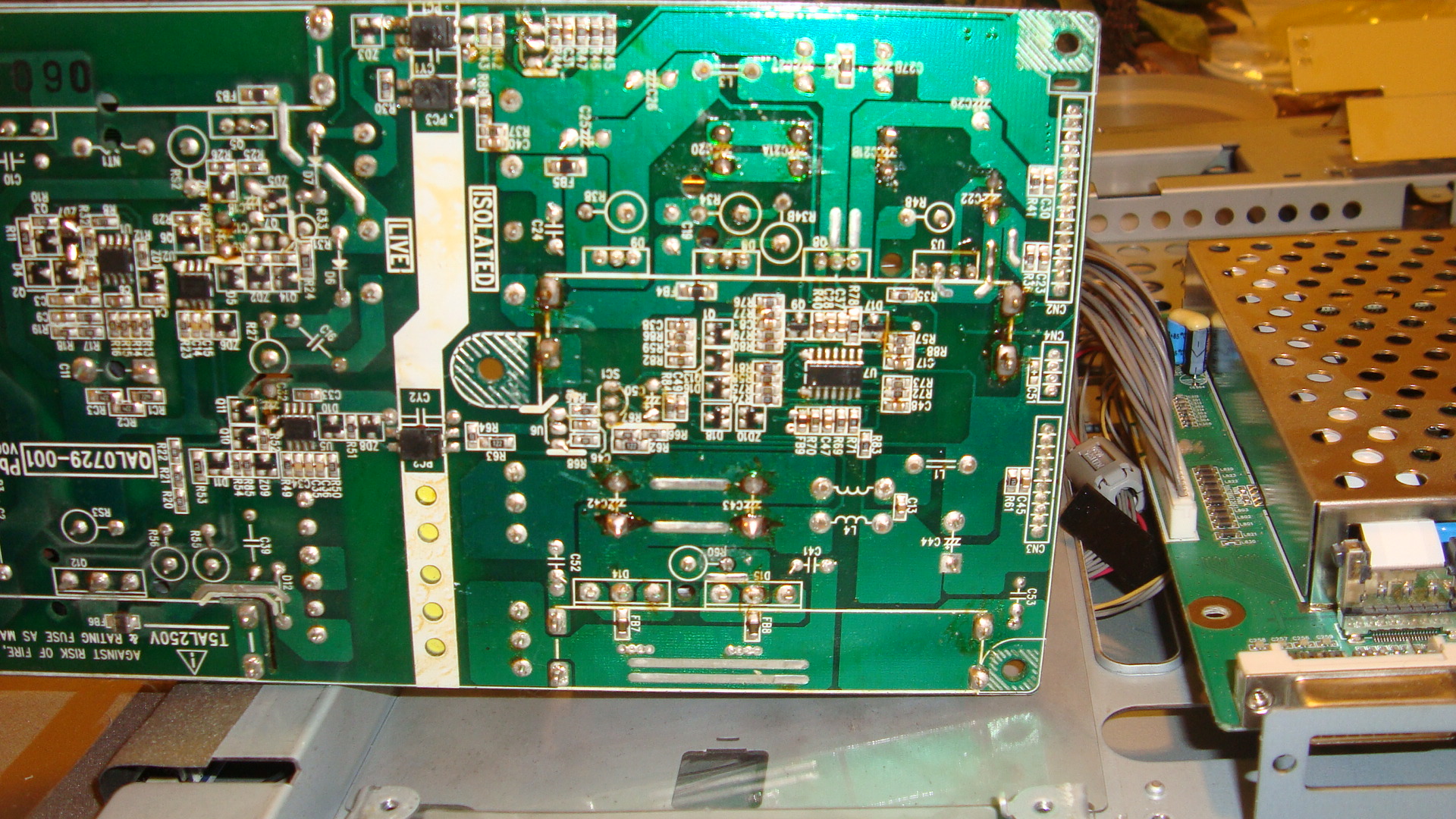

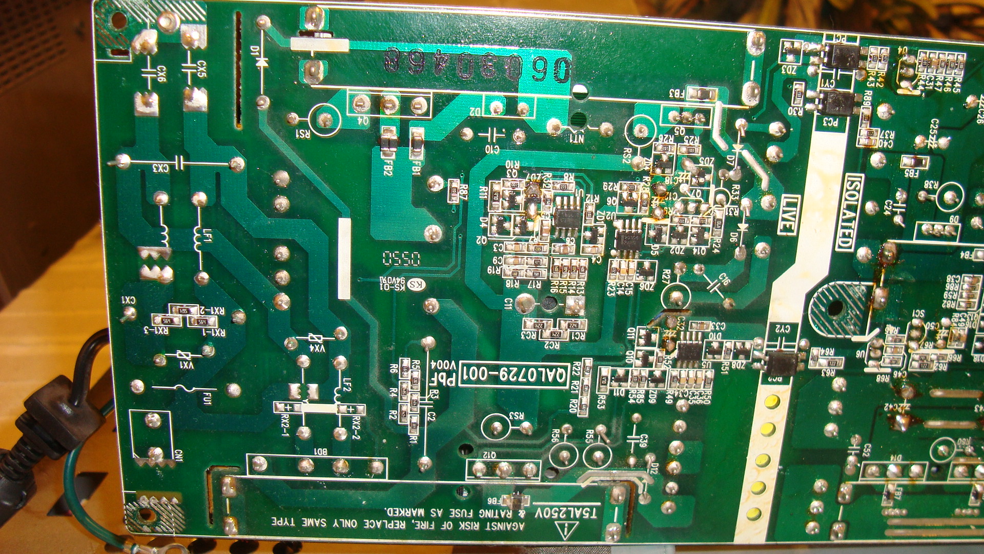

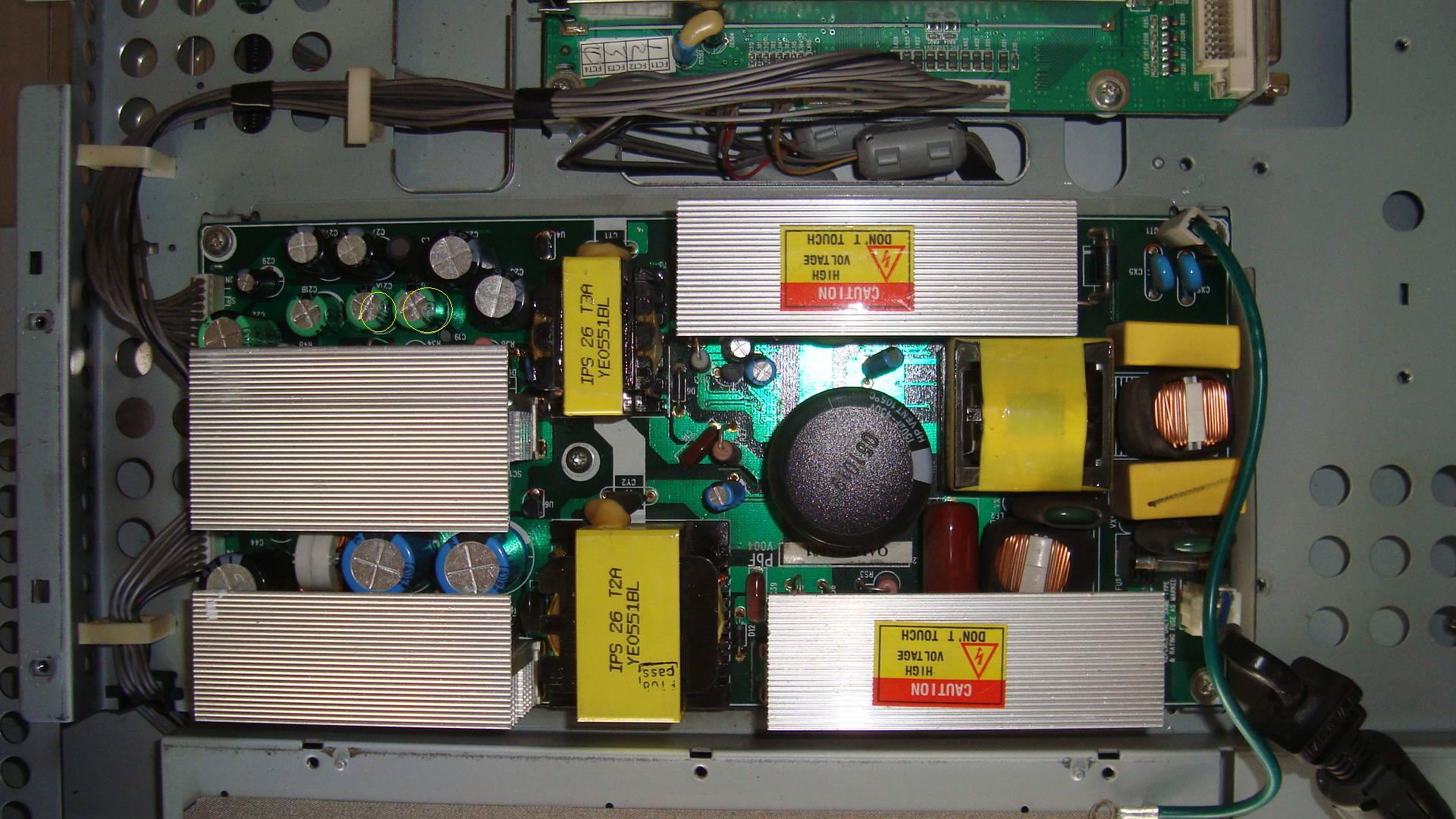

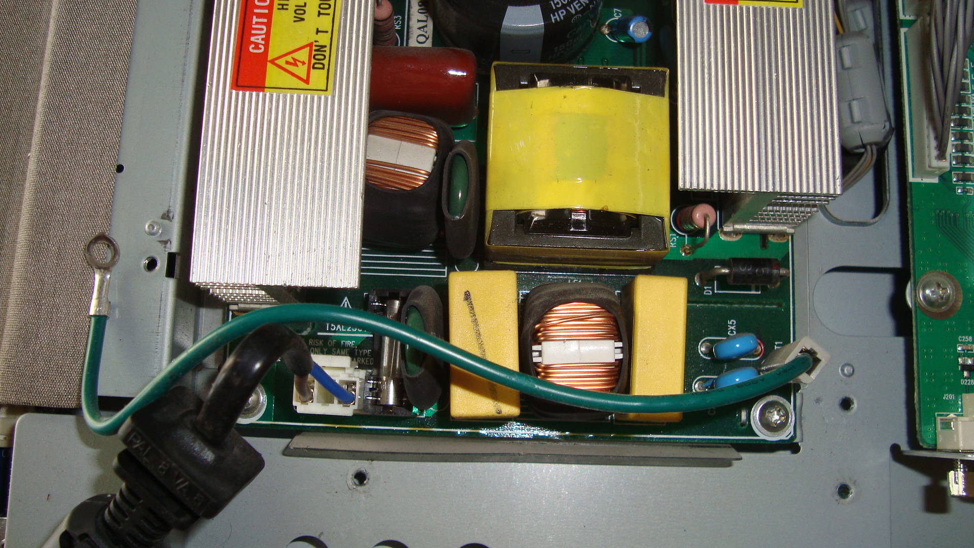

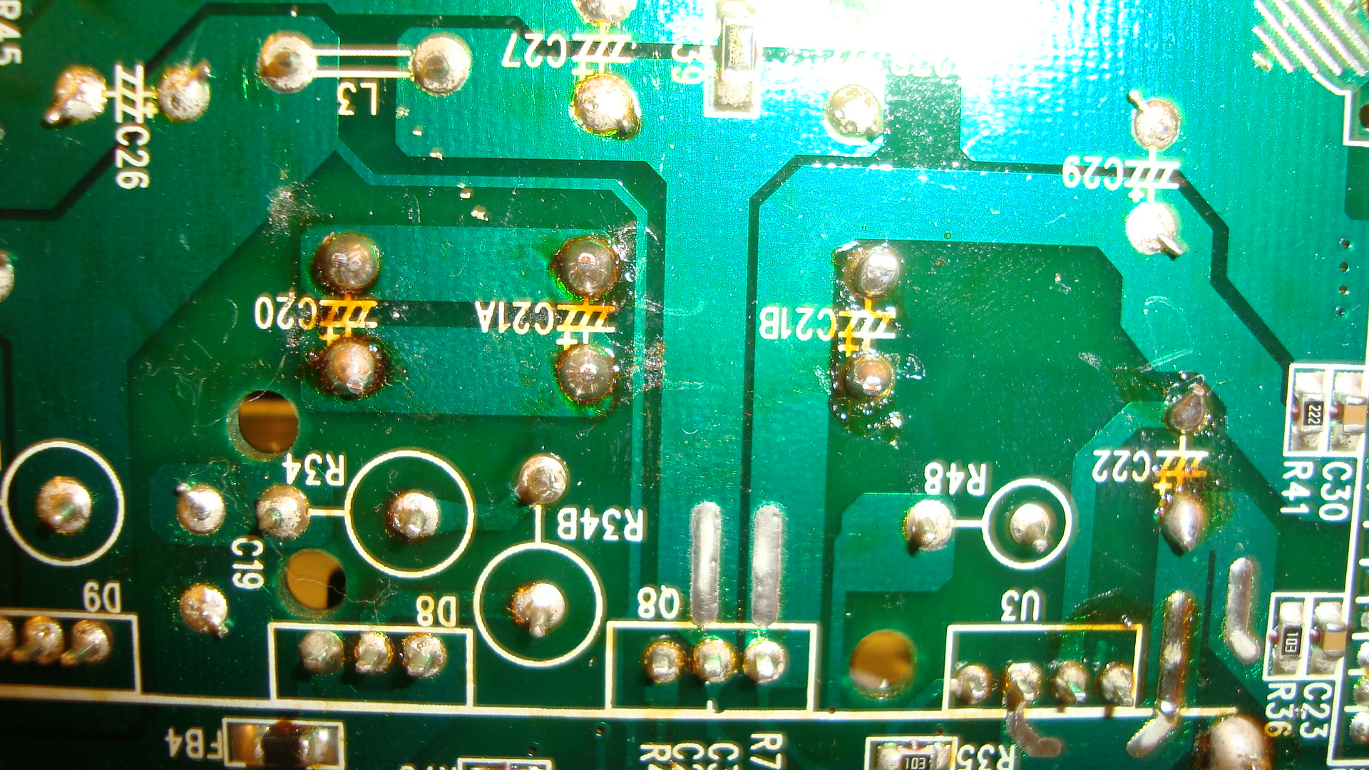

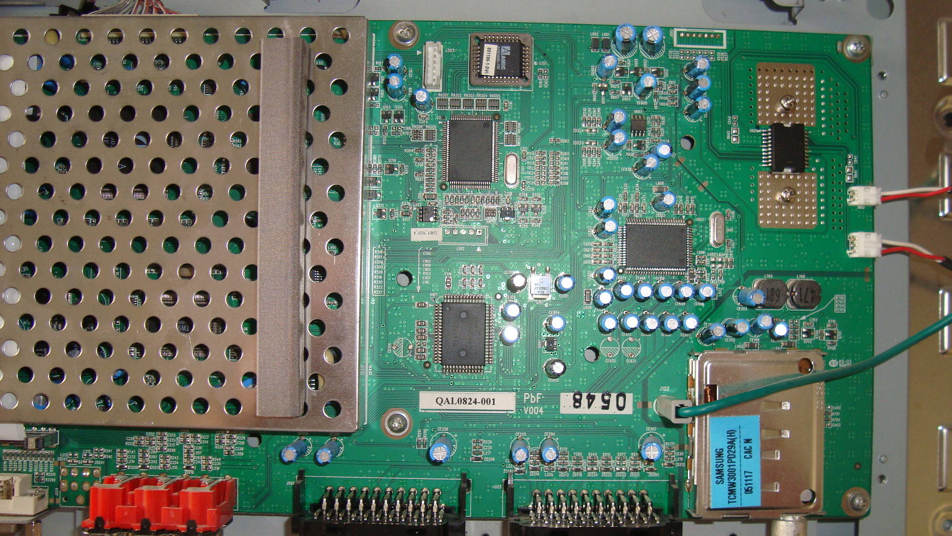

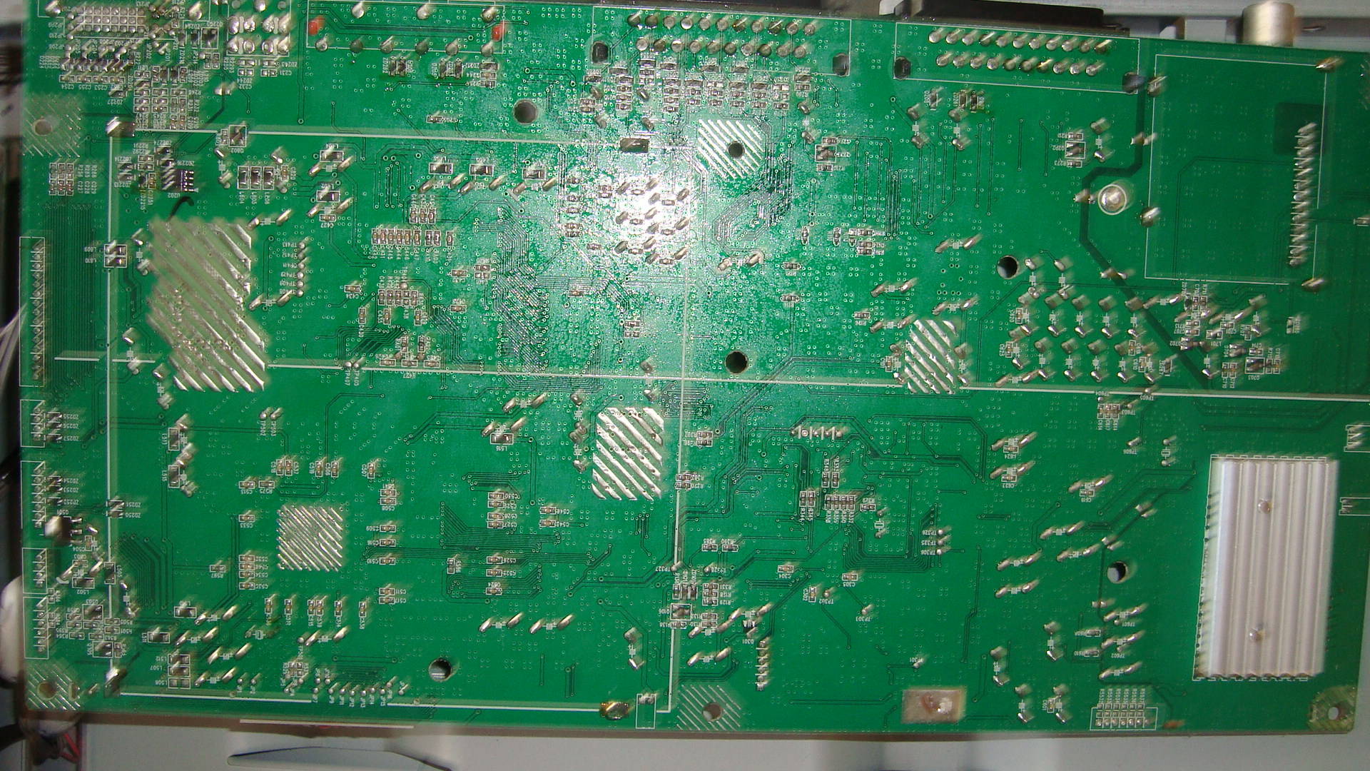

                    Yes finally opened the back cover.Here are the first pics
                    http://img804.*************/img804/7915/dsc01090v.jpg
                    http://img27.*************/img27/9461/dsc01089lu.jpg
                    http://img710.*************/img710/2453/dsc01088av.jpg
                    http://img9.*************/img9/8789/dsc01087bg.jpg
                    http://img600.*************/img600/8935/dsc01086j.jpg
                    http://img256.*************/img256/1770/dsc01085a.jpg
                    http://img41.*************/img41/8442/dsc01084z.jpg
                    http://img16.*************/img16/4061/dsc01083wz.jpg
                    http://img822.*************/img822/2306/dsc01091ba.jpg
                    From a first look no swollen or damaged capacitors identified either to psw or main board.Of cource i have to desolder the metal frame of the main board to check the caps underneath ..
                    Perhaps it is no easy way here, i guess as a next step, i'll go get myself a polymeter.
                    If your experienced eye sees smthng more in these pics i would be obliged

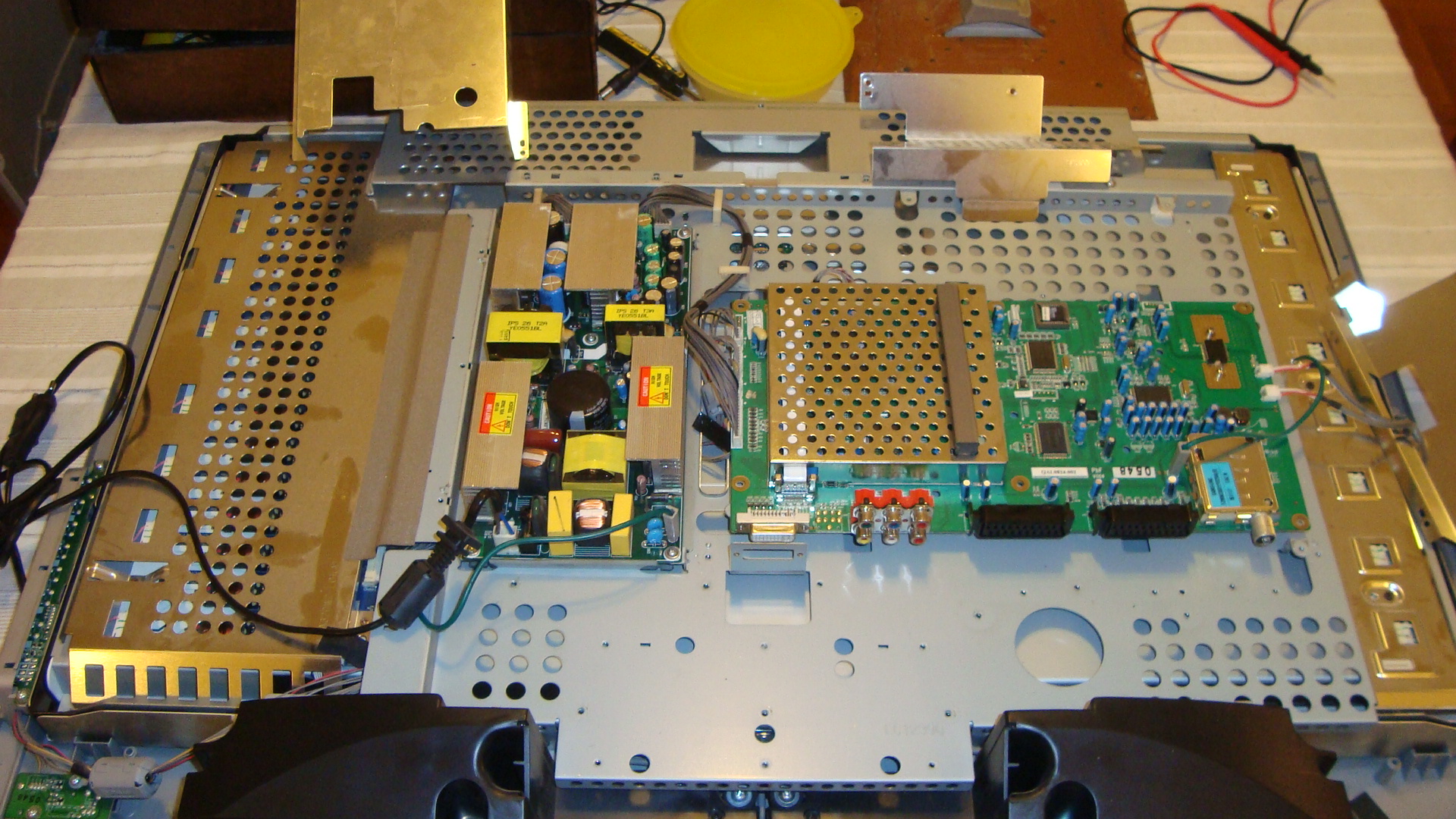

                      Re: Jvc lt32a61sj/bj audio but no picture
                      The main board is likely okay.
                      Can you take a picture of the whole chassis (all boards visible from back.)
                      Also, please use the Manage Attachments feature of this forum, as it is better for future users who might need to see those pictures.
                        Hi can you have another look at the two green caps circled in yellow top left of pic
                        they look a bit odd? (leaky)
                        I have also taken the liberty of uploading your pics.
                        Are these Lelon caps?
                        EDIT - Sorry Caps look ok in pic 1084z

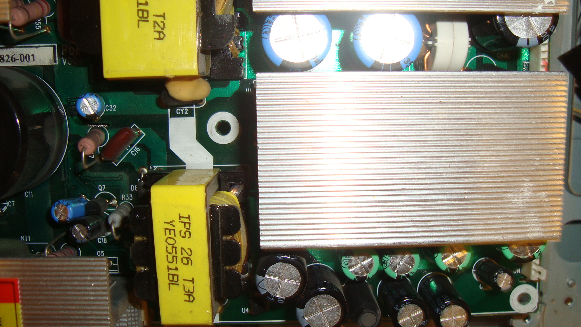

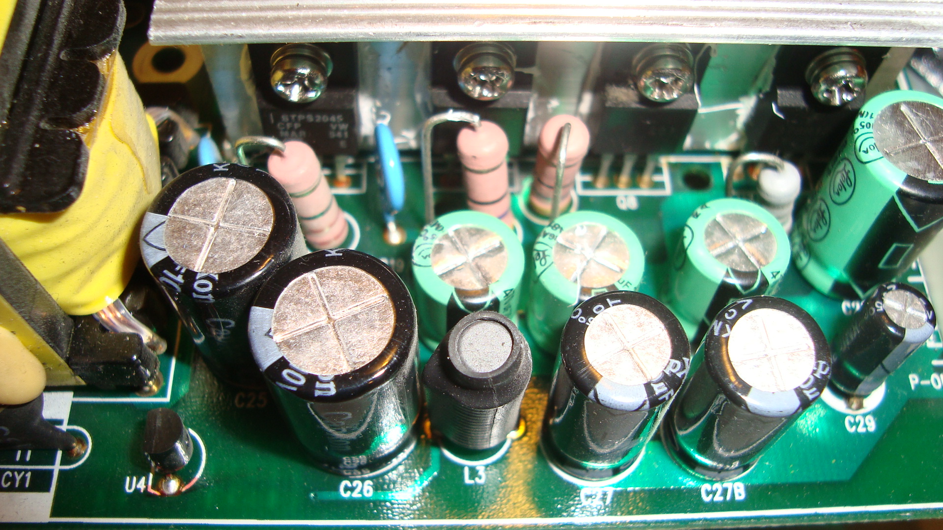

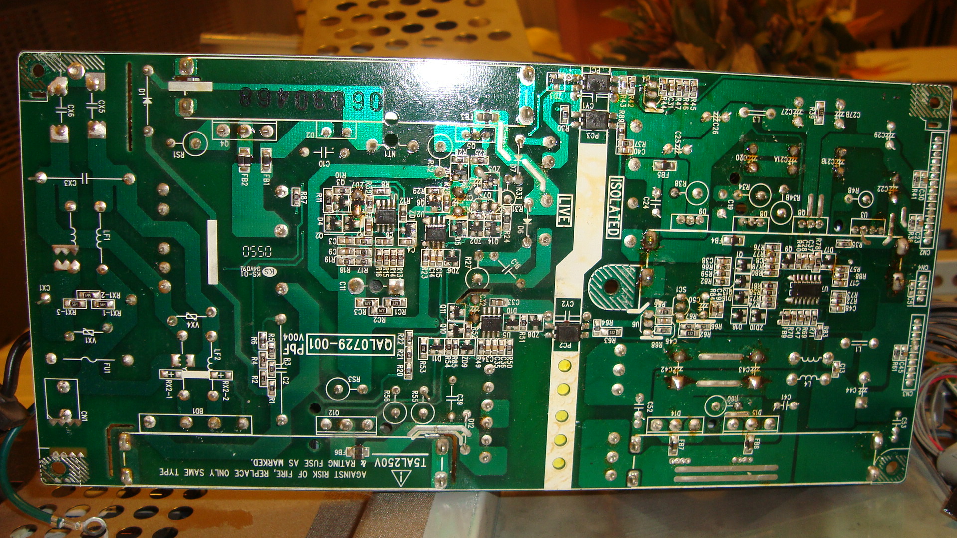

                            I disassembled the psw and saw that on top of the green Lelon caps there some traces of white smthng, dont know if it was dust though. I used the polymeter and tested resistance while placed the 200kΩ limit. The three green Lelon caps show value towards infinity, only the forth bigger green one shows a steady value of 3.4. also in the last pics and especially dsc1099 you can see the solder side end of the caps.Do you think ,that the board is ok?
                            I dont know if i used the polymeter correctly.If you see something else pls advise
                            here are the latest pics
                              what type of meter are you using to test the capacitors its best to use a esr meter imo.
