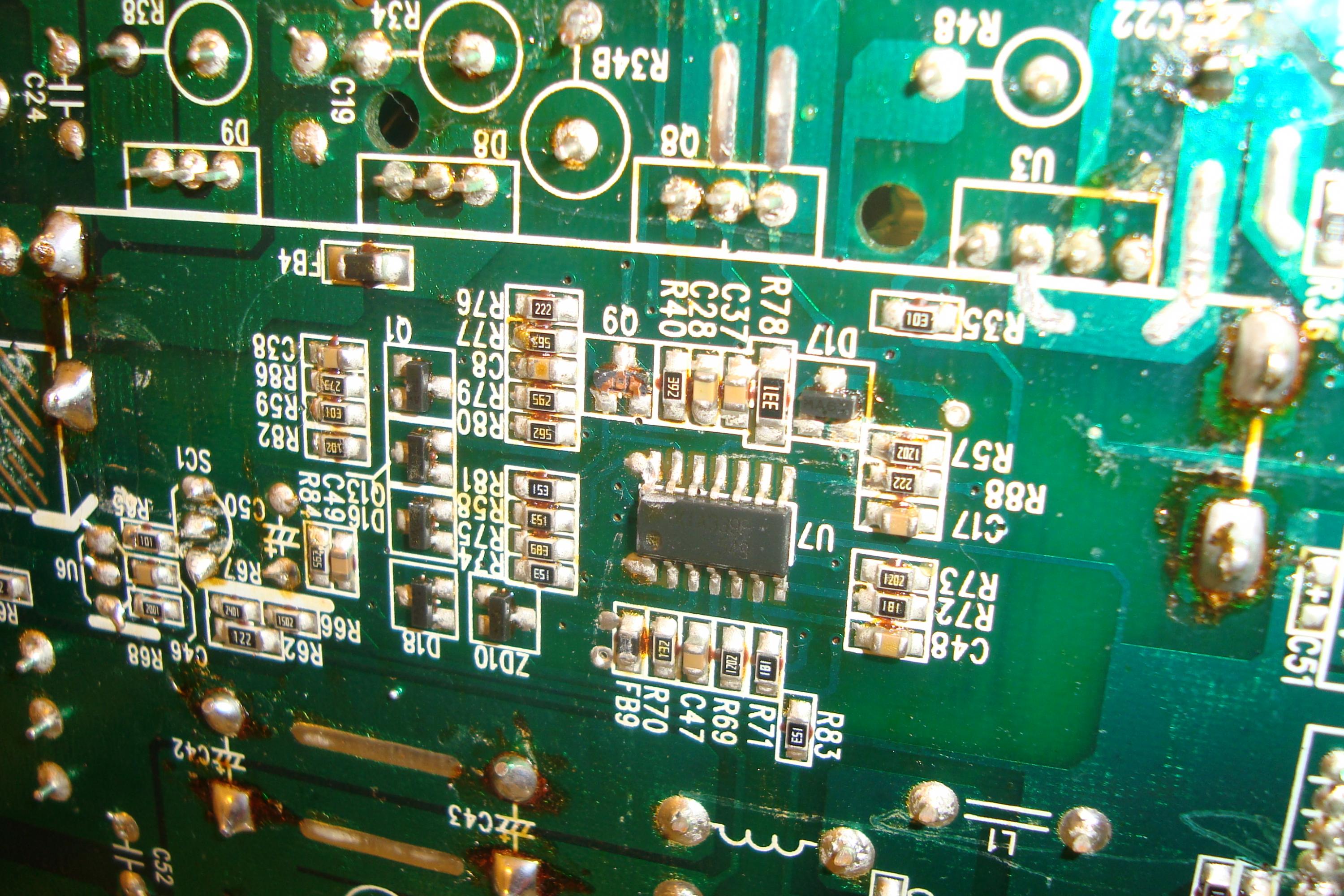

      The picture is taken frm the net, not me measuring ,just to show the eqpmnt as i was out at the office and not at home.
      the set has only a dvi port no hdmi existing
      i tested the PSW board with the multimeter dial set at 200V DC

          After a "while" i decided to pick it up from the last step i did.I have changed 4 capacitors on the psw. It didn;t help. I checked the voltage output from the psw it reeds ok (as indicated on the psw).
          (1)I haven't tested the resistors yet and the diodes on the psw, i will do it today. (2)I also saw in an other link that little triangle fuses may be the problem on the main board?..
          So do you think that last two actions will help?

            i removed the pwb and i noticed that smthng is damaged in Q9 >Q9 T0507-00009A TRANSISTOR could that be the troublemaker to the set? to be frank i dont know what a transistor actually does.
            also i noticed one capacitor a bit loose and i am thinking to resolder it

              Q9defently needs replacing imo. C8 also looks like its got hot? or just the pic

                Thanks for the help! C8 seems hot , you have an eye like a hawk , i had to zoom twice to see it. I called the local service store and gave them the Q9 T0507-00009A TRANSISTOR detail, but they reverted that this is the manufacturer's id of the spare part and not its "commercial" name/type i.e. npn etc .Does anyone know what is the commercial name/type , as JVC service in Greece stopped its operation a couple of years ago, so i am not hoping for an original part. I assume they will say the same for the C8.

                  Re: Jvc lt32a61sj/bj audio but no picture
                  Keep posting to myself. I am determined to resolve this.
                  Found with a lot of internet search that T0507-00009A TRANSISTOR has most probably the commercial name as the attached file. I made an order on this , it will come within the next 15 days..hope it works.
                  But with C8 the manufacturer says it is a capacitor C8 T2203-FC104E C CAPACITOR 0.1uF 50V K?!!! Could that be, with that shape? or is it also a transistor? Btw there is no such capacitor ( i mean the shape) in the electronics shop.
