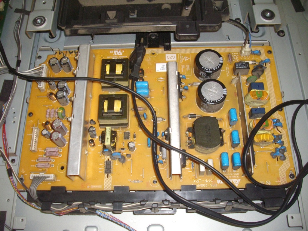

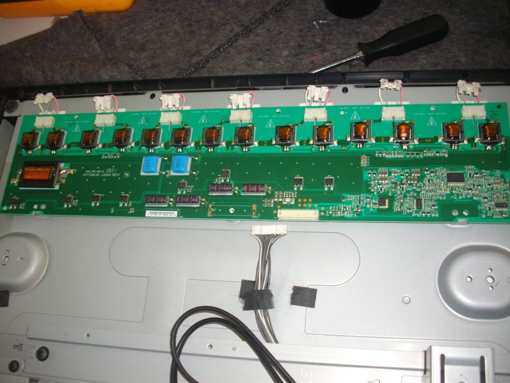

when it starts, it stays on moin one minute and turns off. he does it restart only
sony bravia lcd klv-37s400a restart

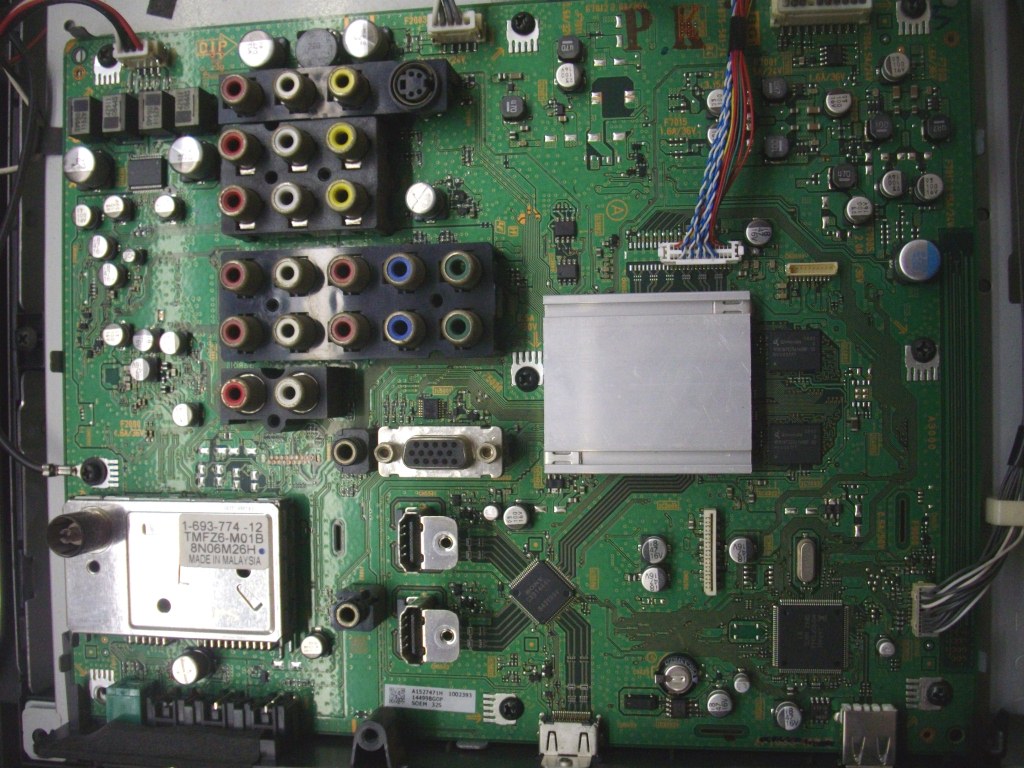

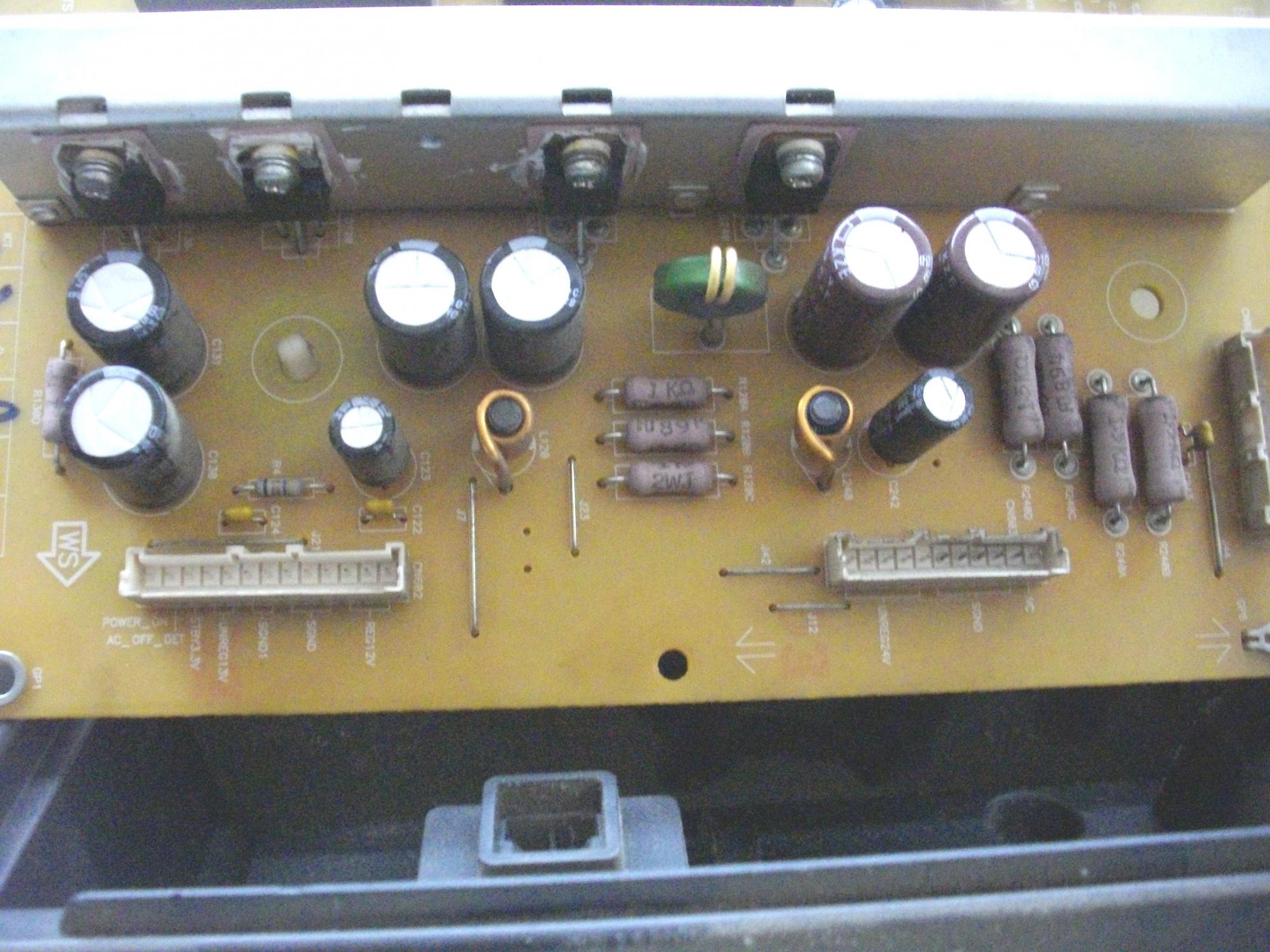

Do you have a camera... can you take pictures of the inside of your TV?

Hi- Pictures need to be a bit sharper
Examples of what is needed
https://www.badcaps.net/forum/attach...1&d=1290283049
https://www.badcaps.net/forum/attach...7&d=1280167246
It will be useful if you can say a bit about yourself - skills tools etc
Do you have a multimeter and can you use it?.

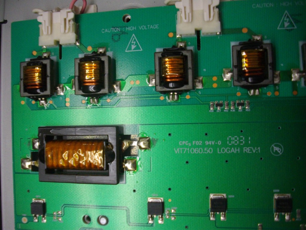

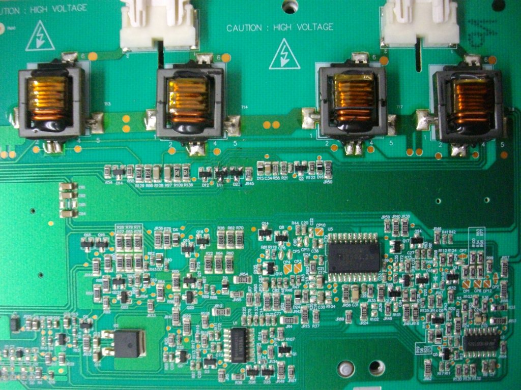

Can you do a picture of the inverter board - one down left side in pic 1
Do it in 2 halves - overlap
When you switch on does the screen light up then go off.
What do the LEDs do - stay on/ flash/ change colour
"he does it restart only" what do you mean? Does it try to restart after it goes off.

in fact I am a technician and I'm used to depanner.Mais it is now that I work on LCD, PLASMA. Also I have a multimeter that I know and use lots of other equipment. I want to distinguish from other technician here because they do nothing but tinker. Otherwise when you turn on the screen, it stays on for a miniute to moin and he died. and after two minutes, it turns back on then back off. no flashing LED to assert an error code. thank youComment
Do it in 2 halves - overlapPlease upload pictures using attachment function when ask for help on the repair

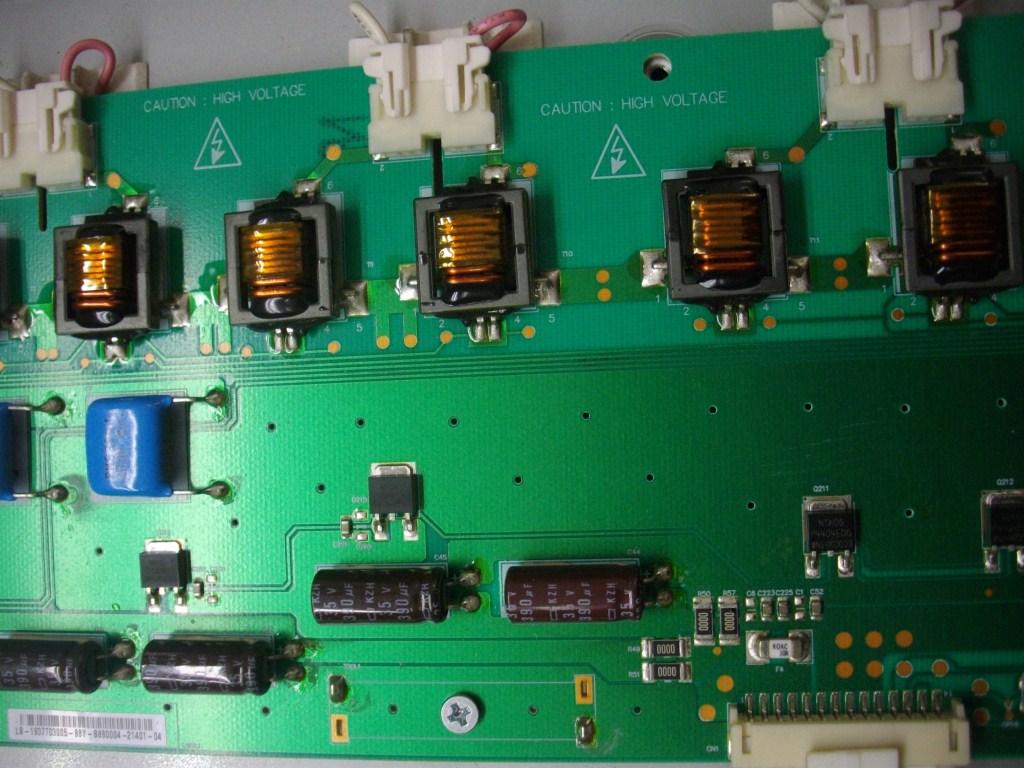

@Mady - I think I was on holiday and missed following this up. On the inverter board
there is at least one fuse that I can see - did you test it?Please upload pictures using attachment function when ask for help on the repair

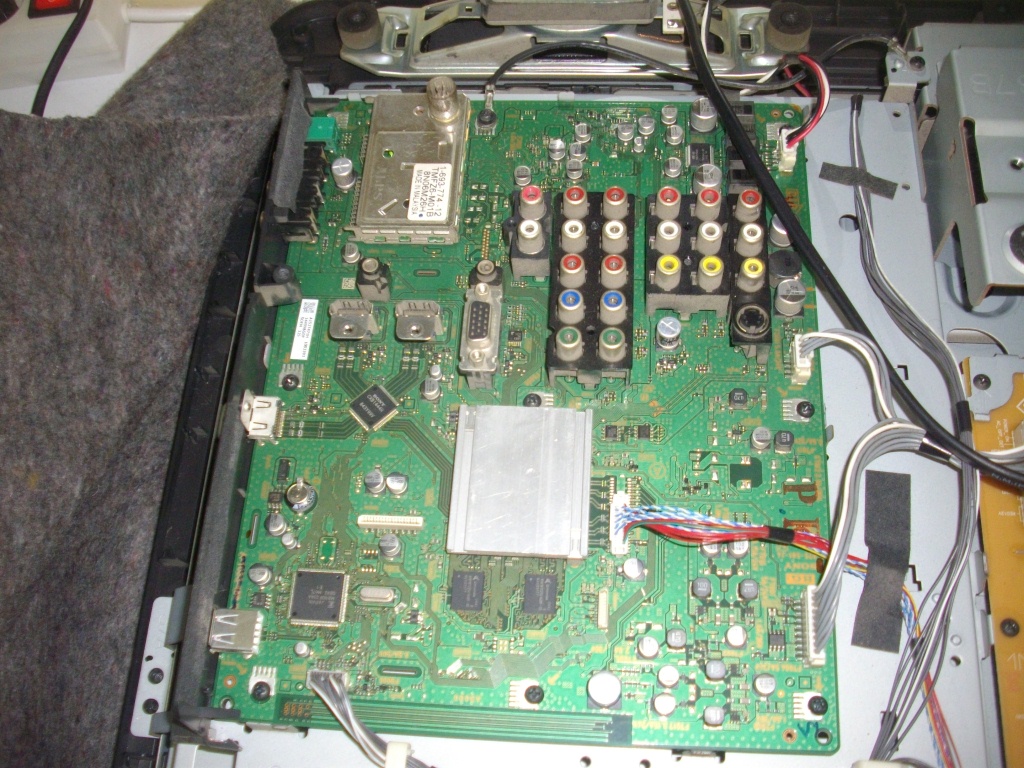

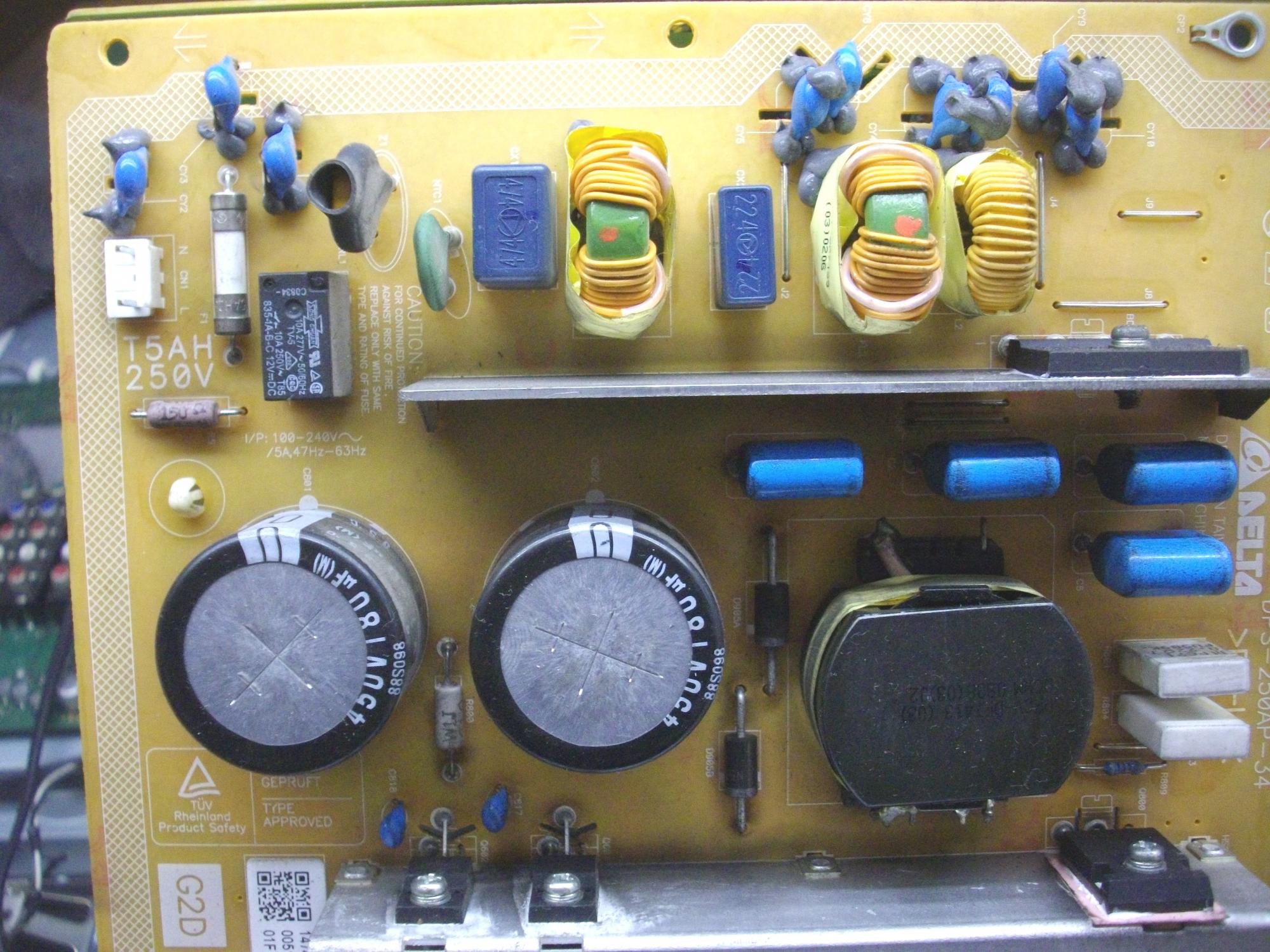

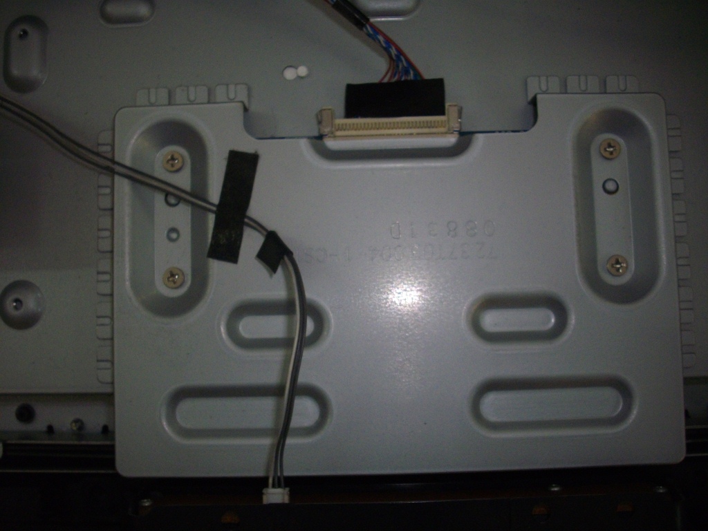

@milha My post was directed at MADY but if you look at MADY's picture 3 there is a small white fuse just above the connector. It is at F4 which might suggest there are other fuses on that board. Do you have a different board?Please upload pictures using attachment function when ask for help on the repair
