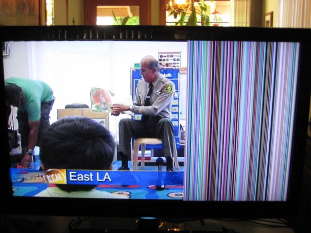

    Yesterday I have picked up this TV which has colored vertical lines on the right side of the screen on all inputs and also on the menu.
    I have tried cleaning the LVDS cable ends and the ribbon cables, but there is no change.
    It has video on the remaining "good" part of the screen. It also has good audio.
    I'm thinking T-con board, but before I rush buying one, I would like your opinion on this.
    Here is the picture of the screen:

    There is no 100% on this, I would try new T-CON first. Even Toshiba does not know for sure, see their troubleshooting guide from their service manual.

      There is nothing to check on the T-con?
      I have checked a regulator(at least that what it looks like-A1718) which has these voltages: 3.3V, 1.85V and 2.6V.

        That looks OK, I would think if it has bad regulator, the whole screen will be affected.

            What do you think about only 1/3rd of the screen has these lines? If the T-con would be the issue it wouldn't had 1/2 the screen lines?

              You really can't state this for certain, I have seen many different symptoms for T-Con failure. There really is not much you can check on a T-Con board. It is just a bunch of lines carrying digital data and timing signals. No manufacturer that I know of has provided schematics for their T-Con boards, so you really have no idea what to look for, or where to look for it on a T-Con.

                        I have replaced the T-con with another one purchased from Ebay and the screen looks exactly the same.
                        Now, how do I know if the T-con that I have received is good?
                          Re: Samsung LN-52A550 vertical lines
                          Per that troubleshooting document from Sony, if I play with the T-con cable it should change something on the screen if the T-con is not the issue, but on mine nothing changes. There is video and lines or there is nothing on the screen(black). It looks like a bad T-con, am I right?
                          Most likely the replacement is bad too. Not sure what to say to the seller.

                            It is unlikely that the replacement board would have exactly the same problem as the original. I had half of the screen show vertical lines on a vw42l when the ribbon cable became frayed. I replaced the cable and it was fine.

                                As the guy above said, its extremly unlikely the tcon you got would have the same problem. Almost every tcon failure is in someway unique.
                                I could have also told you ahead of time that this was probably not a tcon error because like ive said before on this site > tcons output every 60th line or so from the chips individual drivers. So an error with a bad driver causes a line every 60 pixels. The other issues with tcons / or the boards on the edge would be 1/2 the screen being affected.
                                Since your set has like 2/5th affected and its not evenly spaced lines, it appears to not be the tcon at fault.
                                In regards to the jiggling the tcon to test if its bad > i think they mean like seriously tugging on the ribbon cables / or inserting them crookedly so that you get the issues that are common with the ribbon cables being inserted wrong.
                                If anyone has seen a problem with lines on less then 1/2 the screen that was fixed by replacing a tcon please tell me so i know this is not a fool proof assesment, but so far im pretty sure it is a good rule of thumb.
                                In regards to whats actually causing your problem, no idea, but possibly the lvds converter on the motherboard ? or a voltage? You can use a oscope to check all the lvds signals i think, but thats beyond my knowledge.
