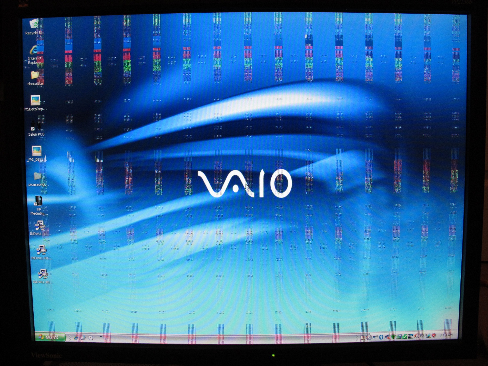

Viewsonic vp2013b flickering screen

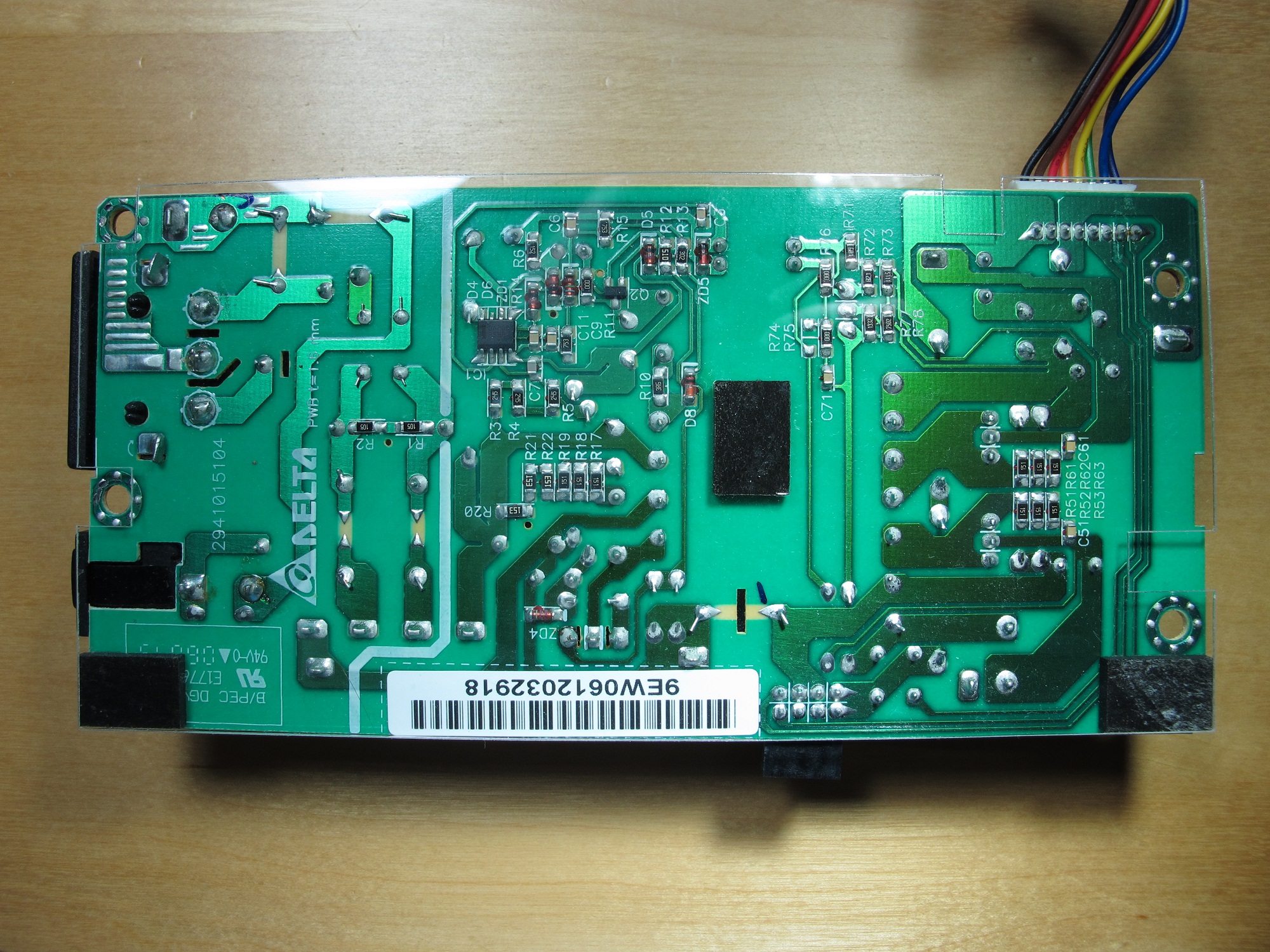

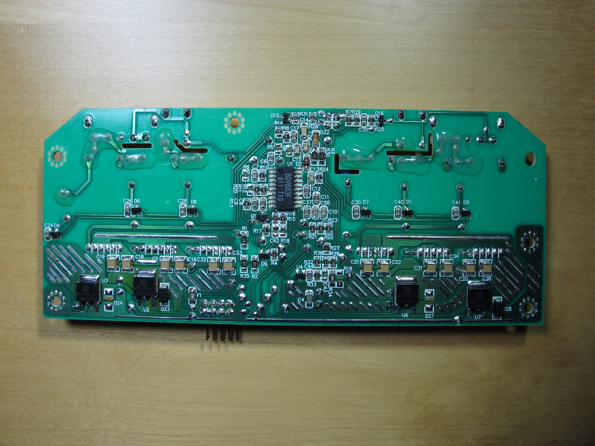

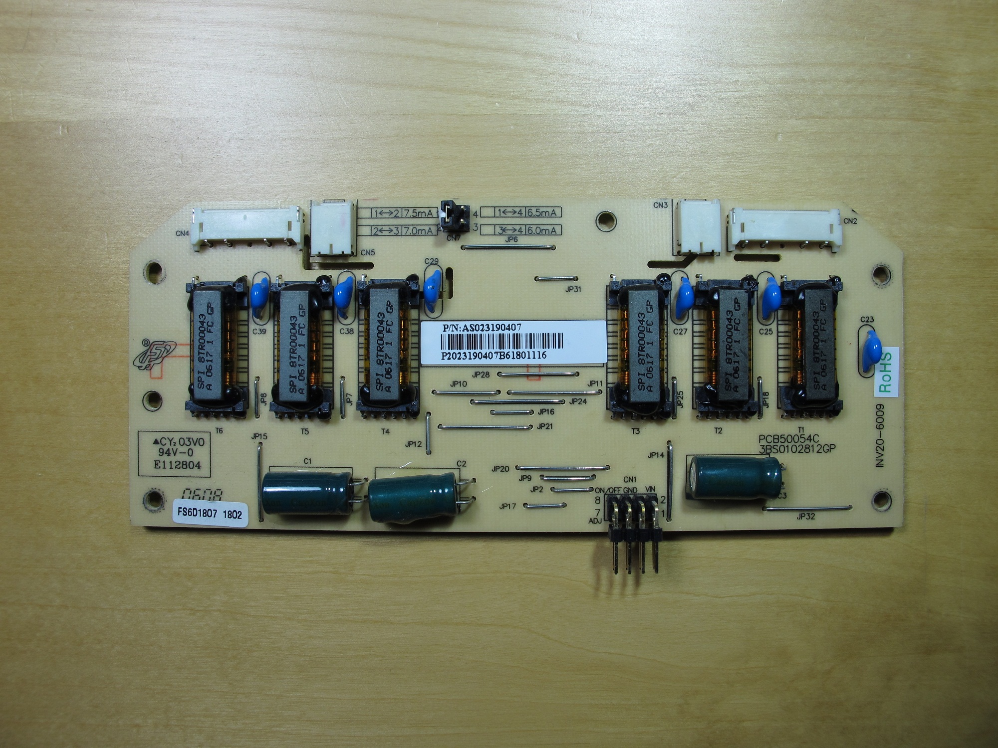

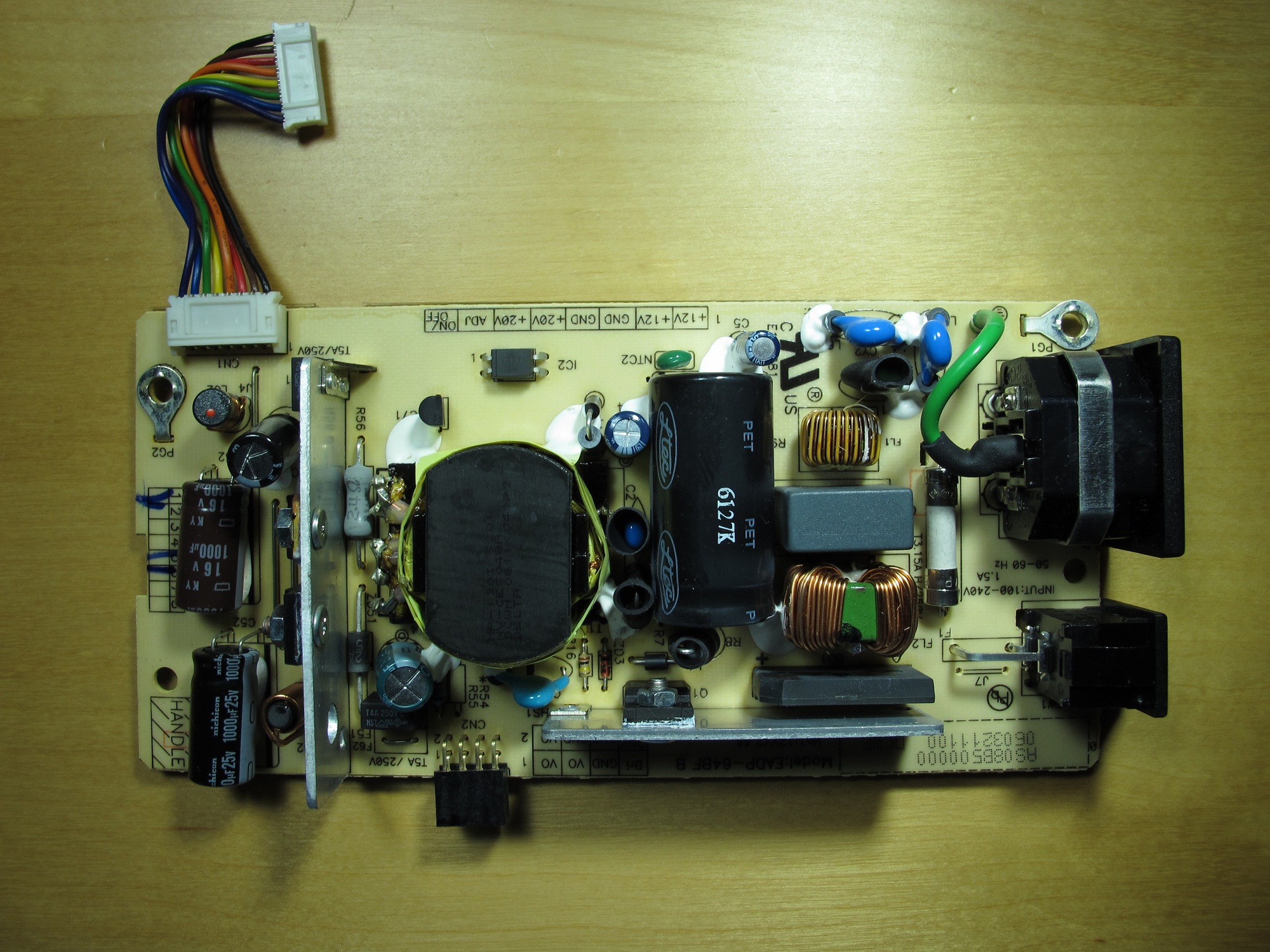

    I have already tried to change a few caps on the main board, but the problem is still there.
    Will the problem be the main board or the power board?
    Is there a way to find out this kind of problem?

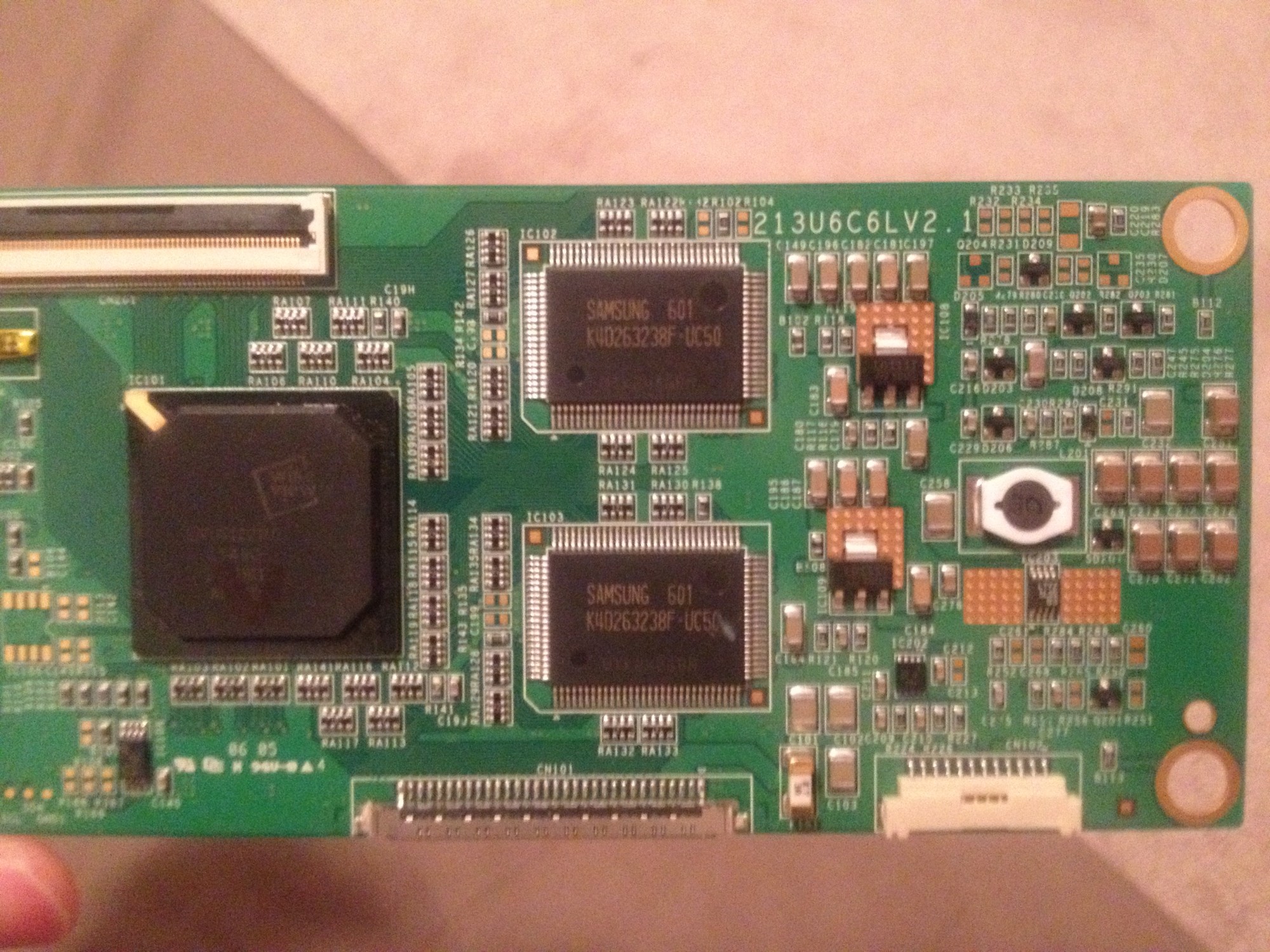

    It looks more like a T-con board problem. On smaller LCDs this is not replacable, yours might be an exception. The T-con is attached directly to the LCD panel and is usually at the top of the display.
      Re: Viewsonic vp2013b flickering screen
      Can a t-con board be replaced?

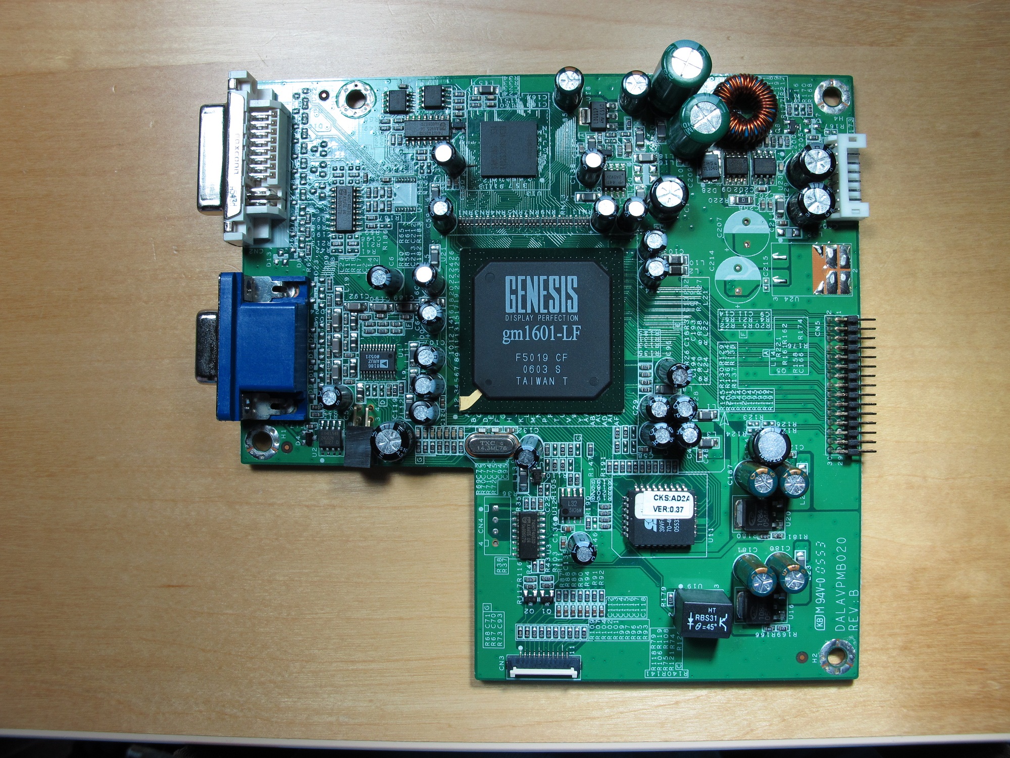

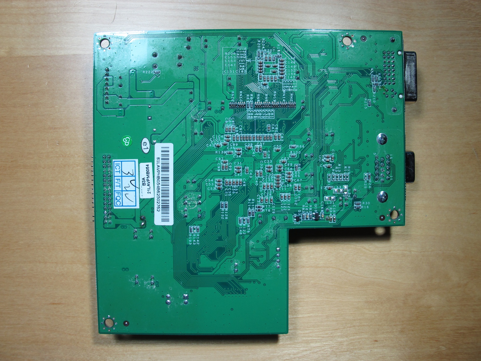

        Just to be sure, check the voltages on the 3-pin regulator IC's (I see 3 on the board) on the signal processing board (the board where you plug in the VGA cable) also. Also try heating up the T-CON board and the signal baord with hair dryer to see if the symptom changed.
          I have tried to heat up the both board with a hair dryer and result stayed the same.
          Checked the 3 regulators with following result:
          Part number 1084-0544AL (located at u20 on the signal board)
          pin 3 = 4.92
          pin 2 = 1.81
          pin 1 = 0.56
          Part number 1084-0544AL (located at u16 on the signal board)
          Pin 3 = 4.92
          pin 2 = 3.33
          pin 1 = 2.07
          Part number LD1117-c550 (Located top center on signal board)
          Pin 3 = 4.94
          Pin 2 = 2.51
          Pin 1 = 1.26
          power was on when I test them.
            OK, the regulators outputs are good.
              Last thing will be the T-con board.

                                I tried to reflow the chip on the T-con, but the screen has same distorted graphic.
                                sorry about the quality of an iphone!
                                  ok, I already bought 2 new T-con boards. Nothing has improved.
                                  After I install the first T-con, it's even worst.
                                  And recently I've order a new one from some where else. Not much of a difference.
                                  What else could it be?
