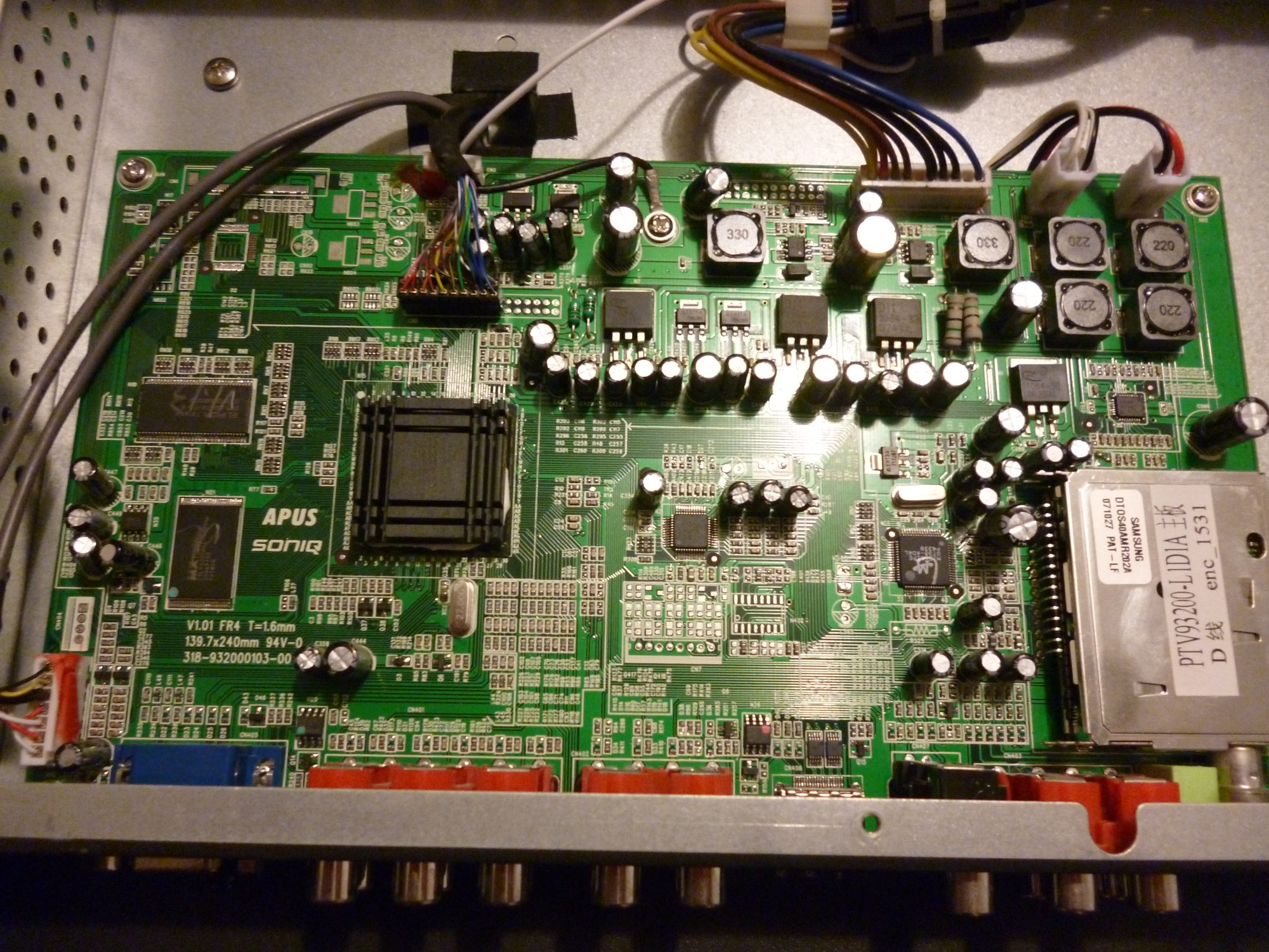

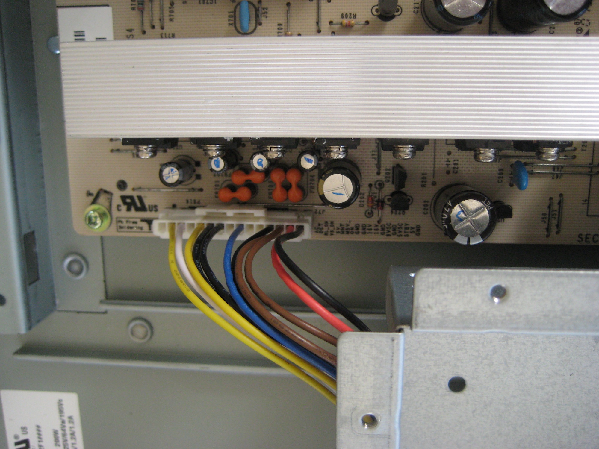

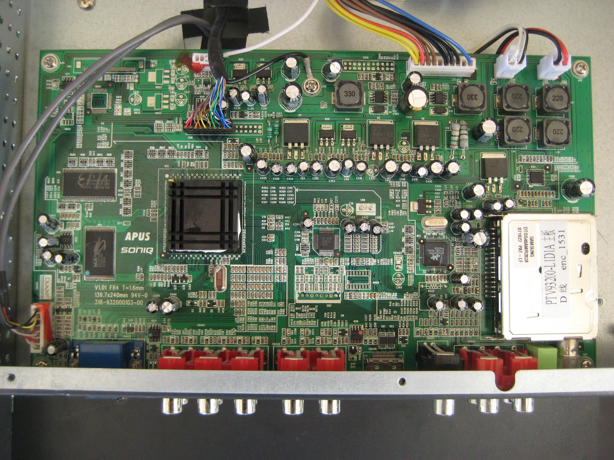

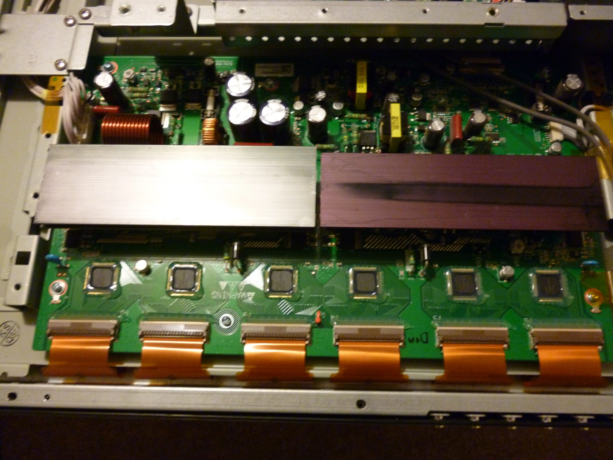

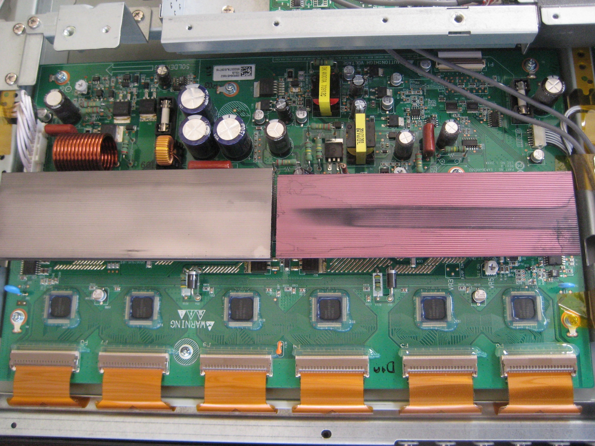

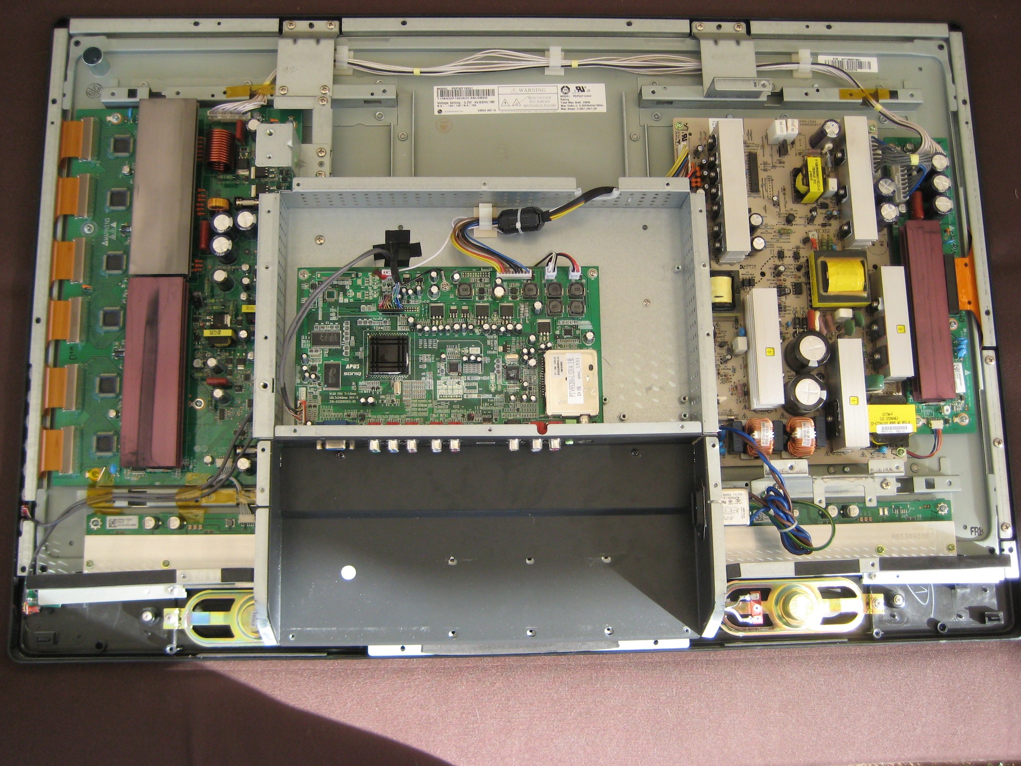

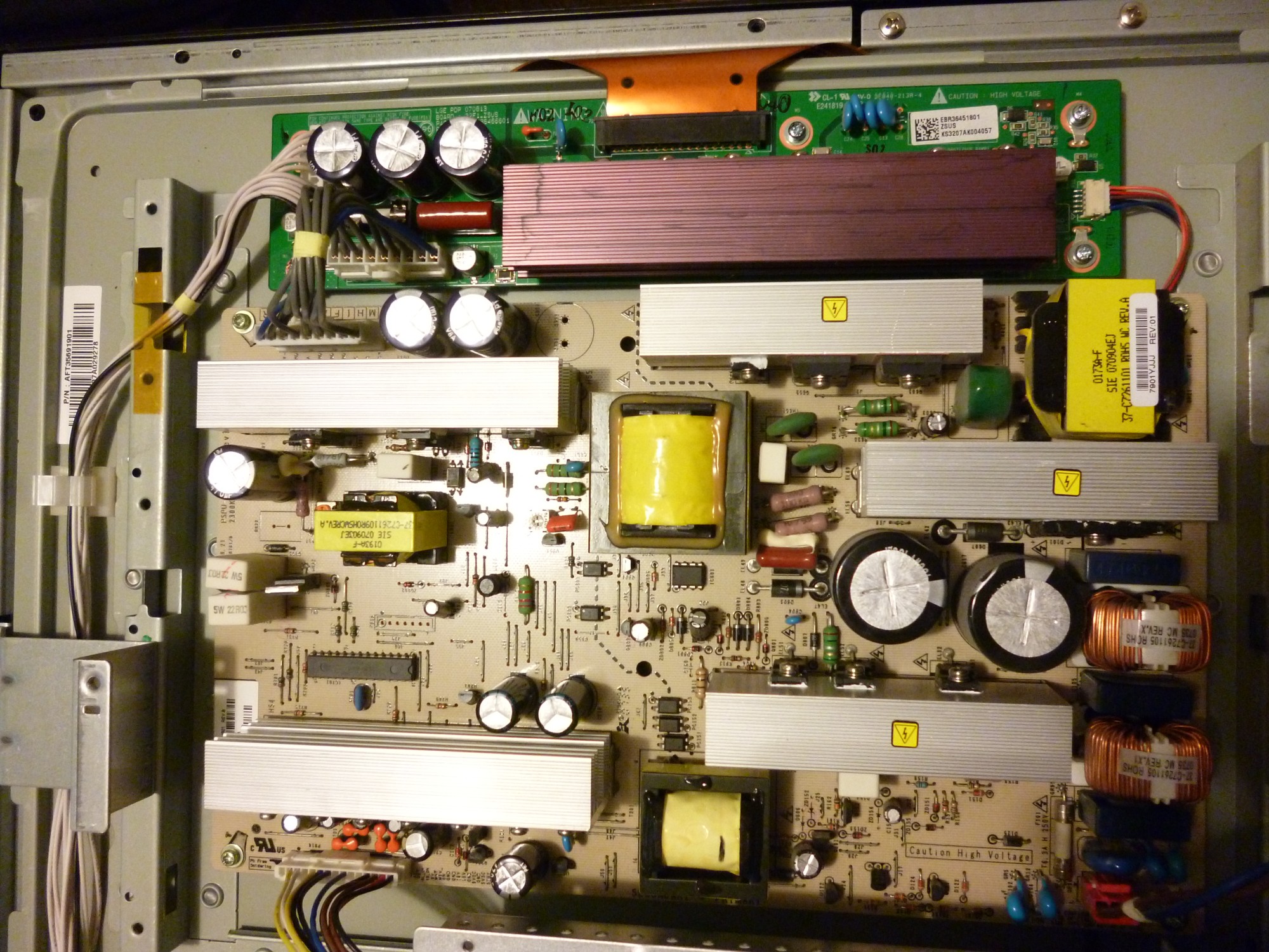

              Photos attached - got home late so was unable to get pictures with natural light

                    3rd pic is the ysys board p/n is in 1st post

                      Before you start replacing can you take close up pics of the connectors showing the legends beside them. Voltages can then be checked - it may not be the power supply
                      on PSU board, top left connector legend is:
                      AC DET
                      RL_ON
                      VS_ON
                      5V MNT
                      M5 V_ON
                      GND
                      GND
                      16V
                      16V
                      GND
                      9VSC
                      GND
                      5VSC
                      STBY 5V
                      GND
                      Connector on top RH side is:
                      5V-
                      GND
                      VA
                      GND
                      GND
                      GND
                      NC
                      VS-

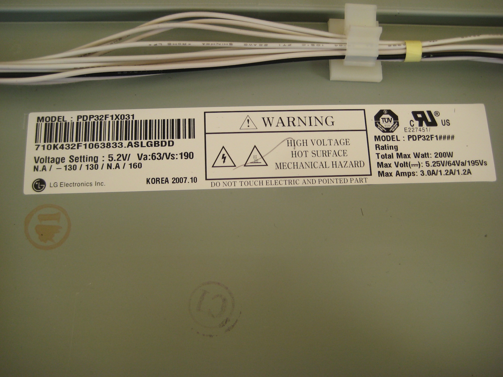

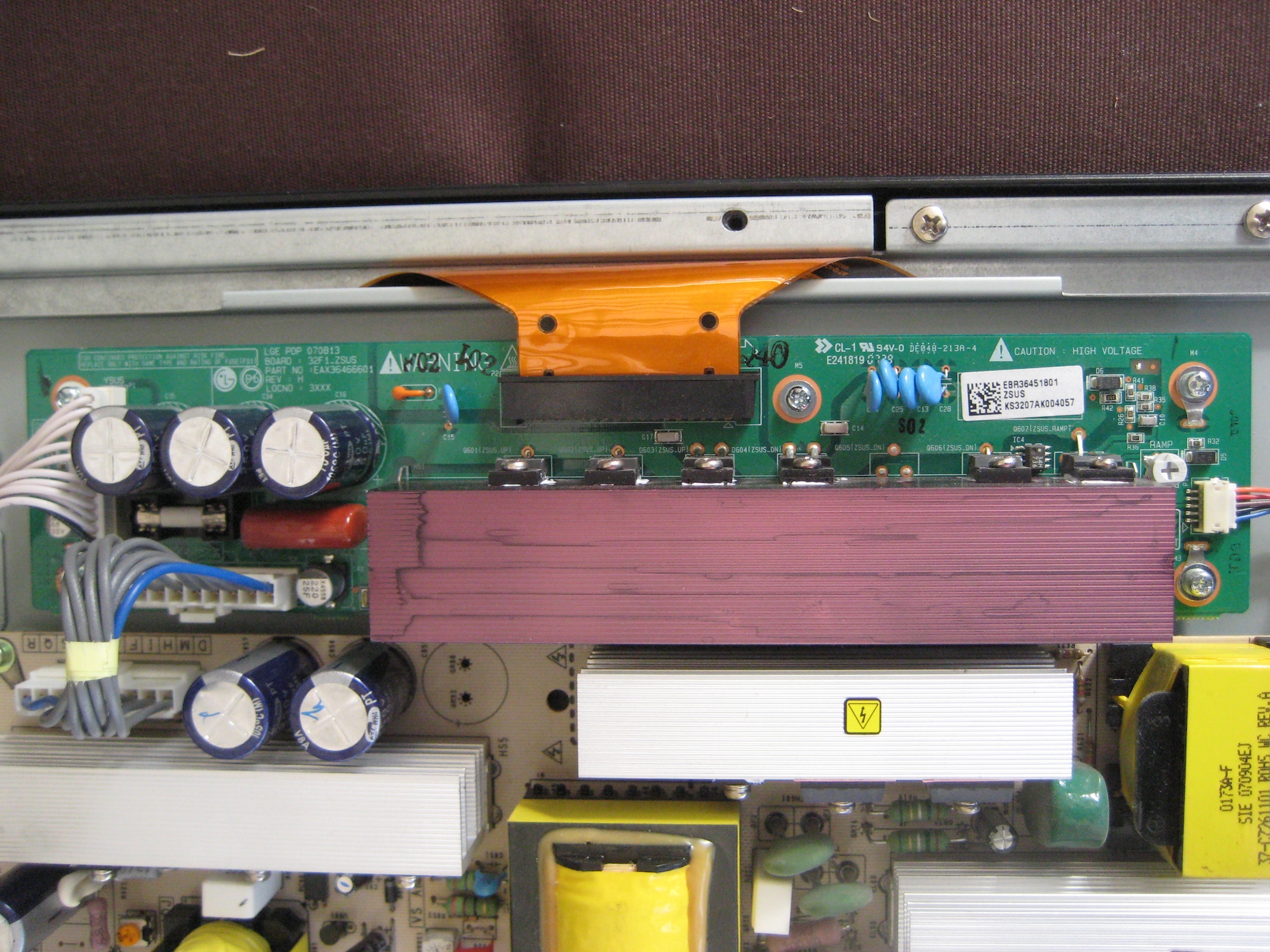

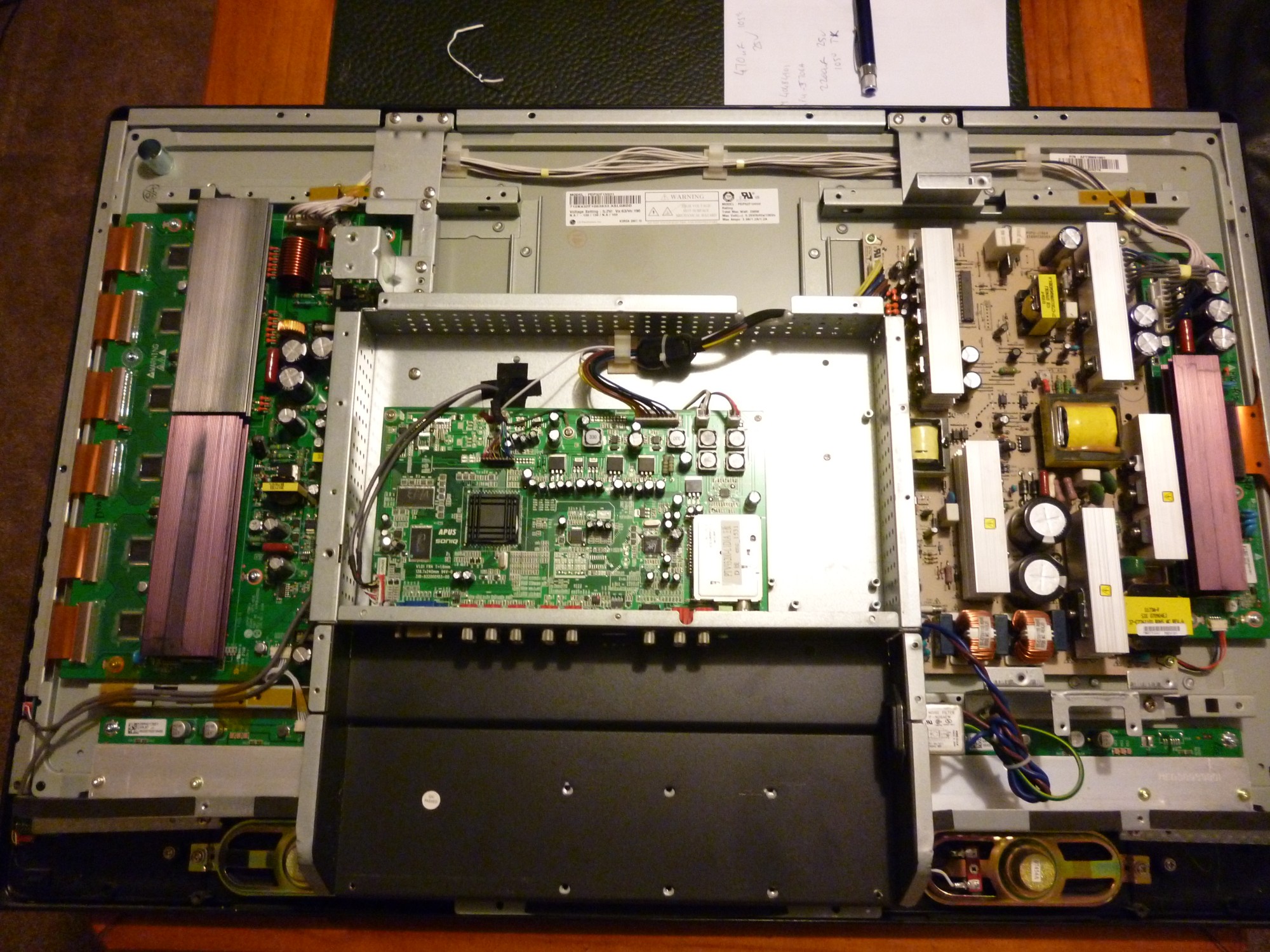

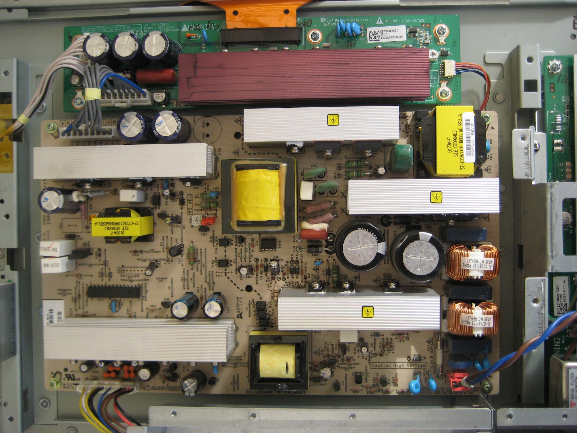

                                  OK, dragged the TV downstairs and got some photos in better light that are hopefully a lot clearer

                                      Can you check the AC_DET pin during when it fails to turn on, and when it works?
                                      Plasma displays use four or five different voltages. The two most important are Vs and Va, approximately 180-210V and 50-70V. In addition, there are -Vy, around 120-200V, Vzbias, around 60-90V, and Vscw, around 180-200V.

                                        VA is 62.4 in both scenarios, VS is 189.5 - also in both scenarios, will go look for AC_DET pin now
